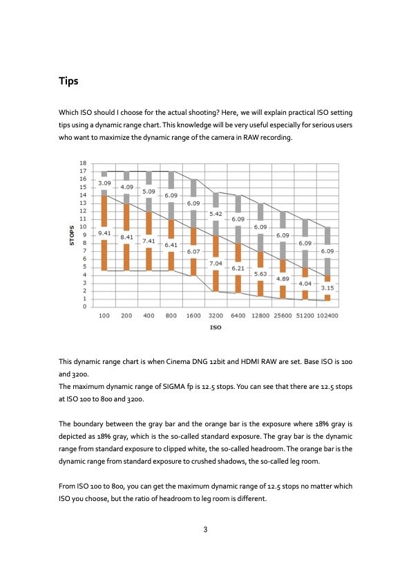

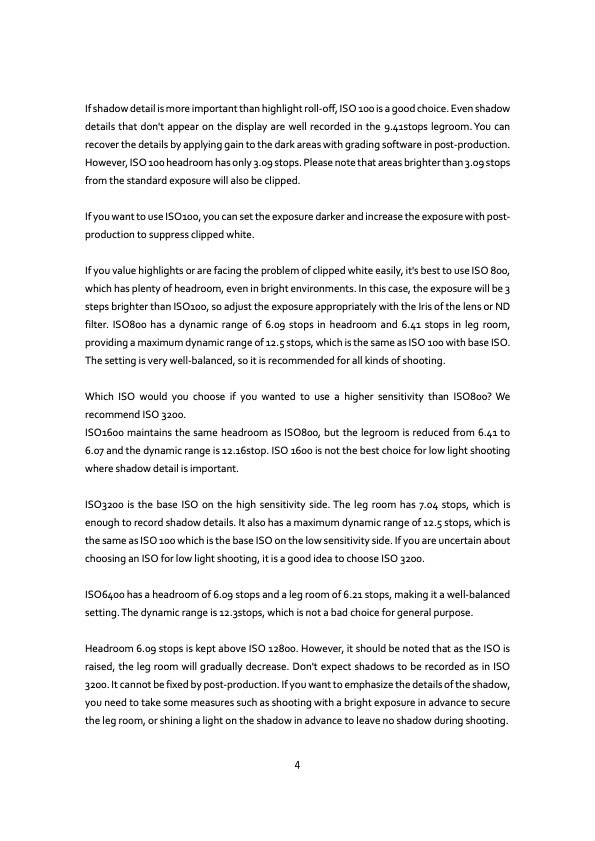

Owlgreen Posted May 3, 2022 Share Posted May 3, 2022 On 5/3/2022 at 4:39 PM, OleB said: May I ask how you determine the correct exposure? Because as stated earlier, all regular tools, including in camera metering, are only working for ISO 100. That ISO value tends to clip highlights indeed very quickly. Expand I just have the histogram. I saw a video where a guy showed you can pull back around two and half stops of highlights relative to the clip point on the histogram. So if the histogram is unclipped I can increase the exposure by about two stops knowing I can pull it back later. I'm still finding my way around this thing. Given that chart you posted a few days back, would it make sense for me to shoot ISO 800 most of the time, given that I would like to protect the highlights at all costs? I think the noise characteristics of this camera look great, so I don't mind trading noise for more highlight latititude. Should I be using false color? Link to comment Share on other sites More sharing options...
OleB Posted May 3, 2022 Share Posted May 3, 2022 On 5/3/2022 at 5:04 PM, Owlgreen said: I just have the histogram. I saw a video where a guy showed you can pull back around two and half stops of highlights relative to the clip point on the histogram. So if the histogram is unclipped I can increase the exposure by about two stops knowing I can pull it back later. I'm still finding my way around this thing. Given that chart you posted a few days back, would it make sense for me to shoot ISO 800 most of the time, given that I would like to protect the highlights at all costs? I think the noise characteristics of this camera look great, so I don't mind trading noise for more highlight latititude. Should I be using false color? Expand Understand that you do not have a Ninja V available. So yes, I would try to use ISO 800 like Sigma intended. For the scenario you described, easily and ugly highlight clipping, they will recommend using ISO 800. Internal false color screen should help on setting exposure correctly. Have attached the additional fp manual from the developer, which tells you what ISO to use and when, including the chart. Keep in mind this is only true when you are using the in camera options including record to an external SSD. When recording ProRes RAW or most likely as well BRAW with an external recorder, you have to choose the approach which I have posted earlier to get the best quality. Hope that helps 🙂 Thomas Hill 1 Link to comment Share on other sites More sharing options...
Ryan Earl Posted May 3, 2022 Share Posted May 3, 2022 On 5/3/2022 at 5:04 PM, Owlgreen said: I just have the histogram. I saw a video where a guy showed you can pull back around two and half stops of highlights relative to the clip point on the histogram. So if the histogram is unclipped I can increase the exposure by about two stops knowing I can pull it back later. I'm still finding my way around this thing. Given that chart you posted a few days back, would it make sense for me to shoot ISO 800 most of the time, given that I would like to protect the highlights at all costs? I think the noise characteristics of this camera look great, so I don't mind trading noise for more highlight latititude. Should I be using false color? Expand I agree ISO 800 will protect the highlights better. You can also post a DNG frame or two to compare developing methods. Link to comment Share on other sites More sharing options...
Owlgreen Posted May 3, 2022 Share Posted May 3, 2022 On 5/3/2022 at 5:22 PM, OleB said: Understand that you do not have a Ninja V available. So yes, I would try to use ISO 800 like Sigma intended. For the scenario you described, easily and ugly highlight clipping, they will recommend using ISO 800. Internal false color screen should help on setting exposure correctly. Have attached the additional fp manual from the developer, which tells you what ISO to use and when, including the chart. Keep in mind this is only true when you are using the in camera options including record to an external SSD. When recording ProRes RAW or most likely as well BRAW with an external recorder, you have to choose the approach which I have posted earlier to get the best quality. Hope that helps 🙂 Expand Thanks, Ole! I wish I'd seen this paper sooner. OleB 1 Link to comment Share on other sites More sharing options...

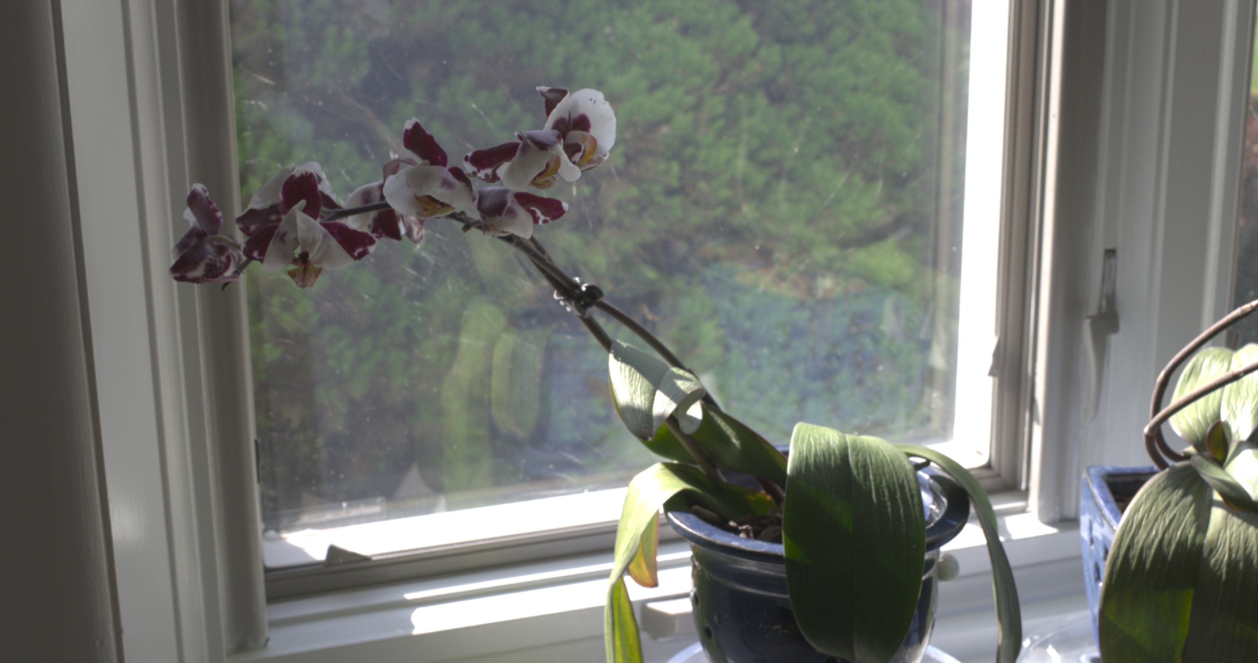

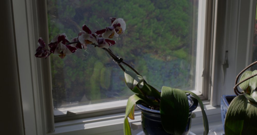

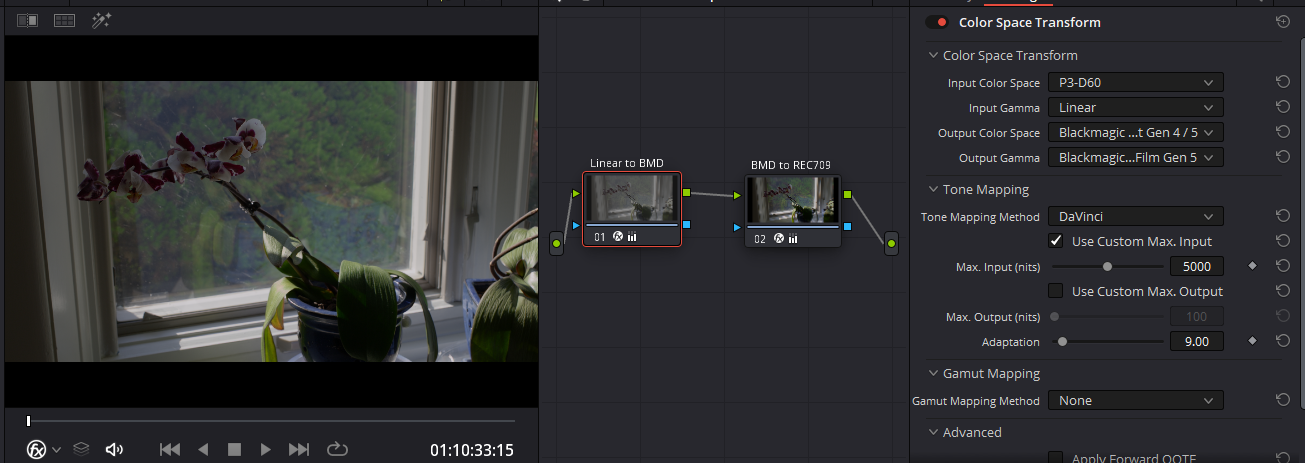

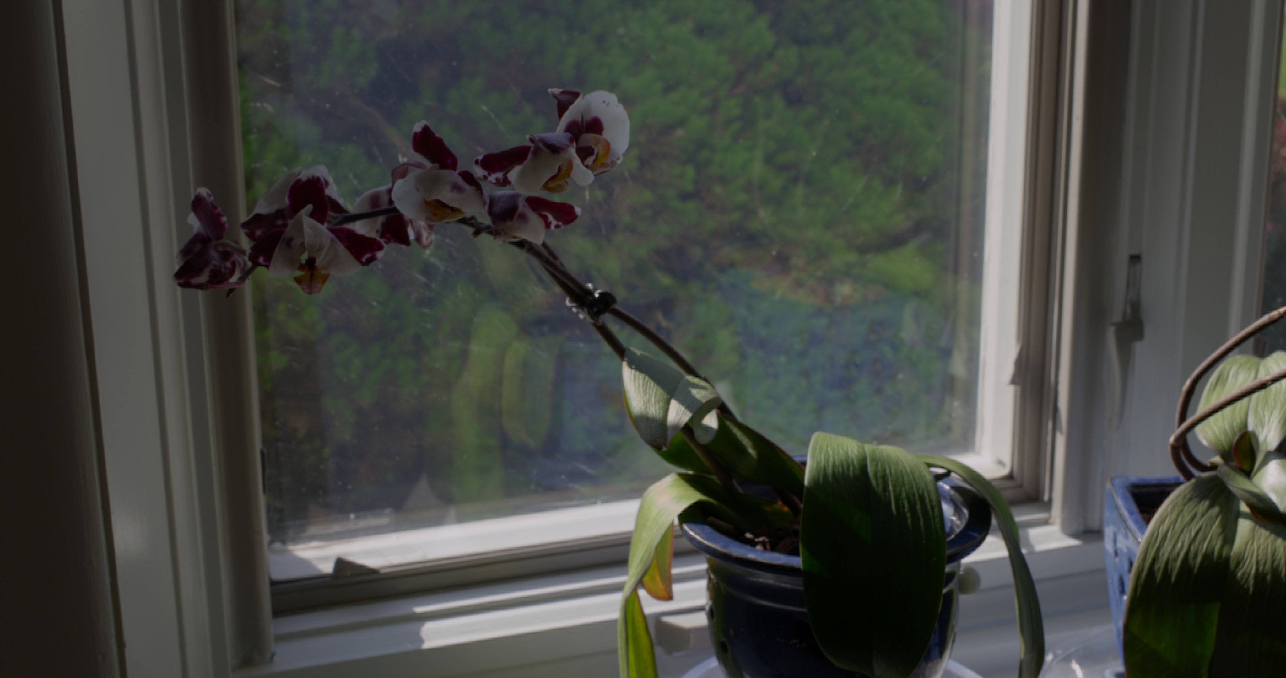

Ryan Earl Posted May 3, 2022 Share Posted May 3, 2022 The monitoring situation is tricky. With the following image recorded in 1080 12bit DNG the whites of the window sill were considered clipping on the camera's monitor and the waveform. The ISO is 160 and it pretty much looked this way on the camera's monitor. I think you will struggle to pull them back down while working directly in REC709 - GAMMA 2.4 or SRGB. Then below is a transform to Blackmagic Wide Gamut and Blackmagic Film Gen 5 with the CST tool from P3-D60 and Linear. Then from BMD GEN 5 a 2nd transform to REC709. You can also try transforming to the RED or ARRI spaces if you have luts for those already. I just added a bit of saturation on top without exposure adjustment, but you can see that I'm underexposing the flowers to hopefully pull them back up. Link to comment Share on other sites More sharing options...
Llaasseerr Posted May 3, 2022 Share Posted May 3, 2022 On 5/3/2022 at 9:33 PM, Ryan Earl said: The monitoring situation is tricky. With the following image recorded in 1080 12bit DNG the whites of the window sill were considered clipping on the camera's monitor and the waveform. The ISO is 160 and it pretty much looked this way on the camera's monitor. I think you will struggle to pull them back down while working directly in REC709 - GAMMA 2.4 or SRGB. Expand Right. The issue is being unable to see clipping like you describe while monitoring, with the default profiles on the camera. It would be a good reason to consider underexposing at a fixed level with an ND, and having the ability to toggle a LUT on and off that included an exposure boost. Again, this is where a published Sigma log curve would be useful - for monitoring. As for working with the image, just to be clear I'm not advocating working in Rec709. Personally I would work in either linear ACES or then convert the linear image to Arri logC. the DNG IDT is the most accurate DNG raw import available in Resolve since it's generated on the fly. In the case of transforming to LogC, the ACES inverse Alexa IDT will do a pretty accurate transform from the linear image to Alexa. Arri's log color space is well documented and not confusing compared to BMD. Basically, I could round trip the image from LogC back to linear ACES and it would match the original imported DNG (via the ACES IDT), so then I know the image integrity has been maintained. My assumptions are based on sound DNG metadata though, as this is what Resolve relies on for accurate ACES input transform. Link to comment Share on other sites More sharing options...
