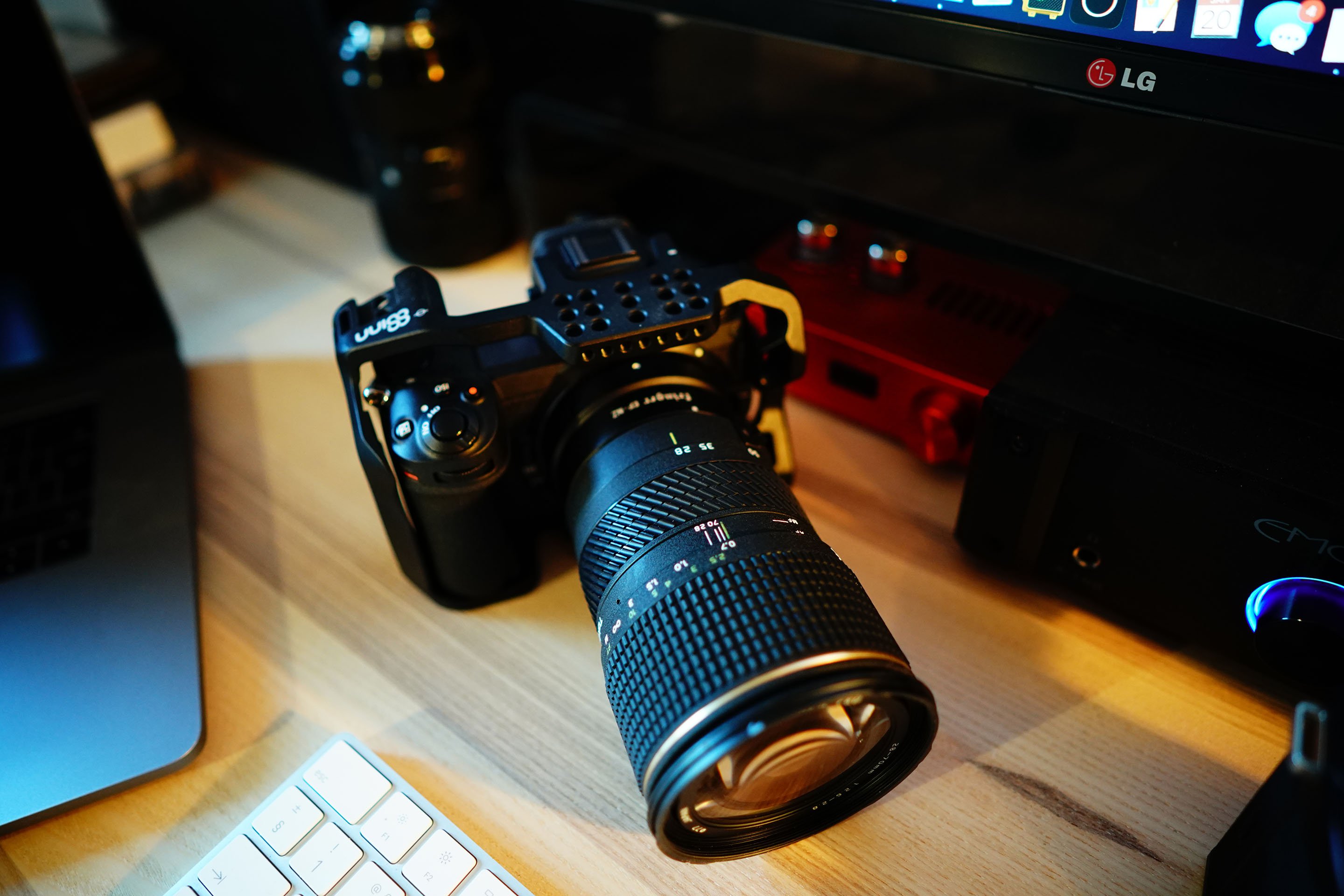

Administrators Andrew - EOSHD Posted January 20, 2020 Author Administrators Share Posted January 20, 2020 On 1/18/2020 at 11:26 PM, rawshooter said: I can also warmly recommend the Tokina 28-70mm/2.8 which is a bought-up and continued Angenieux design: https://cameragx.com/2018/04/11/the-truth-about-the-angenieux-28-70-af-zoom/ It's a blazing lens. Glorious. Still totally undervalued. I got my Canon EF version for £200. The AF even works well on the Fringer Nikon Z adapter (pictured below) for stills. Not so much video as the AF motors are clunky and old, very noisy... Optically though, it's glorious. canonlyme 1 Link to comment Share on other sites More sharing options...
