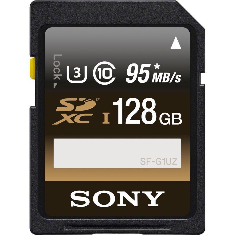

Super Members BTM_Pix Posted May 11, 2019 Super Members Share Posted May 11, 2019 This is following on from something in the thread for the Pocket4K for anyone looking to pick up an original Pocket or Micro or, like myself, dusting off an old one that might not be aware of an issue with available SD cards. All of the SD cards that I put in it (and I tried a lot !) where coming up with No Card error and no amount of re-formatting internally or externally was resolving the issue and then I went and had a look at the official forum and saw this https://forum.blackmagicdesign.com/viewtopic.php?f=2&t=83050&sid=2c193679bb69a8d8f2c48ac0b85ced38 Basically, Sandisk made a change and the original cameras (and the Video Assist as well I understand) can no longer read them. Sony made a firmware change to accommodate it for their cameras but BM haven't and likely won't. The upshot is that it is a nightmare trying to find recently produced SD cards that will work with them and users have been trying and returning all sorts of different ones trying to find a solution. After a lot of this effort, the card type that came up as being able to work is, ironically, a Sony one. It is the UZ designation at the end that is important as there are a few similar looking ones. This is the Amazon link to this exact one https://www.amazon.co.uk/gp/product/B00YOKOJOU/ref=ppx_yo_dt_b_asin_title_o05_s00?ie=UTF8&psc=1 Mine arrived yesterday and I'm happy to confirm that it does indeed work perfectly well with my original Pocket camera so if you are looking at picking a camera up used or getting one out of the back of a drawer and don't have the original media for it then I'd recommend picking one of these up. Apologies for the cross post but the info would have got lost in the behemoth Pocket4K thread and at the time of my original post to @mercer in there about it I hadn't been able to confirm personally if this particular card worked. And now I can matthere, Bioskop.Inc, Emanuel and 1 other 2 2 Link to comment Share on other sites More sharing options...

Super Members BTM_Pix Posted May 11, 2019 Author Super Members Share Posted May 11, 2019 6 hours ago, Mattias Burling said: SandDisks newer U3 cards that I use for the EOS-R and BMPCC4K have been a bit sketchy as well. Two physically broke within a week of normal usage. I've had three where the case separates slightly and the guards between the contacts break off. 2 hours ago, Bioskop.Inc said: Thanks for this, will have to get myself a few now - who knows where we will be in a years time, might not be able to use cards in these old cameras?! I'm going to buy a few just to be on the safe side in case BM don't produce a fix. Surprising that they haven't thus far really as it impacts the Micro and the Video Assists which are still current products. Link to comment Share on other sites More sharing options...
Super Members Mattias Burling Posted May 11, 2019 Super Members Share Posted May 11, 2019 28 minutes ago, BTM_Pix said: I've had three where the case separates slightly and the guards between the contacts break off. Same here, the separators are super thin and snap. Bummer when Ive had so good experiences before. On my older Class 10 thats been with me since the BMPCC days have had their lock-button fall off, making them permanently locked. But given the years of ware and tare I am willing to accept that. Will look for the Sony cards in Sweden. Im 95% sure I will be selling my BMPCC4K and invest further into my Micro. So the cards will be needed. Link to comment Share on other sites More sharing options...
