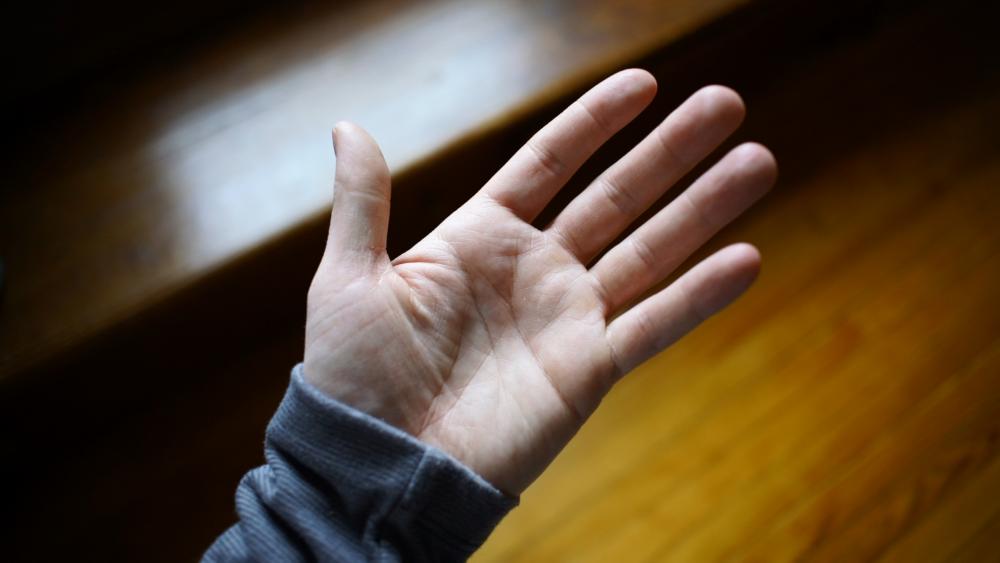

Don Kotlos Posted February 14, 2018 Share Posted February 14, 2018 Cine4 uses illegal values (0-255) and most programs do not recognize that correctly. Are you using the correct ranges? What color profile are you using? I have had a great experience with Cine/Pro modes with slight adjustments to the color depth. Also in the past, I had noticed differences in skin tones when contrast was adjusted between programs: By the way, like @Geoff CB I have also switched to Cine2 as well for most things Gregormannschaft and deezid 2 Quote Link to comment Share on other sites More sharing options...
