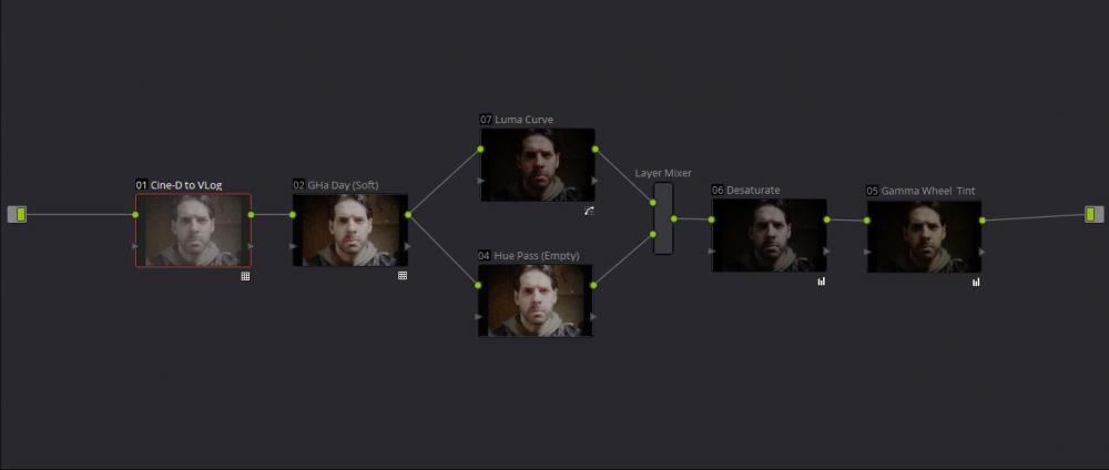

JeremyDulac Posted July 23, 2018 Share Posted July 23, 2018 @Sage , that looks really nice! What was your process grading those stills? Sage 1 Link to comment Share on other sites More sharing options...

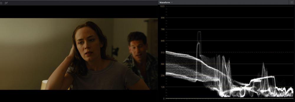

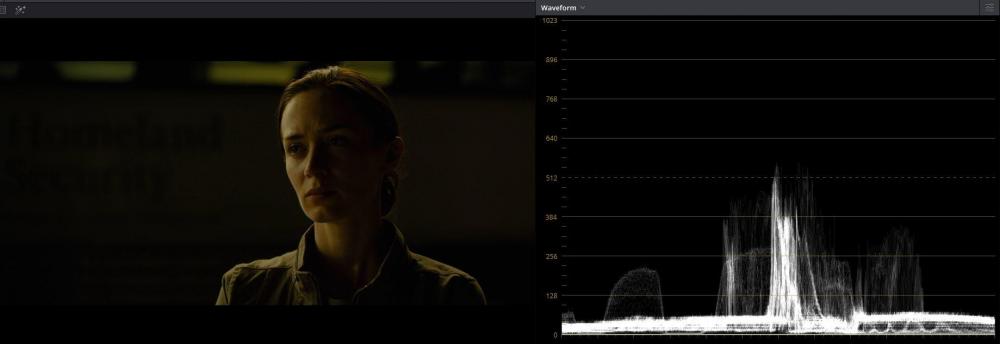

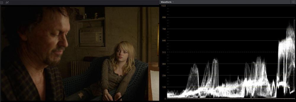

Sage Posted July 23, 2018 Author Share Posted July 23, 2018 Its really simple; first thing of note, its standard cinema luma placement for nighttime interiors with diffuse facial lighting - Take a look at where the faces place, and the black level is set in these: (its actually a bit brighter than I wanted, for the context of this white page) dxotic and Wild Ranger 2 Link to comment Share on other sites More sharing options...
deezid Posted July 23, 2018 Share Posted July 23, 2018 The lovely low contrast look but with nice full shadows. Sage 1 Link to comment Share on other sites More sharing options...

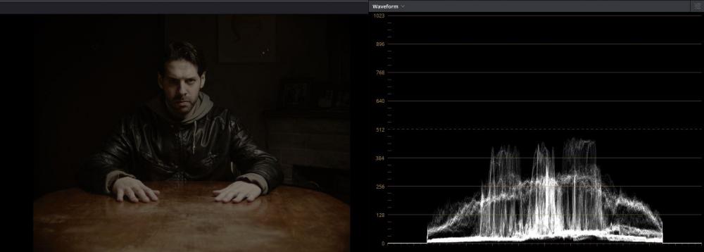

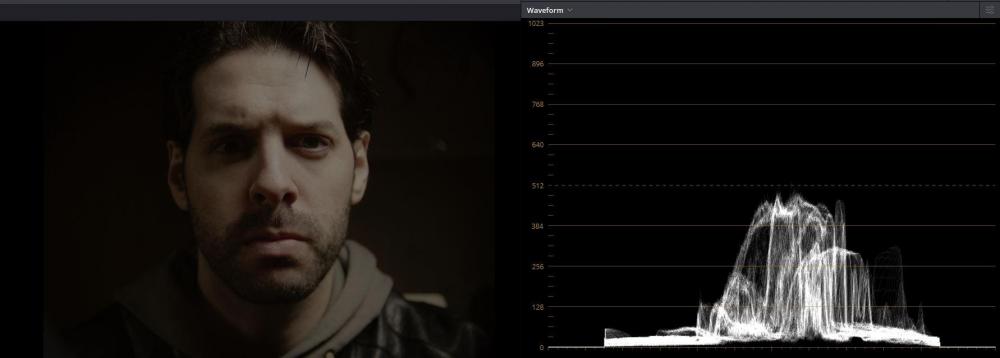

Sage Posted July 23, 2018 Author Share Posted July 23, 2018 Pt. 2 Here are the steps. Desaturate is actually at 23 on the far shot (context change) (Note: the Hue Passthrough is just an empty node, and the Layer Mixer is set to a Composite Mode of 'Hue' - right click on it. This is just to prevent hue distortion from the luma curve) dxotic and JeremyDulac 2 Link to comment Share on other sites More sharing options...

JeremyDulac Posted July 23, 2018 Share Posted July 23, 2018 Very nice! Thanks for the info. So could you elaborate on what the hue pass through setup? What is exactly is hur distortion? I think i have an idea, but was hoping you could explain. Also i notice you give several suggested methods of altering luma - but this hue pss through is your preferred method? thanks! Link to comment Share on other sites More sharing options...
Sage Posted July 23, 2018 Author Share Posted July 23, 2018 5 minutes ago, JeremyDulac said: Very nice! Thanks for the info. So could you elaborate on what the hue pass through setup? What is exactly is hur distortion? I think i have an idea, but was hoping you could explain. Also i notice you give several suggested methods of altering luma - but this hue pss through is your preferred method? thanks! It is my favorite method, because the Resolve luma curve is precise, and direct for luma placement. And for a neutral full saturation style, it used to just be the conversion on one node, and a luma curve on the next. Thanks to David L'Abbée, I discovered that it distorts hue. This means that (for example) a given red twists toward green as it gets brighter; and the other hues (MBCGY) twist away from where they should be with brightness change (contorting the color space). Ideally the curve should be coded to 'build-in' this hue pass, though we can do it manually JeremyDulac 1 Link to comment Share on other sites More sharing options...
JeremyDulac Posted July 24, 2018 Share Posted July 24, 2018 23 minutes ago, Sage said: It is my favorite method, because the Resolve luma curve is precise, and direct for luma placement. And for a neutral full saturation style, it used to just be the conversion on one node, and a luma curve on the next. Thanks to David L'Abbée, I discovered that it distorts hue. This means that (for example) a given red twists toward green as it gets brighter; and the other hues (MBCGY) twist away from where they should be with brightness change (contorting the color space). Ideally the curve should be coded to 'build-in' this hue pass, though we can do it manually Ahhh very interesting. Many thanks for all your work, as usual!! Sage 1 Link to comment Share on other sites More sharing options...
deezid Posted July 24, 2018 Share Posted July 24, 2018 It seems like the Hue distortion issue is fixed in DR15. At least I can't reproduce the issue here. If I use the Hue bypass via layer mixer or not - there's 0 difference in either Waveform, Parade nor Vectorscope Link to comment Share on other sites More sharing options...
Sage Posted July 24, 2018 Author Share Posted July 24, 2018 5 minutes ago, deezid said: It seems like the Hue distortion issue is fixed in DR15. At least I can't reproduce the issue here. If I use the Hue bypass via layer mixer or not - there's 0 difference in either Waveform, Parade nor Vectorscope That's fantastic news! Case study in why updates are vital* I'll be testing at work tomorrow deezid 1 Link to comment Share on other sites More sharing options...
deezid Posted July 24, 2018 Share Posted July 24, 2018 17 minutes ago, Sage said: That's fantastic news! Case study in why updates are vital* I'll be testing at work tomorrow Nvm, reproduced the issue by preparing two different versions of the grade - one with bypass, one without and it's easily visible going back and forth. Link to comment Share on other sites More sharing options...
Sage Posted July 24, 2018 Author Share Posted July 24, 2018 1 minute ago, deezid said: Nvm, reproduced the issue by preparing two different versions of the grade - one with bypass, one without and it's easily visible going back and forth. Darn. I was hopeful Link to comment Share on other sites More sharing options...
deezid Posted July 24, 2018 Share Posted July 24, 2018 Another option which might affect hues and even more: precision using luts in Davinci Resolve is 3D Lookup Table Interpolation. It should be set to Tetrahedral to avoid banding issues... Sage 1 Link to comment Share on other sites More sharing options...
Sage Posted July 24, 2018 Author Share Posted July 24, 2018 The hues won't change but its a good boost, the conversion is yet smoother (gradients) deezid 1 Link to comment Share on other sites More sharing options...
deezid Posted July 24, 2018 Share Posted July 24, 2018 1 minute ago, Sage said: The hues won't change but its a good boost, the conversion is yet smoother (gradients) Noticed as well. Link to comment Share on other sites More sharing options...

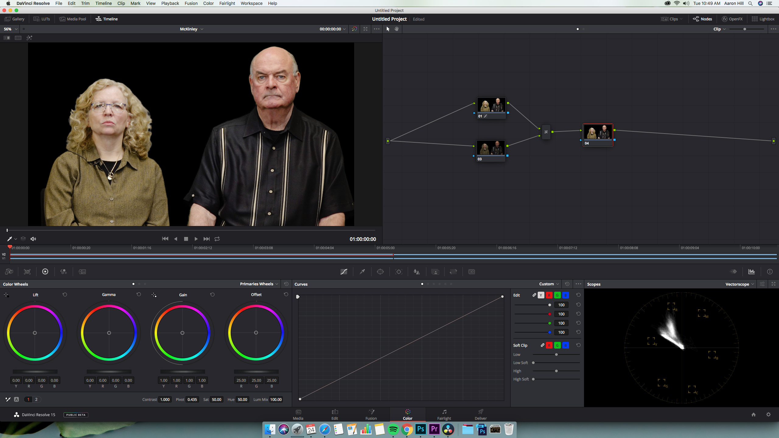

Sage Posted July 24, 2018 Author Share Posted July 24, 2018 Redundant, but here's the Resolve 15 luma curve hue test Link to comment Share on other sites More sharing options...
