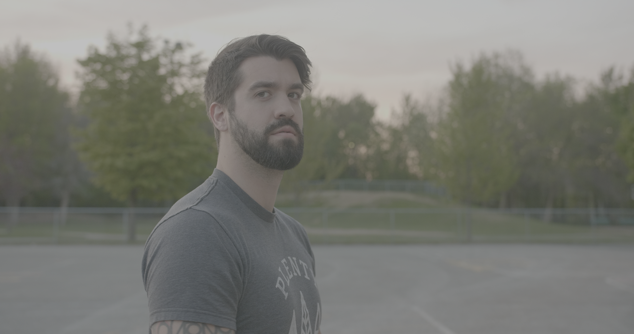

Sage Posted July 22, 2018 Author Share Posted July 22, 2018 @Wild Ranger I think it looks great! And you shoot under the most challenging light conditions (would love to see that in VLog with a halogen bulb if you've got one on hand, just for kicks) Can you post the VLog stills? I think the black level is good. For interiors/nights, blacks are best between 1-3 IRE (but never at 0 or below!) Quote Link to comment Share on other sites More sharing options...

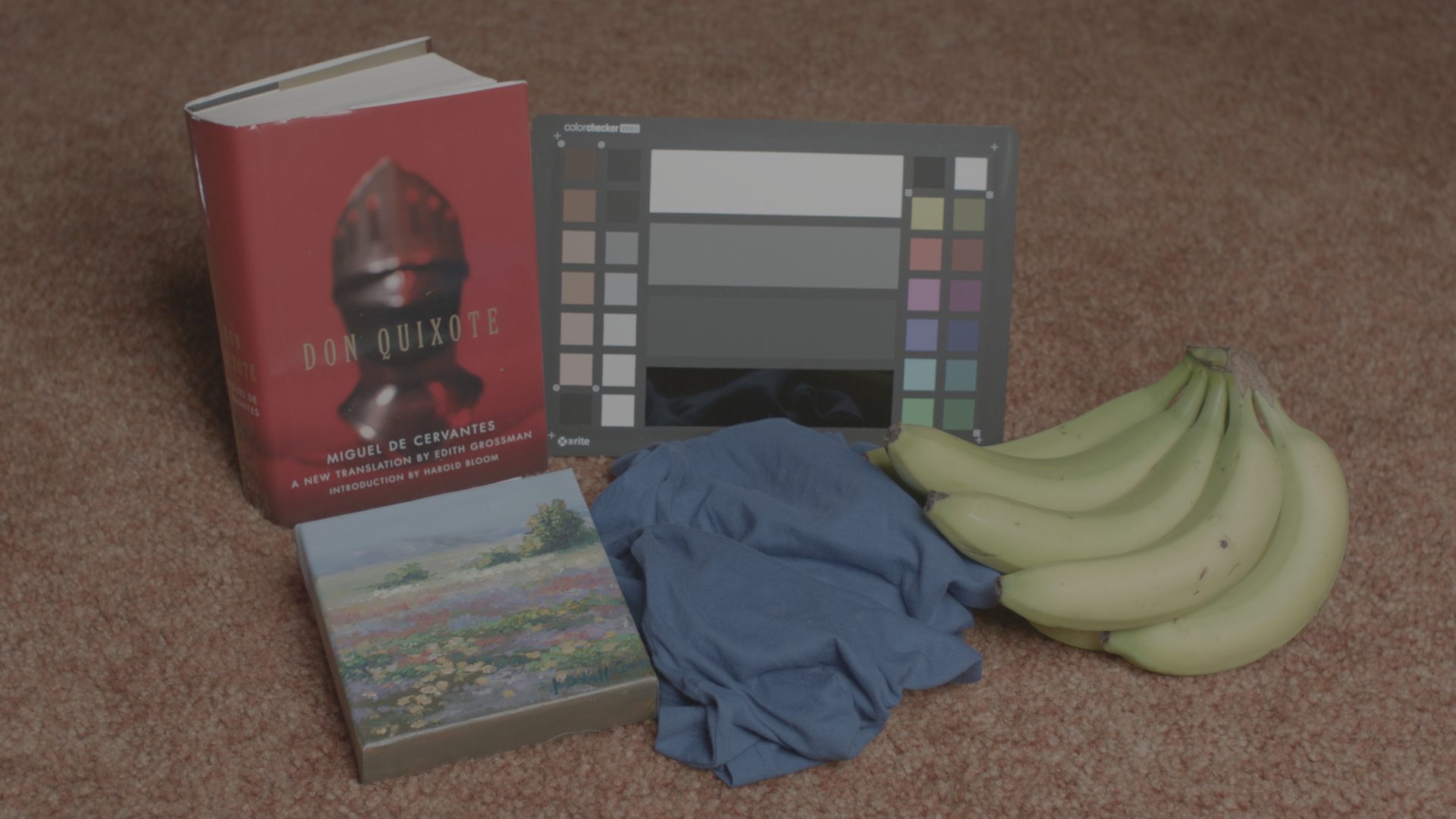

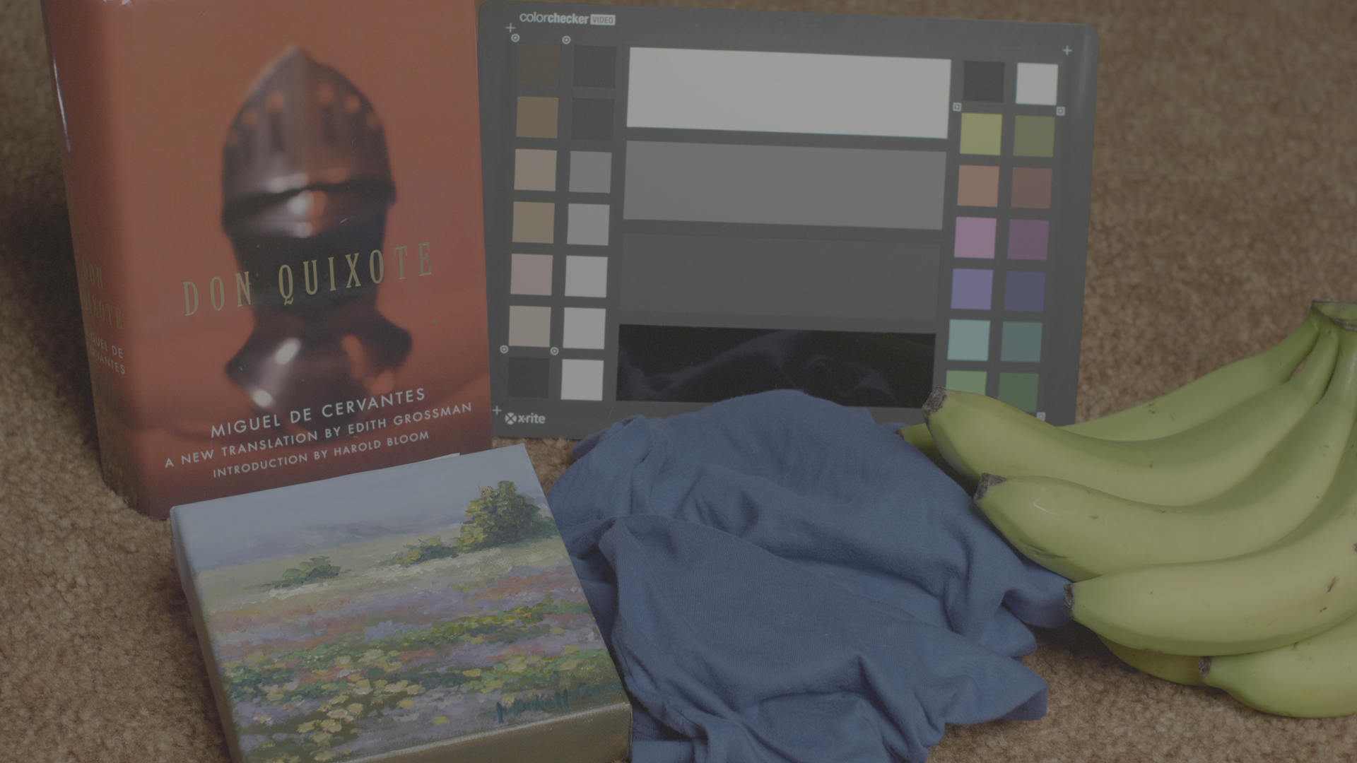

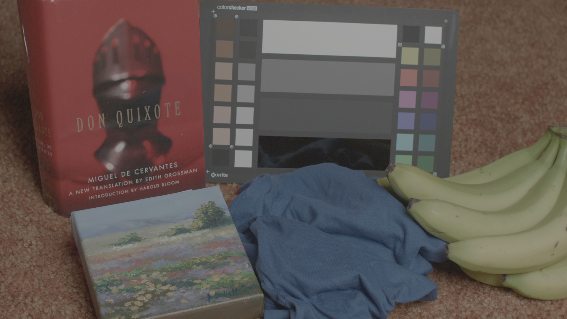

Sage Posted July 23, 2018 Author Share Posted July 23, 2018 @tihon84 David just sent these for you: (Won't need the Premiere Pre, already baked in) Quote Link to comment Share on other sites More sharing options...
Wild Ranger Posted July 23, 2018 Share Posted July 23, 2018 6 hours ago, Sage said: I think it looks great! And you shoot under the most challenging light conditions (would love to see that in VLog with a halogen bulb if you've got one on hand, just for kicks) Can you post the VLog stills? I think the black level is good. For interiors/nights, blacks are best between 1-3 IRE (but never at 0 or below!) Hi sage, I shot all in CineD, i don't use vlog for a convenience matter. But i can share you raw stills of these clips. If you what i can try shot something in tungsten lights for test and share it here. Quote Link to comment Share on other sites More sharing options...
Sage Posted July 23, 2018 Author Share Posted July 23, 2018 6 hours ago, Wild Ranger said: Hi sage, I shot all in CineD, i don't use vlog for a convenience matter. But i can share you raw stills of these clips. If you what i can try shot something in tungsten lights for test and share it here. Sure! And that will help when I revisit Cine-D (I like to collect in-the-field images from everyone to act as a north star, they become part of the reference set) And if you have true filament tungsten (i.e. halogen, rather than led/flo), that test would be great (in true VLog) deezid 1 Quote Link to comment Share on other sites More sharing options...

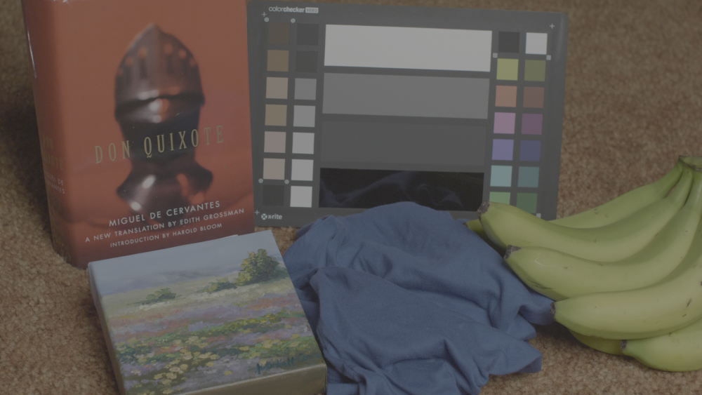

Sage Posted July 23, 2018 Author Share Posted July 23, 2018 Emotive Color "Verde" V2.2 Release EC Component: Saturation Target Revision L'Abbée 709 Hue Lock-In Soft and Pop Luma Revision Core LogC: Multipass Refinement Technique (Maximal Accuracy; for example, accurate Tungsten far red) New Smoothing Pass Fixed Red Highlight Artifact (Bright Red Traffic Lights Hyper-Saturation) Additional Notes: OLPF settings have been revised to take into account the larger sensor area of modern 3.2k/LF Alexas and real world GH5 footage testing Added guidance for optimal DaVinci Resolve luma grading tools; In the Color Wheels section, use the more organic Shadows/Highlights (under Tab 2) instead of LIft/Gain, which allow crushing of detail to 0 and 100 IRE, respectively. Contrast/Pivot (Tab 1) and the Gamma slider are safe tools (see attached Color Wheels image) Like in Premiere, the Resolve Luma curve also distorts hue. To address this (when using it for more than black level placement as in Pdf, i.e. 'curvy'), you can qualify the Luma curve node with a Layer Mixer *set to 'Hue' composite mode*, and an empty node ('hue passthrough') routed to the bottom slot of the Layer Mixer (Thanks to David L'Abbée for this discovery) Firecrest Full Spectrum NDs recommended for reference performance (better for GHa than IRNDs, such as Hoya Pro) PDF updated to reflect changes (Pages 3, 8, 9, and 10) Raw Footage Side-by-Sides updated to reflect Verde, with 16 bit Tif Stills Only versions added (much smaller download) All-I (2K or 4K) VLog recommended; Sunlight & Halogen recommended as reference light sources (for respective conversions) Raw v2.2 Video: (No color grading, black level placement, or post WB correction [Sunny WB preset in cam for day shots]; only the Main conversion directly on VLog) *For Color Accuracy - Please watch in Microsoft Edge, Explorer, Safari, Chrome with the sRGB Dev fix, or Chrome (Mac Edition) - *Avoid Firefox! (Or download 'Original' file on Vimeo for total fidelity) Best Resolve Luma Tools Quote Link to comment Share on other sites More sharing options...

Sage Posted July 23, 2018 Author Share Posted July 23, 2018 53 minutes ago, kidzrevil said: Can’t you do this conversion with davinci resolves color management in floating point precision ? A lut wouldn’t be nearly as accurate as it needs to be to convert to Alexa’s color science. LUTs are hardcoded by nature. Looks nice though Hey there! Just getting back from lunch. Resolve's color space conversion (and the other Lut color space calculators) do a conversion between the known parameters of the color spaces (in this case VLog to LogC). What this conversion does is incorporate all that comprises a color science output, by measuring the end result of each with ~25K color samples under a given light source, and interpolates between them with a color engine I wrote Until the start of 2017, I felt exactly the same way. This thought experiment kept coming back to me over the years; if I shoot a scene under a given light source with a given camera, and then come back days later and shoot that same scene with that same camera, will the image differ? The revelation was that, it would be the same! It sounds silly, but this fundamental static color response revelation is what opened the door of possibility in my mind *Here are some raw footage Side-by-Sides to play around with Alexa LogC GHa LogC (v2.2) Original VLog Quote Link to comment Share on other sites More sharing options...

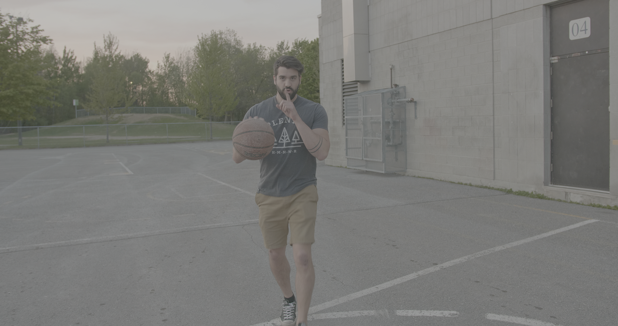

Wild Ranger Posted July 23, 2018 Share Posted July 23, 2018 6 hours ago, Sage said: Sure! And that will help when I revisit Cine-D (I like to collect in-the-field images from everyone to act as a north star, they become part of the reference set) And if you have true filament tungsten (i.e. halogen, rather than led/flo), that test would be great (in true VLog) Here are the stills in Cine-D. These are shot with Daylight balanced leds (around 5500K with a little shift of +3 to magenta). I have some tungsten bulbs around, I will share some stills with them as soon as I can make a test. Sage 1 Quote Link to comment Share on other sites More sharing options...

Sage Posted July 23, 2018 Author Share Posted July 23, 2018 @Wild Ranger What do you think of this? Wild Ranger, JeremyDulac and deezid 3 Quote Link to comment Share on other sites More sharing options...
Wild Ranger Posted July 23, 2018 Share Posted July 23, 2018 @Sage Like it! it's so under exposed and warm that reminds me The Godfather. Nice! Sage 1 Quote Link to comment Share on other sites More sharing options...
