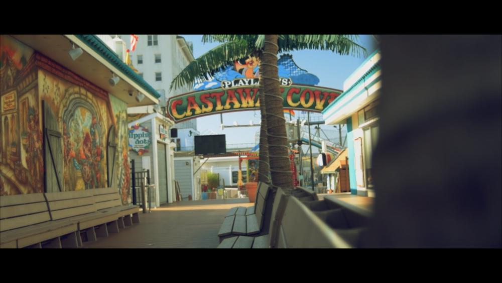

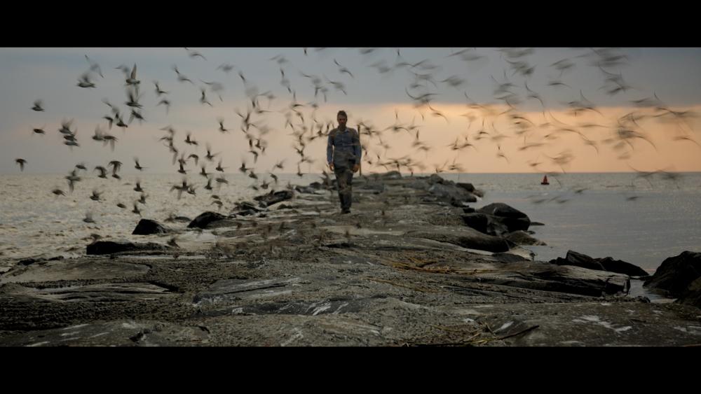

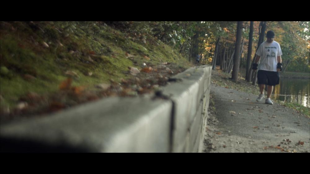

@maxotics idk man im just not seeing the problems you have experienced with LOG profiles shooting SLOG3. The crushed shadows were a stylistic choice but I will grade the image again. If you look at the clips under a waveform and vectorscope you will see that nothing is blown out. I made sure to expose below the clipping point to prevent any kind of overexposure.
I chose to shoot this in LOG over REC709 for multiple reasons. 1) you are shooting at the native iso and also rate the ISO slower by over exposing. 3 stops overexposed at 800 iso is an image equivalent to one shot at 100iso 2) the cameras dynamic range doesn’t chance with any picture profile only the gain does. You will always get a better signal to noise ratio over a rec709 who’s noise floor is hidden in the shadows and will quickly appear when raising them in post. 3) sgamut3.cine works better with color than standard rec709 profiles because of how it handles saturation. After around 40 ire I believe colors don’t get more saturated they just get brighter like film. That color science is not present in any other profile. 4) Im not having the issue with loss of color data or banding because I raise the in camera saturation. SLOG3 white papers suggest to raise in camera saturation to emulate printed film. In post it preserves more color information. The SLOG3 & cineon white papers both state they were made to support 8,10 & 12 bit data so the 8bit argument when shooting log is null and void. Expose up to assign the higher code values of the codec to the image and you are fine.
So in my experience there are significant gain in using LOG profiles over REC709 under the right lighting conditions. I will regrade this to look flatter.

I have never experienced the banding problem. Do you see it present in my footage ? Im not sure if I missed it but I didn’t see ang banding when I shot or graded this

Absolutely right. There is no exposure trick to get more color depth and this is why you raise the in camera saturation. Increasing the saturation holds onto more color information. SGAMUT3 is large enough to support this extra color info without blowing out a color channel. You can desaturate in post

I don't see what you gain using them in those shots because you crushed the contrast so heavily you even removed the noise inherent in the higher ISO the camera uses to achieve a LOG distribution of visual data.
And that is the point. There is no noise inherent in the final image which = better compression. Also it is almost physically impossible to have noise in the image if the sensor is getting a signal with an exposure 2 to 3 stops over. All the shadow data is assigned to a code value in the upper range of the histogram above 40% ire where noise isn’t present before grading which also results in better compression especially since h.264 destroys details stored in the lower ire levels. Data people often try to raise in post shooting standard rec709. Also with rec709 profiles/linear curves a massive amount of data is distributed to the highlights and its another reason macroblocking and stuff occur in the lower range of the image with far less data assigned to the lower stops.
Waveform doesn't show color depth.  I'm not arguing exposure one way or another.
Are you trying to shock me or get a laugh?  I'm not sure you understand ISO correctly.  The core idea of ISO is to tell the photographer/videographer the amount of light that will provide the most accurate, color saturated image without any digital amplification (gain).  Anything above base ISO (usually 100) is up to the manufacturer to determine because there is no accepted industry measurement of noise expectations for higher ISOs. So not sure how to respond here.

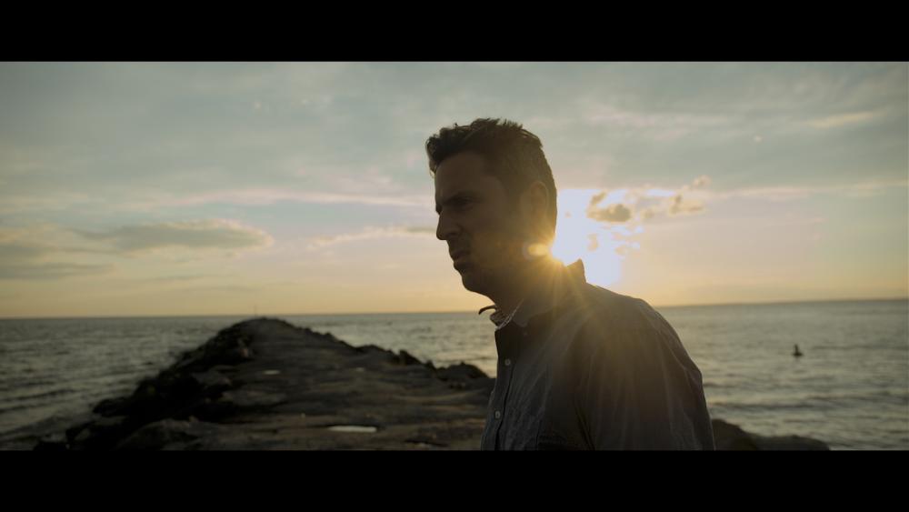

@maxotics now you’re understanding me. In the original post I mentioned sacrificing the highlight headroom for better noise performance and shadow detail and that is the trade off. That is very much in line with pull processing an image and is exactly what I did here. This is no free lunch and I apologize if I alluded to that but in the original post I mentioned what you do lose and what you gain from my method of exposing the image for post production.
edit : also keep in mind that I included her in the test to showcase how skintones are handled when shooting in the overexposure range. She falls under a 1.5-3stop overexposure in these scenes
