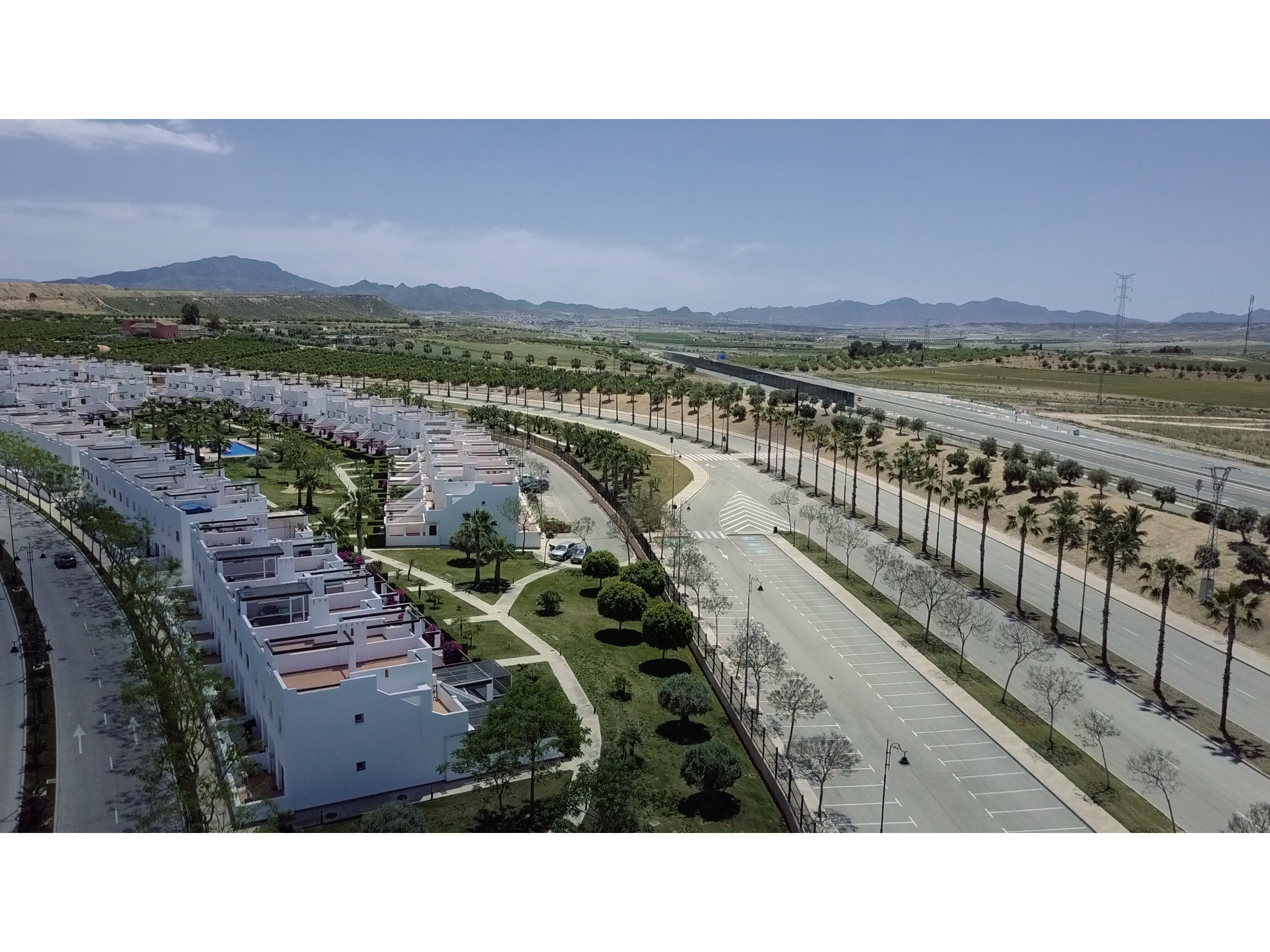

Alright, so the mavic is the perfect size for what I film, but the footage looks so bad. It's aliased and over sharpened. I am just trying to get something decent with it. Does anyone have any good results to share?

I have been trying different apps, different settings. Mostly in our tests, we found that we had to be at +1 sharpening or all of the details would get muddied in the shadows. The problem is that with a sharpening this high there is tons of aliasing. Not sure if you can see it in the YT clip, but it's really really bad.
These clips are D-Cinelike +1 -3 -1
