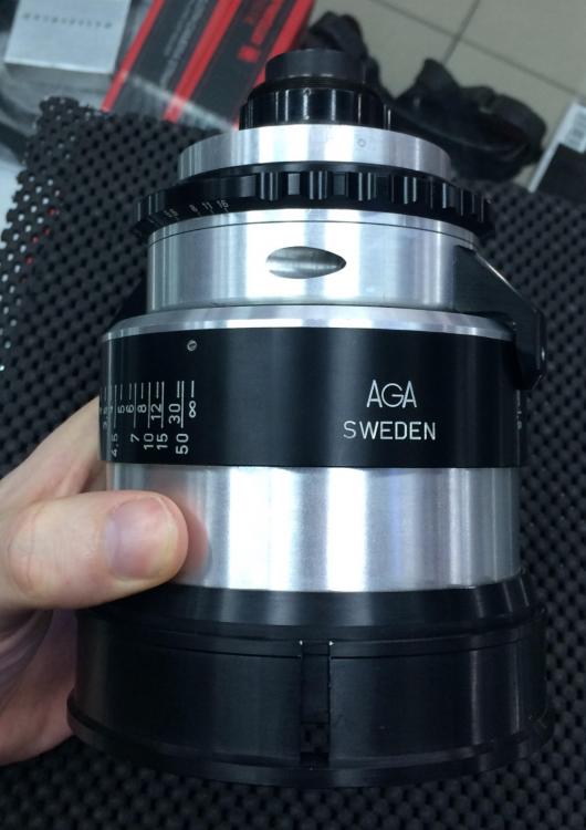

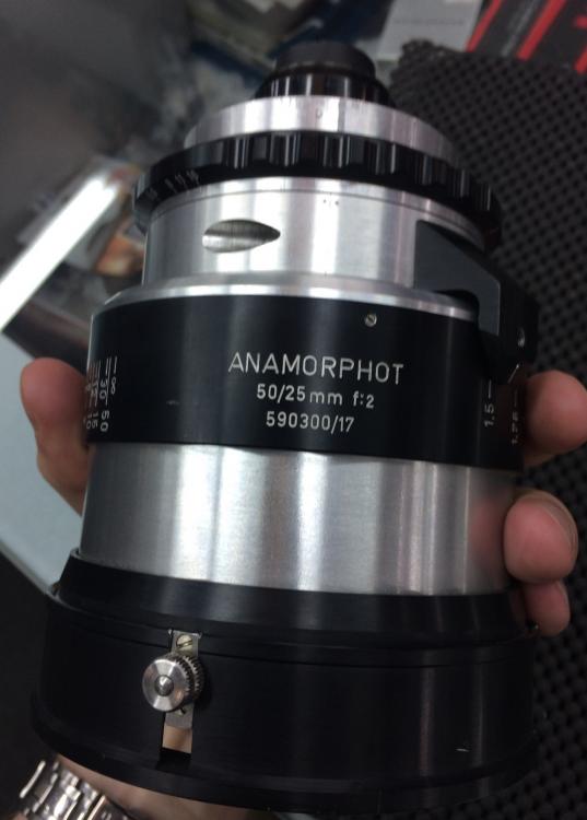

Ric Posted February 26, 2017 Share Posted February 26, 2017 I came across this lens in a local camera store - AGA 50mm anamorphic, but there's very little available online about them. The owner didn't have a price, but suspected it was valuable - is anyone familiar with these lenses? What should I offer? Is this going to be similar to the old LOMOs? Link to comment Share on other sites More sharing options...

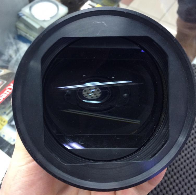

Justin Bacle Posted February 26, 2017 Share Posted February 26, 2017 Nice finding, the question is : will it cover S35/FF ? If so the price can be high yes ! If it only covers S16 not that many people will be interested. This does looks nice indeed, I curious to know if it is a rehousing a unique optical design. Can you try and take a picture with it ? Link to comment Share on other sites More sharing options...
Blah Blah Posted February 26, 2017 Share Posted February 26, 2017 That looks like a high quality pro lense. Link to comment Share on other sites More sharing options...
Julien416 Posted February 26, 2017 Share Posted February 26, 2017 Hi, It's obviously a cine lens. From the pictures, at first i thought it could be one of those anamorphic add ons you had to put in front of old cine primes in the 50's. You had so synchronize both lens to focus with some long lost mechanical gear. But because the lens seems to have an aperture ring, I guess it's a prime anamorphic lens from the 60's. Looking at the size of it, it may well be a 35mm film lens. As for the mount, i have absolutely no idea, . Not much info on Agascope on internet. But they're supposed to be good lenses with nice anamorphic characteristics (and blue flares). Probably worth a few quids if in good shape and depending on the camera mount. Link to comment Share on other sites More sharing options...

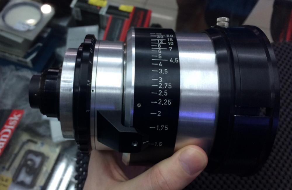

webrunner5 Posted February 26, 2017 Share Posted February 26, 2017 That is one impressive lens. How about a picture of the mount. What kind is it. Screw mount, PL? Link to comment Share on other sites More sharing options...
Bioskop.Inc Posted February 26, 2017 Share Posted February 26, 2017 The only thing that i could find via google (gotta sometimes look past the first page or two!) was this post from cinematography.com. It does offer a suggestion to which mount it might be (BNCR-mount or DeBrie - never heard of them). http://www.cinematography.com/index.php?showtopic=2539 Did find mention of Agascope in another article in Swedish, but once translated it didn't offer any technical details just who used the lenses. Link to comment Share on other sites More sharing options...
Timotheus Posted February 26, 2017 Share Posted February 26, 2017 Sure looks like a pro optic! Try to take some pictures of the mount, as it looks rather small for larger sensor coverage...perhaps someone here can identify it. But then you might get the issue of adapting. It would get even more interesting if the anamorphic block could be separated from the spherical lens. Link to comment Share on other sites More sharing options...

BrooklynDan Posted February 27, 2017 Share Posted February 27, 2017 It is an AgaScope lens. It was built by a Swedish industrial firm during the widescreen craze of the late 50s/early 60s. It was mainly used in Sweden, although some sets made it to Eastern Europe. The set was fairly sparse and included a 46mm and a 75mm. There weren't any zooms or wide focal lengths available, so the modern day appeal of these lenses is limited. Quality should be on par with other early anamorphic systems of continental Europe like Dyaliscope or Totalvision. Timotheus, webrunner5 and Justin Bacle 3 Link to comment Share on other sites More sharing options...
Justin Bacle Posted February 27, 2017 Share Posted February 27, 2017 5 hours ago, BrooklynDan said: It is an AgaScope lens. It was built by a Swedish industrial firm during the widescreen craze of the late 50s/early 60s. It was mainly used in Sweden, although some sets made it to Eastern Europe. The set was fairly sparse and included a 46mm and a 75mm. There weren't any zooms or wide focal lengths available, so the modern day appeal of these lenses is limited. Quality should be on par with other early anamorphic systems of continental Europe like Dyaliscope or Totalvision. Great information Thank you so much ! Link to comment Share on other sites More sharing options...
Ric Posted February 27, 2017 Author Share Posted February 27, 2017 Thanks for all your replies! I went back to the store and they're quoting $8-9k for the lens... way out of my price range! Shame. Seems to be in very good condition. Link to comment Share on other sites More sharing options...
BrooklynDan Posted February 27, 2017 Share Posted February 27, 2017 1 hour ago, Ric said: Thanks for all your replies! I went back to the store and they're quoting $8-9k for the lens... way out of my price range! Shame. Seems to be in very good condition. In theory, it is worth that price because it is a professional-grade anamorphic prime lens, and similar lenses from Lomo and others have been going for about $8k. However, I think the value of this lens should take a hit because it is, of course, a one-off. The chances of building a complete Agascope set are slim to none, So that makes this lens a curiosity, rather than a functional cinema lens, and it should be priced as such. I would put it at $4-5k. Justin Bacle 1 Link to comment Share on other sites More sharing options...
webrunner5 Posted February 27, 2017 Share Posted February 27, 2017 Well without a modern mount on it I would consider it a Paperweight to be honest! LoL. God knows if there is anyone left alive that even knows how to adapt it to a modern mount. Risky buy. Too bad. Link to comment Share on other sites More sharing options...

perarnes Posted February 16, 2020 Share Posted February 16, 2020 I have shoot severeal feature films with the Agascope lenses back in the eigthies. The most famous one was "Ninja Mission" in 1984. Today a cult movie. I used all four of them with the Debrie mount on Arriflex IIC cameras. These lenses are NOT old soft lenses. They are supersharp with good contrast. Fantastic lenses! In the fifties and sixties you could only rent them. AGA never sold any lenses so lenses on the market was probably stolen. I think that the above one is a prototype as I have never seen or heard of a 50mm Agascope. The lens was made in 1959, at the end of the Agascope production era. They came in 46, 75, 105 and 210mm. I don´t think there are any problem rehousing these lenses today. Juank and Ian Edward Weir 2 Link to comment Share on other sites More sharing options...
BrooklynDan Posted February 24, 2020 Share Posted February 24, 2020 On 2/16/2020 at 2:13 PM, perarnes said: I have shoot severeal feature films with the Agascope lenses back in the eigthies. The most famous one was "Ninja Mission" in 1984. Today a cult movie. I used all four of them with the Debrie mount on Arriflex IIC cameras. These lenses are NOT old soft lenses. They are supersharp with good contrast. Fantastic lenses! In the fifties and sixties you could only rent them. AGA never sold any lenses so lenses on the market was probably stolen. I think that the above one is a prototype as I have never seen or heard of a 50mm Agascope. The lens was made in 1959, at the end of the Agascope production era. They came in 46, 75, 105 and 210mm. I don´t think there are any problem rehousing these lenses today. Wonderful information! Do you happen to have any additional pictures of the lenses, or any trade materials? Possibly a good guess as to where the lenses wound up? Link to comment Share on other sites More sharing options...

Martin Rodensjo Posted July 29, 2023 Share Posted July 29, 2023 Hi all. I have serviced and modified three of these lenses (not the 210mm version) and they are indeed very sharp and contrasty but only after servicing and realigning all anamorphic elements. Great lenses and quite rare. Fantastic build quality. Im pretty sure they cover FF. Leon Postma 1 Link to comment Share on other sites More sharing options...
