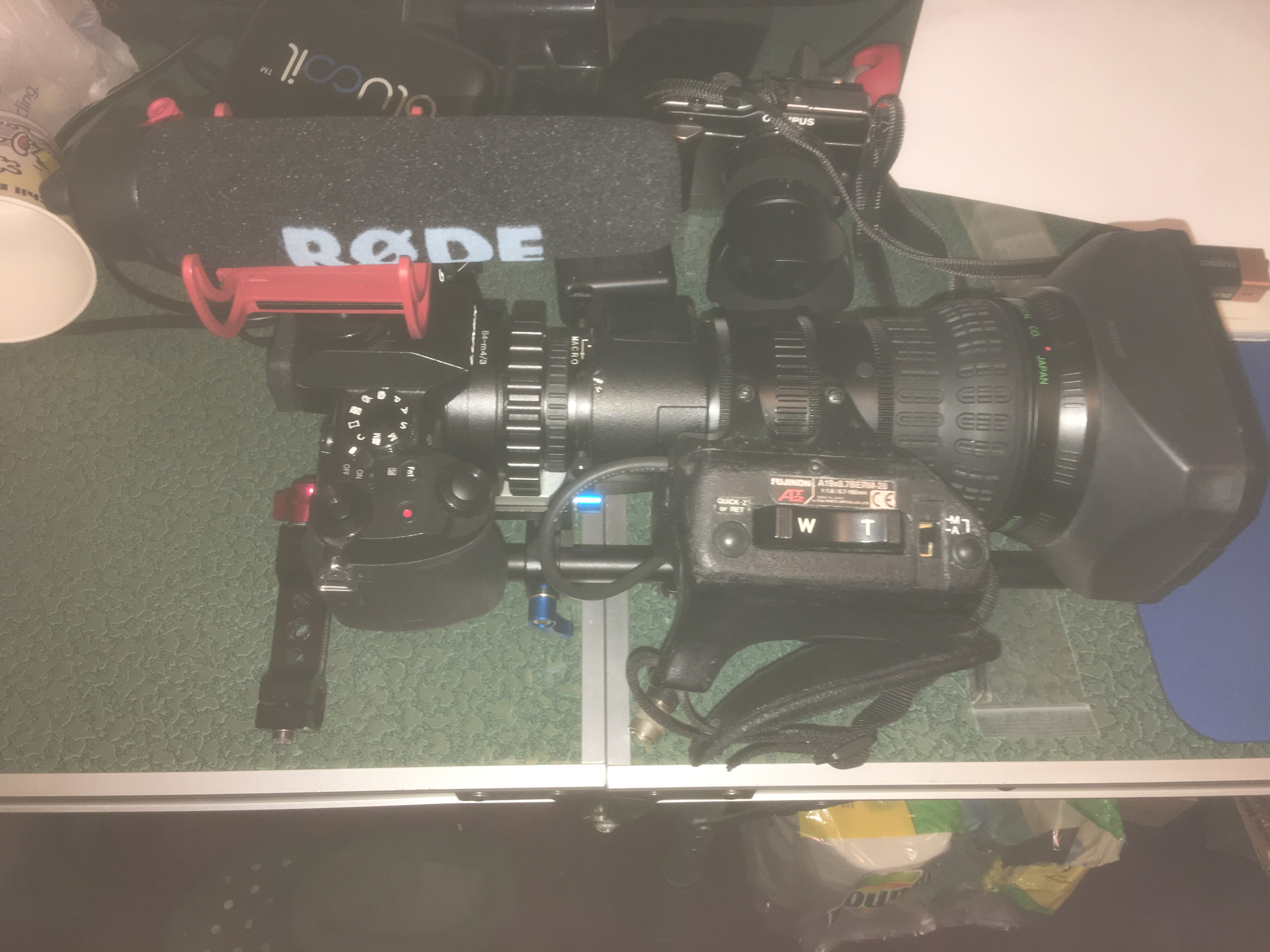

webrunner5 Posted December 20, 2016 Share Posted December 20, 2016 6 hours ago, mercer said: He uses a hot shoe handle on his gx80 and with his new implementation of the Sigma 18-35mm and metabones adapter, Jase is afraid the hot shoe may break due to the load. Ahh now I see. I have the same problem I am facing with my Panasonic G7 rig. I am going to buy a Zacuto Half Cage, with their handle. Big bucks to buy, but beats dropping my rig. Â Blury picture and all! Link to comment Share on other sites More sharing options...

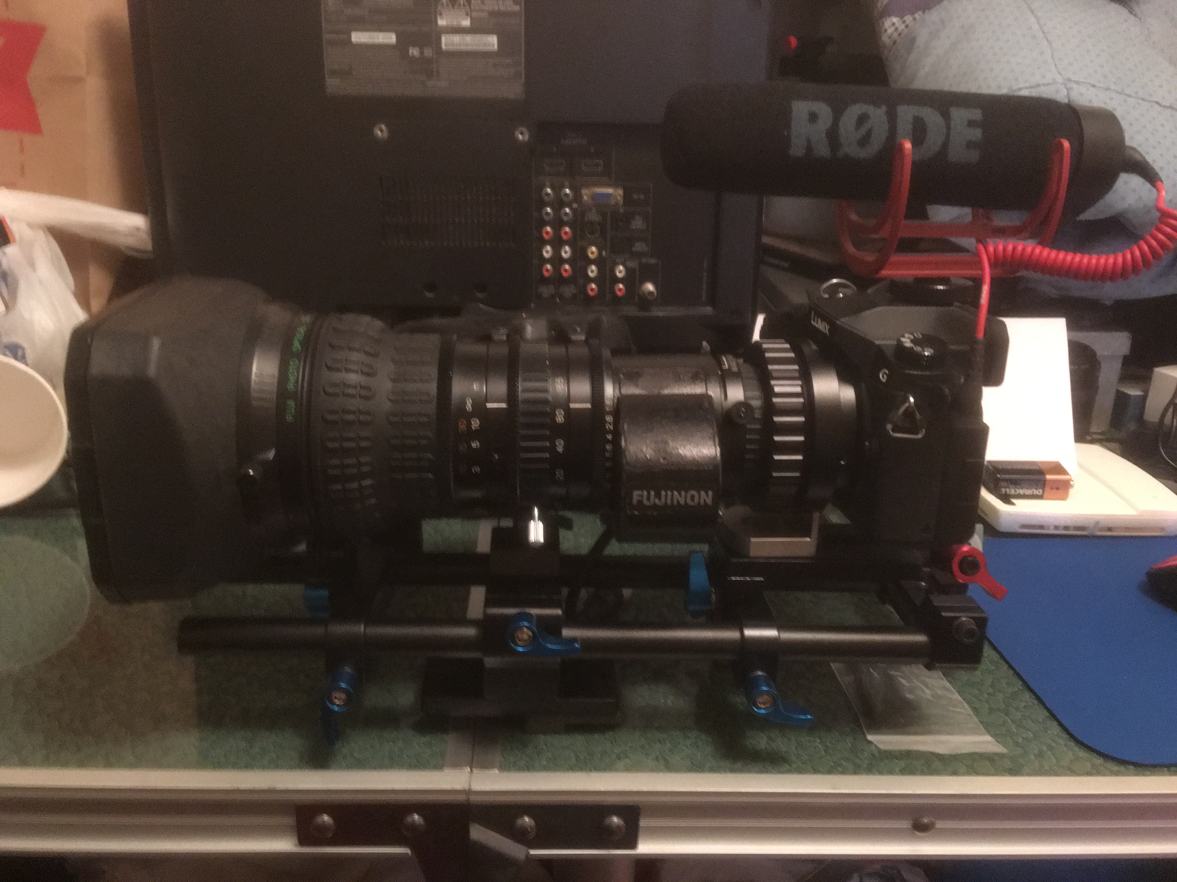

webrunner5 Posted December 20, 2016 Share Posted December 20, 2016 A bit clearer! iPhone picture not in the best of circumstances. mercer 1 Link to comment Share on other sites More sharing options...
mercer Posted December 20, 2016 Share Posted December 20, 2016 7 minutes ago, webrunner5 said: A bit clearer! iPhone picture not in the best of circumstances. Dang, that is some lens. Link to comment Share on other sites More sharing options...
webrunner5 Posted December 20, 2016 Share Posted December 20, 2016 Yeah that is a Fujinon ENG 2/3" f1.8 19x 8.7-165mm lens with a 2x built in doubler in it. They are refered to as a B4 lens. And it does cover a M4/3 sensor with the doubler engaged. So you end up on a M4/3 camera with figuring in the 2x doubler on the lens and the 2x crop factor of M/4/3 lenses, it is about a constant F3.6 parafocal 35.7mm- 660mm. And I payed $150.00 for it. So they a pretty impossible to beat. That lens cost over $10,000.00 when it was new 20 years ago! And they have a built in zoom servo on them, and has Macro focusing too boot! Adept 1 Link to comment Share on other sites More sharing options...
