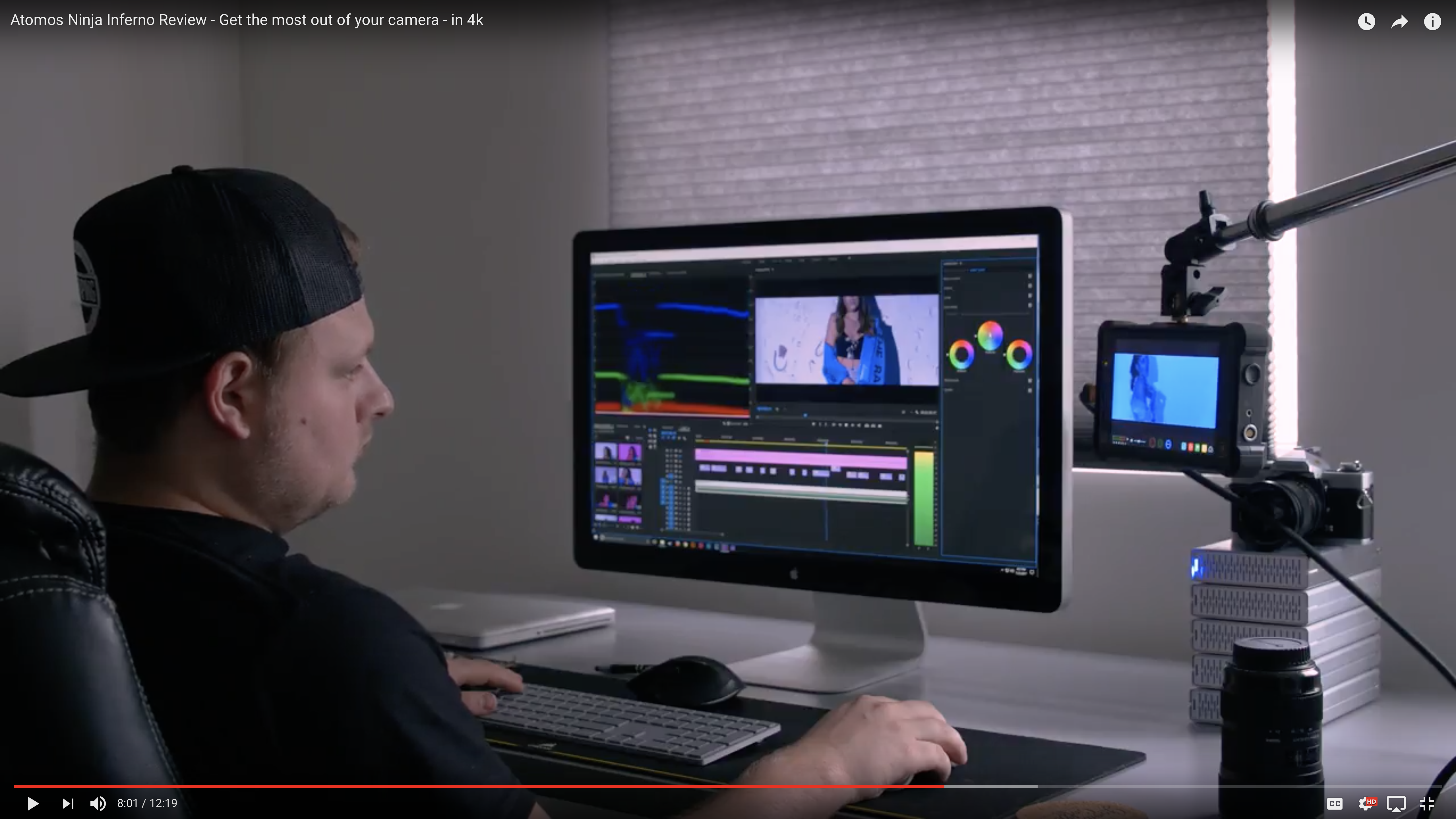

Now that Atomos is becoming available in Vietnam at last (yay!), I might invest in the Ninja Inferno and give HLG rec. 2020 a shot - even though I'm not working for the BBC, I don't have a Panasonic TV, I can't tell 4K from 1080p and I'm not even sure I'd recognize HDR unless it was shown alongside SDR... The Inferno should arrive on these shores just about the same time that Apple releases Final Cut Pro version 10.4. Anyhow, even for those who, correctly or not, consider HDR just a marketing gimmick, my advice at this point in the game would still be to invest in the very best television set you can afford, because even SDR content looks a gazillion times more awesome on one of the newer flat screens than on any small desktop or laptop.
Edit: I guess I'll throw in one more word, and that is that, regardless of whether you think focusing with the GH5 or other mirrorless is good enough just using the built in LCD screen, I'd strongly encourage picking up a 5" monitor for precise focusing. Especially when shooting flat profiles like V-Log, HLG or even Cinelike D, with sharpening and saturation dialed down, I often can't see focus peaking. With an external monitor, I can distinguish whether the camera's focused on the subject's glasses, their hair, their cheeks or their eyes, something that was next to impossible to do with the LCD.
