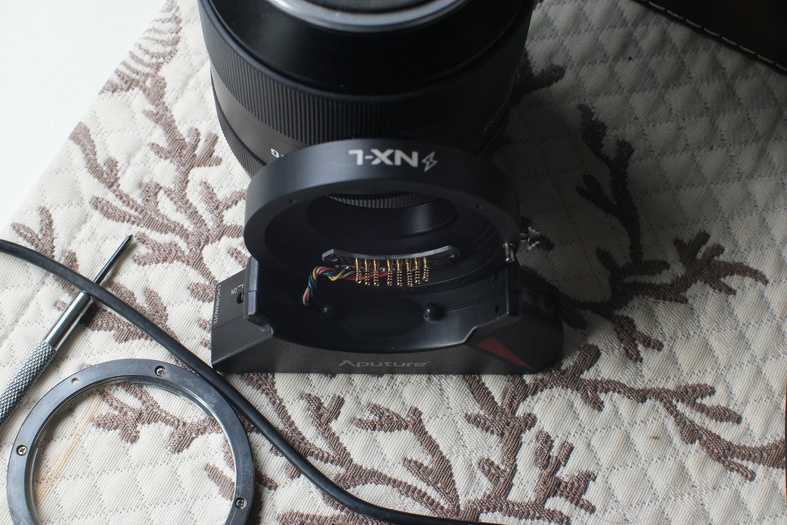

lucabutera Posted February 8, 2017 Author Share Posted February 8, 2017 1 hour ago, IKSLIM said: Dear Luca, how many sponsors do you consider with current NXL-funding? Today you have 10 sponsors and 20 days due. I appreciate your comment on max number of Sponsors and NXL-Items you are considering to create. Thanks. Hello Ikslim, I build them in sets of 10 pieces at a time. Next week I will send the first 10 already sold, for the next production will have to wait a month, but it will have some constructive improvements and also the predisposition for electrical controls. Best Luca Kisaha and Marco Tecno 2 Link to comment Share on other sites More sharing options...
IKSLIM Posted February 9, 2017 Share Posted February 9, 2017 19 hours ago, lucabutera said: Next week I will send the first 10 already sold, Luca Do you mean the very first sold from September? How many items you've created and sent already? Please, you have to understand us, we are investing without any guarantee and obligations. Link to comment Share on other sites More sharing options...
ttbek Posted February 9, 2017 Share Posted February 9, 2017 21 hours ago, lucabutera said: Hello Ikslim, I build them in sets of 10 pieces at a time. Next week I will send the first 10 already sold, for the next production will have to wait a month, but it will have some constructive improvements and also the predisposition for electrical controls. Best Luca Hey Luca, you've sabotaged yourself :P I'm holding out for the electronics now that I know they're coming. Even if there isn't AF working yet, at least so I can attach my chip in between without trying to machine my own holes or something. You've probably leapfrogged me by a lot on the electronic control, but if there's anything I can do to help let me know. Link to comment Share on other sites More sharing options...
lucabutera Posted February 9, 2017 Author Share Posted February 9, 2017 2 hours ago, IKSLIM said: Do you mean the very first sold from September? How many items you've created and sent already? Please, you have to understand us, we are investing without any guarantee and obligations. No. I've sent all NXL sold in 2016. In approximately one week, I will ship the first eleven sold in 2017. Best Link to comment Share on other sites More sharing options...
lucabutera Posted February 9, 2017 Author Share Posted February 9, 2017 1 hour ago, ttbek said: Hey Luca, you've sabotaged yourself :P I'm holding out for the electronics now that I know they're coming. Even if there isn't AF working yet, at least so I can attach my chip in between without trying to machine my own holes or something. You've probably leapfrogged me by a lot on the electronic control, but if there's anything I can do to help let me know. Hello ttbek, how are you? You must keep up to date, if you come on the forum every month you will always find new surprises. The next series will predisposition of electrical contacts. I will make a version NXL mute and a version with electronic controls. Currently, for practical reasons, it is being tested, the Aputure Dec control that allows: 1) iris control Canon lenses; 2) Stabilizer Canon lenses; 3) WiFi Control focus; 4) recording 2 subjects for quick changes of focus. Currently I started the study of a smart autofocus system, but this will take a little time. How can you help me? Been programming? You want to finance my project? Or both? P.S. If you ship me the NXL I can update it for telephoto compatibility. Kisaha and Marco Tecno 2 Link to comment Share on other sites More sharing options...
