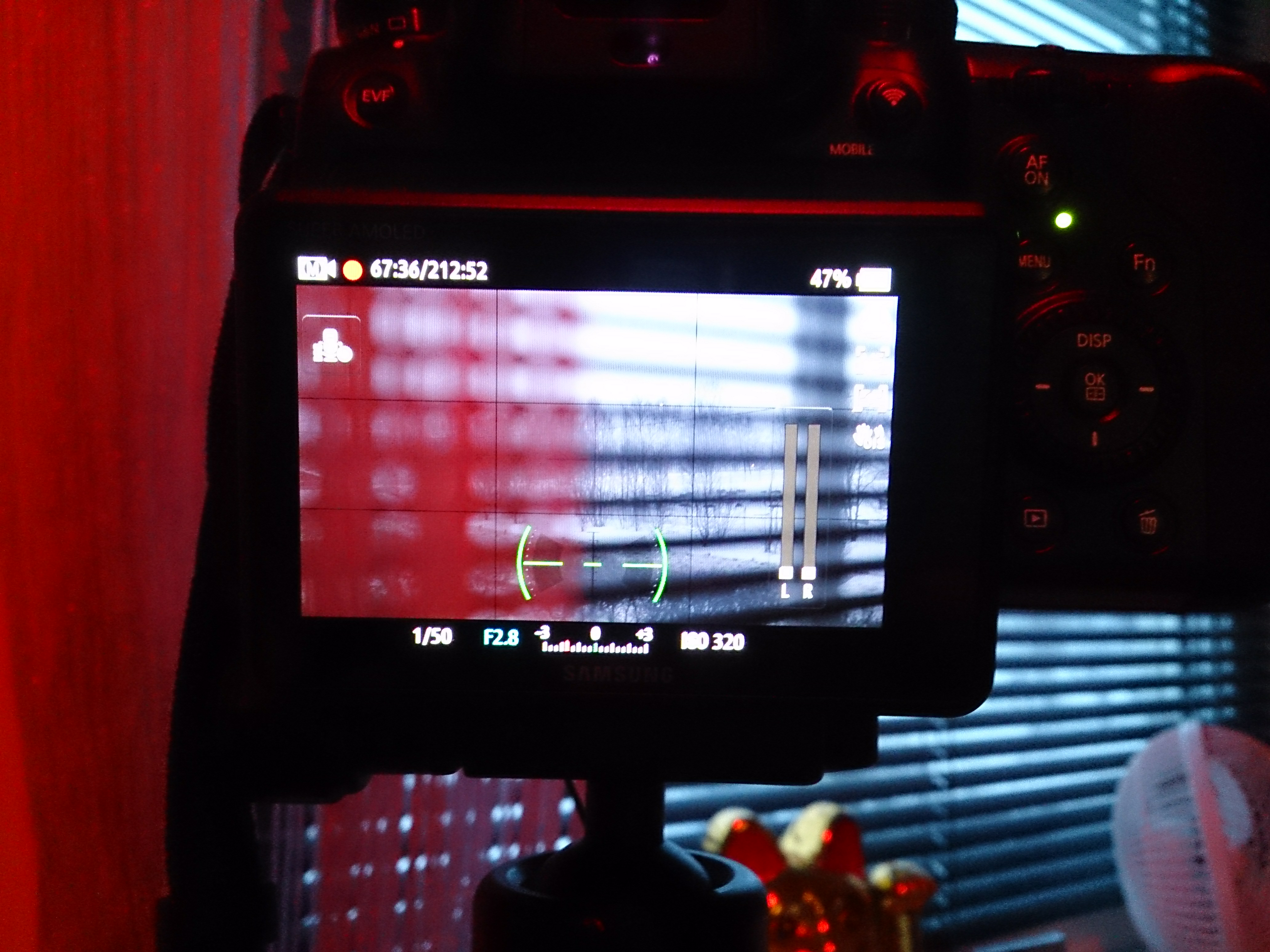

SMGJohn Posted March 16, 2016 Share Posted March 16, 2016 I tried recording with the record limit off, some strange results to say at least. I noticed it goes to one hour just fine even when the battery runs out it saves the file before it shuts down. But once it hits 73 - 75 minutes it stops recording, the camera goes into power saving mode right off the bat, and I monitor the camera. I did the test 6 times while having pauses in between to let the camera cool down, but two times did it hit 73 - 75 minute mark and it stops recording and goes to power saving mode. The file size is always 43GB but the file is corrupted and cannot be read at all. My setup was: 2160p25 UHD mode PAL SDXC Lexar 128GB 400x Class 1 UHS-I (exFat obviously) At first I thought it was overheating but it would do another 40 minute with no issues right after the 73 - 75 minute file failed and it did 40 minutes extra until the battery went flat. And I did constantly touch the camera to feel how hot it was simply because I did not have any sort of instruments to measure heat at the moment on me. It was all miles away for now. Can anyone confirm the same results? The exFat maximum file size is 16EB so something odd is going on, either the memory card causing it, I am going to do another test with Samsung's SDXC 64GB Class 10 UHS-I card to see if I get different results, funny enough the maximum record time is calculated automatically by the camera, 212 minutes on 128GB and much less on 64GB Link to comment Share on other sites More sharing options...

Pavel Mašek Posted March 16, 2016 Share Posted March 16, 2016 1 hour ago, SMGJohn said: I tried recording with the record limit off, some strange results to say at least. I noticed it goes to one hour just fine even when the battery runs out it saves the file before it shuts down. But once it hits 73 - 75 minutes it stops recording, the camera goes into power saving mode right off the bat, and I monitor the camera. I did the test 6 times while having pauses in between to let the camera cool down, but two times did it hit 73 - 75 minute mark and it stops recording and goes to power saving mode. The file size is always 43GB but the file is corrupted and cannot be read at all. Maybe try to check also DISABLE POWER SAVE in DEV menu (?) Link to comment Share on other sites More sharing options...
