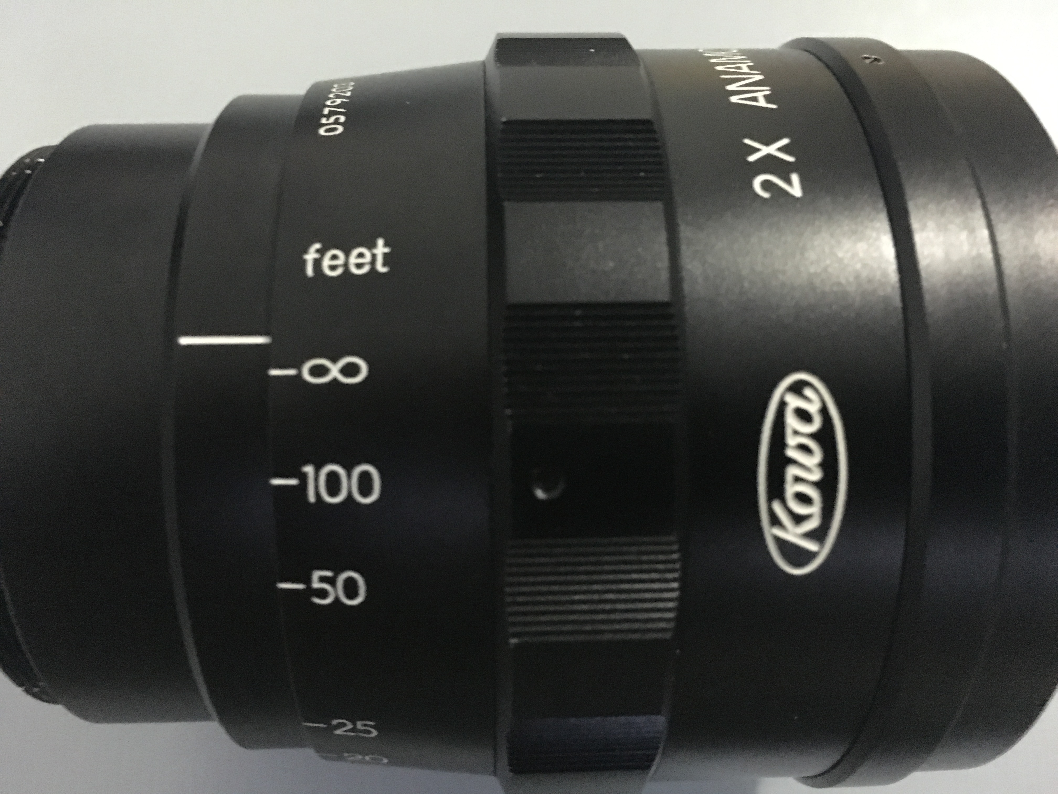

Visual Amco Posted October 12, 2015 Share Posted October 12, 2015 Hey,Good job! I am a afraid of ruining my kowa bell and howell with this. I would like to check the sharpness mod. But how do you know it is at it sharpest point?(do you mount it onto a camera and turn it until it the most sharp on camera?) Or is there a good trick for this? Also do you need to remove the brass tabs before turning? (I did not get that part, a howto video would be awesome )Cheers Link to comment Share on other sites More sharing options...
Hans Punk Posted October 12, 2015 Author Share Posted October 12, 2015 It's ok to be afraid!...it is a mod that is probably not worth attempting for most anyway.I would not recommend anyone to mess with or dismantle ANY lens unless they were very sure how to put it back together - or had a lens in such a bad condition there would be little to lose if it all went wrong. Like I said in opening post, I had a Kowa that I could afford to mess with...so I had nothing to lose. As for the sharpening/alignment tweaks, yes - it is best to unscrew/remove all brass tabs first, freehand focus front Kowa assembly at an object at infinity focus whilst at maximum zoom on evf or monitor...tweak rotation until sharpest image is reached, then look at the screw holes left by the removed brass tabs, if they are not perfectly central to the new position you have set, it indicates that re-seating the tabs into the new position would increase sharpness.From my limited experience, 3 Kowa B&H's out of the 4 that I've owned have benefited from this modification, so it's completely possible a few owners out there already have a perfectly aligned lens. Link to comment Share on other sites More sharing options...

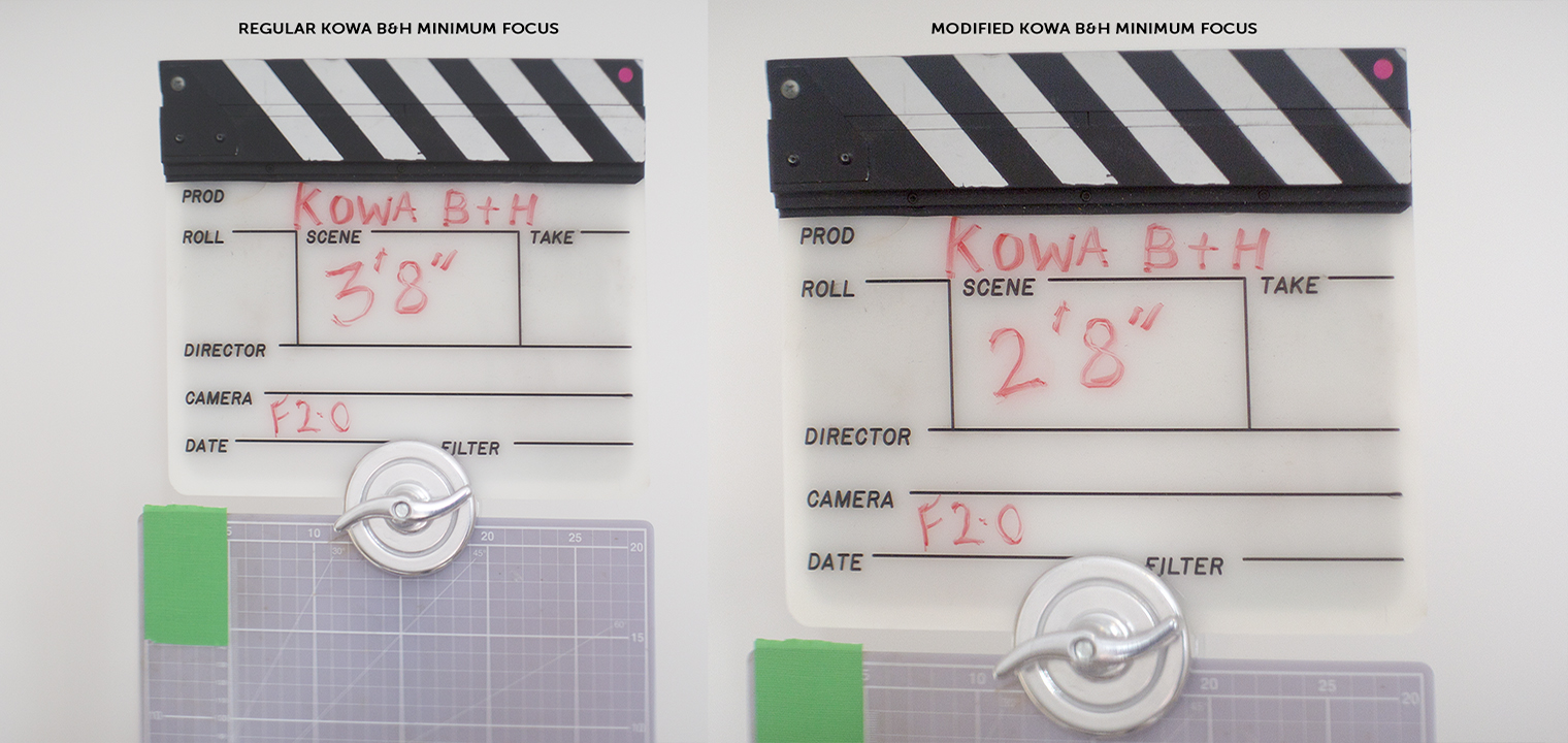

Hans Punk Posted October 12, 2015 Author Share Posted October 12, 2015 Here is a quick example shot to help explain how much minimum focus can be squeezed from just shortening the brass tabs.Seems like I underestimated the normal minimum focus distance of regular Kowa B&H. Modification basically allows a foot closer to be obtained (not a massive amount but the visual jump is impressive). Modded min focus is 2 feet 8 inches which is around the close focus distance that a Tokina +0.4 will give you on an unmodified Kowa. But the cool thing is that if you add Tokina on the modified Kowa, you get exactly 2 feet minimum focus (from front optic). Bold 1 Link to comment Share on other sites More sharing options...
enny Posted October 12, 2015 Share Posted October 12, 2015 I think its worth doing this going from 5 ft to 3 ft i am just below 3 ft my self. and its not a big complex modification bras are still there alignment is still there its just you cut the bras shorter and you gain more. I wanted to get tokina go get down to 2 to 3 ft. But i now have no really need for tokina now and save 600$ Jim Chang, Hans Punk and Bold 3 Link to comment Share on other sites More sharing options...

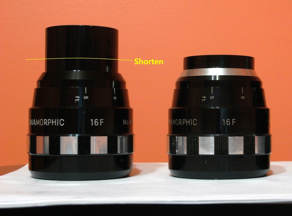

ken Posted October 12, 2015 Share Posted October 12, 2015 I am pretty sure, closer focus distance would make less ratio in my experience until I got a D.O. 16F ana lens.D.O. lens actually is a shortened lens from Sankor/Singer/Eiki 16F. Make the the 2x lens become about 1.6x when focus in minimum distance. So the D.O. lens can focus to closer less than 1m. But it is lack of infinity ability. I just add a negative lens in front to let it is able to focus to infinity. And the advantage is that it can take wider lens, basically as wide as 16H. Hans Punk 1 Link to comment Share on other sites More sharing options...

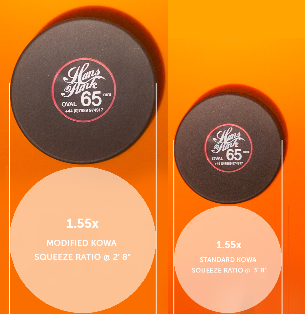

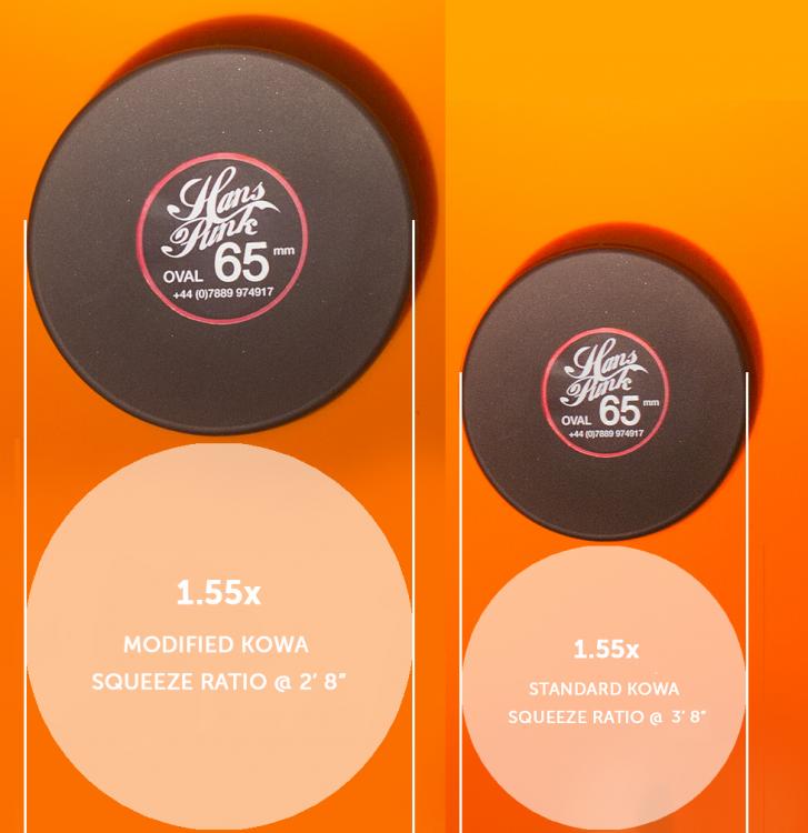

enny Posted October 12, 2015 Share Posted October 12, 2015 so what is this is actually does kowa b&h goes 2x squeeze to 1.55 when trying to focus or it stays 2x even with modification or is this for kowa 16 h so basically does kowa always stays at 2x from 3ft to infinity and in between Thanks Link to comment Share on other sites More sharing options...
Hans Punk Posted October 12, 2015 Author Share Posted October 12, 2015 All Anamorphic squeeze ratios are the measurement of image compression at infinity. The closer an object is in focus, the less the compression will appear at that object of focus. When people sometimes say 'my 2x is more like a 1.75x or my 1.75x is more like a 1.5x' - they are mostly noticing that at medium/close compositions, most lenses do not resolve the full compression value on that plane...because infinity is not usually the focal plane (unless shooting landscapes). Above picture was to demonstrate that the difference in modifying the lens results in no perceivable drop in squeeze ratio from the 'standard' Kowa optics. You can easily see the apparent squeeze value change throughout focal range in the video below (the breathing effect). Most modern cinema anamorphics have minimal breathing artefacts as a purpose refinement, therefore more consistent FOV and compression values throughout focus range, but what we are primarily talking about projection anamorphics that are usually trying to handle weird and wonderful taking lenses and imaging areas that were never intended for their design, so a variation in apparent squeeze ratio at varying distances is inevitable on a few of these 2x lens types. Link to comment Share on other sites More sharing options...
Hans Punk Posted October 12, 2015 Author Share Posted October 12, 2015 Here is a quick example shot to help explain how much minimum focus can be squeezed from just shortening the brass tabs.Seems like I underestimated the normal minimum focus distance of regular Kowa B&H. Modification basically allows a foot closer to be obtained (not a massive amount but the visual jump is impressive). Modded min focus is 2 feet 8 inches which is around the close focus distance that a Tokina +0.4 will give you on an unmodified Kowa. But the cool thing is that if you add Tokina on the modified Kowa, you get exactly 2 feet minimum focus (from front optic). Oooops, deleted my own pic from previous post so reposting here: Link to comment Share on other sites More sharing options...
Visual Amco Posted October 21, 2015 Share Posted October 21, 2015 By cutting the brass tabs do you mean Saw with a metalsaw? Or how should I do such a thing?Thanks! Link to comment Share on other sites More sharing options...
Hans Punk Posted October 21, 2015 Author Share Posted October 21, 2015 By cutting the brass tabs do you mean Saw with a metalsaw? Or how should I do such a thing?Thanks!You can make a clean cut by carefully cutting with a metal handsaw/ hacksaw, or like I did...use some needle nose pliers and snap it off! Then used a file to clean up the edge that was sheared off. Remember that when re-assembling the body, the numbered focus marks will no longer be accurate - as you would have offset that scale by allowing slightly more travel to the helicoid. But since these lenses are dual focus anyway - that is not a great loss, since focusing is mostly achieved by eyeballing the image. Link to comment Share on other sites More sharing options...

mdominic20 Posted October 31, 2017 Share Posted October 31, 2017 Here's some tips, based on my experience with the sharpness tweak: I'm not sure if this is the case with every lens, but with mine, it was possible to adjust the sharpness without even removing the brass tabs. Just by loosening all 6 screws, but leaving the tabs in place, it created enough rotational play in the front optic for me to fine-tune the sharpness. This is because the holes in the brass tabs are ever so slightly bigger than the screws, so you have a little room for rotation. For me it was just enough. Once you find the sweet spot, simply re-tighten the screws. No glue needed. Be careful that the act of re-tightneing the screws doesn't nudge the optic. This took me a little while to get right. Once everything is tight, check the image again to make sure it's still sharp. As Tito says in his video, it's easiest to judge the sharpness using a long lens at (or near) infinity, and stopped down to 4 or 5.6. In my case, I could never get a sharp image with the Kowa and taking lens at infinity. I had to focus both lenses slightly less than infinity to get a super sharp image. This is very important, especially if you are using a single-focus solution. Don't blindly trust the infinity marks on your Kowa or your taking lens. You might be able to get a MUCH sharper image by adjusting them slightly under infinity. I'm sure this will vary from lens to lens. Hopefully this helps! Exo7, Tito Ferradans, Grimor and 1 other 4 Link to comment Share on other sites More sharing options...
