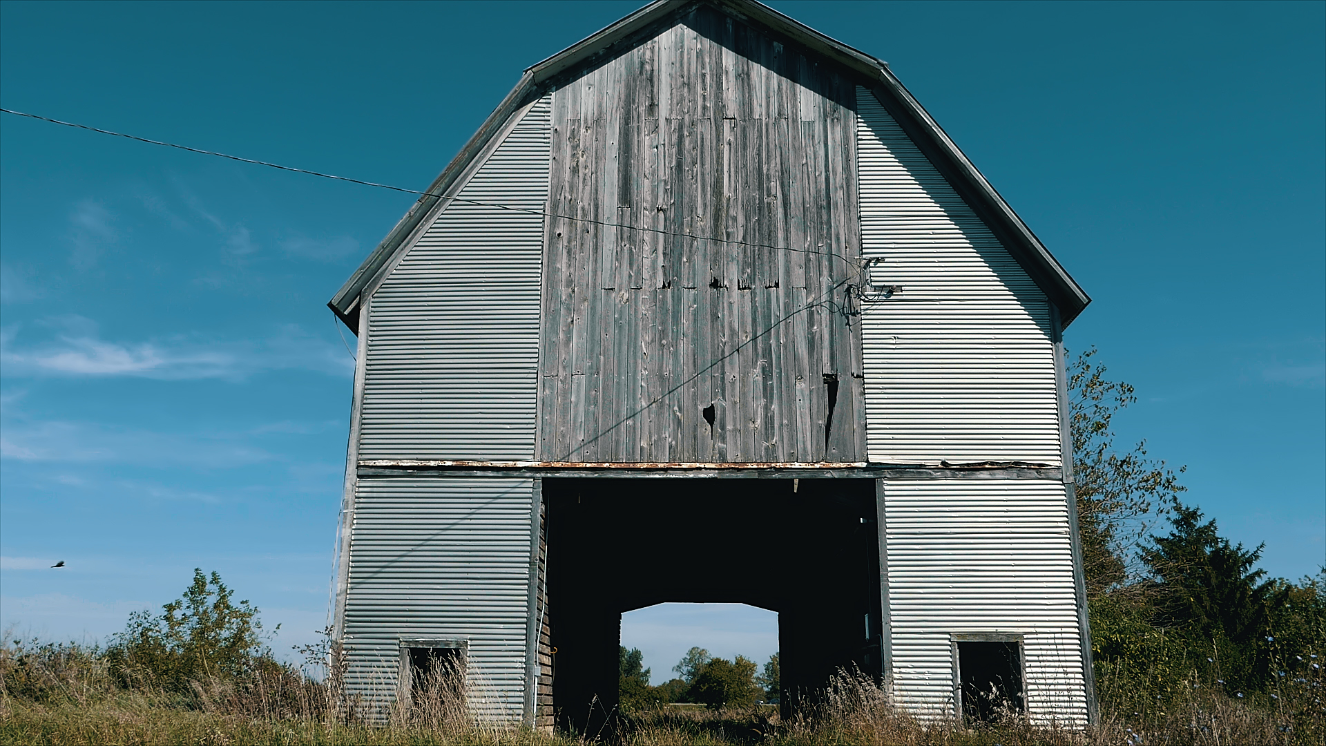

Cassius McGowan Posted September 17, 2015 Share Posted September 17, 2015 Thanks. I don't think the lens has anything to do with it b/c I've tested some grey/beige walls with the 12-35 and the macroblocking is there, but I think the shots in Chicago were high contrast which hides it pretty well.I've done some more testing today and have found that the Varicam LUT is just the worst in regards to hiding the magenta/cyan blocking. Something about that curve is just not right with the GH4's V Log. Film Convert seems to hide it pretty well. Exposing to the right by a stop or so also helps. Thank God faces aren't lumped into the cyan/magenta problem. They seem to be fine. I would just avoid big walls of light beige/grey, or yellow. Pure white and dark grey are fine. So what's the major differences in V-Log Paid and V-Log Free? Link to comment Share on other sites More sharing options...
Flynn Posted September 17, 2015 Share Posted September 17, 2015 Even Cinestyle had none of the degrading qualities of V-Log here. S--log2 doesn't, C-Log doesn't, all in 8bit with even lower-end more-compressed codecs. After investigating (cool word for pixel-peeping) V-LOG on the deep image quality level (deep meaning it's way less significant for normal viewers vs. me) what I see is:1 -More noise, shadow and midtones. Not just more, but worse looking noise pattern (coloured/blotchy)2 -Banding, colour banding and posterization everywhere especially in the area between shadows and mids, 30-40IRE-ish3 -A colour shift I can't remove for the life me. Neutral/Cine-D are more natural/accurate.4 -Increased highlight DR by about a stop. Actually sees more into the highlights. 5 -Slightly less shadow DR (clipped earlier, more noise, colour posterization/artefacts)(benefits of v-log are in Bold)Tested enough to decide shooting CinelikeD unless Panasonic or someone else fixes V-Log. I couldn't care less about the slightly less highlight clip. Yikes. After all this time, and supposed money, Panasonic has put into it and it's really this bad? I have a hard time believing it. Link to comment Share on other sites More sharing options...

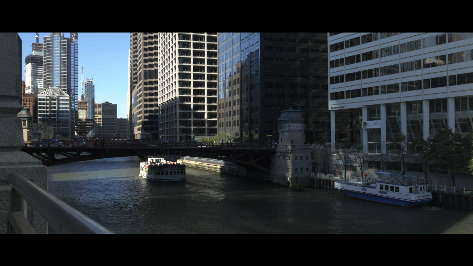

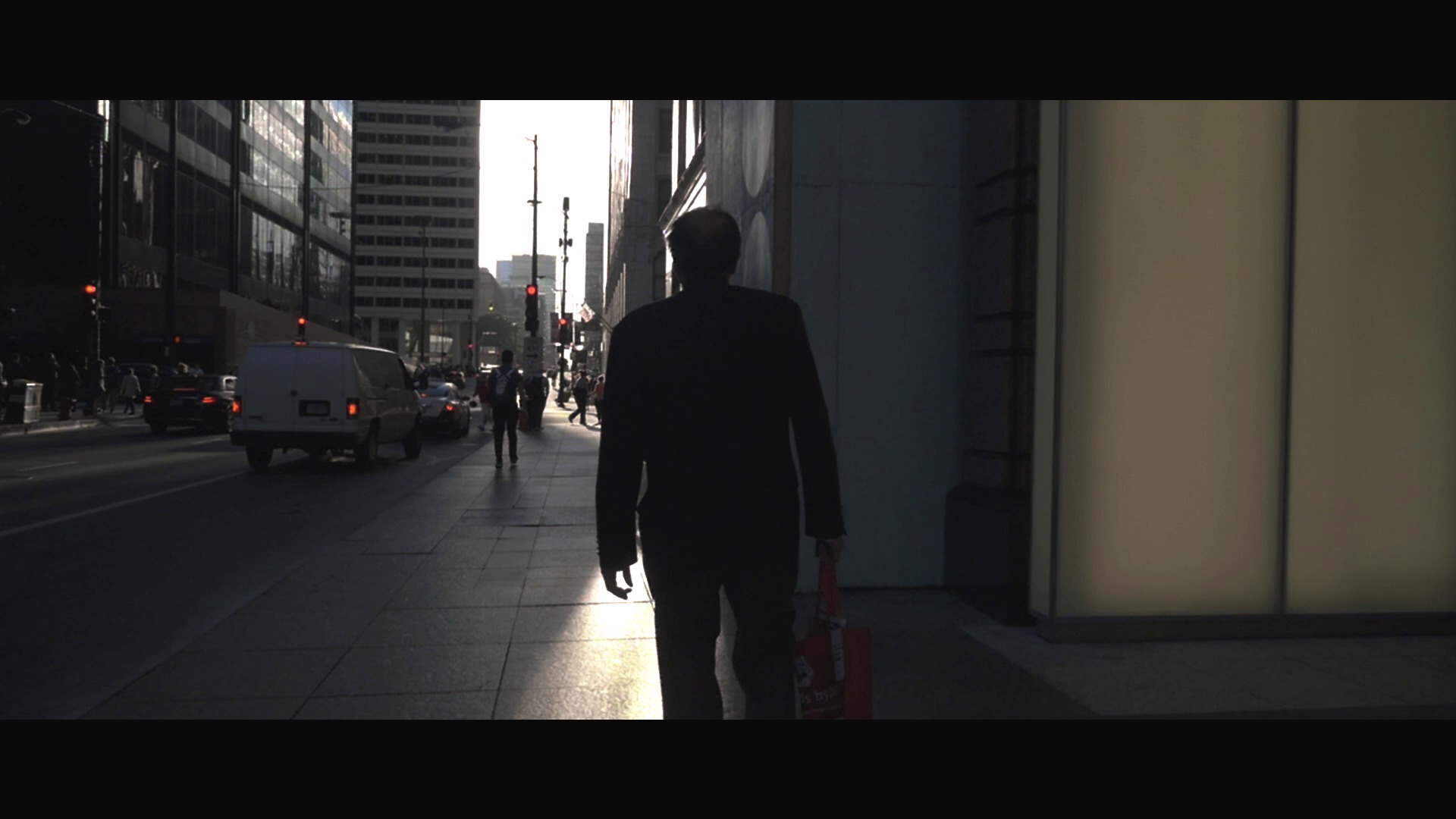

cantsin Posted September 19, 2015 Share Posted September 19, 2015 This is true. The highlight rolloff is insane. Very cinema camera-like. Not wanting to be nitpicky, but when I saw your video, I thought the very opposite (see screenshot). Link to comment Share on other sites More sharing options...
AaronChicago Posted September 19, 2015 Share Posted September 19, 2015 Not wanting to be nitpicky, but when I saw your video, I thought the very opposite (see screenshot).That shot is a pretty extreme DR example. Sun blasting the pavement. It's also 1080 at 96fps which is the worst in regards to overall res/detail. Look at other shots and you'll see a difference. Trust me I've been shooting with the GH4 ALOT since it was released and the highlight rolloff is much improved. johnnymossville, Lintelfilm, TheRenaissanceMan and 1 other 4 Link to comment Share on other sites More sharing options...

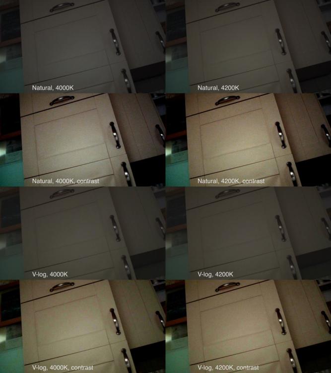

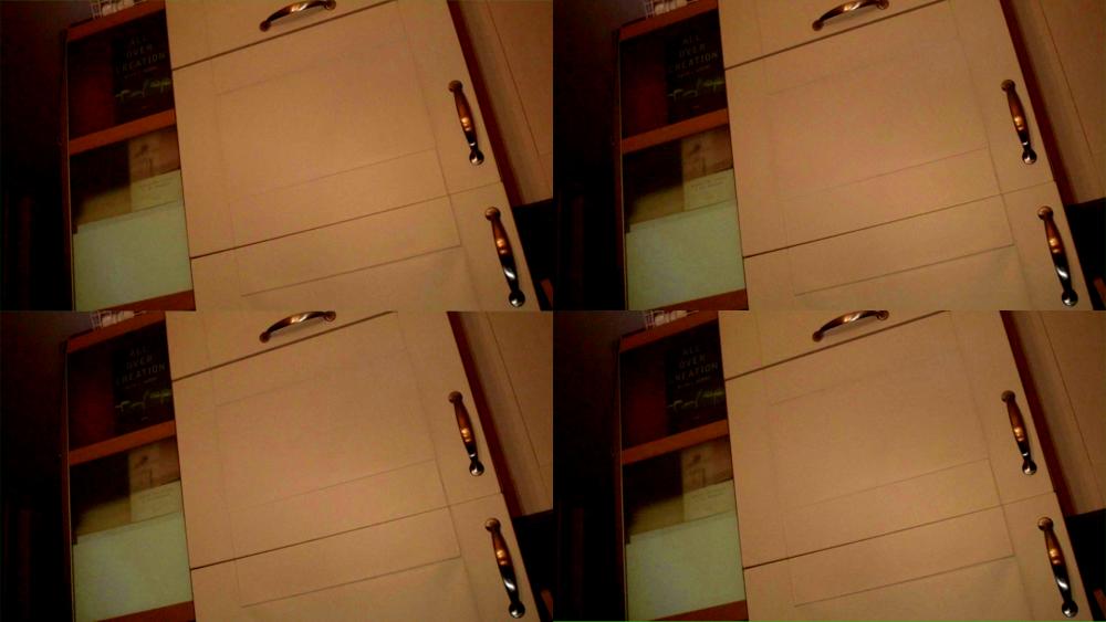

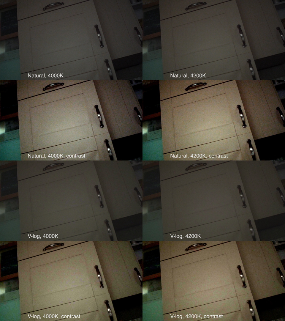

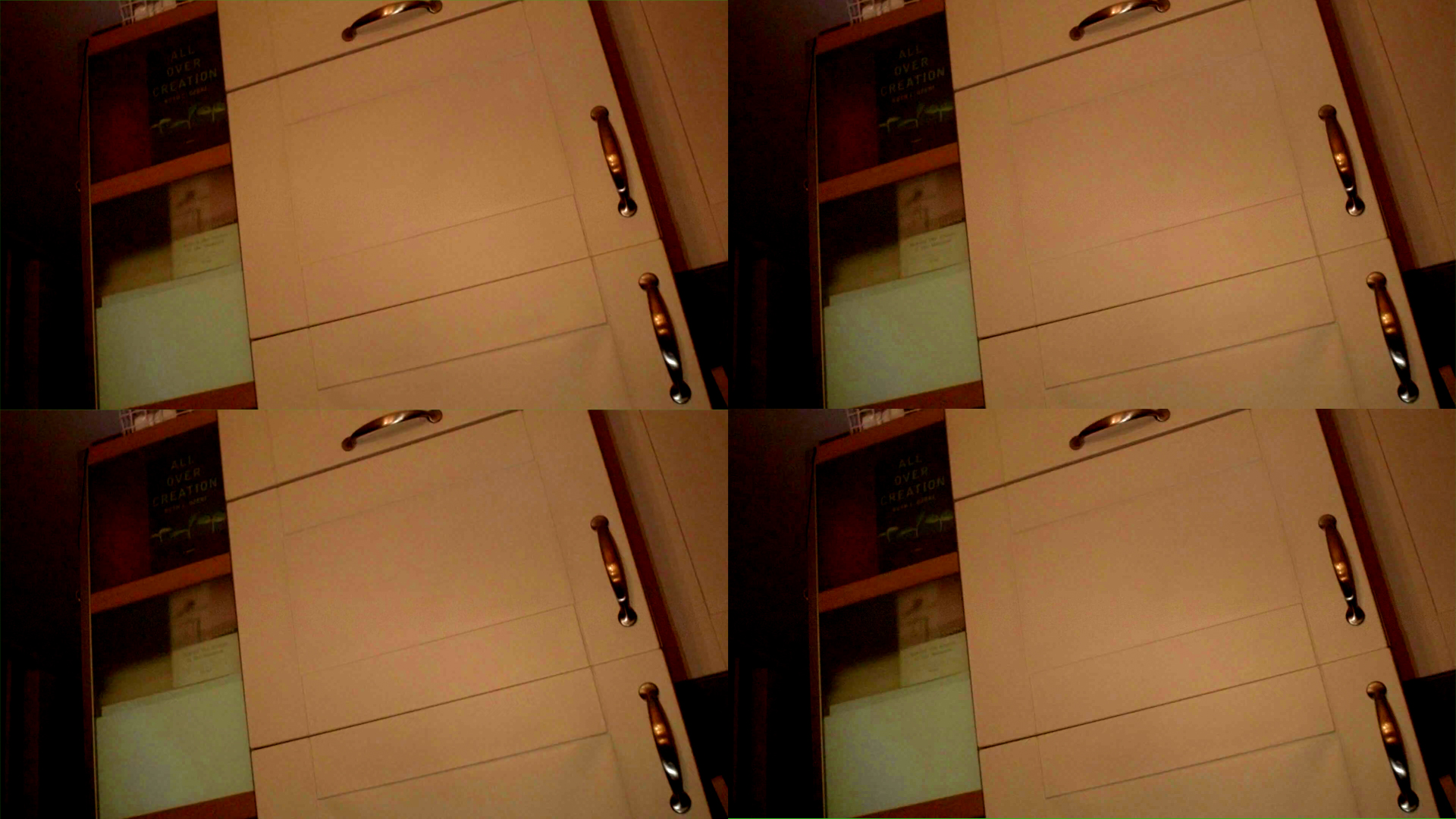

bunk Posted September 21, 2015 Share Posted September 21, 2015 So far I have heard no mentioning of WB in combination with V-log …it has a huge influence and I actually suspect there is a bug related to WB an V-log causing the macro blocking artifacts.I did some tests with the following settings: WB 4000K and 4200K, Natural vs V-log, Shutterspeed 30, ND 1.2, Exposure 6400, everything in All-I 25fps 1080. Shots where 2 stops underexposed. I used V-log to custom (own brew) on the Vlog clips.As you hopefully can see in the picture, the noise pattern of the Natural clips is identical in both 4000K and 4200K. The only difference is the color.The noise patterns (macro-blocking) of the V-log clips are completely different for each Kelvin value. Only when you reach the top values (±9000 and up) the patterns become more identical.It is as if the WB adds ad-random posterization to V-Log clips as if the white balance is part of "V-log space". I do not know enough about WB and how it works or should work but to me this looks and feel like a bug.If it's not a bug …I would like to know how to set the WB because even Custom has a a different noise distribution each and every time you set one. The second picture shows this. Each of the four custom settings give different noise patterns, even though the conditions were the same at the time of creation. The two at the bottom look quite similar but that is luck. To be clear these are not four frames out of the same clip. The macro block islands change shape but stay where the are …and their position and number are completely random as far as I can tell.Hope someone can either confirm it's a bug or tell me how to use WB properly.Thanks. TheRenaissanceMan, Zak Forsman and CTRT 3 Link to comment Share on other sites More sharing options...

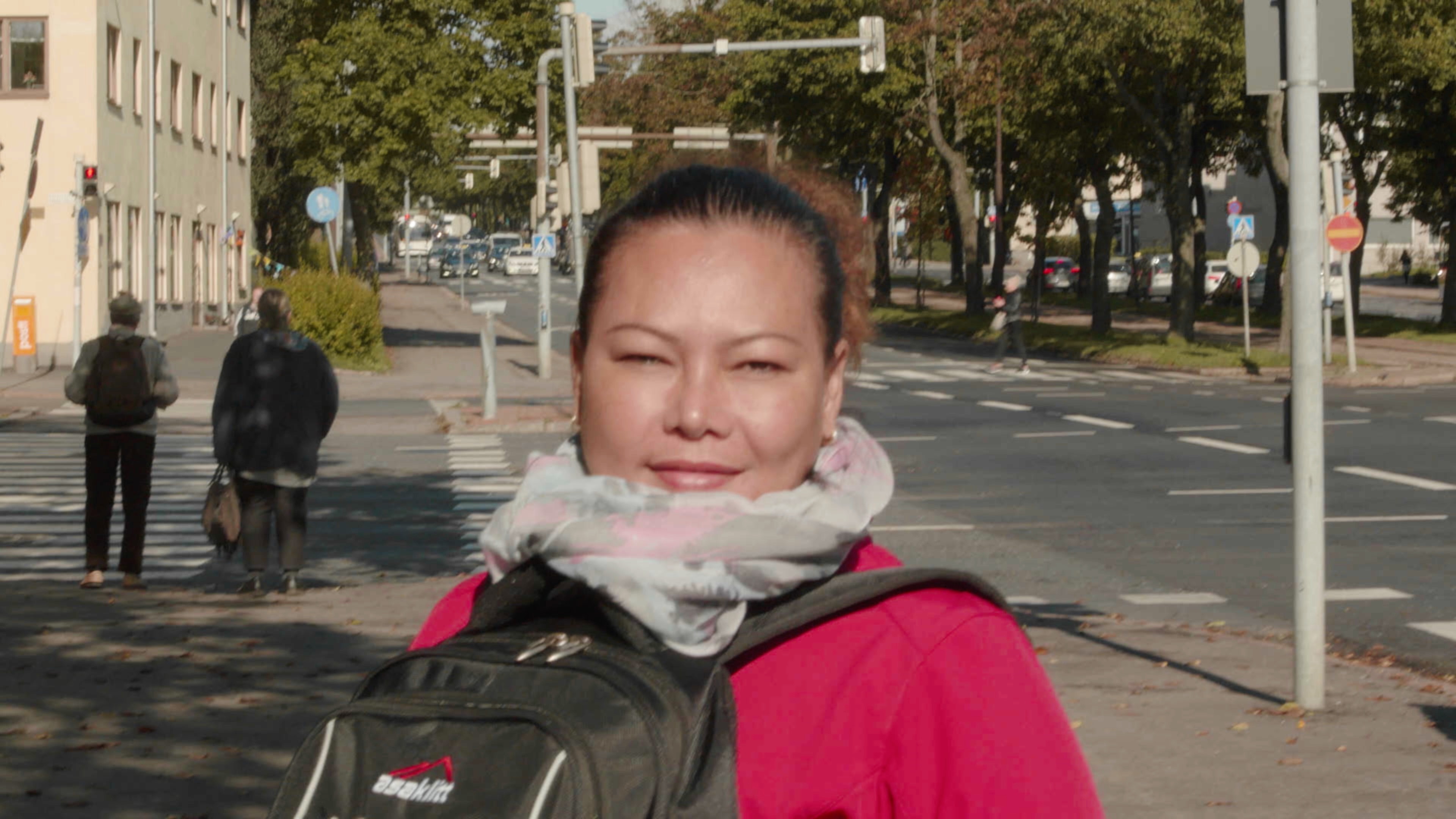

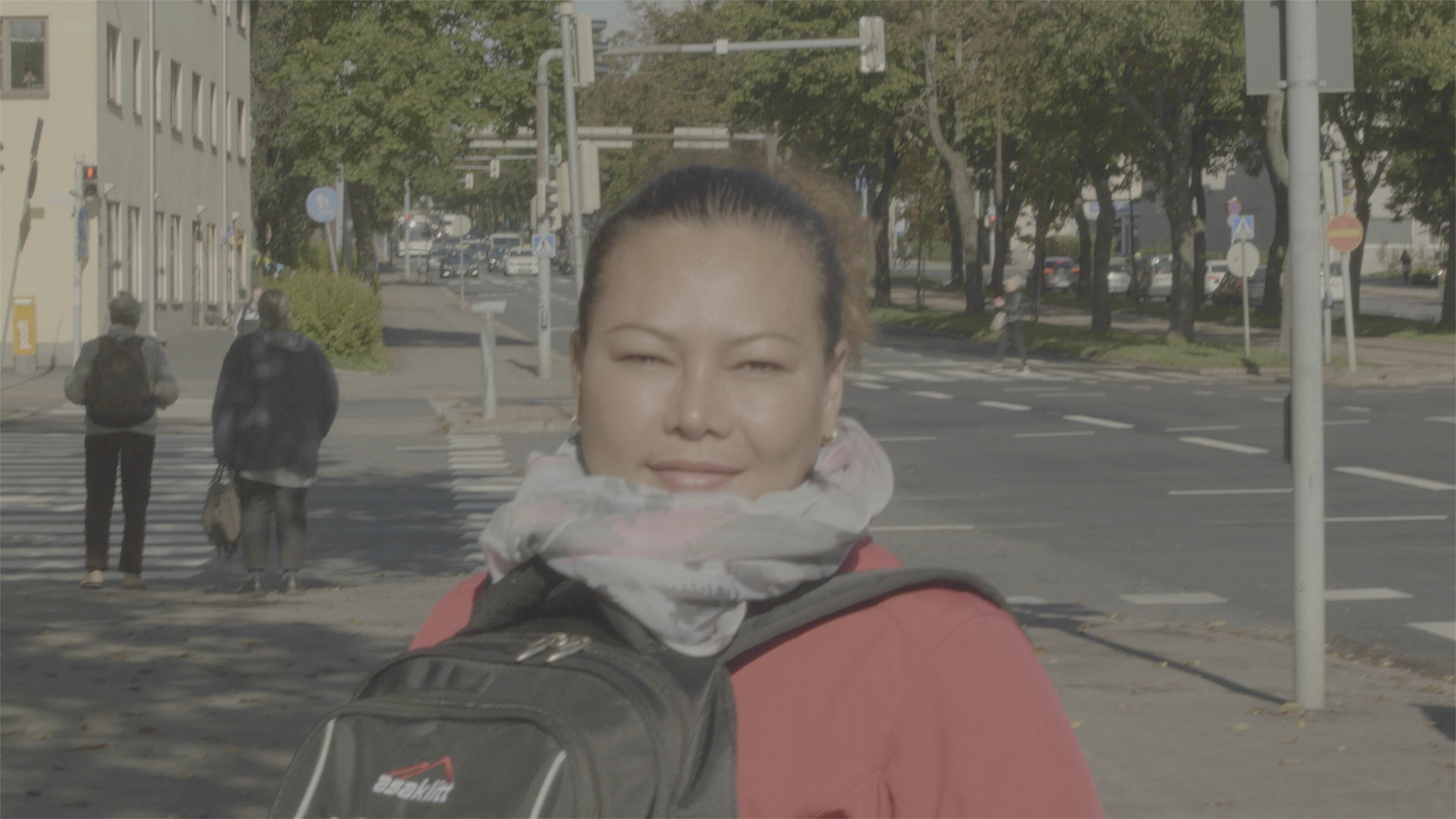

HelsinkiZim Posted September 22, 2015 Share Posted September 22, 2015 I was very disappointed with the noise, it makes me feel like i am in a time warp editing footage from my Canon XL1 in 2006. So I tried to tweak/ max out the settings we have available in V Log. I raised NR to +5 and i.Res to High. This immediately killed the noise in the lcd screen and evf. I have looked at the footage and it seems to help. I know it is established that pumping up these settings don't help the image in the long run, but I wanted to see if the payoff was worth it.For any of you GH4 pros with more experience, what exactly am I sacrificing by raising these settings so high?(I am also struggling with exposure for VLog, any tips on what I am doing wrong in this shot would be helpful. 'Twas a sunny day, lady facing the sun.) Link to comment Share on other sites More sharing options...
AaronChicago Posted September 22, 2015 Share Posted September 22, 2015 I was very disappointed with the noise, it makes me feel like i am in a time warp editing footage from my Canon XL1 in 2006. So I tried to tweak/ max out the settings we have available in V Log. I raised NR to +5 and i.Res to High. This immediately killed the noise in the lcd screen and evf. I have looked at the footage and it seems to help. I know it is established that pumping up these settings don't help the image in the long run, but I wanted to see if the payoff was worth it.For any of you GH4 pros with more experience, what exactly am I sacrificing by raising these settings so high?(I am also struggling with exposure for VLog, any tips on what I am doing wrong in this shot would be helpful. 'Twas a sunny day, lady facing the sun.) The exposure actually looks good. What did you use to convert V Log ? Link to comment Share on other sites More sharing options...
Orangenz Posted September 23, 2015 Share Posted September 23, 2015 I was very disappointed with the noise, it makes me feel like i am in a time warp editing footage from my Canon XL1 in 2006. So I tried to tweak/ max out the settings we have available in V Log. I raised NR to +5 and i.Res to High. This immediately killed the noise in the lcd screen and evf. I have looked at the footage and it seems to help. I know it is established that pumping up these settings don't help the image in the long run, but I wanted to see if the payoff was worth it.For any of you GH4 pros with more experience, what exactly am I sacrificing by raising these settings so high?(I am also struggling with exposure for VLog, any tips on what I am doing wrong in this shot would be helpful. 'Twas a sunny day, lady facing the sun.) Noise seems the most in magenta colours. Some LUTs seem to produce it a lot while others make it disappear. The main thing for exposure seems to be set zebra to 80% and wind back just a tad from there with either shutter speed or ND filter, ie. the same as I would do with a normal profile (except zebra would be on 100% for other styles). I use iRes standard, sharp -5, NR 0. But really it seems more to do with the interaction between LUT and overall colour of shot. There's something nasty going on with the pink jacket though. Almost looks 1080 bad. Link to comment Share on other sites More sharing options...
