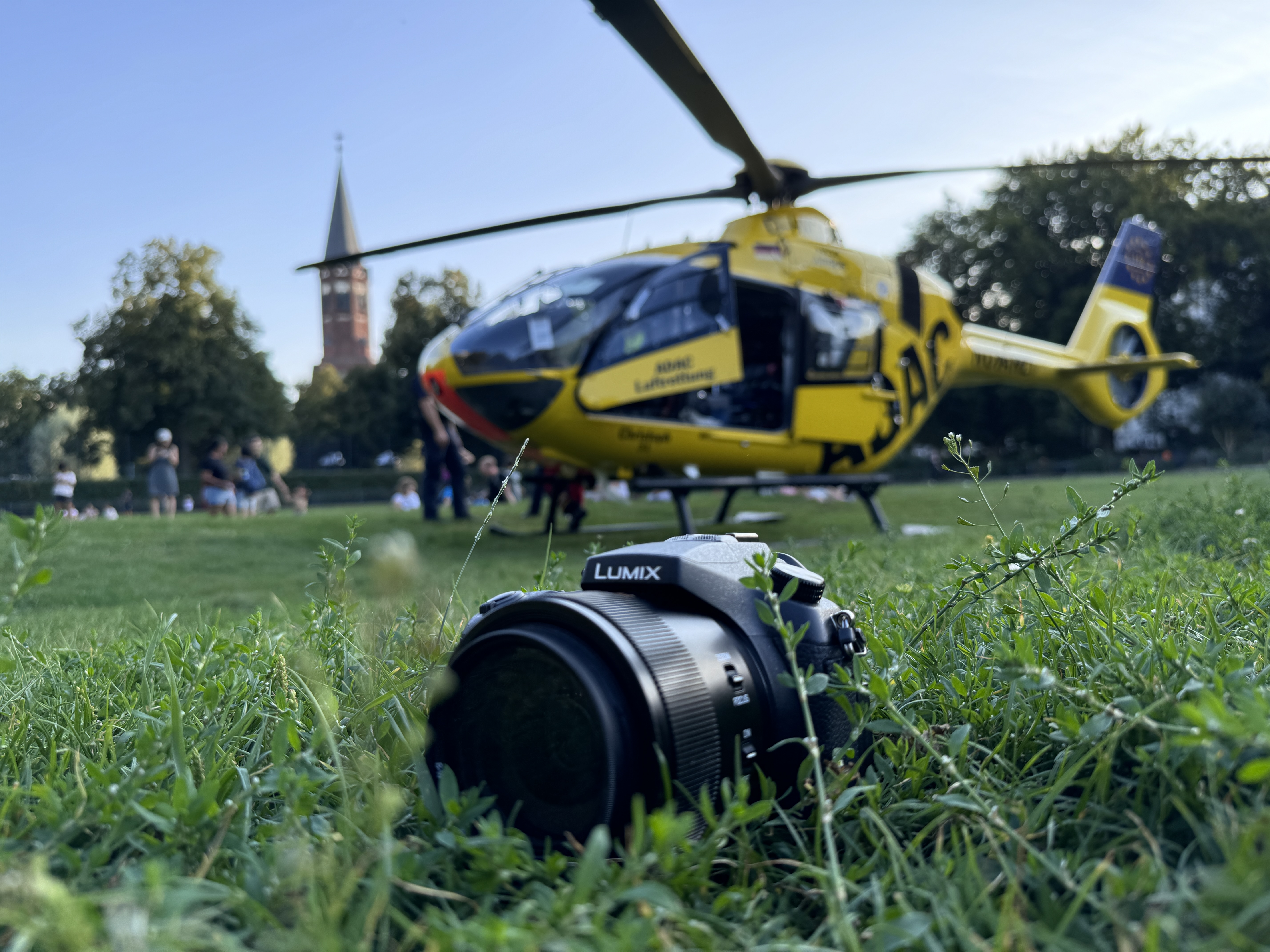

Administrators Andrew - EOSHD Posted August 29, 2024 Administrators Share Posted August 29, 2024 The lens on this thing is bonkers, most of the shots come out looking like they are shot on at least an APS-C sensor. The FZ1000 had been going for under 400 euros in recent months but I got lucky and found one for 150 at Foto-Meyer in Berlin. I don't remember the lens ever being this good. The close-focus ability is nuts. The contrast at the long end is very nice for a 25-400mm, it is very crispy for such a ridiculous zoom and it is really quick to AF. The whole thing is more ergonomic and snappier to use than Sony's RX10 series too. The 4K is a crop, that's the only flaw. Sony didn't let them use the later stacked 1" sensor so it has the older version. It was a bargain at 900 euros 10 years ago and I think it is one of those shot-getters that has really stood the test of time, so a mega thumbs-up at 150-400 in 2024 from me. The original review: https://www.eoshd.com/review/panasonic-fz1000-review-bargain-4k-super-zoom/ Emanuel 1 Link to comment Share on other sites More sharing options...
