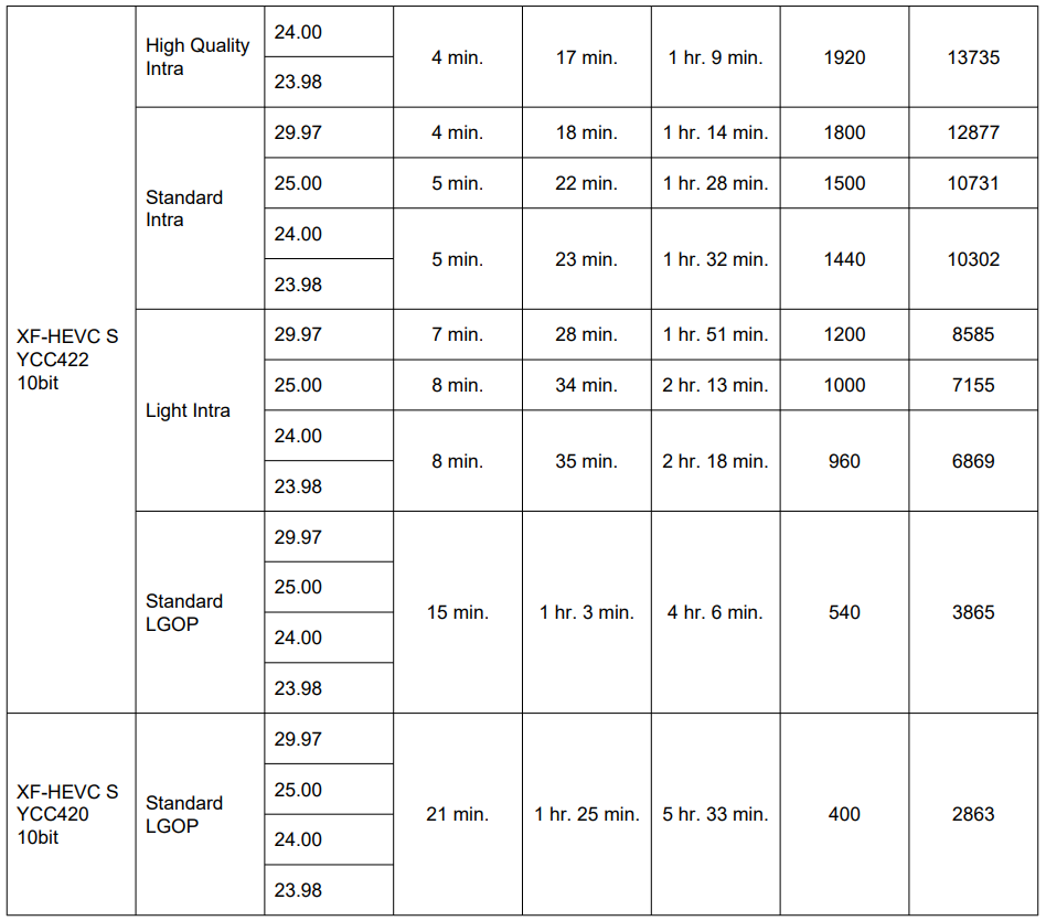

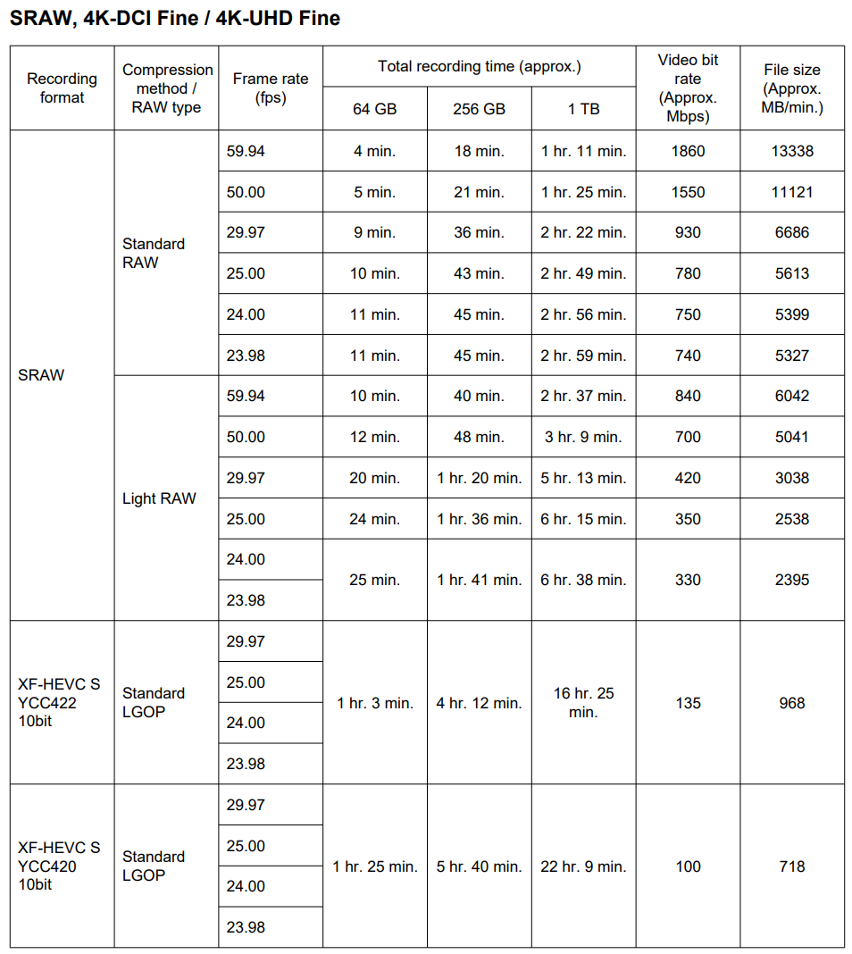

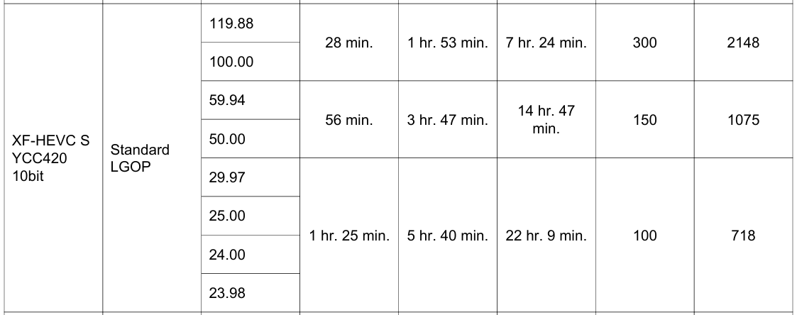

herein2020 Posted July 25, 2024 Share Posted July 25, 2024 From the user manual, these are the two most interesting codec tables to me. 8K in Standard LGOP might actually be usable especially for short b roll clips. I never understood why the R5 only offered RAW for 8K, probably due to overheating. Another interesting combination is 4K SRAW at 60FPS. My understanding is that SRAW doesn't use line skipping so in theory the R5II does support some form of down sampled 4K60FPS if you shoot in SRAW. 4K Light SRAW at 60FPS looks like it might be usable for short b roll clips. Also, I have figured out where the cripple hammer is hiding.....for most of these more interesting codecs you will need to use the single CFE card which means you will not have multi-card redundancy for most of your footage if you shoot in these modes. Out of curiosity, I checked the Nikon Z8 and it also only has a single CFE slot but it is also $500 cheaper. Considering how hot CFE cards get in the R series, relying on a single card is even more concerning to me. According to the user manual, it looks like you don't get dual card redundancy until you drop down to 4K30FPS XF-HEVC 10bit 422 LGOP. For some reason the tables don't show if 60FPS can also be written to the SD card but I assume so. One of my favorite features of the C70 (right after the internal ND filters) is being able to write Cinema Raw LT at 4K30FPS to dual V30 1TB SD cards. User Manual: https://cam.start.canon/en/C017/manual/c017.pdf Link to comment Share on other sites More sharing options...

ac6000cw Posted July 25, 2024 Share Posted July 25, 2024 1 hour ago, herein2020 said: Also, I have figured out where the cripple hammer is hiding.....for most of these more interesting codecs you will need to use the single CFE card which means you will not have multi-card redundancy for most of your footage if you shoot in these modes. Out of curiosity, I checked the Nikon Z8 and it also only has a single CFE slot but it is also $500 cheaper. Considering how hot CFE cards get in the R series, relying on a single card is even more concerning to me. According to the user manual, it looks like you don't get dual card redundancy until you drop down to 4K30FPS XF-HEVC 10bit 422 LGOP. For some reason the tables don't show if 60FPS can also be written to the SD card but I assume so. I suspect the heat generated when writing data to the cards at those high rates is a major reason why only one card is supported. Also the energy that is heating the cards is coming from the battery, which will cause that to get hotter - and of course the cards and battery are very close to each other, plus it's the part of the camera that is designed to be held in your right hand, so can't be allowed to get too hot. 1 hour ago, herein2020 said: One of my favorite features of the C70 (right after the internal ND filters) is being able to write Cinema Raw LT at 4K30FPS to dual V30 1TB SD cards. It's not really a fair/sensible comparison - the C70 is very much larger (with the battery on the outside as well), twice the weight and has integrated fan cooling: Link to comment Share on other sites More sharing options...
herein2020 Posted July 25, 2024 Share Posted July 25, 2024 1 hour ago, ac6000cw said: I suspect the heat generated when writing data to the cards at those high rates is a major reason why only one card is supported. Also the energy that is heating the cards is coming from the battery, which will cause that to get hotter - and of course the cards and battery are very close to each other, plus it's the part of the camera that is designed to be held in your right hand, so can't be allowed to get too hot. I agree, its probably a heat problem, I really didn't think in 2024 that cameras overheating when using them for what they were intended to be used for would be this big of a problem, I wonder if an internal NVME drive would fix all of these heat problems. The best example for comparing body sizes between the R5II and a camera with dual CFE slots would be the R1. Of course, the R1 has a bigger body, different battery (I think), and a lower resolution sensor, but it is a good example of possibly what the minimum specs need to be to support the heat generated by two CFE cards at least for Canon. 1 hour ago, ac6000cw said: It's not really a fair/sensible comparison - the C70 is very much larger (with the battery on the outside as well), twice the weight and has integrated fan cooling: My point with the C70 was that Canon was able to create a flavor of a raw codec that was a low enough bitrate to support 4K30FPS writing to relatively slow V30 SD cards. No other camera in their product line can write any flavor of RAW to a V30 SD card that I am aware of. If they had included that same codec in the R5II (Cinema Raw LT), then we would have a raw option that could write to both card slots. In fact, with that codec, it might even be possible to write 4K60FPS to V60 or V90 SD cards which would provide a redundant card slot option up to 4K60FPS raw. I doubt we will see Cinema Raw LT in the R5II since it seems like they have already thrown everything possible into it, but without it, I would never feel comfortable shooting important projects over 4K LongGOP. Link to comment Share on other sites More sharing options...

herein2020 Posted July 25, 2024 Share Posted July 25, 2024 1 hour ago, gt3rs said: R5 offers 10 and 8 bit 8k since day one (h265 and h264) ALL-I, IPB and IPB Light not only RAW I never even noticed that, I read somewhere early in the launch of the R5 that it was RAW only and never confirmed for myself. 44 minutes ago, ntblowz said: One thing R5II is missing is the IBP light codec... I really like it for long hour recording, save a lot of space and don't need fast cars at all for 4k60p That is a good point, the lowest 4K data rate that the R5 offers is 60Mbps, the lowest for the R5II is 100Mbps. I read somewhere that Canon decided to stop using proprietary codecs and standardize on what everyone else is using. It will be interesting to see if Standard LGOP is better or worse than IPB Light. It could be harder to edit, lower quality, or both. The C70 uses XF-AVC LongGOP and I haven't had any performance problems editing the footage from it. Canon R5 - 4K (29.97p/25.00p/24.00p/23.98p) IPB (Light): Approx. 60 Mbps Canon R5II Link to comment Share on other sites More sharing options...
