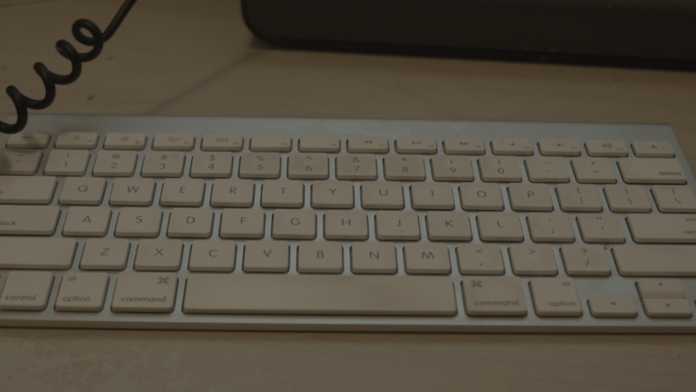

Jonesy Jones 0 Posted May 3, 2015 Share Posted May 3, 2015 So, I just got a hold of the Sigma 18-35 for the first time. Lovely lens. I'm trying to do some tests to make sure I want to keep it. Decided to compare it with another lens that I own which is a Leica 19mm 2.8. I thought I'd run them both through a few tests. Just fiddling around I shot the keyboard on my desk with both lenses wide open... and to be honest I don't see too much of a difference. Granted the 1.8 is slightly brighter, but not by much. Definitely not a stop +, at least to my eyes. Both lenses are using adapters to get them on my BMPCC. The Sigma lens is using the Metabones (non speedbooster). I've looked at the aperture blades of the Sigma/adapter and they appear to be opening up all the way. The Leica is using a cheap (non speedbooster) adapter. You guys are smarter than me. What am I doing wrong? Thoughts?EDIT: Just added the sample photos. Can you tell which is which?EDIT #2: Added a couple more examples. I also compared the Sigma to an old 24mm 2.8 Nikon I have (this is the 3 pair of photos), with the same results. I am going to try a couple more tests, the suggestion of shooting a candle seems like a great idea. However, at this point, it is becoming obvious that the Sigma 18-35 is, regarding exposure, closer to a 2.5 than 1.8. Quote Link to post Share on other sites

Jonesy Jones 0 Posted May 3, 2015 Author Share Posted May 3, 2015 Hey guys, thanks for your help. I just uploaded some sample pics to illustrate what I am talking about. Yes, you can sort of see a difference. But no where near the difference a stop + should represent. Quote Link to post Share on other sites

Julian 581 Posted May 3, 2015 Share Posted May 3, 2015 Hey guys, thanks for your help. I just uploaded some sample pics to illustrate what I am talking about. Yes, you can sort of see a difference. But no where near the difference a stop + should represent.What are the exact settings of each shot?Did you try to reproduce it? Quote Link to post Share on other sites
Jonesy Jones 0 Posted May 3, 2015 Author Share Posted May 3, 2015 What are the exact settings of each shot?Did you try to reproduce it?Leica 19mm 2.8Sigma 18-35 (@19) 1.8 (or wide open using metabones adapter) Will try and post another test later today. Quote Link to post Share on other sites

leeys 101 Posted May 4, 2015 Share Posted May 4, 2015 Is the top image the Sigma? Quote Link to post Share on other sites

Jonesy Jones 0 Posted May 5, 2015 Author Share Posted May 5, 2015 Added some more examples. There is just no way this Sigma is even close to a 1.8. Also I would try to photograph or make a video of a something much darker, like a candle on a table with it's surroundings. The difference should be much more obvious then.This is a great idea. I am going to try this next. Quote Link to post Share on other sites
