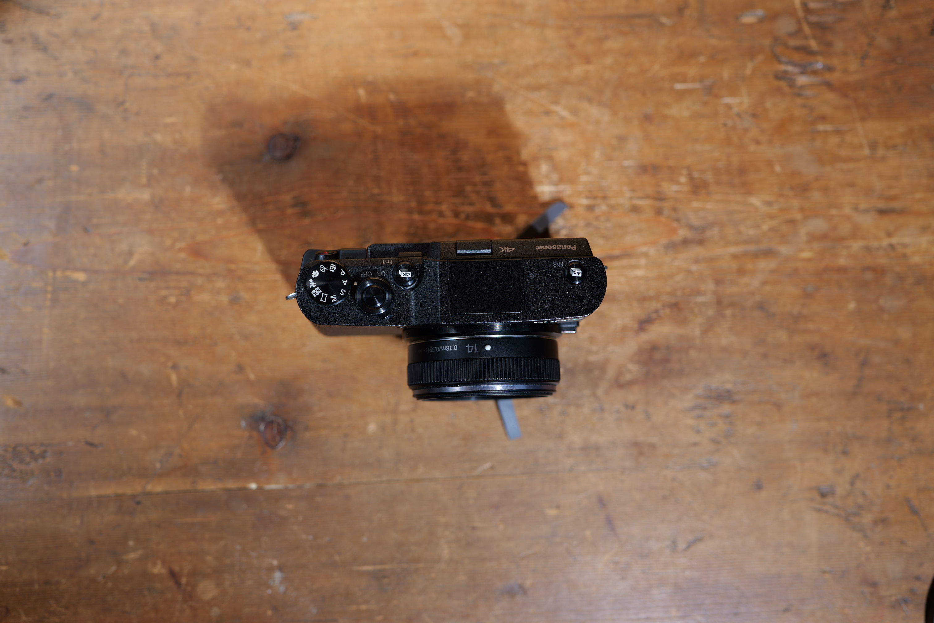

John Matthews Posted December 16, 2023 Share Posted December 16, 2023 I'm still impressed with the GX850/GX800/GF9. Correct me if I'm wrong, but I believe this is still the smallest 4k DSLM setup. It weighs a whopping 269g and 55g for the 14mm f/2.5 lens. Not bad for January 2017. Still waiting for any sort of a replacement. sanveer 1 Link to comment Share on other sites More sharing options...

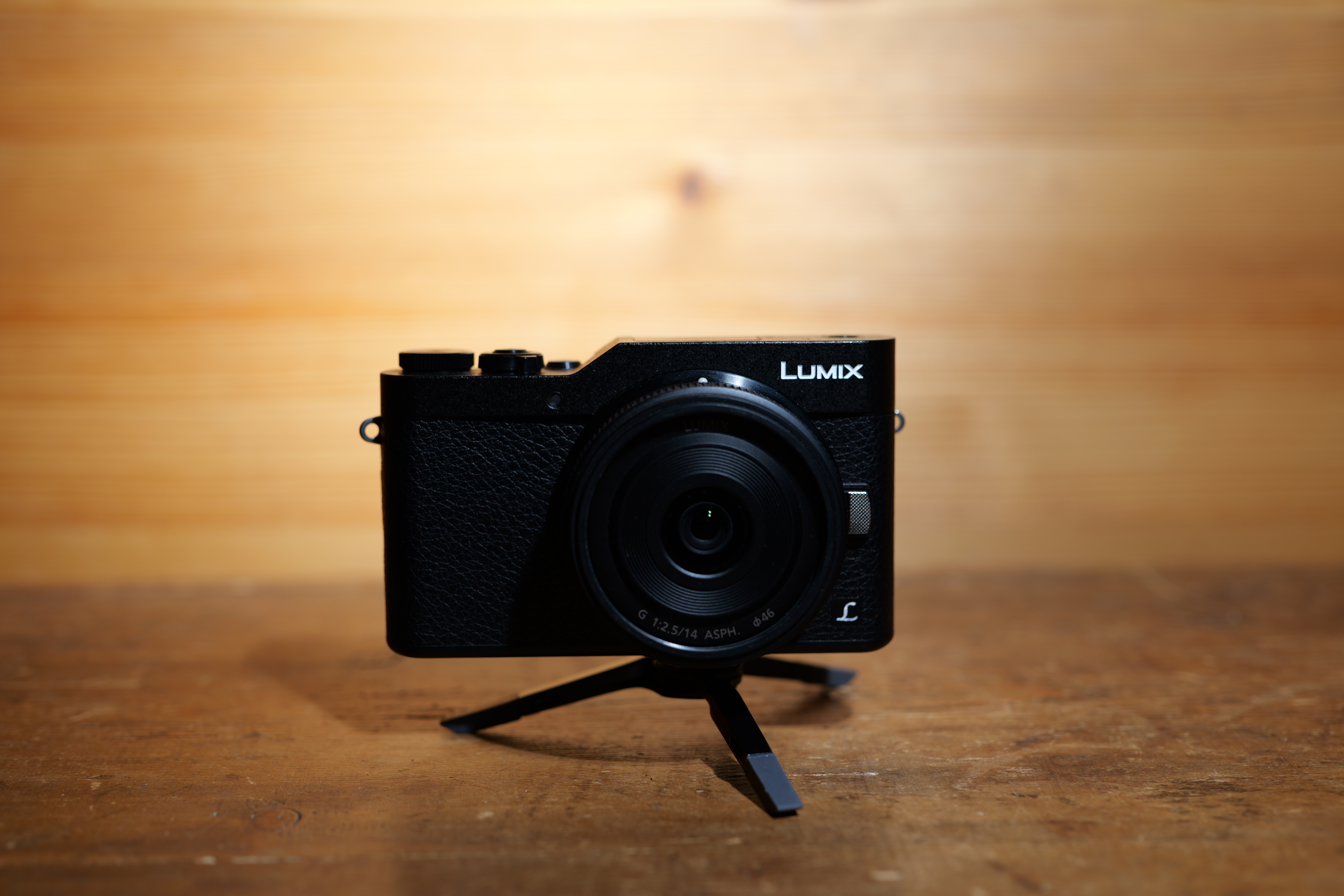

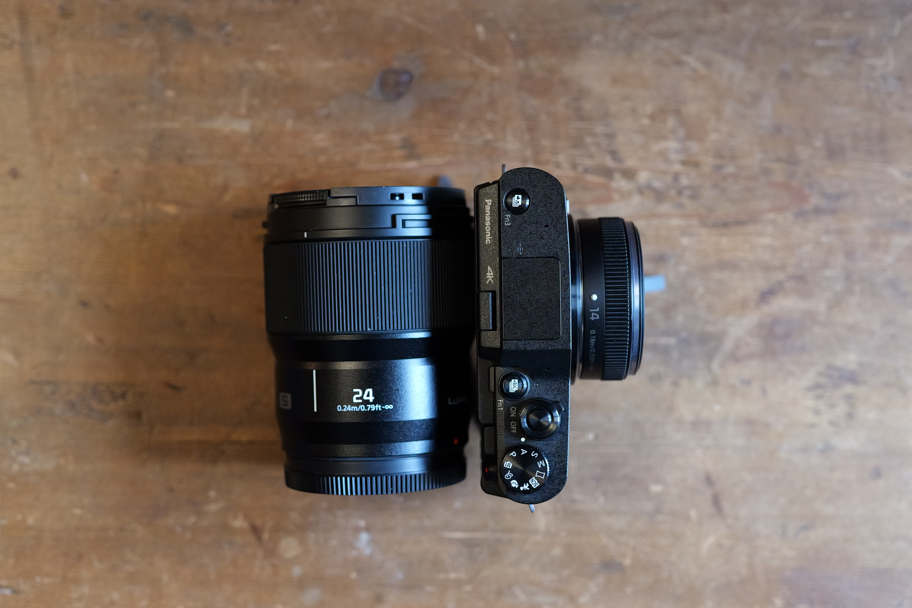

John Matthews Posted December 16, 2023 Author Share Posted December 16, 2023 Perhaps a more telling image: sanveer and kye 2 Link to comment Share on other sites More sharing options...
