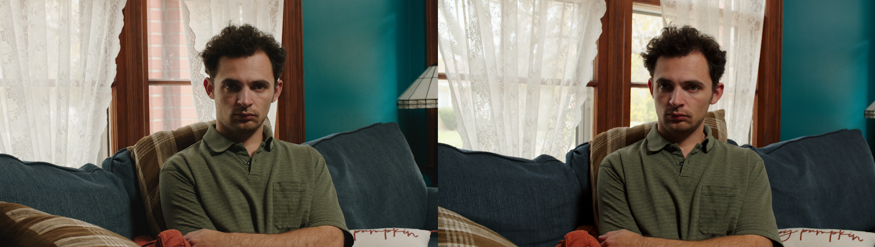

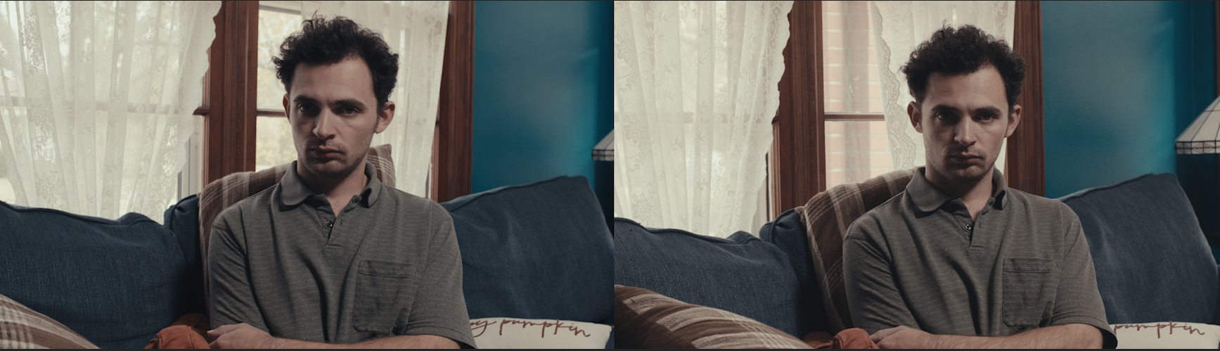

TomTheDP Posted November 2, 2023 Share Posted November 2, 2023 Somewhat unrelated to the topic. My attempt at matching an ARRI Alexa Classic and an FX30. Used an Xrite color checker passport chart. I guess that is cheating but I wanted to see if I could match them this way 100%. I think these are very close but maybe not 100%. Thoughts? The more stylized one I switch the color space and gamma to RED and then put a Kodak lut on. The other two are just ARRI color space with the ARRI 709 lut. Link to comment Share on other sites More sharing options...
kye Posted November 2, 2023 Author Share Posted November 2, 2023 1 hour ago, TomTheDP said: Somewhat unrelated to the topic. My attempt at matching an ARRI Alexa Classic and an FX30. Used an Xrite color checker passport chart. I guess that is cheating but I wanted to see if I could match them this way 100%. I think these are very close but maybe not 100%. Thoughts? The more stylized one I switch the color space and gamma to RED and then put a Kodak lut on. The other two are just ARRI color space with the ARRI 709 lut. Did you grade the FX30 to match the Alexa, or the other way around? I see differences, but they're subtle and not significant. IIRC it was Steve Yedlin that talked about the idea of the "cut back" test for camera matching. Ie, if you were to have a shot from camera A, then another shot, then CUT BACK to camera B, would you notice that A and B were different. I think this is a good test because in real film-making you don't normally cut directly between two cameras showing the same scene from the same angle, so there is some distance there, and so in A/B testing you shouldn't cut directly between the same scene and angle because it's too stringent a test. Yes, in theory you would cut between two angles of the same scene, but in lots of film-making you'd be changing the lighting setup between filming those angles, so getting a perfect match isn't relevant in these situations either. TomTheDP 1 Link to comment Share on other sites More sharing options...
BrunoCH Posted November 2, 2023 Share Posted November 2, 2023 1 hour ago, TomTheDP said: Somewhat unrelated to the topic. My attempt at matching an ARRI Alexa Classic and an FX30. Used an Xrite color checker passport chart. I guess that is cheating but I wanted to see if I could match them this way 100%. I think these are very close but maybe not 100%. Thoughts? The more stylized one I switch the color space and gamma to RED and then put a Kodak lut on. The other two are just ARRI color space with the ARRI 709 lut. Very close. What jumps out at me is a difference in the blue of the sofa cushions in both and a difference in the saturation of the reds in the second still. Link to comment Share on other sites More sharing options...
TomTheDP Posted November 4, 2023 Share Posted November 4, 2023 On 11/2/2023 at 7:27 PM, kye said: Did you grade the FX30 to match the Alexa, or the other way around? I see differences, but they're subtle and not significant. IIRC it was Steve Yedlin that talked about the idea of the "cut back" test for camera matching. Ie, if you were to have a shot from camera A, then another shot, then CUT BACK to camera B, would you notice that A and B were different. I think this is a good test because in real film-making you don't normally cut directly between two cameras showing the same scene from the same angle, so there is some distance there, and so in A/B testing you shouldn't cut directly between the same scene and angle because it's too stringent a test. Yes, in theory you would cut between two angles of the same scene, but in lots of film-making you'd be changing the lighting setup between filming those angles, so getting a perfect match isn't relevant in these situations either. That is very true. The only thing would be very interview situations where you have an A and B cam on the same subject. I haven't done one in almost a year now but I have a gig coming up where we are going to be doing that. I used the color match tool in resolve, using an xrite chart. So you can set the color space and gamma, which I set to ARRI's. I did it on both cameras so it changed up the way the Alexa originally looked as well, with its preset white balance. This method would fall apart with creative lighting though. Let's say you wanted to do an orange tinted light as a key with blue for fill or something wacky. The chart is only useful for getting normal colors. On 11/2/2023 at 7:37 PM, BrunoCH said: Very close. What jumps out at me is a difference in the blue of the sofa cushions in both and a difference in the saturation of the reds in the second still. Yes someone pointed both out to me. I didn't see them at first but its very apparent now. Definitely got it much closer than my manual attempts. I think with more fine tuning it could come closer. Link to comment Share on other sites More sharing options...
kye Posted November 4, 2023 Author Share Posted November 4, 2023 2 hours ago, TomTheDP said: That is very true. The only thing would be very interview situations where you have an A and B cam on the same subject. I haven't done one in almost a year now but I have a gig coming up where we are going to be doing that. I used the color match tool in resolve, using an xrite chart. So you can set the color space and gamma, which I set to ARRI's. I did it on both cameras so it changed up the way the Alexa originally looked as well, with its preset white balance. This method would fall apart with creative lighting though. Let's say you wanted to do an orange tinted light as a key with blue for fill or something wacky. The chart is only useful for getting normal colors. Interesting. It did a pretty good job then. 2 hours ago, TomTheDP said: Yes someone pointed both out to me. I didn't see them at first but its very apparent now. Definitely got it much closer than my manual attempts. I think with more fine tuning it could come closer. The things that I noticed first was the skin tones. This is what I always look at, and is most important. The one on the left has those nutty tan and brown hues and the one on the right has 'porange' (pink&orange) and red tones. The hues of the skin tones are the most important thing for me in images. I also noticed the differences in the green/cyan area top-right, which has greens on the left but none on the right. BUT, the skin tones are so important that they're the entire ballgame if you're cutting an interview between two angles. A really quick and dirty way to match skin tones when they're so far apart is to just rotate the hue of the entire image. This sounds like a brutal thing to do to an image, but it will never break the image and we are so sensitive to skin tones that what is a huge change in skin tones is imperceptible on everything else in the image. If there is anything that goes off in the background then you can easily do a Hue-vs curve adjustment on it, which is much more prone to inaccuracies and stressing the image so it's far preferable to rotate the hue of the whole image to suit the skin tones and then do the Hue curves on the background rather than the other way around. This assumes that you've correctly white-balanced and exposed the cameras, and are doing colour management and transforms properly of course. Link to comment Share on other sites More sharing options...
