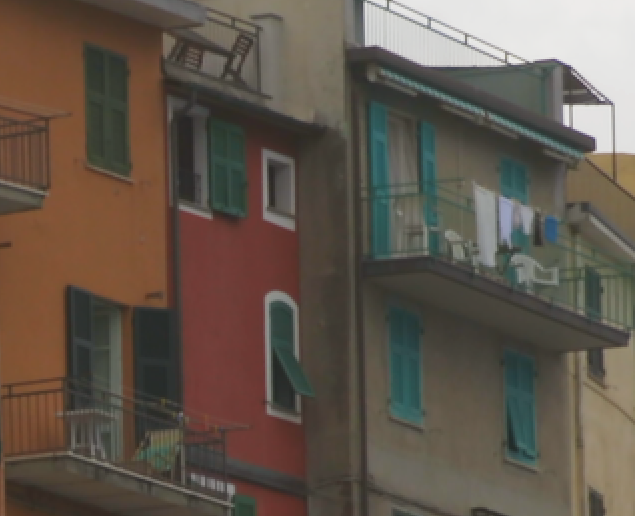

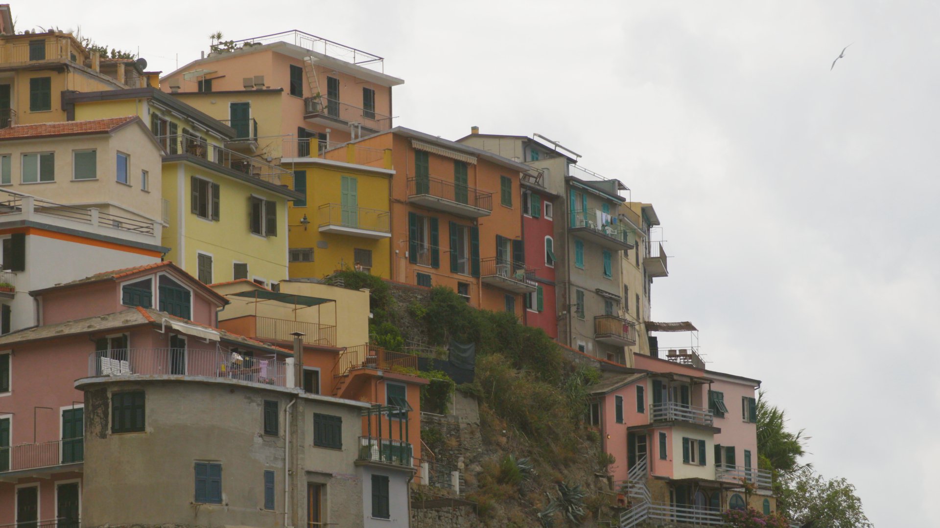

But I was able to start with this C-Log 8-bit 4K image:
Grade it to this:

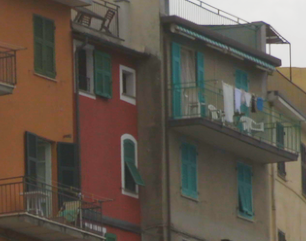

and then turn this level of noise:
Into this:
Perhaps the greatest challenge with the Canon footage is that the noise is in large blocks, rather than single-pixel noise which is easier to get rid of.  My Canon 700D was the same, even in RAW, so maybe it's a Canon thing.
As the combination of temporal and spatial NR combines adjacent pixels (which you can then sharpen back up again as Waqas shows above) it also helped turn this obviously 8-bit and heavily expanded / broken colour space:
Into a much smoother colour rendition:
It's not magic, but it's definitely a much better result than just living with the noise or binning shots that had a bit of noise in them for whatever reason.
