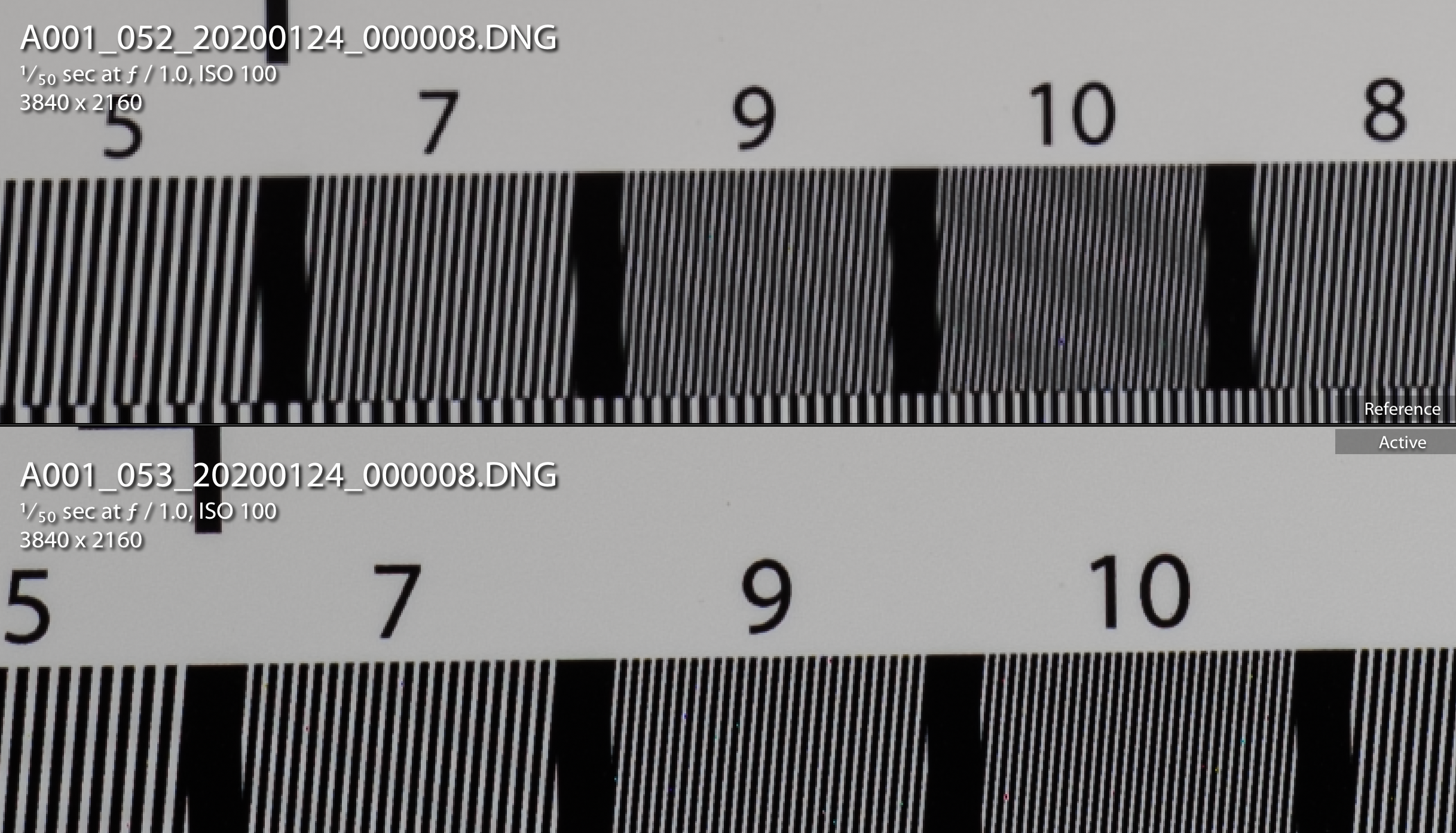

paulinventome Posted January 24, 2020 Share Posted January 24, 2020 Second attempt as i had uploaded the wrong images before. So long short short, i was testing resolution of 6k vs FF UHD to check the level of aliasing. The only chart i had was an old one i'd printed off myself many moons ago but should be enough to create issues (but i really need to find a better way...) But i can clearly see 6K still vs scaled UHD but what i found interesting is if you switch to DC mode i am pretty sure you're just getting a 1:1 crop of the sensor in UHD - it looks similar to the 6K. Either way the DC UHD RAW mode is much clearer than the FF. But i need to do some better tests but try it yourself and see what you think. cheers Paul So top is full frame UHD and lower is DC UHD, see how much clearer the lines are MikhailA and Lars Steenhoff 2 Link to comment Share on other sites More sharing options...
Lars Steenhoff Posted January 24, 2020 Share Posted January 24, 2020 I think for lower iso the dc crop mode may give the best results based on your test. The crop mode is also more noisy, so for higher iso the full frame mode will give cleaner results Link to comment Share on other sites More sharing options...
paulinventome Posted January 24, 2020 Share Posted January 24, 2020 6 minutes ago, Lars Steenhoff said: I think for lower iso the dc crop mode may give the best results based on your test. The crop mode is also more noisy, so for higher iso the full frame mode will give cleaner results I've just found photoshop on my laptop so used that and yes, the UHD DC crop is a pixel for pixel crop from the centre of the sensor. You can A/B stills and cine and it's identical. So in this mode with no OLPF it would be interesting to see how much moire there is in motion. I could guess that perhaps the DC HD mode would be pretty good too. The full frame HD mode not so much but there's a even scaling for HD. cheers Paul MikhailA and Lars Steenhoff 2 Link to comment Share on other sites More sharing options...
