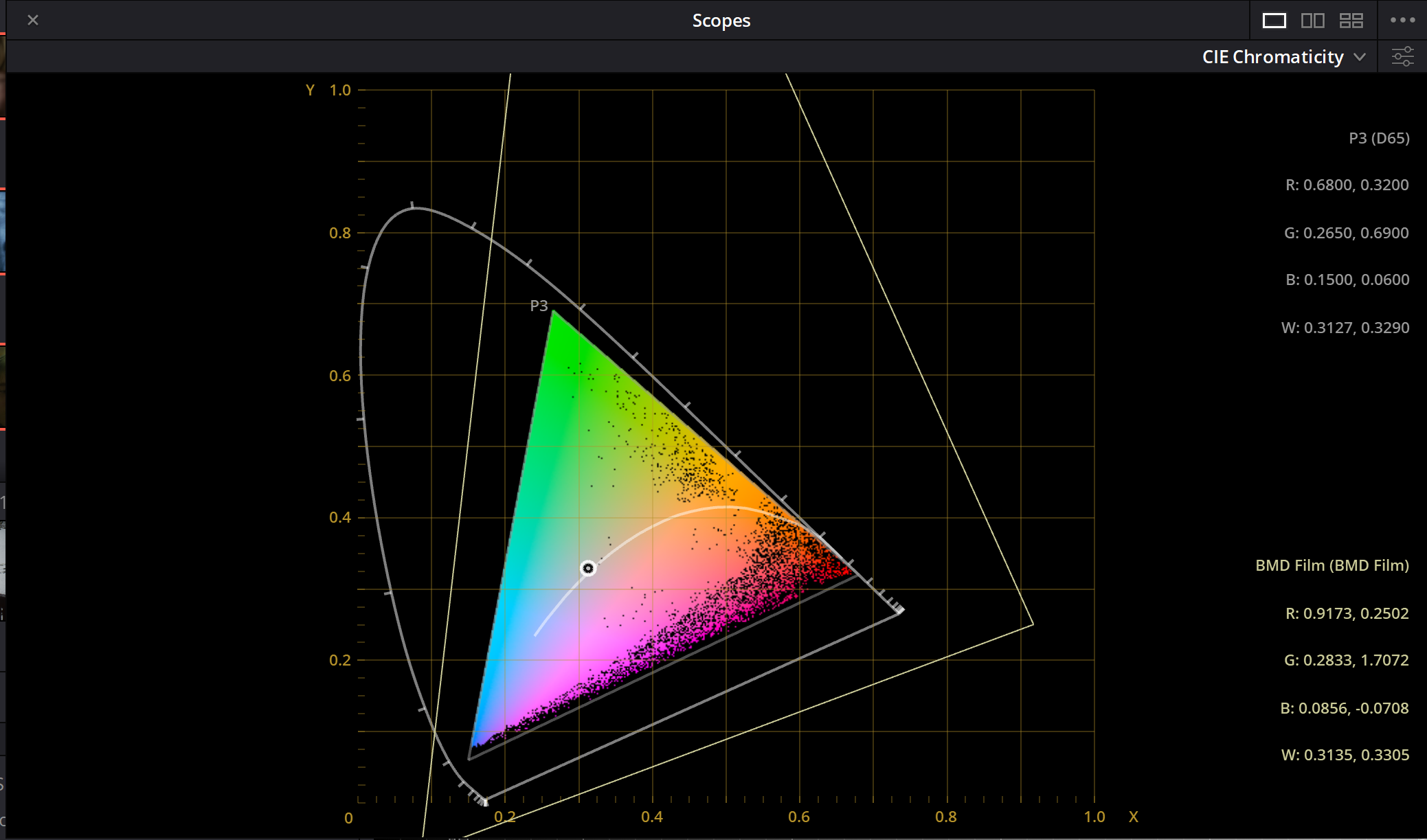

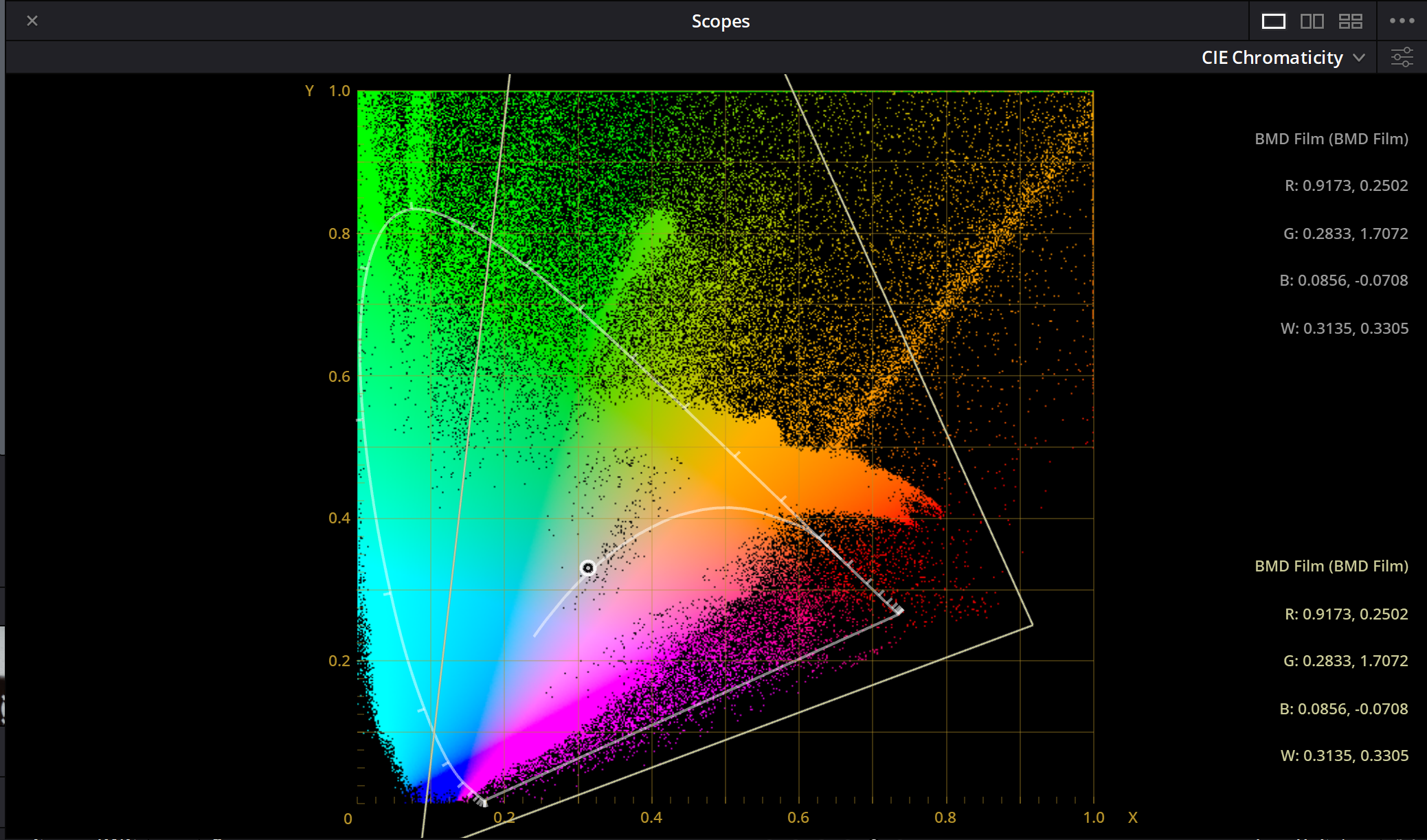

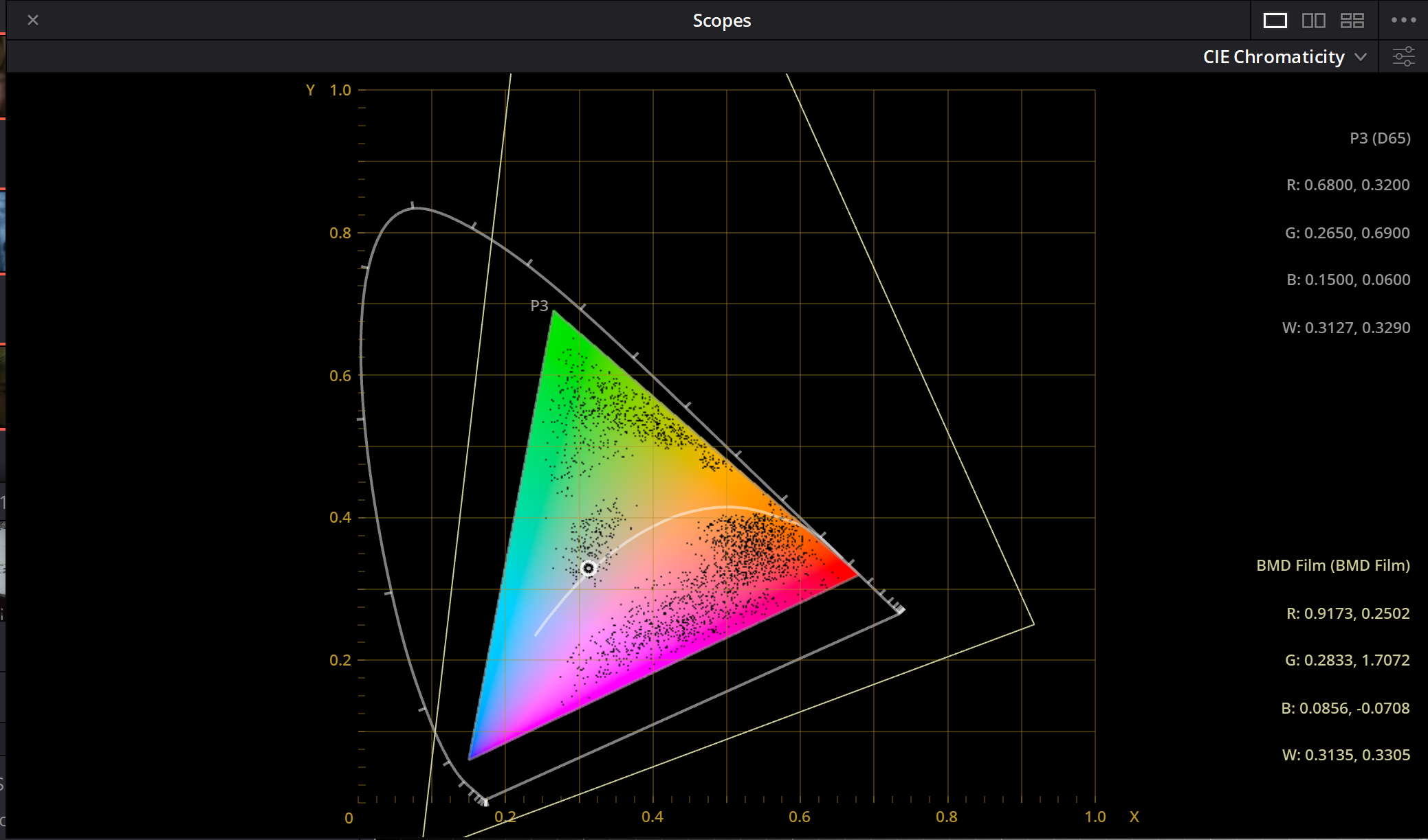

paulinventome Posted January 7, 2020 Share Posted January 7, 2020 On 1/6/2020 at 12:55 AM, CaptainHook said: "BMD Film" (version 1 which will be applied to non-BMD DNGs) will just apply a log type gamma curve and not touch colour (gamut). So you will be getting Sigma fp sensor RGB space in terms of gamut and no colour 'errors' except that a sensor response isn't meaningful on a display. To transform into a common display space would not be straight forward though unless Sigma or someone provided the correct conversion, so unless you could get something you're happy with by manually correcting the colours it might be easier and more straight forward to decode into a known defined space like 709 or something and go from there. Thanks for Clarifying officially! If you actually do this then the settings are Color Space: Blackmagic Design, Gamma: Blackmagic Design Film. The gamma curve brings all the range in and the colourspace is BMD. What does that actually mean though, you say that it won't touch gamut? To try and understand i use the CIE diagram scope. And setting the DNG to P3 vs BMD Film 1 (in a P3 timeline) i see the first two diagrams. First is BMD Film into a P3 Timeline and the second is debayering P3 into a P3 timeline. Now this is basically a point of confusion in Resolve for me - to understand what resolve is actually doing in this case. A saturated Red in sensor space in the DNG is transformed into 709/P3/BMD Film - but is that saturated Red actually mapped into the target space or is it placed at the right point. I cannot work it out. So for example if that sensor Red is outside of 709 space then IMHO Resolve could either clip the values or remap them. But if you switched to P3 and that Red lay within it then no mapping has to happen. But on the CIE diagram i do not see this. I would expect to switch between 709 and P3 and the colours inside the triangles not move. In other words in a sufficiently large colourspace on that CIE diagram i ought to be able to see what the camera space is (ish). So when i do this and choose BMD Film and set the timeline to that as well i get the 3rd diagram - which is beyond visible colours so i have to assume i just don't understand what Resolve is doing here or that CIE diagram is not working? Any light shed (pun intended) would be super nice! cheers Paul Lars Steenhoff 1 Link to comment Share on other sites More sharing options...

CaptainHook Posted January 13, 2020 Share Posted January 13, 2020 On 1/7/2020 at 9:35 PM, paulinventome said: What does that actually mean though, you say that it won't touch gamut? To try and understand i use the CIE diagram scope. And setting the DNG to P3 vs BMD Film 1 (in a P3 timeline) i see the first two diagrams. First is BMD Film into a P3 Timeline and the second is debayering P3 into a P3 timeline. So when i do this and choose BMD Film and set the timeline to that as well i get the 3rd diagram - which is beyond visible colours BMDFim Gen 1 doesn't touch gamut, so for DNG's what you get is the sensors native response to colour, which is not suitable for a typical display. You can't really map a sensors spectral response to just 3 chromaticity points like a typical gamut and show it on a CIE plot either, but people do it anyway to give a rough idea. But most sensors will definitely have a response beyond visible colours so this is expected. I don't work in the Resolve team but CIE scope in Resolve will be plotting our Blackmagic Cinema Camera spectral response as best it can because it assumes if you're using that colour space you're using our camera. It doesn't try work out a gamut for whatever camera clip you're currently viewing. So the chromaticity points for the gamut you see are based on the original Blackmagic Cinema/Pocket Camera. When you transform from one space to another, you are scaling values by a 3x3 matrix. There's no algorithm deciding if a pixel value is within a gamut to leave it a lone depending on the target gamut. It just scales it by the 3x3 matrix regardless. Resolve does have a RFX plugin though that will allow you to selectively decide how to deal with out of gamut colours when transforming from a larger space to a smaller, it's under "Gamut Mapping" in the Colour Space Transform plugin. But this isn't typical 'standard colour science', because generally you want your transforms to be "reversible" and when you start doing non-linear manipulations it gets very difficult to reverse. On 1/7/2020 at 11:15 PM, paulinventome said: That's my thinking. AFAIK highlight reconstruction happens best in XYZ space and i'd read that the BRAW files are white balanced. But that was something i'd read and have no idea whether it's true or not. It's best to white balance and do highlight recovery in native camera/sensor RGB space. Blackmagic RAW is not white balanced, its the native sensor response and we white balance it during decode. XYZ is okay to white balance in as an alternative if you can't do it in sensor space and this is possible because you can transform to XYZ from any gamut, but if you've already white balanced you can't do common highlight recovery (in XYZ or otherwise) that uses unclipped channels as during white balance you clip the highlights to ensure white = white. Link to comment Share on other sites More sharing options...
