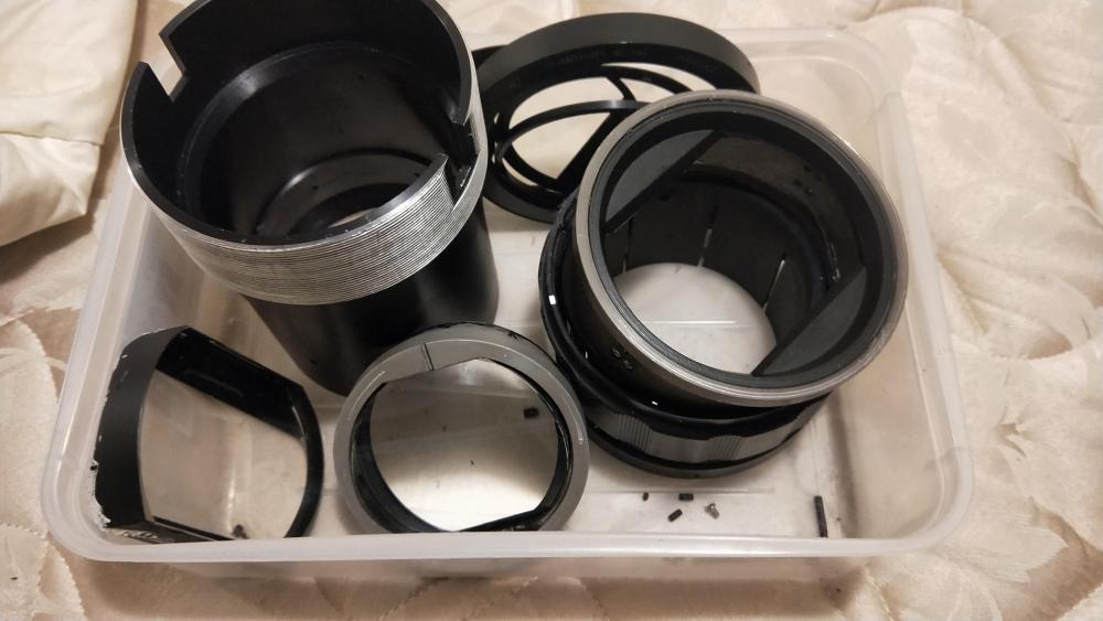

leslie Posted July 13, 2019 Share Posted July 13, 2019 i have a 35 nap-3 pulled apart at the moment. It being the cheapest i could find and i wanted to see how they worked plus i have a project in mind for it i think there are four types of nap 35. 1 being the rarest 2 being smaller and more popular than the 3 3 is quite big no 4 i cant remember much about i also have an isco gottingen which takes both hands to turn the front ring, one day i'll get around to looking at it i looked at buying from the anamorphic store however the prices weren't affordable for me. Link to comment Share on other sites More sharing options...

leslie Posted July 14, 2019 Share Posted July 14, 2019 14 hours ago, Caleb Genheimer said: I too purchased the NAP to rip apart and experiment with. Has anyone tried a negative diopter between front and rear anamorphic elements to bring them closer together? I understand that the closer they are, the lesser the squeeze ratio, but I would think it might also reduce vignetting and increase angle of view. oh.... i can see this getting competitive? Link to comment Share on other sites More sharing options...

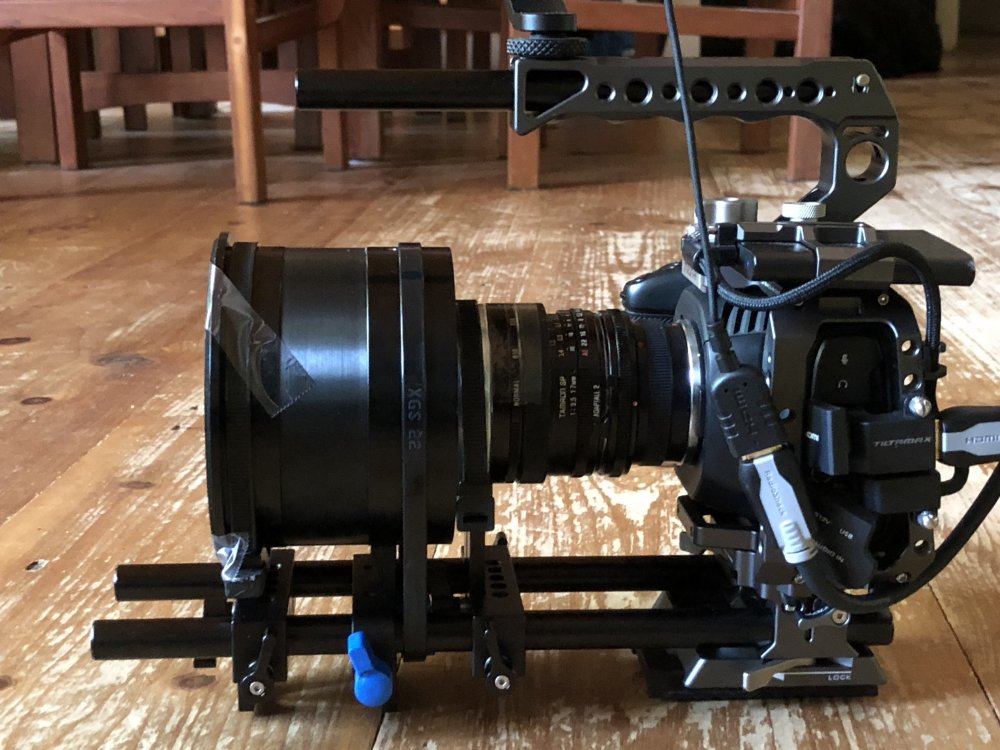

Rikoshet Posted July 23, 2019 Share Posted July 23, 2019 On 7/13/2019 at 3:37 PM, Tito Ferradans said: As for larger scopes, I've seen lots of good stuff coming from them, the issue is what kind of rig do you work with to support it. Hey Tito! Great blog you have, watching always your videos to understand better if a certain adapter is for my taste. Anyway, you have no/few large adapters reviewed on your blog! As Caleb I'm too interested in such lenses because they are affordable. I found 3 lenses: Officine Galileo Anamorfico 2x for 100eur (that one I already have but I have to use it with f like 7.3-8 and minimum focusing distance is like 4-5m, but great double blue flares btw!) Sankor Anamorphic Adapter-W for 100eur Schneider Kreuznach WA Cinelux Anamorphic adapter for 130eur. I like the idea of large lenses so I can maybe go wider, on my pocket 4k I can use sigma art 35mm but I can't find any review of last two. Of last two I'd like to know the mionimum focus distance, type of flare and its color. Any idea/opinion/link would be appreciated! Thank you! Link to comment Share on other sites More sharing options...
Tito Ferradans Posted July 24, 2019 Share Posted July 24, 2019 Hey @Rikoshet The reason I don't love big anamorphics is because although they cost you less at first, in the long run you'll be wrecked by hauling them around. Plus support gear and stress on your taking lens and camera mount. They usually have far minimum focus (past 4m), and not necessarily go wider than their smaller counterparts. Flares are a different universe and I lack info on that from lack of experimentation. Good luck! Rikoshet and ZEEK 2 Link to comment Share on other sites More sharing options...
ZEEK Posted July 24, 2019 Share Posted July 24, 2019 9 hours ago, Tito Ferradans said: You'll be wrecked by hauling them around. Plus support gear and stress on your taking lens and camera mount. They usually have far minimum focus (past 4m), and not necessarily go wider than their smaller counterparts. Agree with this. Run & Gun Anamorphic is the way to go with all these new, light weight, mirrorless cameras these days. Having great luck with the MOSTY SE 16mm 2x [GOLD], very nice anamorphic adapter indeed, rally sharp wide open, faster focus than my taking lens. Rikoshet 1 Link to comment Share on other sites More sharing options...
Rikoshet Posted July 24, 2019 Share Posted July 24, 2019 16 hours ago, Tito Ferradans said: Plus support gear and stress on your taking lens and camera mount. Well, take a look. No stress on taking lens at all. The only thing I need is a single focus unit but again, no info about compatibility... ? Ok guys, so are you telling me there are 16mm anamorphics that can be used with lets say sigma art 35mm with same crop? Link to comment Share on other sites More sharing options...
Tito Ferradans Posted July 26, 2019 Share Posted July 26, 2019 On 7/24/2019 at 11:03 AM, Rikoshet said: Well, take a look. No stress on taking lens at all. The only thing I need is a single focus unit but again, no info about compatibility... ? Ok guys, so are you telling me there are 16mm anamorphics that can be used with lets say sigma art 35mm with same crop? This image is the perfect example of why I don't like projection scopes. As for crop and FOV, you can always use the calculator. ? www.tferradans.com/anacalc/go webrunner5 and Rikoshet 2 Link to comment Share on other sites More sharing options...

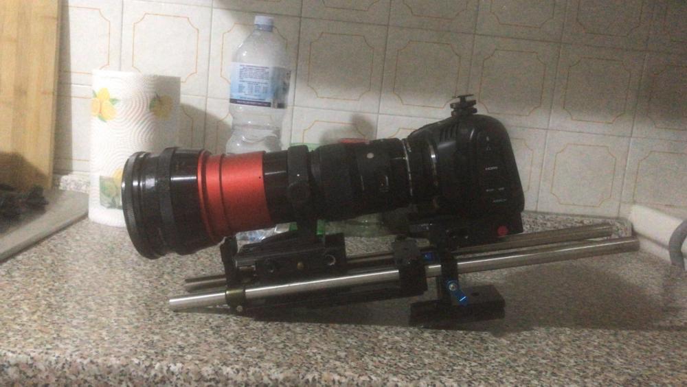

Rikoshet Posted August 9, 2019 Share Posted August 9, 2019 On 7/26/2019 at 5:42 PM, Tito Ferradans said: This image is the perfect example of why I don't like projection scopes. As for crop and FOV, you can always use the calculator. ? www.tferradans.com/anacalc/go I followed your example.Waiting for some clamps now. 120eur white/golden flares. Link to comment Share on other sites More sharing options...
