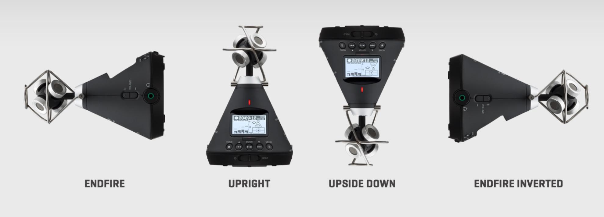

Super Members BTM_Pix Posted June 4, 2019 Super Members Share Posted June 4, 2019 First of all, this is not some big comprehensive review but just a brief look and some samples that I took on the first day that I took it out. OK, with that disclaimer out of the way, lets have a look at it. The H3-VR is an integrated ambisonic microphone array and recorder and you can find the full product information here https://www.zoom-na.com/products/field-video-recording/field-recording/zoom-h3-vr-handy-recorder Basically, what it allows you to do is record the output from its 4 microphones either as a stereo binaural track or as a 4 channel ambisonics B format which you can then manipulate in post to effectively simulate changing the mic position after the fact. If you want a bit of a primer on ambisonics then this link will sort you out https://www.waves.com/ambisonics-explained-guide-for-sound-engineers I've mentioned the H3-VR a few times in responses in various threads about field recording, particularly with regard to ambient tracks, so on my last trip I decided that it was time to put my money where my mouth was and actually buy one. Well, with the proviso that I found one cheap enough, which I did, so here we are. First impressions are that it is much smaller than I had expected which is no bad thing and very, very light so its not going to be a problem to mount it on a camera. Here it is on the very diminutive OG Pocket Cinema Camera which I was using for testing it with. Incidentally, the foam shield is included in the box but I'd budget for a deadcat if you are using it outdoors and I'd probably also caution against mounting like it is here as it is very prone to handling noise even as transference from operating the camera controls. It is very straightforward to use as it has a good menu system and you can record in an array of stereo and B format modes and it also has a headphone monitor which you can select to be stereo or binaural. This option is also available on the line out so for the examples further down they are sent to the camera as a binaural mix but still recorded in B format in the recorder for later manipulation if necessary. To make post sync easy, you have the option for it to send a tone burst to the camera at the start of each recording and the H3-VR also has an inbuilt gyro so that it knows which way is up as it where in terms of where the microphones were during the recording. This function is also used for shooting 360 videos as it allows the unit to be connected upside down under a 360 camera to keep it out of shot and also enables you to use it in end-fire mode. Specs wise, it can record in various formats up to and including 24bit/96Khz so you can have a decent amount of headroom for your recordings but there is also a limiter and lo cut filters to give you a bit more security. My interest in this system is partly for VR but primarily for general ambience recording to create a more immersive soundscape with the ability to do some manipulation of the sound targeting in post production. Its worth bearing in mind that until very, very recently, having a B format microphone array and recording setup (let alone one that can fit in a large pocket and runs off two AA batteries) was a very specialist niche with a price tag to match so you'll have to manage your expectations about matching something like that but I've got to say that for me its going to be a very useful little item to supplement rather than replace other sound recording gear I've got. For these examples, I chose two different scenarios (although they are only about 15 minutes walk away from each other in Tokyo!) to illustrate its use in capturing soundscapes with different densities and degrees of subtlety. The audio on these is from the line out of the H3VR set to binaural stereo straight into the OG Pocket Cinema Camera whilst the H3-VR was recording them internally in the 4 channel B Format (Ambix in this case). Make sure you put some decent headphones on to listen and you should be able to pick up some degree of height and rear positioning of sounds within the environment and as objects move around it. If you want to experiment with manipulating the B format files, Zoom have a standalone player that enables you to do this This is available free from https://www.zoom-na.com/products/field-video-recording/field-recording/zoom-h3-vr-handy-recorder#downloads And I have put the original B format files from the H3VR from the videos above for you to download and use with it here https://mega.nz/#!RqYQXSpB!Ydluy4G-ouMIEJbJyWWTAzcG4DIUU47G2GNKhMyVpJM OK, thats it for now, as this is very much just an initial look at it and I'll return to flesh it out with more information as I use it a bit more but hope some of you can find some use in it. newfoundmass, heart0less, Francisco Rios and 5 others 4 4 Link to comment Share on other sites More sharing options...

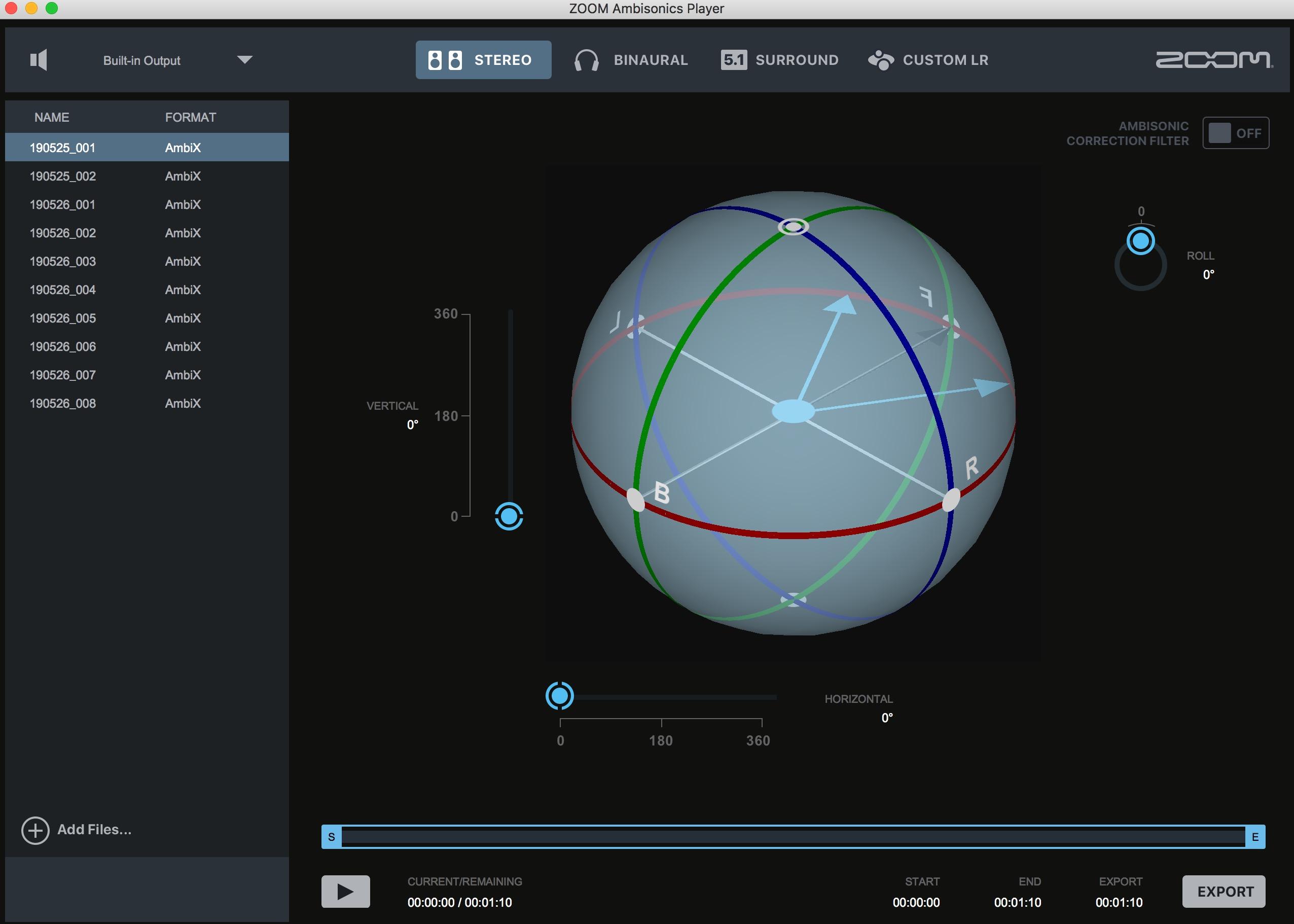

3DstuffTokyo Posted June 25, 2020 Share Posted June 25, 2020 I just got one of these and wondering what is best format to record in where you can convert to whatever you need in post? Hoping to use in VR where I can use binaural or ambisonic You in Japan? Any other way to get in touch? Sincerely, steve Link to comment Share on other sites More sharing options...
IronFilm Posted June 26, 2020 Share Posted June 26, 2020 20 hours ago, 3DstuffTokyo said: I just got one of these and wondering what is best format to record in where you can convert to whatever you need in post? If you're converting it in post, then record in A Format 3DstuffTokyo 1 Link to comment Share on other sites More sharing options...
Super Members BTM_Pix Posted June 26, 2020 Author Super Members Share Posted June 26, 2020 On 6/25/2020 at 8:15 AM, 3DstuffTokyo said: I just got one of these and wondering what is best format to record in where you can convert to whatever you need in post? Hoping to use in VR where I can use binaural or ambisonic You in Japan? Any other way to get in touch? Sincerely, steve As @IronFilm says, A format will give you the most flexibility as it is a raw recording of each of the four capsules and the Zoom Ambisonics Player app can then convert that to B format (or to stereo, binaural and 5.1 too) for you to then drop in to your editing system. The B format encoder that is built in to the H3VR will save you the step of having to run it through the Ambisonics Player app, something which, due to app not having a batch process capability, can become quite tedious and time consuming if you have a lot of clips. Because I am inherently a lazy bugger, thats why I record on the H3VR in B format to avoid the extra steps and use its internal down mix feature to record a live binaural feed into the camera as often the latter is all I need but can still have the option to tweak it using the B format files during the edit if I need to. 3DstuffTokyo 1 Link to comment Share on other sites More sharing options...
