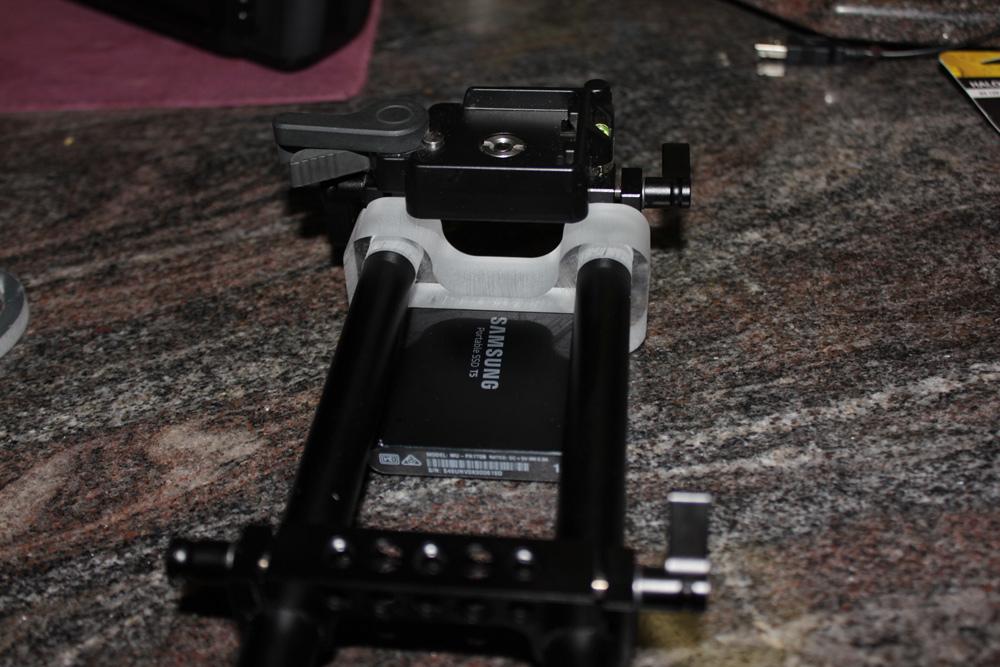

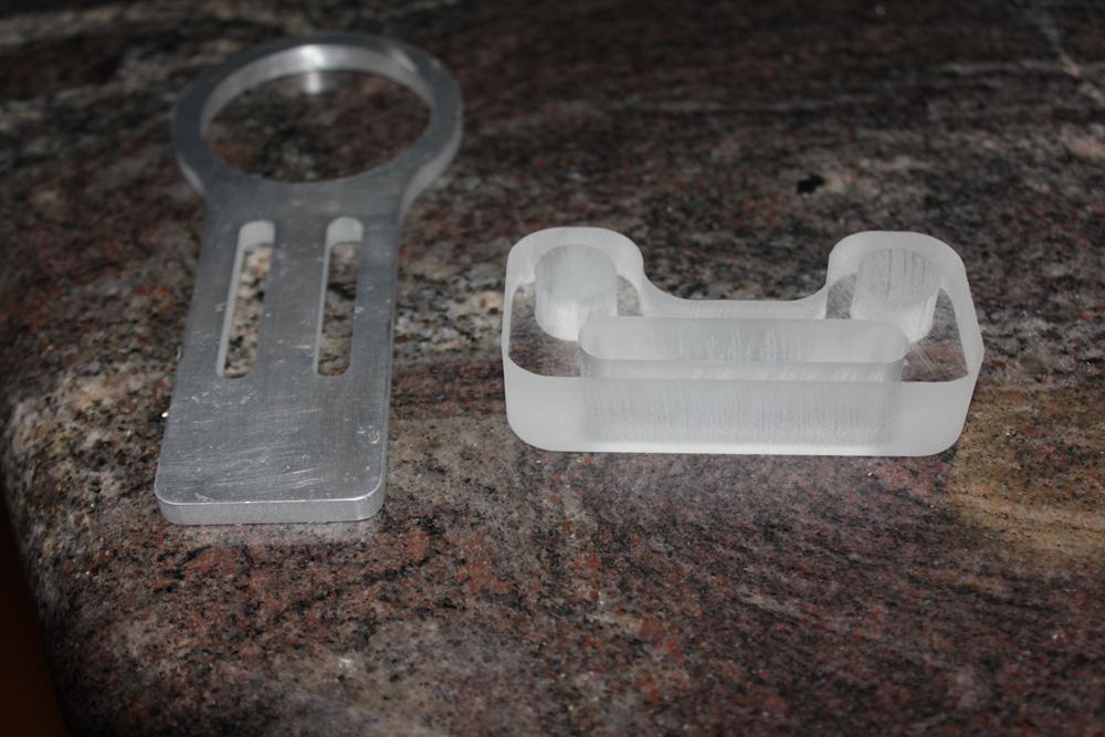

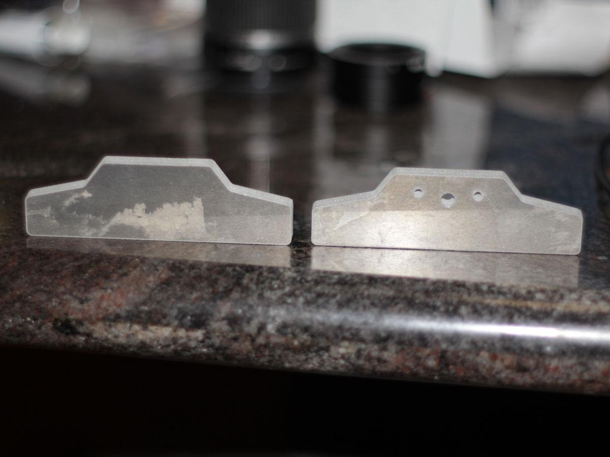

leslie Posted April 18, 2019 Author Share Posted April 18, 2019 Did a bit of redesign this week, got two pieces cut on the waterjet for testing purposes. I changed the design of the ssd holder it now sits beneath the smallrig 15mm rails surprisingly my measurements were rather accurate and all i had to do was a little sanding to made things slide together. if i had to do it again i'd made things 0 .1 mm bigger for some wiggle room. The alloy clamp required the most time, broke out the dremel for that. The alloy holder clamp is a bit tall at the moment, i made it that way as i was guessing abit at the time. The last two pics are a bit of a mock up at the moment. i actually have the original clamp holder on the back at the moment. Not sure if i will get that machined to hold a step down ring or do something different. I am however happy that more progress has been made. webrunner5, billdoubleu, kye and 1 other 4 Link to comment Share on other sites More sharing options...

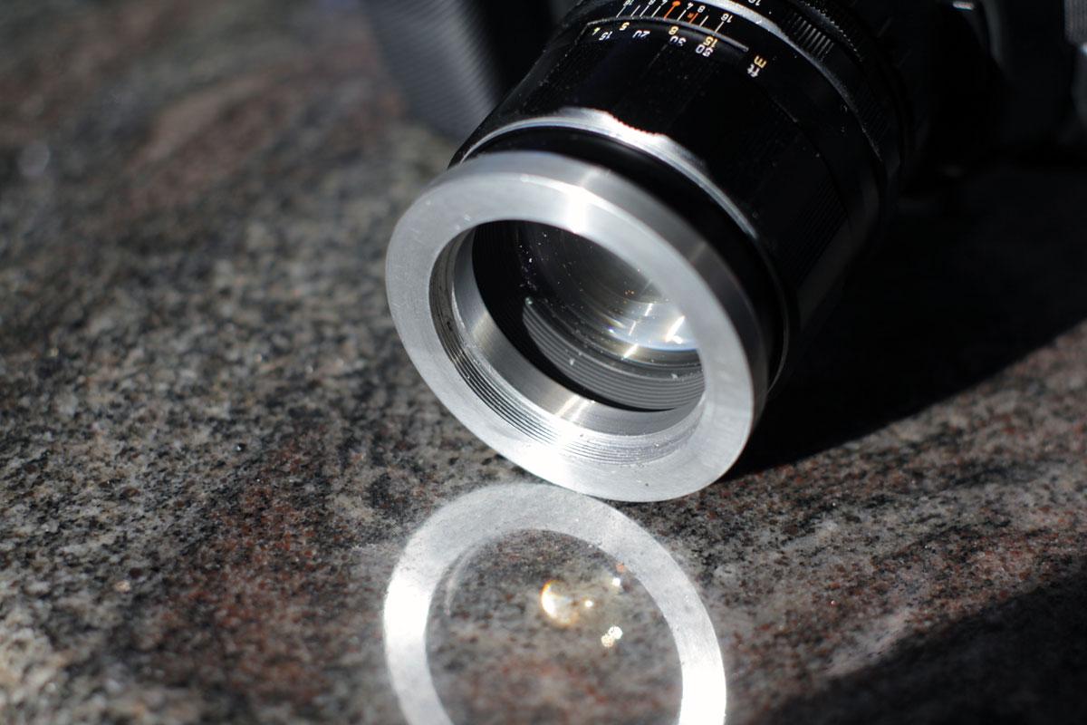

leslie Posted May 8, 2019 Author Share Posted May 8, 2019 did some ringing around, then drove to the other side of town. found a place to machine me an adapter from the elmoscope to a standard filter thread. The elmoscope is 50mm on the rear thread, it seems the pitch is .75 as far as we have been able to ascertain at the moment. if dimensions change i'll post them for posterity later . Most popular thread sizes for cameras seem to be 49mm or 52mm then 55mm which makes the 50mm of the elmoscope a bit of an oddball . I think i may have to incorporate some kind of sleeve arrangement in the adapter, as if i can thread an adapter onto the back of the elmoscope i can pretty much guarantee the anamorphics in the scope wont align correctly. I will give it some thought over the next few days and proceed ahead next week. Its kinda exciting to being so close to being an anamorphic videographer? kye 1 Link to comment Share on other sites More sharing options...

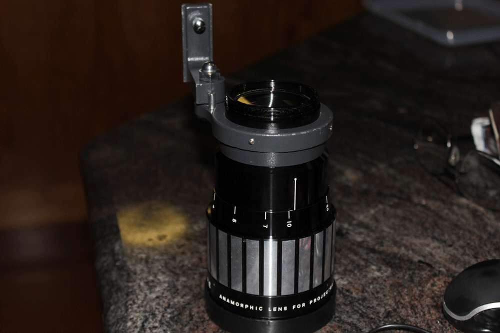

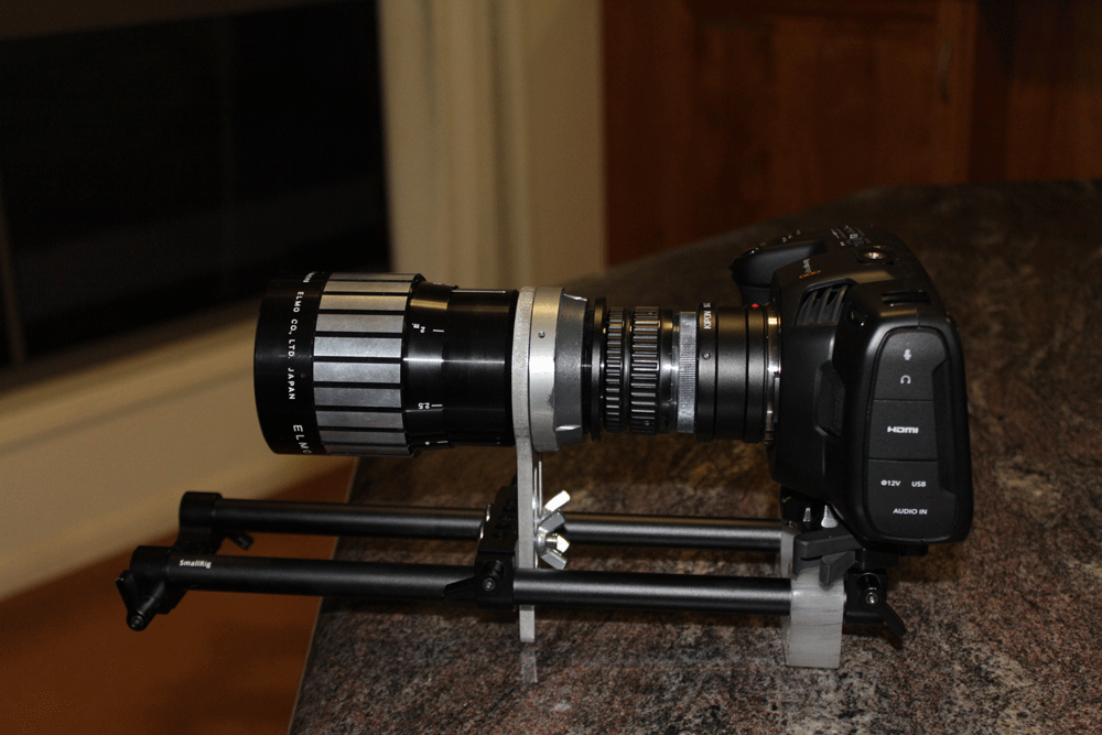

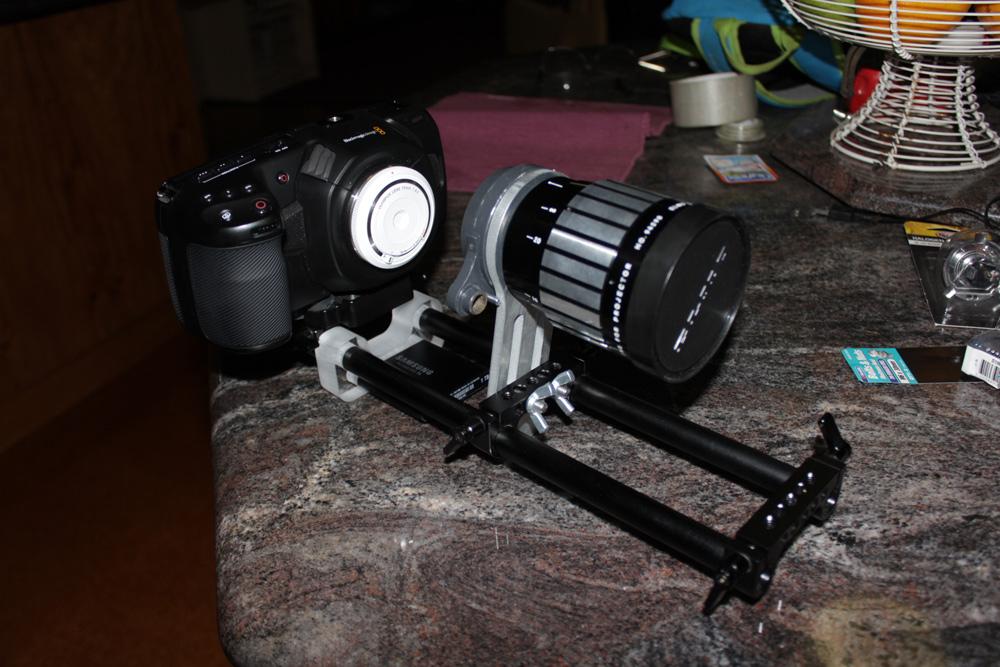

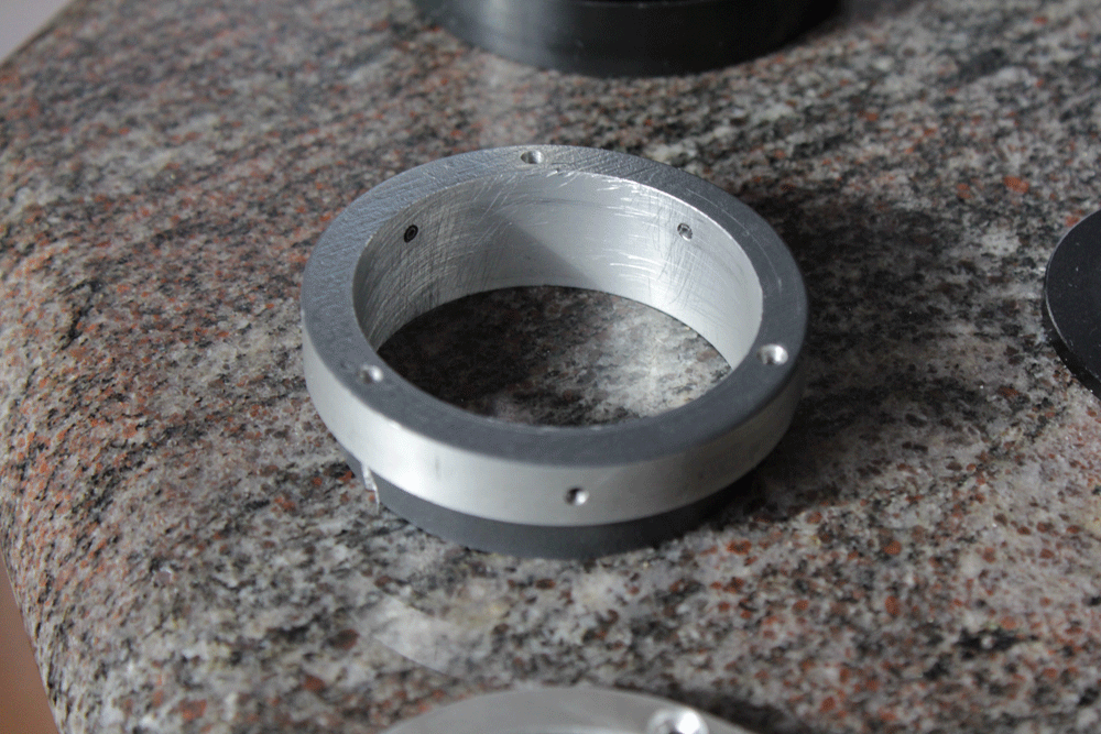

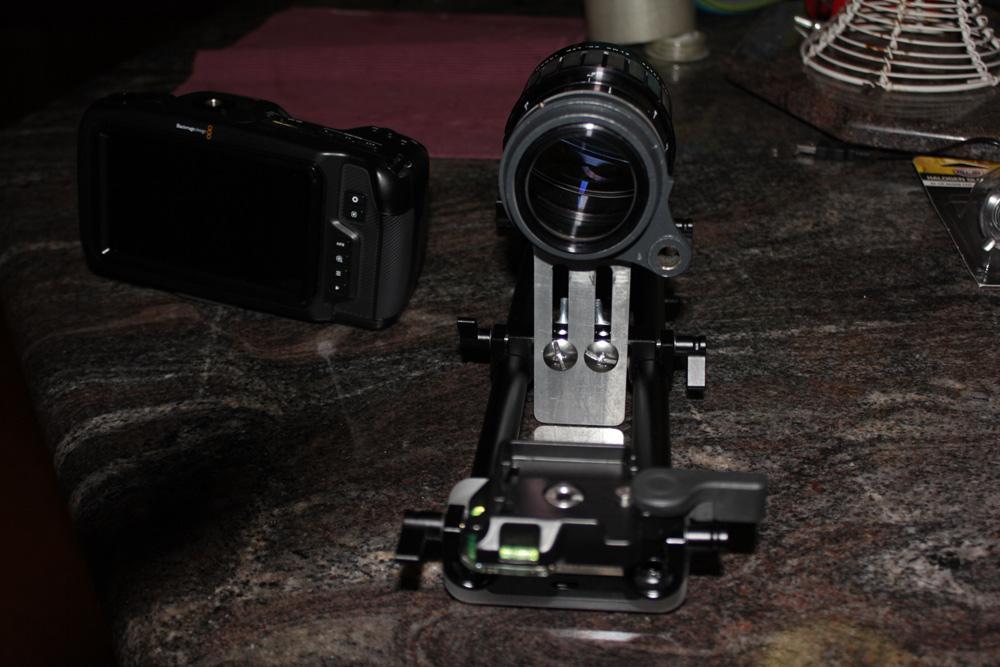

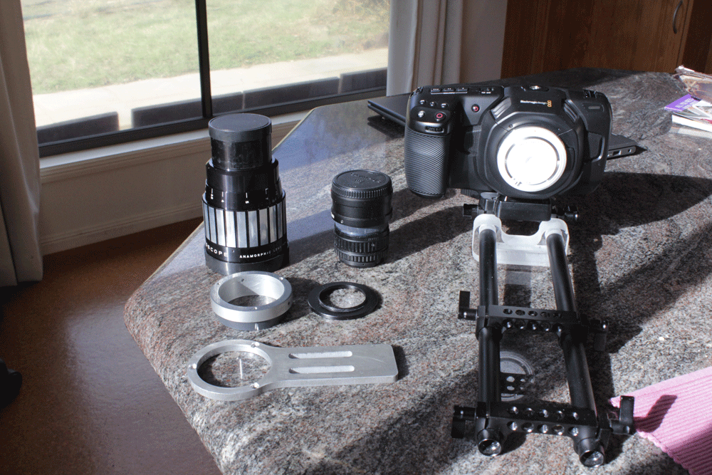

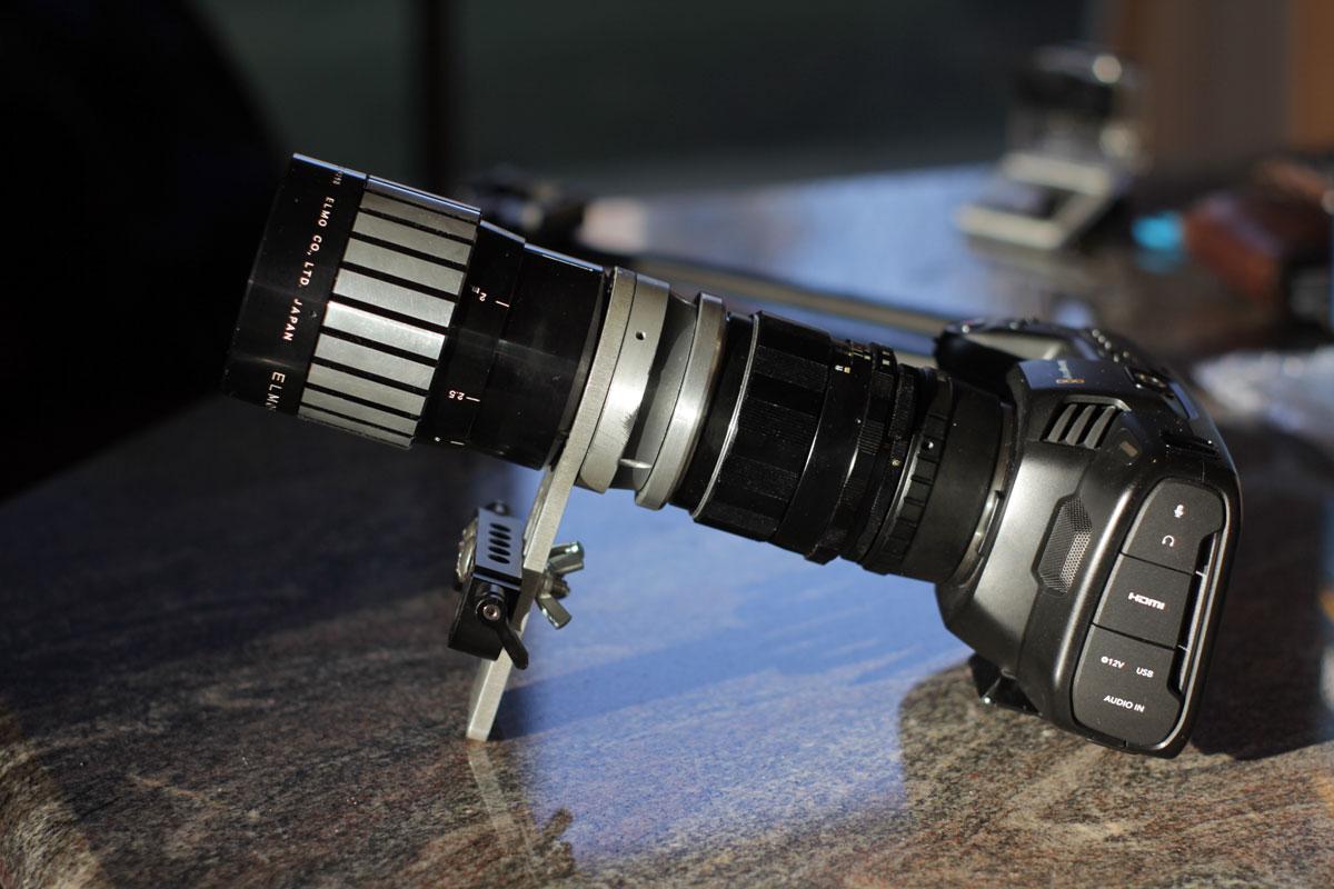

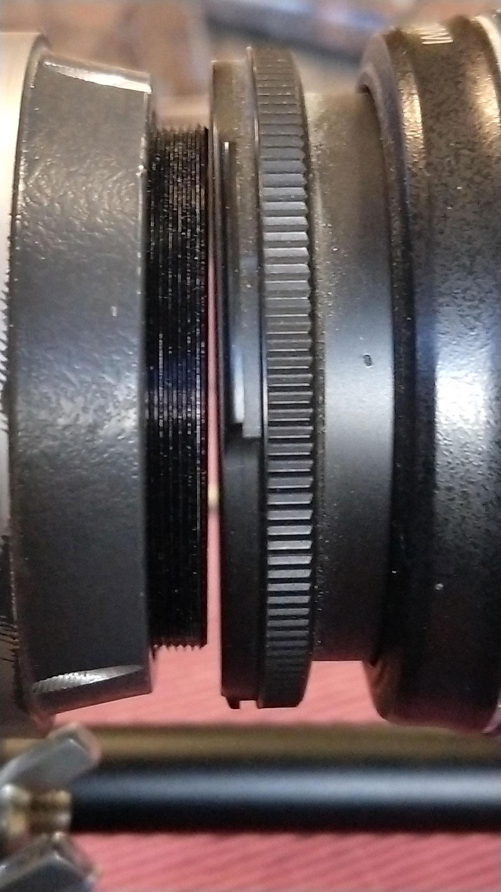

leslie Posted May 26, 2019 Author Share Posted May 26, 2019 ok i know your all been waiting with bated breath. Picked up the anamorphic mount this morning the first couple of pics show the old projector mount. I had the old positioning arm machined off and one additional 3mm grub screw machined into the bottom of the mount and three bolts machined through the anamorphic lens leg holder into the old mount. The bolt pattern was offset about 30 degrees to stop bolts from hitting the grub screws. the first time i fitted it together the anamorphic and bmp4k, i had a real issue with alignment. The bmp4k was not parallel to the smallrig. It was leaning backwoods quite noticeably. I then tried the canon 60d and it was closer to parallel. I then pulled it all apart upon inspection the cheap quick release tripod rocks a little when placed on a table top so that might be my problem. I did turn the tripod release around and now its alot closer to parallel close enough for me to play with anyway. there's also an issue with the bmp4k spinning a little on the quick release, i put it down to the small contact suface of the quick release and the bmp4k base plate has a recessed area with a high ridges around the edge. Its not a major issue, so far its kinda my only gripe with the camera and as gripes go in the overall scheme of things its a pretty small one The bmp4k has one small hole each side of the socket. i'm willing to bet good money that any accessory that bm brings out has prongs on it that slot into those holes next to the tripod socket and prevent any slippage. Because i plan on shooting anamorphic, once i get a threaded connection between the anamorphic and the taking lens, i think the camera twisting issue will go away. i did get a couple of quick backyard shots late in the day. First thing i notice with the canon connected to the anamorphic was that i get the confirm beep and focus mark regardless of whether its actually focused or not, which i found rather intriguing. I guess its the anamorphic optics confusing the camera somehow. I also had the el nikor 63mm enlarger lens and bmp4k connected briefly and i could get focus peaking on some clouds and trees in the distance but it was getting late by then. the el nikor 63mm doesn't vignette on the bmp4k. The standard 18-55mm canon kit lens vignettes from bad at the wide end and a litle bit when zoomed in. I'll get some photos next week as i have just about run out of weekend. not sure if i saved the cat and yard pictures correctly photoshop displays them correctly but i think i need to crop them maybe will have to investigate more hmm those last two pics do look odd, i guess i have some homework, looks like photoshop displays them ok but it doesn't save them in that format. kye 1 Link to comment Share on other sites More sharing options...
kye Posted May 26, 2019 Share Posted May 26, 2019 8 hours ago, leslie said: hmm those last two pics do look odd, i guess i have some homework, looks like photoshop displays them ok but it doesn't save them in that format. Can you just pull them into PS and rescale them manually, stretching it by the right ratio? Link to comment Share on other sites More sharing options...

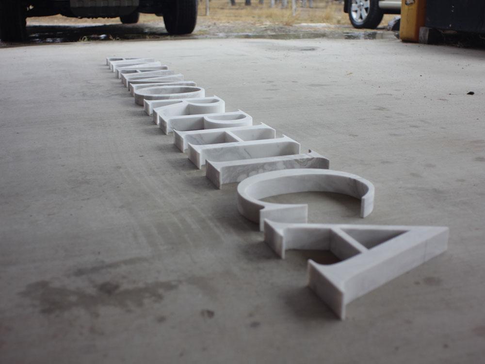

leslie Posted May 30, 2019 Author Share Posted May 30, 2019 yes gonna try that shortly just didn't have the originals with me when i posted the last comment. i hope to get some footage to upload shortly been planning to do it for awhile but there's been some hiccups, and working away from home tends to defeat any sort of planning i do. on the bright side i have got all the letters for my logo on the youtube channel cut on the waterjet. so that aught to add an extra element. Probably could do something in resolve but i thought i'd go oldschool Link to comment Share on other sites More sharing options...

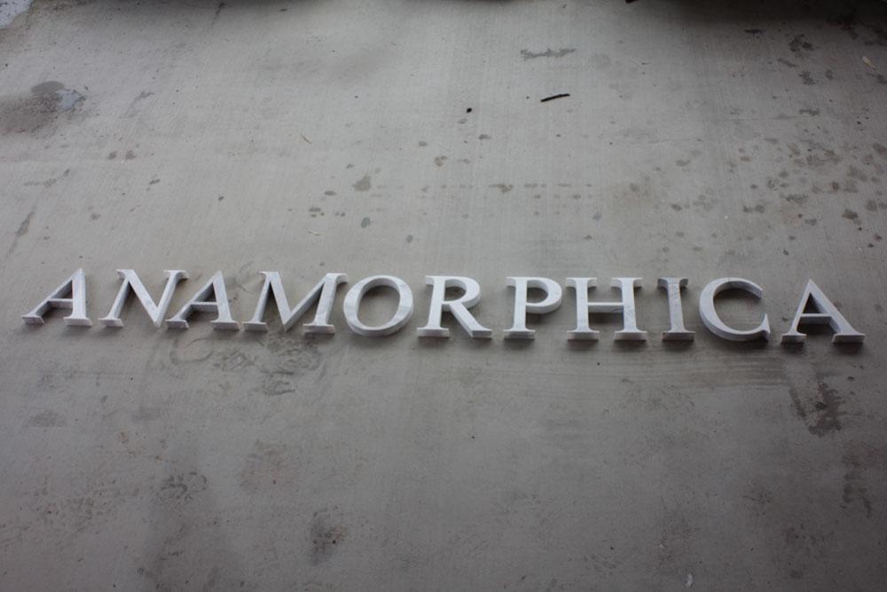

leslie Posted June 2, 2019 Author Share Posted June 2, 2019 i'm excited its rained not heavy rain, but rain none the less. Which is wonderful seeing as most of western queensland is drought declared. So been undercover doing a few things. Heres a sneek peek of my youtube logo, got alot of sanding and polishing to do but you get the idea and remember you saw it here first ?. Those letters are 200mm high i did them big as a few of the smaller prototypes broke so i gave them some size to give em some strength. Their cut out of marble i had hoped to get some veining through the marble, some of that colour will come out when their polished i hope. kye, matthere, BTM_Pix and 1 other 4 Link to comment Share on other sites More sharing options...

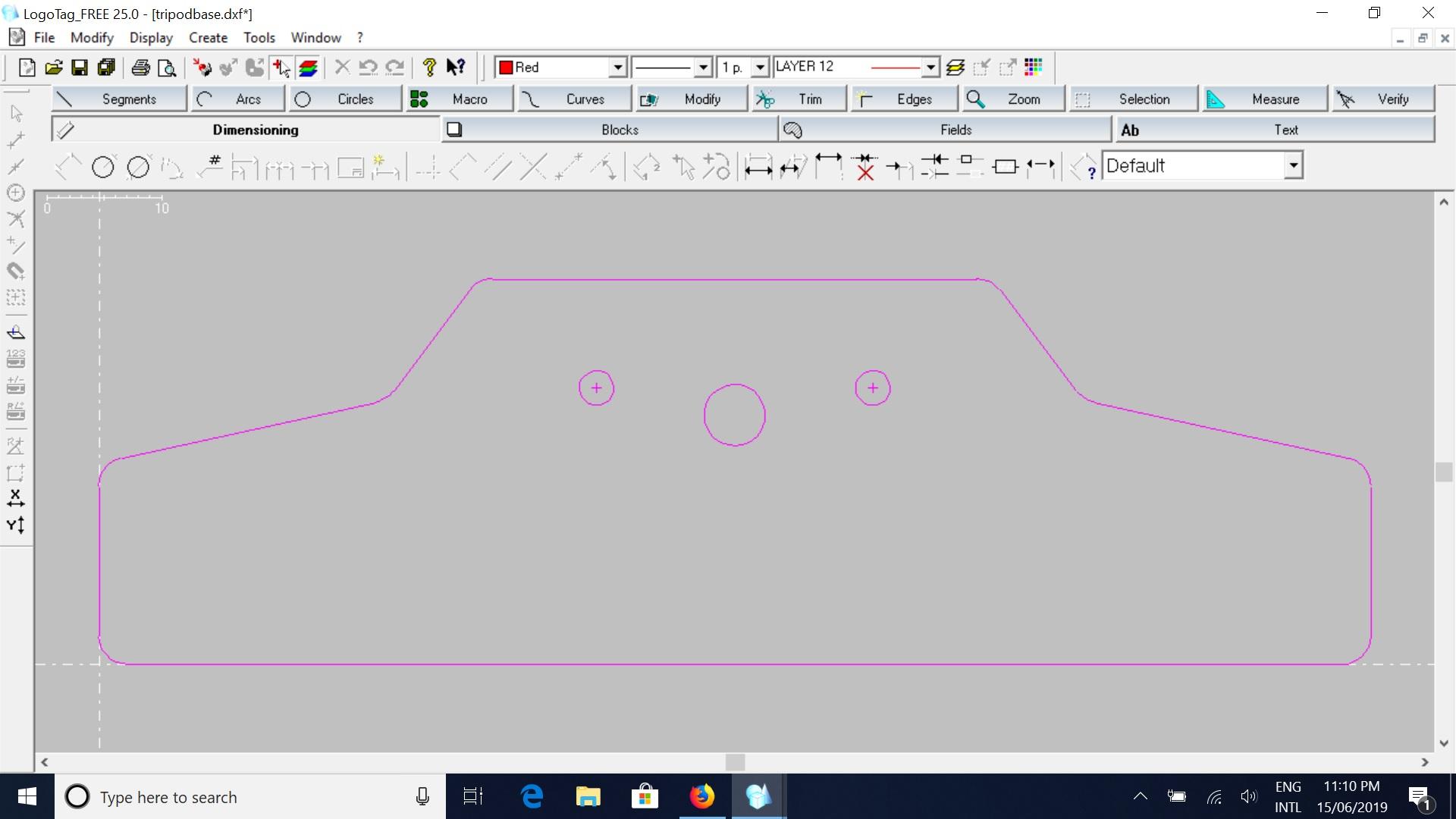

leslie Posted June 22, 2019 Author Share Posted June 22, 2019 been a busy week. Got the tripod base cutout got two made. One has holes in it, the other is blank. got some ideas about milling out the perspex base i had made earlier and inserting the tripod base into it, kinda still at the ideas stage with it at the moment. I also picked up the last part for the anamorphic adapter. its kinda like a step up ring but more substantial it will take the weight of the anamorphic, but i do plan on using support anyway. Had the pentax m42 85mm 1.9 attached. I think its 58mm thread size. alignment was a little bit off when tightened up, thought about it for a bit then applied a rubber band to the rear of the anamorphic right where the threads end and put it all together tightens up quite nicely, seems to work as a temporary fix for now. This afternoon i found out i can melt lead and quite easily it seems. I used my gopro4 with a letus anamorphic lens attached, filmed some and then timelapsed the rest, yet to import it into resolve and have play with it. Hopefully its a little bit interesting. Had a lamb born about lunch time today, mom brought it up this afternoon, canon 60 d m42 50mm 1.4 lens. So there is a bit of a mix picture wise. enjoy kye and BTM_Pix 2 Link to comment Share on other sites More sharing options...
