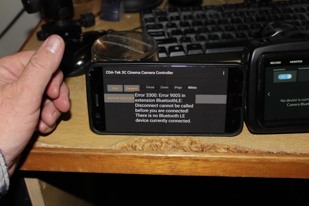

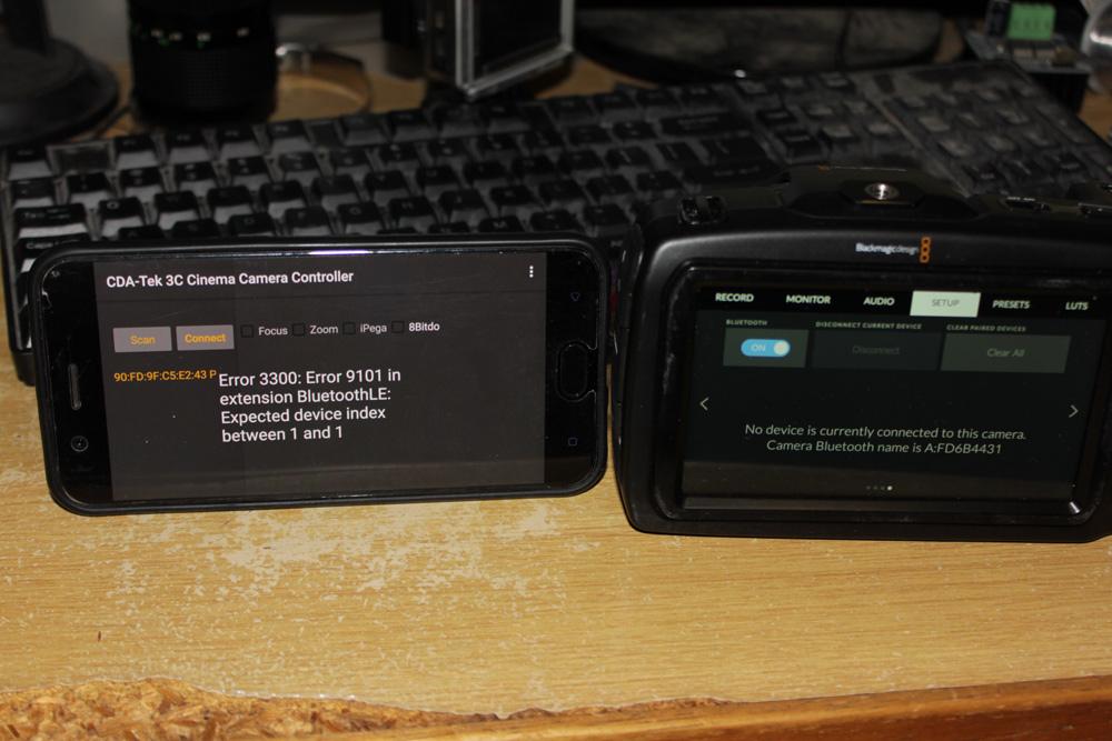

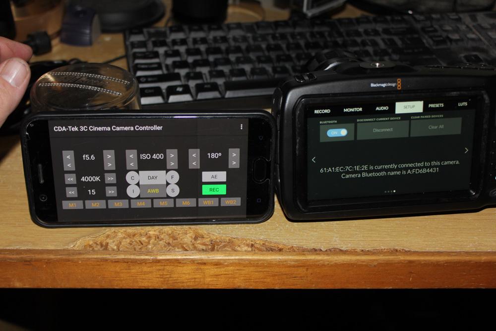

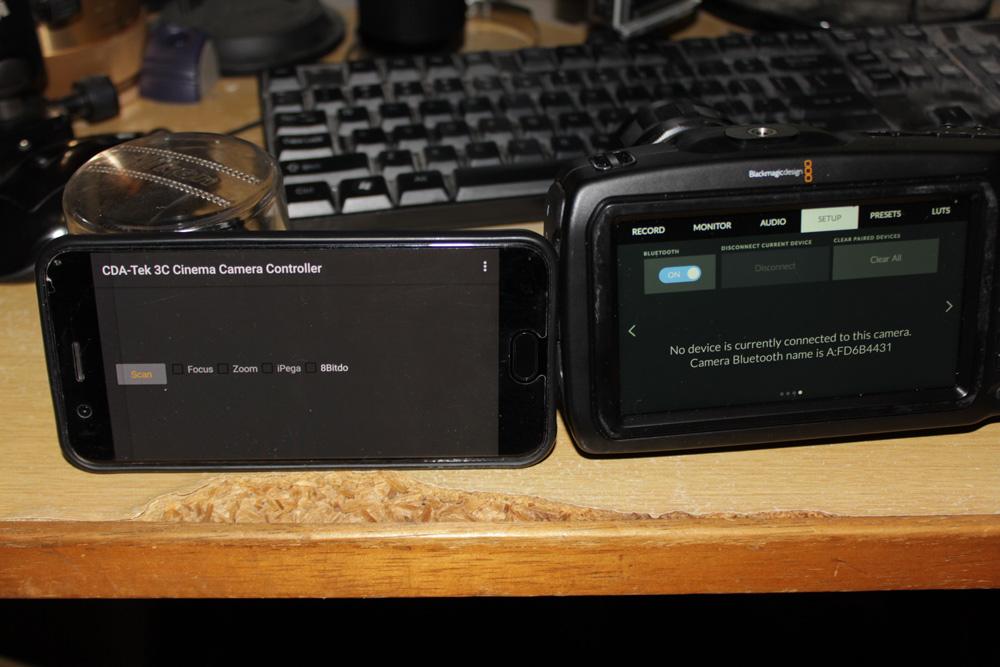

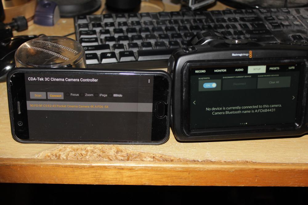

leslie Posted March 16, 2019 Author Share Posted March 16, 2019 Well i have been shopping online... bought an interesting (lens) which came to my attention while i was looking at something else and i'm bidding on another, the Olympus 15mm body cap lens. i watched some youtubes on it and it seems a little quirky perhaps but at least i'll always have a lens on the front till i find something else and its pretty cheap. btw kye this is all your fault bought and installed btm's app, had some teething issues with my oppo r11, however btm has since sorted me out and it now works. So if you have an oppo r11 it may prove helpful to turn on location services when you turn on bluetooth le. once your paired you can open the ctek app scan for your camera, when the camera is found you can highlight the camera and attempt to connect to it. you might get an error like i do, so wait a few moments and try to connect again.. i have to press the connect button a couple of times and then it will connect btx the fifth and last image is the first error message i was getting maybe it will help you with further trouble shooting BTM_Pix 1 Link to comment Share on other sites More sharing options...
Super Members BTM_Pix Posted March 16, 2019 Super Members Share Posted March 16, 2019 18 minutes ago, leslie said: Well i have been shopping online... bought an interesting (lens) which came to my attention while i was looking at something else and i'm bidding on another, the Olympus 15mm body cap lens. i watched some youtubes on it and it seems a little quirky perhaps but at least i'll always have a lens on the front till i find something else and its pretty cheap. btw kye this is all your fault bought and installed btm's app, had some teething issues with my oppo r11, however btm has since sorted me out and it now works. So if you have an oppo r11 it may prove helpful to turn on location services when you turn on bluetooth le. once your paired you can open the ctek app scan for your camera, when the camera is found you can highlight the camera and attempt to connect to it. you might get an error like i do, so wait a few moments and try to connect again.. i have to press the connect button a couple of times and then it will connect btx the fifth and last image is the first error message i was getting maybe it will help you with further trouble shooting Yep, the last image is because it is not showing in the scan which means that the camera still thinks its connected. Exiting the app through the Close Application in the top right menu ensures that the connection is terminated correctly. There is a v1.11 update that I'll put up tomorrow to filter out non-Blackmagic devices during the scan which helps A) if you are in a very congested public place and B) if your phone scans very slowly as it appears to be the case from looking at some reports of that particular one. I am off to a place that satisfies criteria A this afternoon to test it and it will automatically update your app when its published tomorrow. Emanuel 1 Link to comment Share on other sites More sharing options...
leslie Posted March 16, 2019 Author Share Posted March 16, 2019 1 minute ago, BTM_Pix said: Yep, the last image is because it is not showing in the scan which means that the camera still thinks its connected. Exiting the app through the Close Application in the top right menu ensures that the connection is terminated correctly. There is a v1.11 update that I'll put up tomorrow to filter out non-Blackmagic devices during the scan which helps A) if you are in a very congested public place and B) if your phone scans very slowly as it appears to be the case from looking at some reports of that particular one. I am off to a place that satisfies criteria A this afternoon to test it and it will automatically update your app when its published tomorrow. awesome ? Link to comment Share on other sites More sharing options...
Super Members BTM_Pix Posted March 16, 2019 Super Members Share Posted March 16, 2019 6 hours ago, leslie said: awesome ? Here are the screenshots of it in action today in a city centre. First scan shows everyone's Fitbits etc as well as the camera. You now click on Search List and enter the filter term you want (I chose "Camera") And then it filters all of the other devices out. You could choose "4K" or whatever but I decided against a default in case people have renamed their cameras. Trek of Joy and leslie 1 1 Link to comment Share on other sites More sharing options...

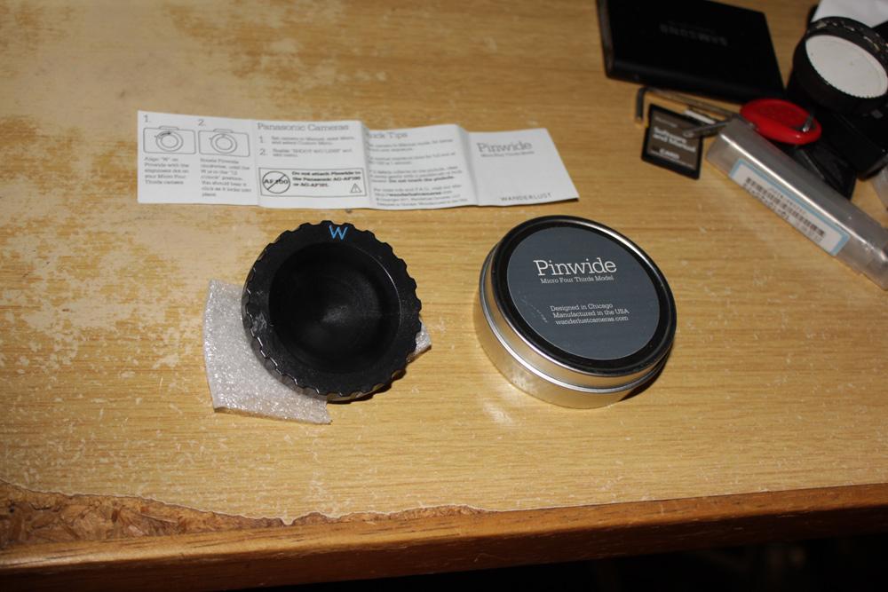

leslie Posted March 22, 2019 Author Share Posted March 22, 2019 one of my lenses .... er lens caps has turned up. its a wandalust pinhole for m4/3 keen to give it a bit of a go tomorrow getting a bit late here and this thing equates to like f92 or something. got a couple of hours to go on bidding for an olympus 15mm bodycap lens if i don't win this auction i might just buy one ? i guess it seems abit odd to go get a 4k camera then not throw a couple of stellar cine lenses at it ? i find the 300mm takumar a little soft and a bit of ca happening as well. i downloaded some resolve beginner tutorials which i plan on working my way through after that i plan on revisiting the moon a bit more with my meade lightbridge which might make things a little more interesting Link to comment Share on other sites More sharing options...

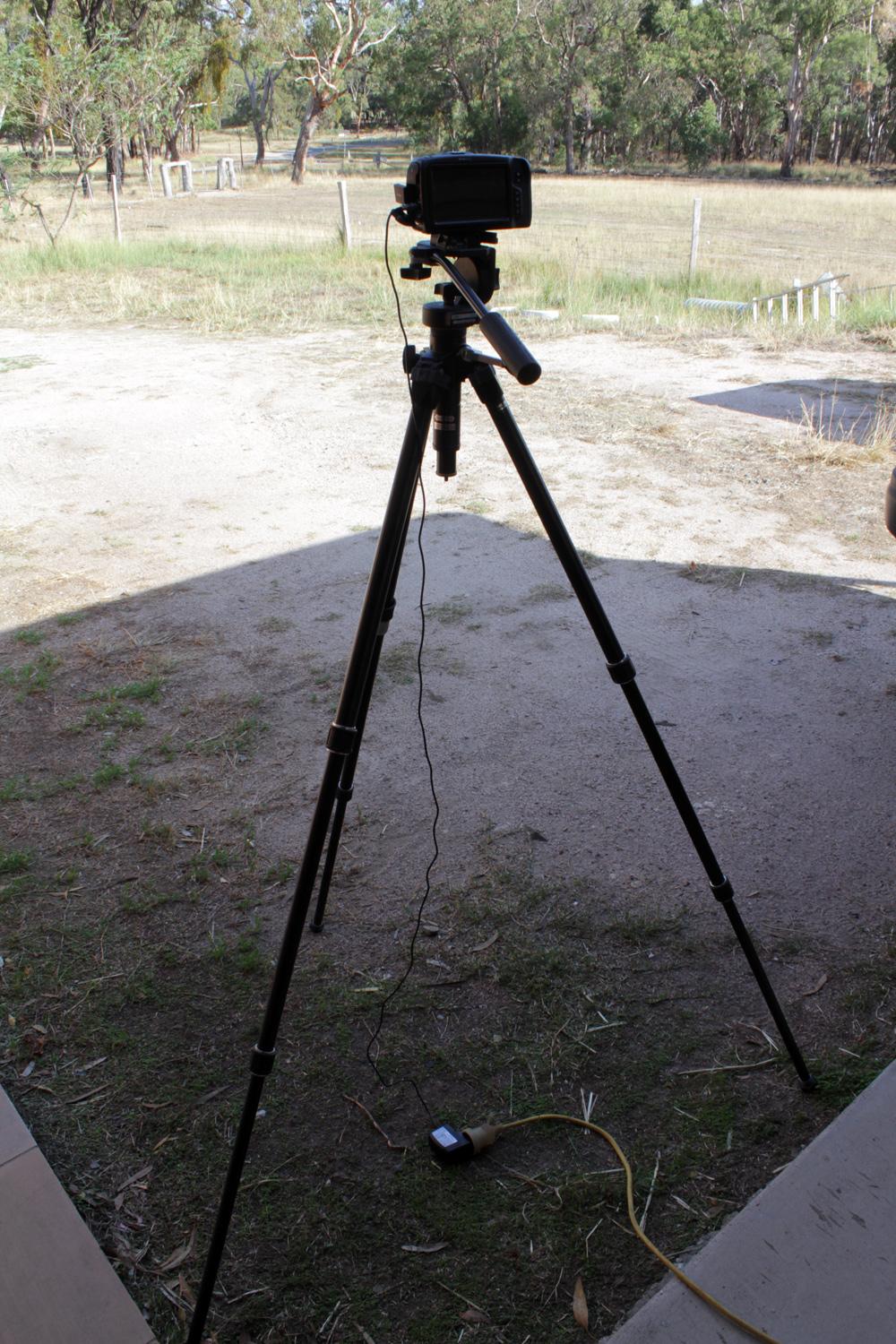

leslie Posted March 23, 2019 Author Share Posted March 23, 2019 Had the wandalust pinhole lens on the p4k today played with some settings but i think it will be some time before i have something inspiring to show . i have seen some stuff online and suspect its been processed for want of a better word. so more work or learning required, i think. Kinda hoping to be able to use it in a dreamy surreal sort of way. I did notice one other thing today and that is the length of the wall plugpack to the camera is just long enough to let the plugpack rest on the ground and not have any undue weight on the connection as it goes into the camera when mounted on a tripod. Which is a nice touch i think. One more thing i finished an el nikor 63mm enlarger lens m39 to m42 ef adapter today as well. If i unscrew the ef mount i can then screw it into a m42 to m4/3 adapter i have. Gonna take a video of few seconds of tonight's moon and see if the infinity focus is to the same point as when mounted to the ef mount which would save me making making another adapter for the bm and place me one step closer to shooting anamorphic. i know the el nikor 63mm is meant for full frame. However i figure with the prices climbing all the time i might as well get one and be done with it and be future proof if i ever get a full frame. Not sure on m/43 how wide i can go for a taking lens but i think i'll have a look around for a 50 mm el nikor enlarging lens next and see how that goes. By the way has anyone seen anything shorter than a 50 mm enlarger lens as i am rather curious about the potential Another thing learned i can record 8.05 seconds of hq prores 4k dci on my cheap toshiba 32g card before it drops frames in case anyone was wondering. i should try cinema dng and see what i get for posterity My manfroto tripod has died. well one of the clamps on the top leg section has stripped. i think i now know why my brother gifted it to me ?. To be honest it wasn't very smooth on pan or tilt so it looks like i'm in the market for a new tripod for videography. Damn that's probably going to impact my lens buying for awhile. i think i will put a hose clamp around that section of leg to stop it falling down and use it round the property. Link to comment Share on other sites More sharing options...

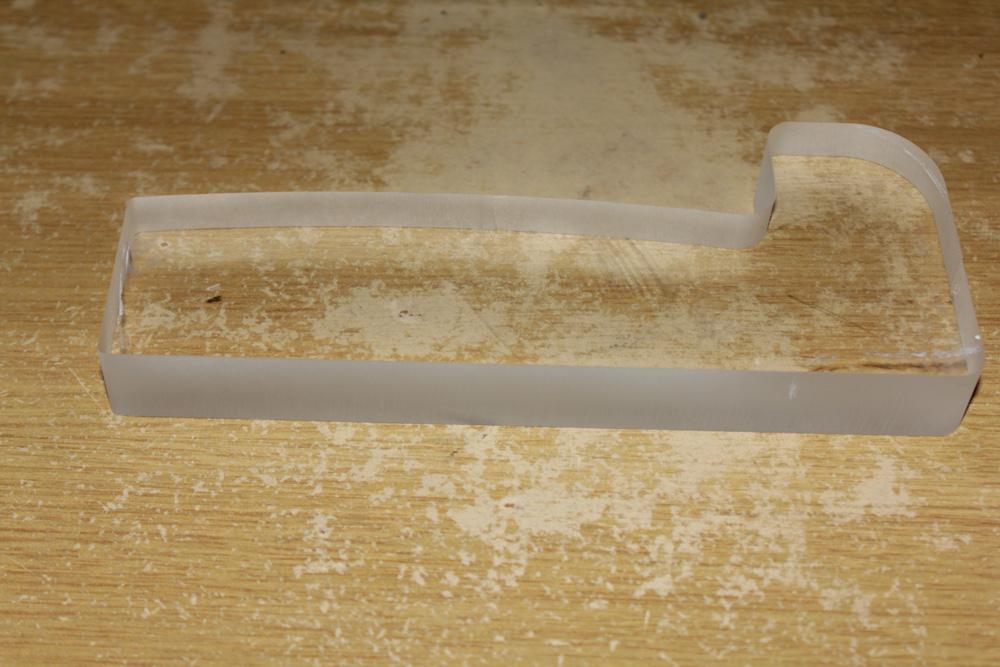

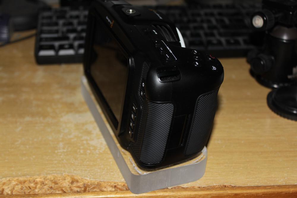

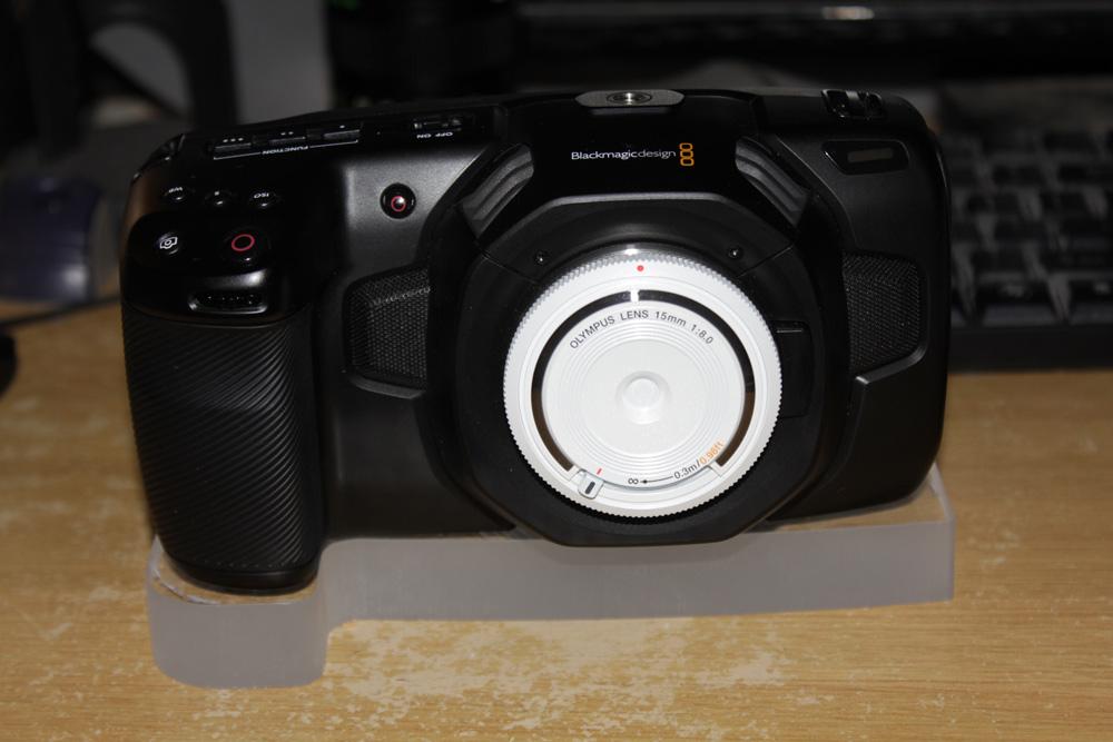

leslie Posted March 28, 2019 Author Share Posted March 28, 2019 been a bit busy this week. Had the 15mm olympus body cap lens turned up this afternoon. To late to have a play with lol. I also took a set of digital calipers to the bmp4k and got some measurements from it, had a piece of perspex lying around. Drew it up in cad and got it cut out at work on the waterjet , I'm calling this the mark one. Now that i have had some time to look at it there's a few things i want to change. i want to add about 4mm to both sides of the hand grip hopefully that will allow enough room to cut out a hole that will allow the battery door to swing open. i think it should work. i plan on milling out a space for a quick release tripod mount as well and finally horizontally mill a slot for my ssd to slide into. Link to comment Share on other sites More sharing options...
kye Posted March 28, 2019 Share Posted March 28, 2019 7 minutes ago, leslie said: been a bit busy this week. Had the 15mm olympus body cap lens turned up this afternoon. To late to have a play with lol. I also took a set of digital calipers to the bmp4k and got some measurements from it, had a piece of perspex lying around. Drew it up in cad and got it cut out at work on the waterjet , I'm calling this the mark one. Now that i have had some time to look at it there's a few things i want to change. i want to add about 4mm to both sides of the hand grip hopefully that will allow enough room to cut out a hole that will allow the battery door to swing open. i think it should work. i plan on milling out a space for a quick release tripod mount as well and finally horizontally mill a slot for my ssd to slide into. Cool! So is this a DIY rig then? I watch lots of 'maker' youtubers and I think this might be the first intersection of CAD and cameras I've seen Link to comment Share on other sites More sharing options...

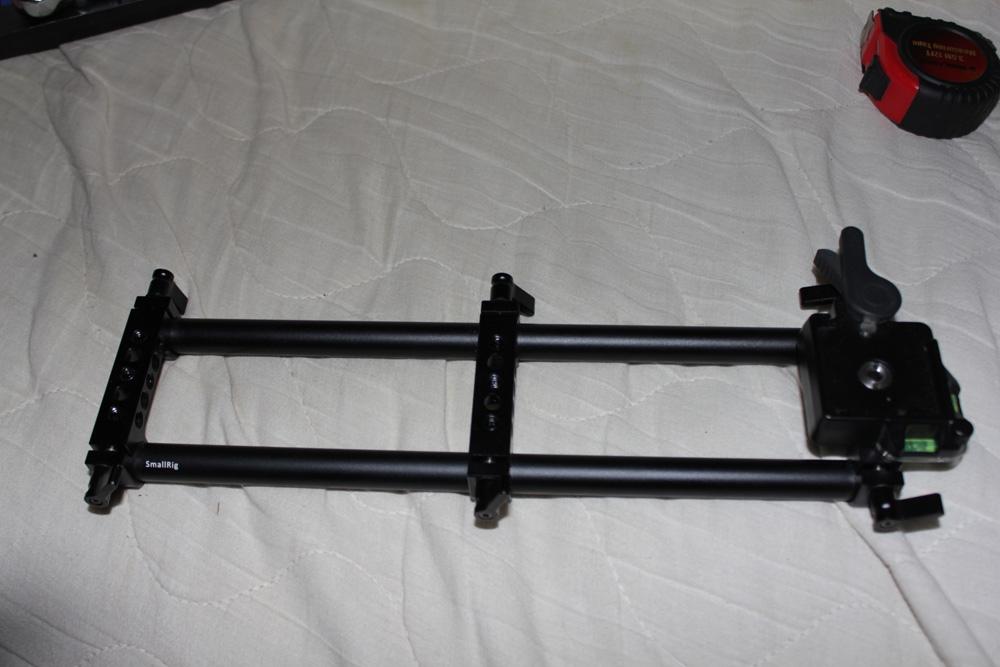

leslie Posted March 28, 2019 Author Share Posted March 28, 2019 1 minute ago, kye said: Cool! So is this a DIY rig then? I watch lots of 'maker' youtubers and I think this might be the first intersection of CAD and cameras I've seen not completely diy, i have had a small rig for awhile i also have an elmoscope anamorphic lens plus some other bits and pieces, i'm looking to intergrate everything together in a nice robust package without the use of duct tape and chewing gum webrunner5 and kye 2 Link to comment Share on other sites More sharing options...

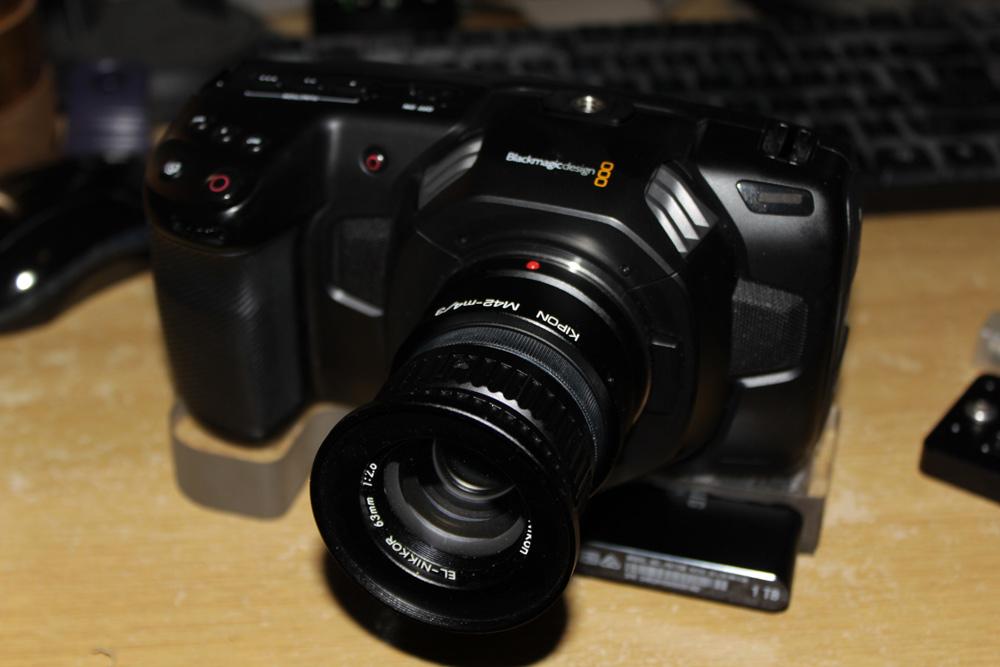

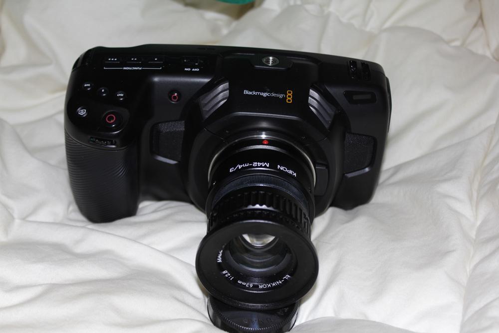

leslie Posted March 30, 2019 Author Share Posted March 30, 2019 got a slot milled for the ssd and tried milling a depression for the tripod socket screw. Unfortunately gouged the side of the hole. As i proof of concept i know it works. Next week will be focused on some correct sized drill bits, clamps amongst other things and a mark 2. also learned that the el nikor 63mm enlarging lens does in fact focus to infinity on the bmp4k. so that one step closer too having an anamorphic rig Link to comment Share on other sites More sharing options...

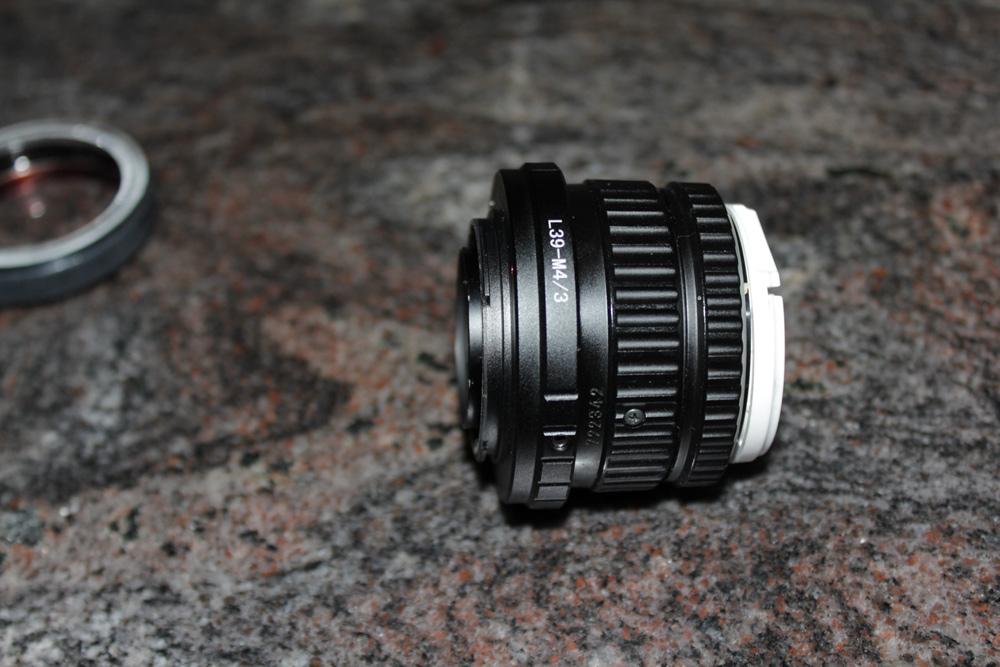

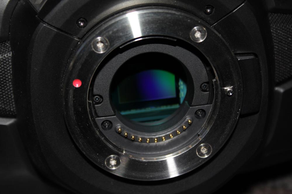

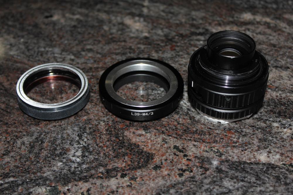

leslie Posted April 13, 2019 Author Share Posted April 13, 2019 after fitting the el nikor 63mm to a m42 extension tube. i wondered if i could i avoid an extension tube by using a m39 to m4/3 adapter instead. So i ordered a m39. Turned up a couple of days ago. here's a pic of the m42, m39 and el nikor. While the el nikor fits to the m39 to m4/3 adapter it protrudes out the back of the adapter by about a millimeter and a half. Which is shown in the second picture. Which hits the edge and or contacts on the bmp4k which is shown in the third picture. so using an enlarger lens on am39 adapter is a dead end unless i want to grind down the back of the el nikor and i'm not keen to do that at this point. Link to comment Share on other sites More sharing options...
webrunner5 Posted April 13, 2019 Share Posted April 13, 2019 It's a 100 dollar lens for Christ Sakes. Saw off the back of it and be happy. Nobody is going to use it in a Enlarger again. Sell it if you don't like it for 3 times the money you paid for it on ebay because it is a Professional Modded lens. ? Link to comment Share on other sites More sharing options...
