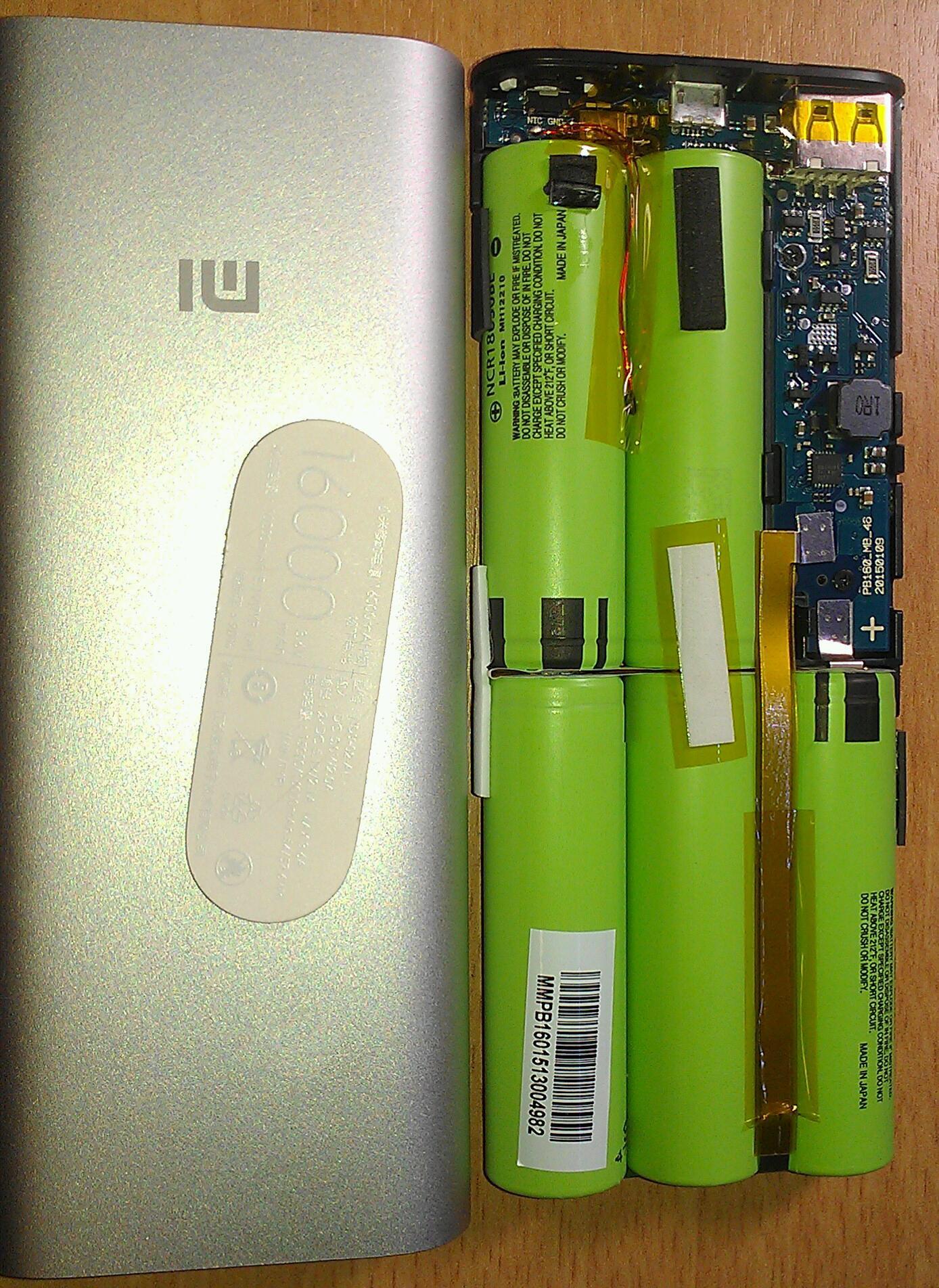

Super Members BTM_Pix Posted March 3, 2019 Super Members Share Posted March 3, 2019 16 minutes ago, thephoenix said: now i would like ot find a simple way to fix it on a rig as there are no screw hole in all this power banks This £7.50 set should give you enough flexibility to clamp the power bank securely and then use the screw thread onto a rig. https://www.amazon.co.uk/UTEBIT-Adapter-compatible-17-35mm-Motorcycle/dp/B0784JNVCF/ref=sr_1_20?ie=UTF8&qid=1551643592 Link to comment Share on other sites More sharing options...
thephoenix Posted March 3, 2019 Author Share Posted March 3, 2019 You have cheap 15mm rod adapters with screw too the issue is just that no mount on banks and the phones clamps i do not trust it might fall when moving fast Link to comment Share on other sites More sharing options...
Super Members BTM_Pix Posted March 3, 2019 Super Members Share Posted March 3, 2019 30 minutes ago, thephoenix said: You have cheap 15mm rod adapters with screw too the issue is just that no mount on banks and the phones clamps i do not trust it might fall when moving fast I'm not sure I follow ? The clamp will go on the power bank instead of using a mount and as they are designed to clamp cameras to motorcycle handlebars they have a pretty firm grip. An alternative is to use one like this, which again you would use the clamp to hole the power bank in. Beyond that, you would be looking at making your own mount by either epoxying this to the power bank or, more preferably, taking the case off, screwing a hole through it to put it in so that the flat part is inside and then you tighten the first nut to secure it on the other side and then use the other nut to securely mount it to a cage or whatever else you are using. Link to comment Share on other sites More sharing options...
thephoenix Posted March 3, 2019 Author Share Posted March 3, 2019 Hmmm Maybe but when it comes to power and especially electricity i wouldn't add some metal inside. I guess the best would be to 3d print some kind of holder a bit like smallrig does for the samsung ssd For the clamp first it takes too much space and second you will damage the bank Link to comment Share on other sites More sharing options...
Super Members BTM_Pix Posted March 3, 2019 Super Members Share Posted March 3, 2019 1 minute ago, thephoenix said: Hmmm Maybe but when it comes to power and especially electricity i wouldn't add some metal inside. Fair enough. Just as an FYI though, the powerbanks are just varying amounts of cells so you would have to really try hard to come to any harm if you followed the same simple insulation practice that the manufacturer uses to the actual metal outer case itself. I modded one like that for my nephew to use with his A6500 and he seems to be doing OK with it. kye, webrunner5, thephoenix and 1 other 4 Link to comment Share on other sites More sharing options...
