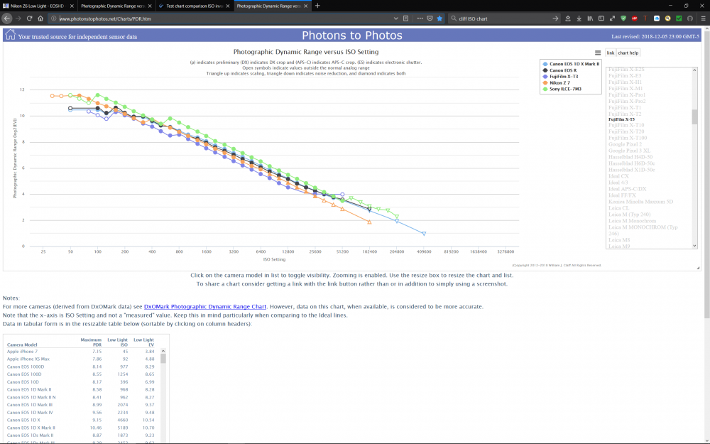

ND64 Posted December 12, 2018 Share Posted December 12, 2018 "It’s the gain level that introduces noise, not the lack of light." Its exactly the opposite, brother. Gain actually decreases the noise. Lack of light increases that. Castorp 1 Link to comment Share on other sites More sharing options...
DBounce Posted December 13, 2018 Author Share Posted December 13, 2018 3 hours ago, Eric Calabros said: "It’s the gain level that introduces noise, not the lack of light." Its exactly the opposite, brother. Gain actually decreases the noise. Lack of light increases that. So then, by this logic, assuming the amount of light remains constant, increasing the gain will yield a cleaner image. So instead of shooting in a dark environment at 3200 ISO, just crank the ISO up to 25,000 and enjoy a super clean image... right? I mean the amount of light is still constant... the only thing changing is the image cleaning gain? But meanwhile... back in the “real world”, boosting gain also boost the noise... meaning? A noisier image at higher ISOs. Though I really think we all prefer your version. IronFilm 1 Link to comment Share on other sites More sharing options...

KnightsFan Posted December 13, 2018 Share Posted December 13, 2018 20 hours ago, DBounce said: So then, by this logic, assuming the amount of light remains constant, increasing the gain will yield a cleaner image. So instead of shooting in a dark environment at 3200 ISO, just crank the ISO up to 25,000 and enjoy a super clean image... right? I mean the amount of light is still constant... the only thing changing is the image cleaning gain? Exactly. Generally, you get less noise if you raise the gain by a stop while shooting, and then pull it down a stop in post, though you can lose highlight detail. Assuming that the "gain" is actually gain and not just metadata, like it is on most Blackmagic cameras. Link to comment Share on other sites More sharing options...
