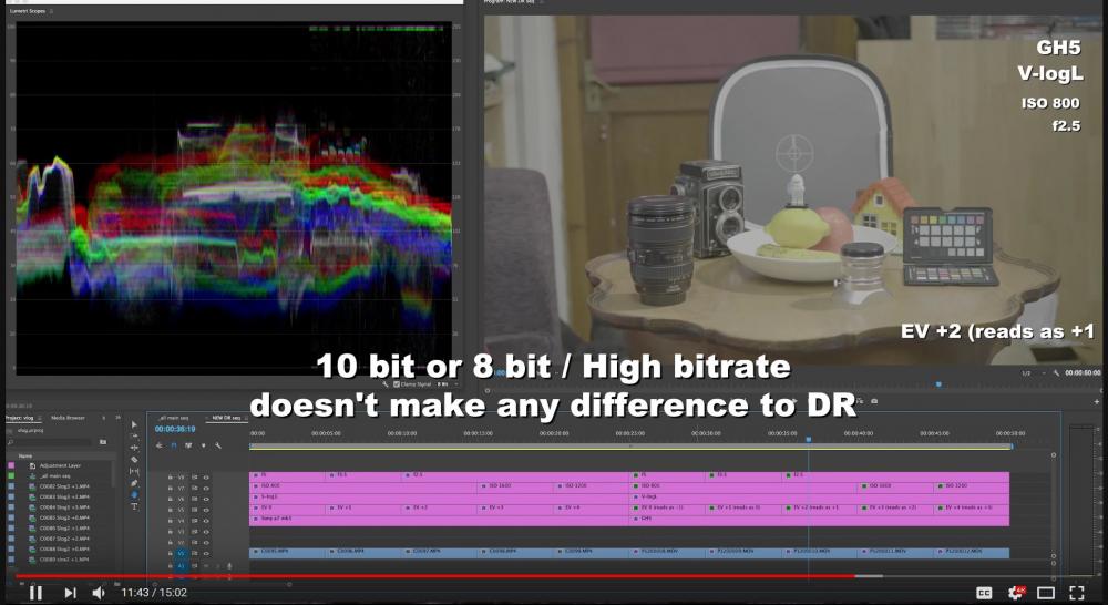

Apparently, dynamic range is directly related to bit depth.
Yes, I think that is self evident. Take a shot jpeg (8 bit) and raw (14 bit) and you can recover 1 to 2 more stops in raw. Also bit rate will effect DR - I can recover more highlights in a jpeg still than in the more heavily compressed video. These factors would certainly help both the GH5 and X-H1 get closer to A7iii DR in video relative to stills than the sensor size difference might imply.
With linear encoding like in RAW files, the bit depth determines the upper limit of dynamic range.  jpeg or log use non linear encoding which can map higher dynamic range in a limited bit depth. Thats how jpegs can typically have ~11 stops of dynamic range and log profiles >12.
The problem is that the more you compress the dynamic range of an image into limited bit death, the more you under-sample the color space and the more limited tonalities & increased banding you get.
Bitrate has nothing to do with dynamic range.

I found this video comparing the GH5 and A7III with regards to dynamic range. It appears the A7III has at least 1.5 stops more DR compared to the GH5. From what I've seen the GH5s might have about .5 stops better than the GH5 but still puts the DR behind the A7III by quite a bit. Of course there are other criteria that makes the GH5 line more appealing in other circumstances, but for myself, shooting outdoors, it appears the A7III might be a better choice for what I do:
Am I just tired, or is there a serious flaw with this test? Correct me if I’m wrong, but I don’t think he should be raising the ISO, he should be opening up the iris. Very strange test.
I think you may be tired. As you said, it’s a dynamic range test... open the iris, close the iris, the DR won’t change at the same ISO at different apertures... only lens sharpness will. So to test DR, you need to change the ISO on both cameras to see which does better.
6 minutes ago, mercer said:
That’s the point of the test. You test how well the DR holds the further you are from base ISO.

Right but I think the test in question from the video was showing the difference in DR from their respective base ISO. So vLog’s base ISO is what... 400? And sLog is 800. So when you go one stop up in ISO with vLog you’re at 800 ISO and one stop up with sLog you’re at 1600 ISO... two stops up with vLog you’re at 1600 ISO and two stops up with sLog you’re at 3200 ISO... etc, etc...
