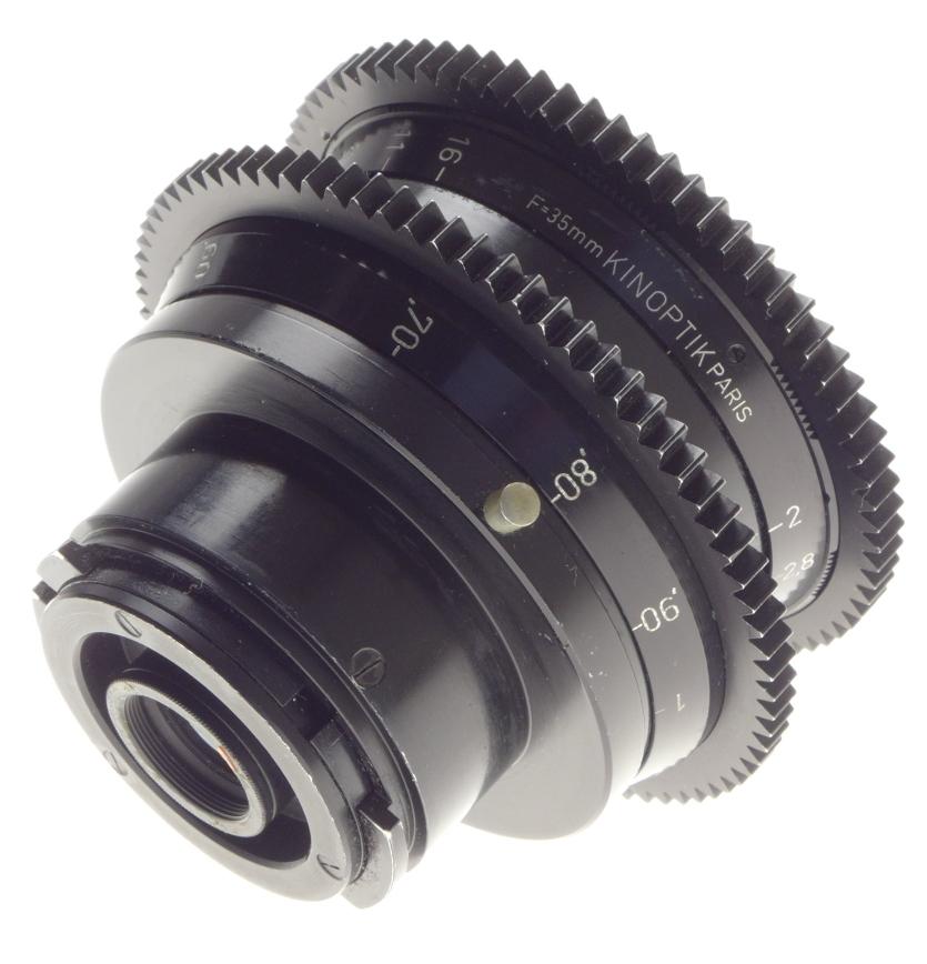

youshouldtry11 Posted August 10, 2018 Share Posted August 10, 2018 9 hours ago, Alpicat said: @youshouldtry11 The lens is pretty small, but heavy as it's metal - feels front heavy on the eos m. It's a c-mount lens -I think this is the adapter that works best to make it work parfocally, though haven't personally tried it: https://fotodioxpro.com/products/c-eosm Don't know what mount the lens in your photo has - it doesn't look like it has any mount at all, maybe it was unscrewed or removed, or it's a custom built one? can you take a photo of your lens back? I want to compare it .... isn't this a c mount? tupp 1 Link to comment Share on other sites More sharing options...
Alpicat Posted August 10, 2018 Share Posted August 10, 2018 @youshouldtry11 c-mount is a screw thread type mount and I don't see any screw here. I'm unsure what makes you think the above is c-mount, to me it looks like it doesn't have a mount - perhaps it's been physically removed. I sold my schneider lens last month as I wasn't using it, however below are some photos of it with c-mount: https://thumbs.worthpoint.com/zoom/images3/1/0915/23/schneider-kreuznach-optivaron-66mm-1_1_ba20e52d51029e2677ec30cad36cabc4.jpg https://www.picclickimg.com/d/w1600/pict/263721207841_/Schneider-Kreuznach-Beaulieu-Optivaron-18-6-66-C-Mount-Zoom.jpg Link to comment Share on other sites More sharing options...

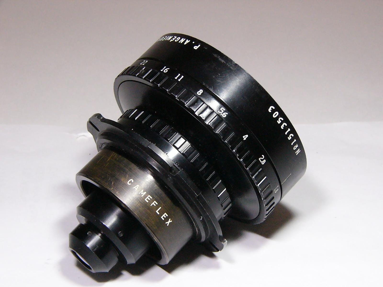

tupp Posted August 10, 2018 Share Posted August 10, 2018 On 8/7/2018 at 1:20 AM, youshouldtry11 said: (I won't shoot RAW video as it seems relatively unstable) I don't think that this is true in all raw modes on the EOSM. My understanding is that raw on the EOSM in the lower res crop modes (which you seem to seek) is stable and can work without over-cranking the SD card. Perhaps @Alpicat could enlighten us further on this matter. 13 hours ago, youshouldtry11 said: isn't this a c mount? It looks like a very clean cameflex mount with the end flanges removed. Here is such a mount with the end flanges: Here is the cameflex mount with no end flanges, but with a PL flanges: Here is is a cameflex-to-Emount adapter: Alpicat 1 Link to comment Share on other sites More sharing options...
Alpicat Posted August 12, 2018 Share Posted August 12, 2018 @tupp @youshouldtry11 thanks for this, had never heard of the cameflex mount! Shooting in raw is stable even with the SD overclock hack - I rarely had problems with corrupt footage, unless it's an extremely experimental build. The only issue with the SD hack is activating it, which can be a bit risky, but after activation, the camera is fine to use as normal. If you want to avoid the SD card hack and want to use s8 or s16 lenses, just download the latest 4k lossless experimental build from the magic lantern website, select "movie crop mode" in 10 or 12 bit lossless raw up to 1800x1030 resolution (4.66x crop). That mode is nice to use as it gives you a properly framed liveview, and should give you fairly continuous recording times. Of course you can also select lower resolutions whilst in movie crop mode if you want a bigger crop or a different aspect ratio. tupp 1 Link to comment Share on other sites More sharing options...
