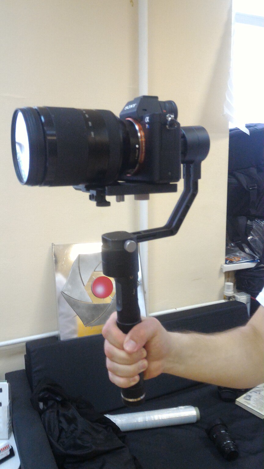

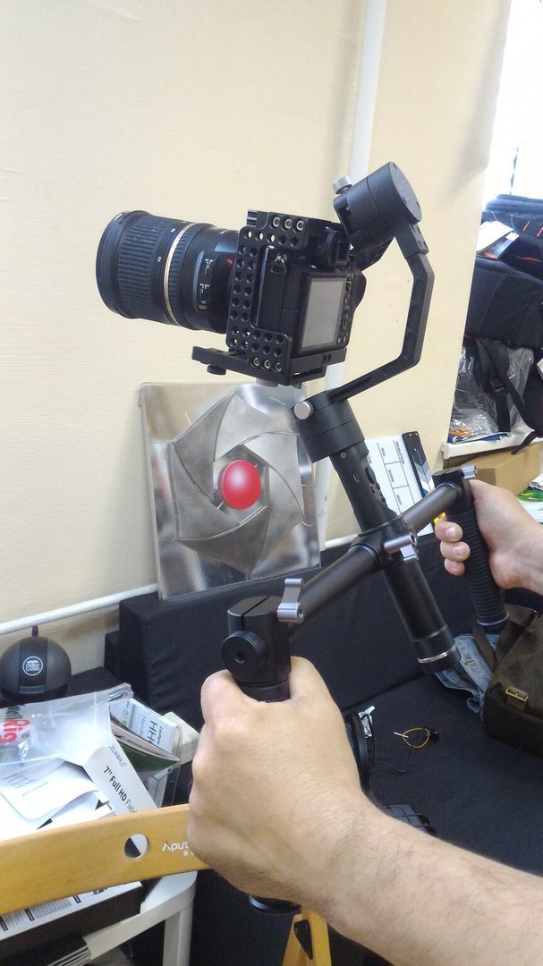

1. balance it with cage and tilt crane 45 degree
2. balance it with a little monitor
3. mount it backwards and shoot with crane tilted 45 degree
here's calculation for 1, 2 option on a proven setup (last picture) tamron 24-70/2.8 + sigma mc11 + a7sii + smallrig cage: 825+125+630+250 (bmpcc setup actually can be less front-heavy having 580g to balance it as it need to be)

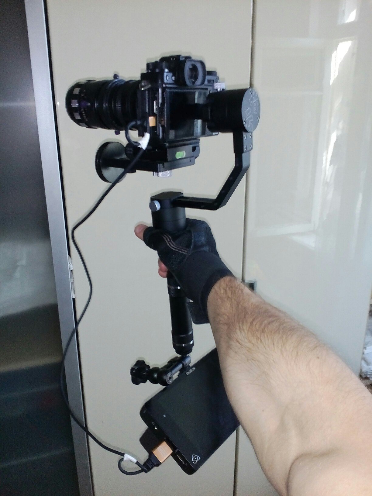

before some more bs i'll give a little notice: my own setup (first pic) is very like OP's setup (in terms of weight distribution): sankor+helios+speedbooster~900g +x-t2 500g (and also im added some weight in front to balance it so crane can be fold easily).
And have no problem with visual control at all (crane not even powered on)
