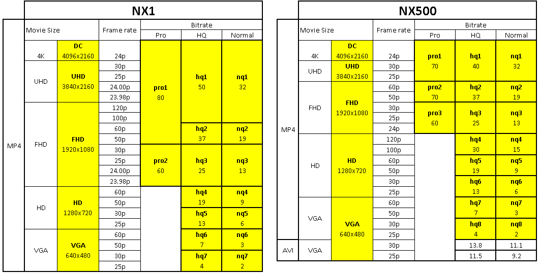

derderimmermuedeist Posted December 6, 2017 Share Posted December 6, 2017 HOW TO - INSTALLATION 0. The file containing this README.txt includes everything you need. 1. Make sure the nx-on-wake mod is installed. This mod depends on nx-on-wake. 2. The zip file includes a nx-patch.png file. Open and print it or familiarize yourself with it - it shows the meaning of the various bitrate and resolution slots. You will need to know them to use the mod. 3. Unzip the file where you found this README in the root of your SD card. 4. Insert the SD card into your camera and power it up. NB. I mean power up the camera, not the SD card :-) 5. Pay attention to the messages showing on the screen. 6. You will be informed when the mod is available (installation is finished). Link to comment Share on other sites More sharing options...

Juxx989 Posted December 7, 2017 Share Posted December 7, 2017 @BopBill Ok we did it I was missing the info.tg went through the mysterious install process I put in the code and did all the things It appears it was successful as I see that 4 light blinks on my green light by the menu button... Thanks BUT....... now I cant seem to get the GUI to pop up so I can change bitrates Andrew says above that you just double click the little button with the lightbulb on it under the top LCD screen... Ive been pushing it like crazy and nothing is happening Ill keep trying But thanks for getting me this far! Link to comment Share on other sites More sharing options...
BopBill Posted December 7, 2017 Share Posted December 7, 2017 This is the second part of installation prosess: https://github.com/ottokiksmaler/nx500_nx1_modding/blob/master/video-bitrate-mods/nx-patch/nx-patch.zip Instructions are in the ZIP-file. The hack has the killall button and it is usefull, because using it the other parts of the hack (except bitrates) are not using any prosessing resurces. And after using killall you can't open menu before the battery has been out of the camera ( shut camera and after that battery out for few seconds.) However the Killall function doesn't remain on many days. You have to do it again after day or two. But you start to make it habbit to check, with double clicking the little lcd light button, that if the killall function is still on or not. Not a big deal. Juxx989 1 Link to comment Share on other sites More sharing options...
