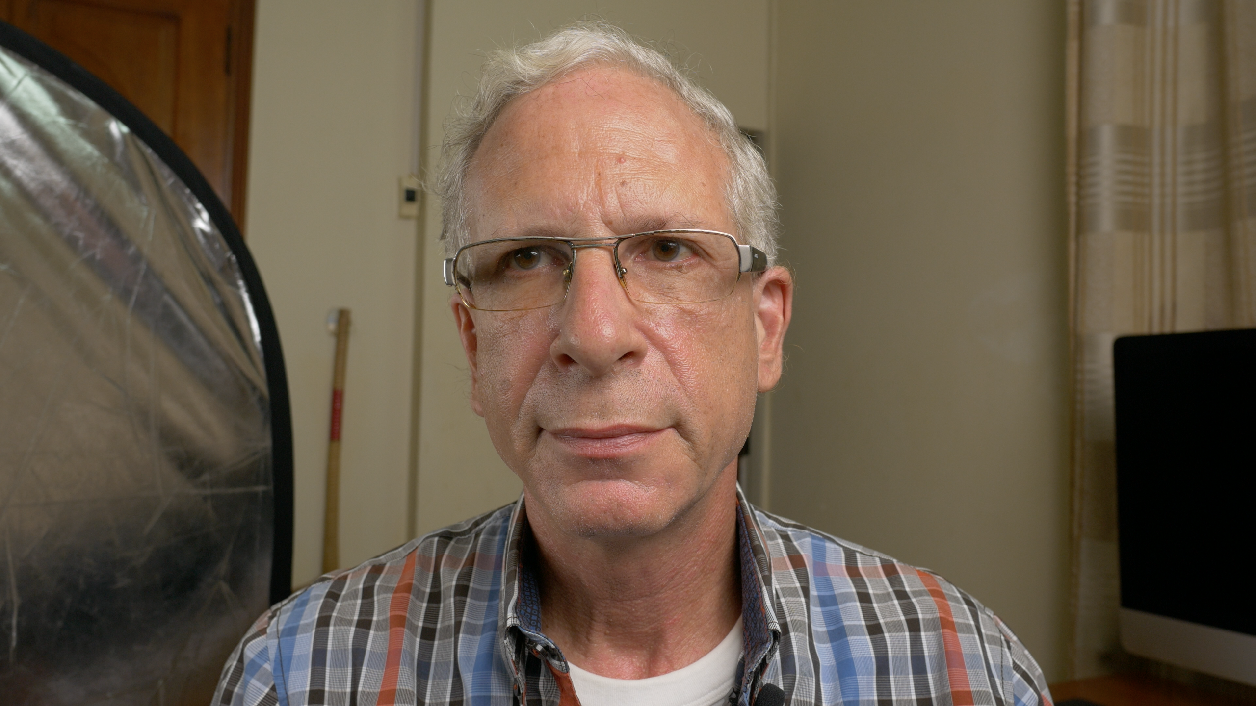

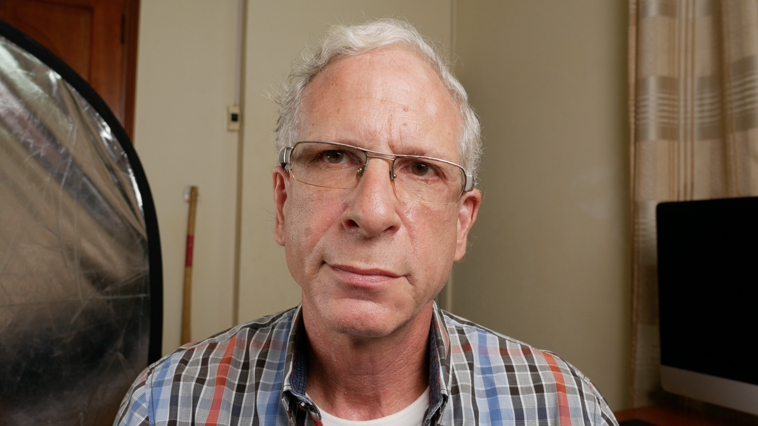

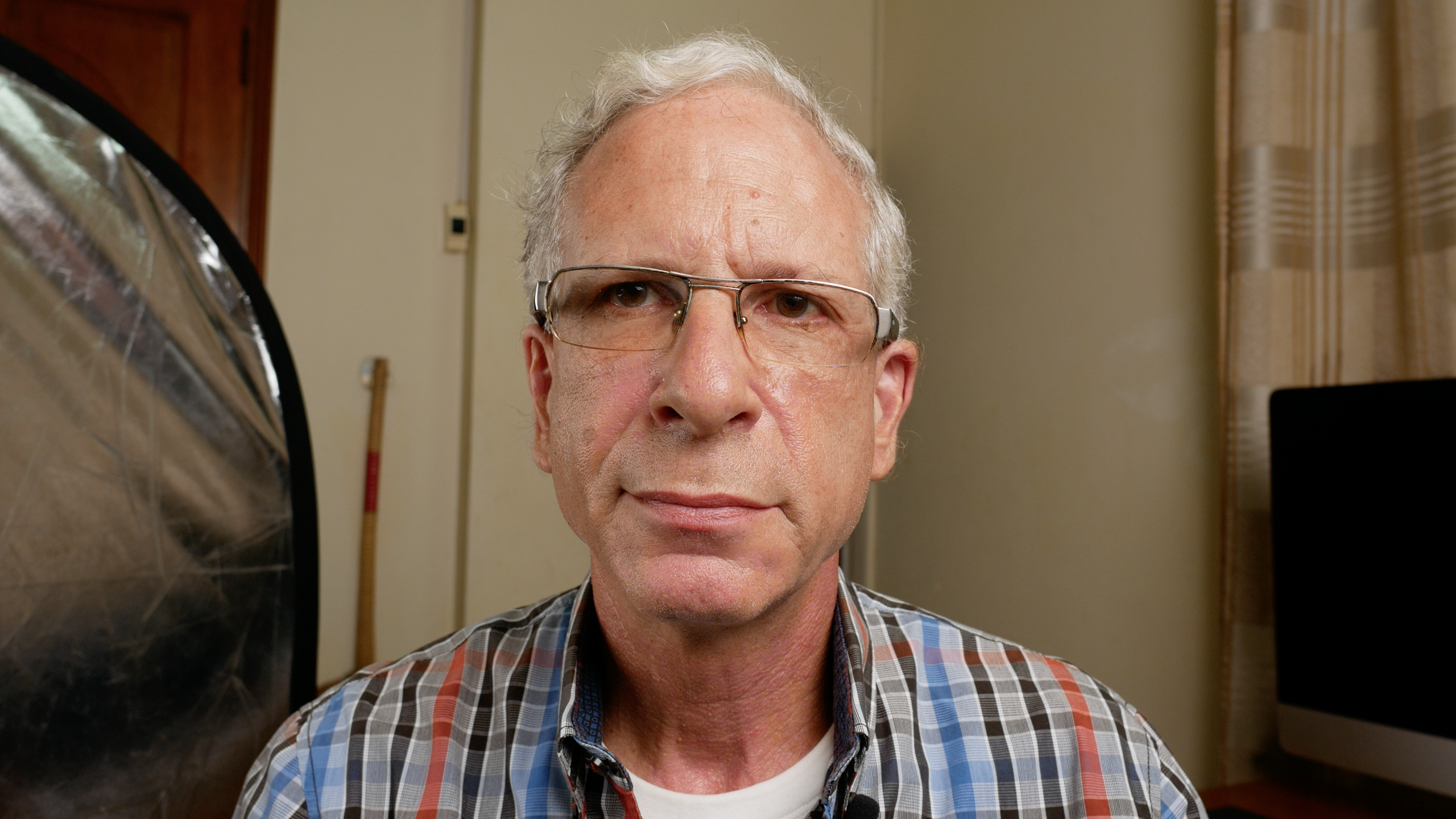

jonpais Posted May 25, 2017 Share Posted May 25, 2017 1 hour ago, Inazuma said: Would you be so kind as to do some comparison shots with the standard profile and new profile on skin? The following were shot with the G85 using an LED light, all set at -3 sharpening and -5 noise reduction. 1) Cinelike D 2) Standard 3) Natural Link to comment Share on other sites More sharing options...
