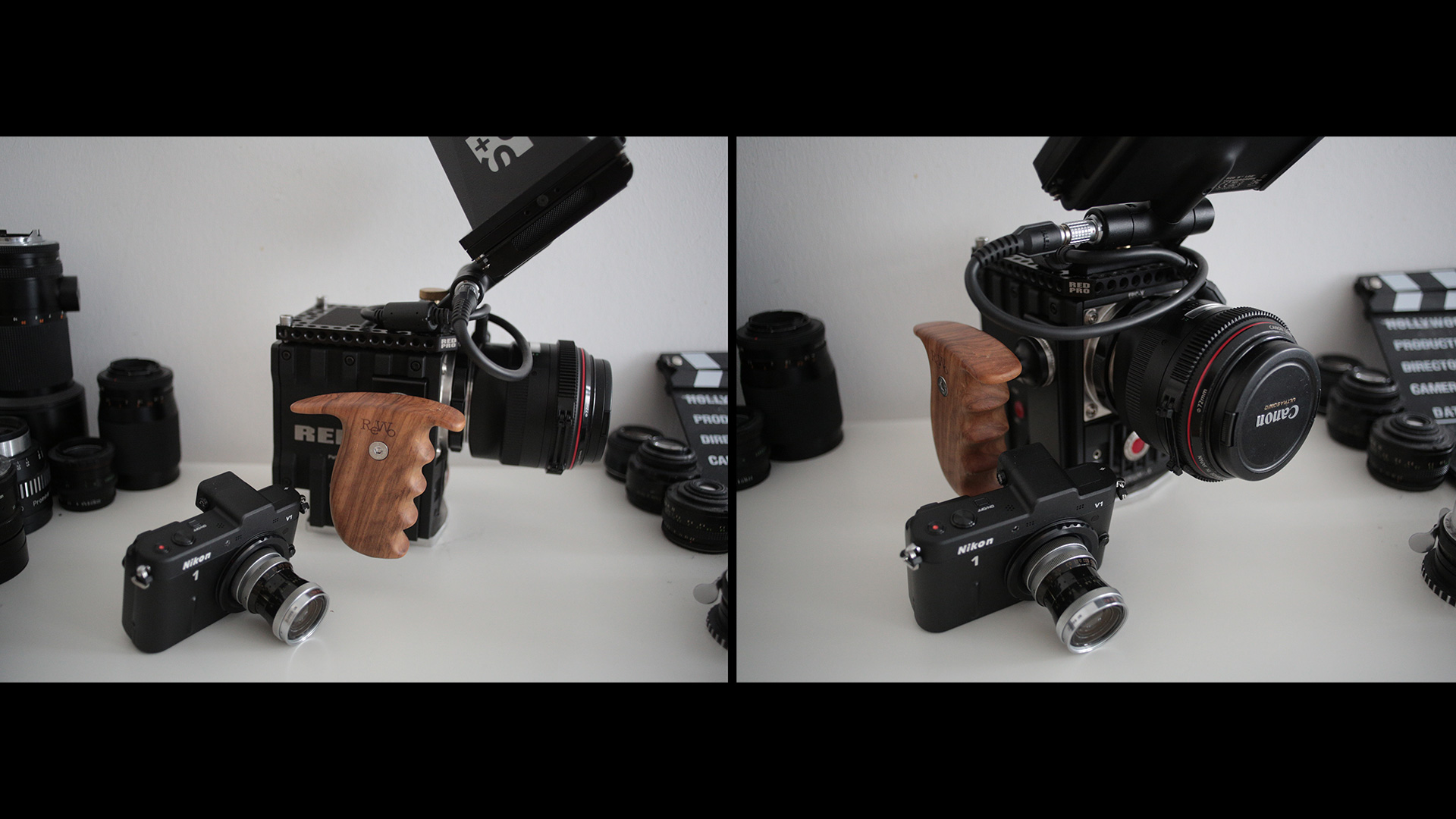

I have two of the bodies of Nikon V1, this camera is my everyday video camera for working on assignments, as well as primary camera for Video/Interactive Art Projects.
About the C-Mount lenses. In traditional shooting mode you can not see exposure information while non-coupled lenses are attached, you can not zoom in for manual focusing, so be careful about correct focus distance.
Now the C-Mounts will be driven in price :(
