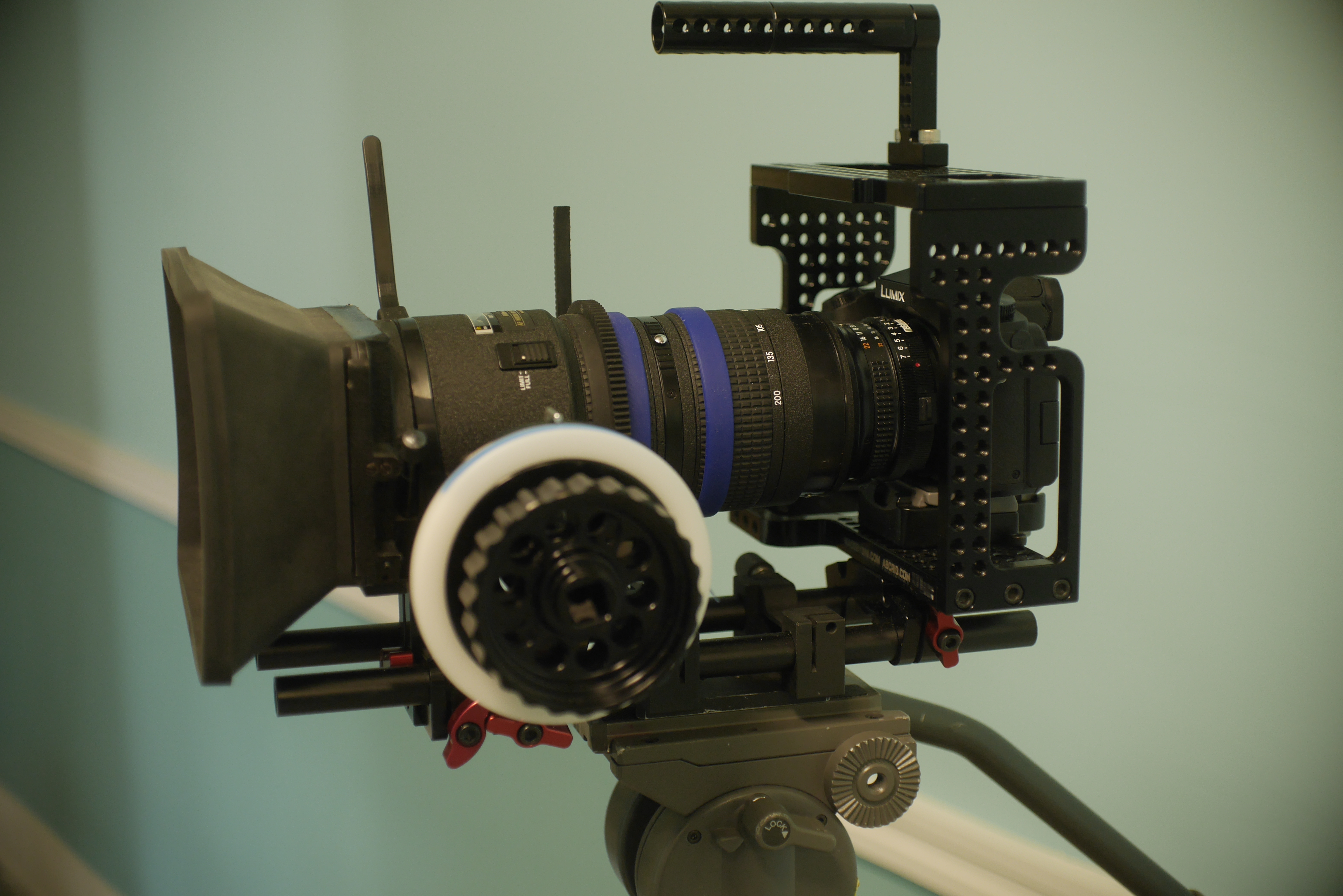

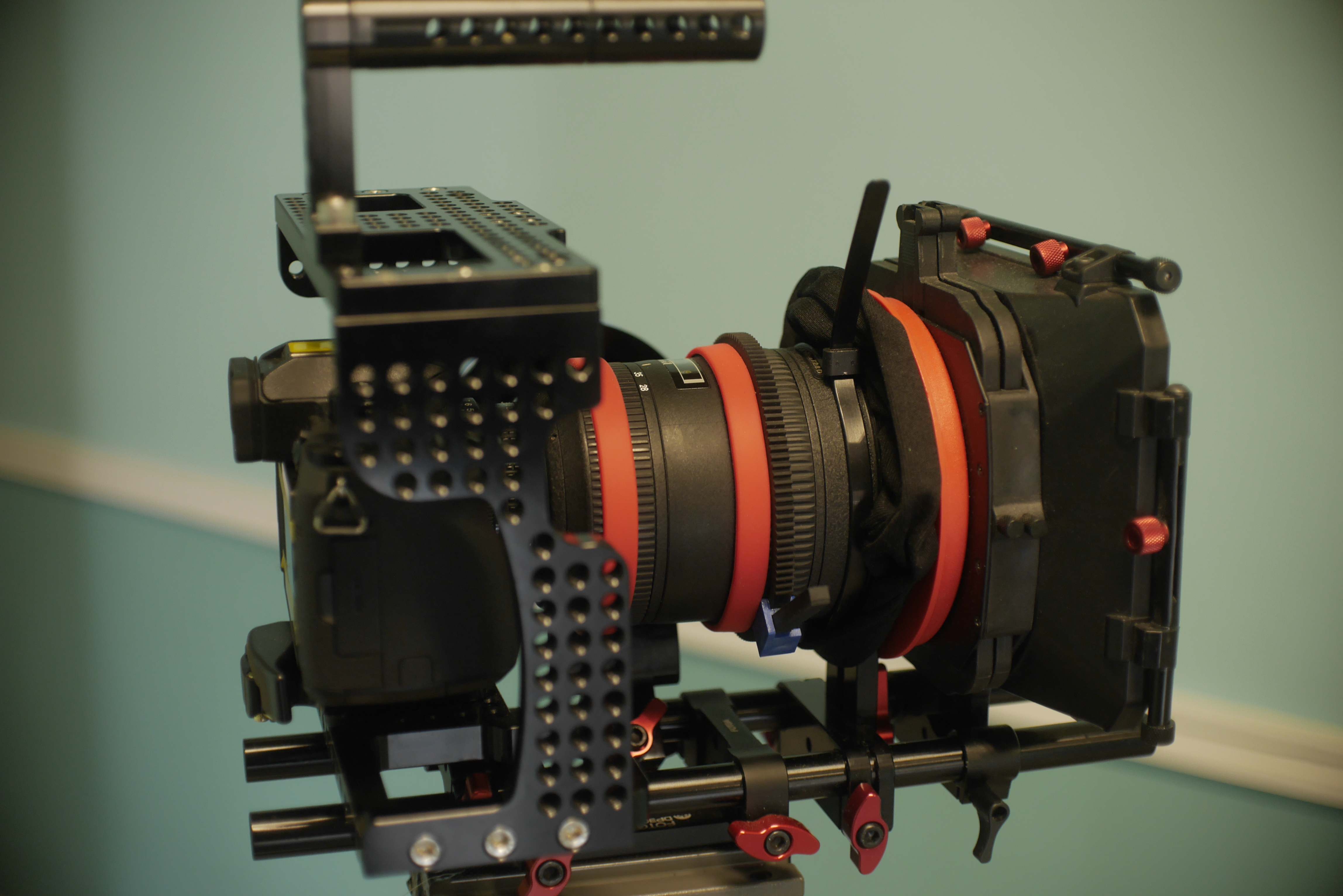

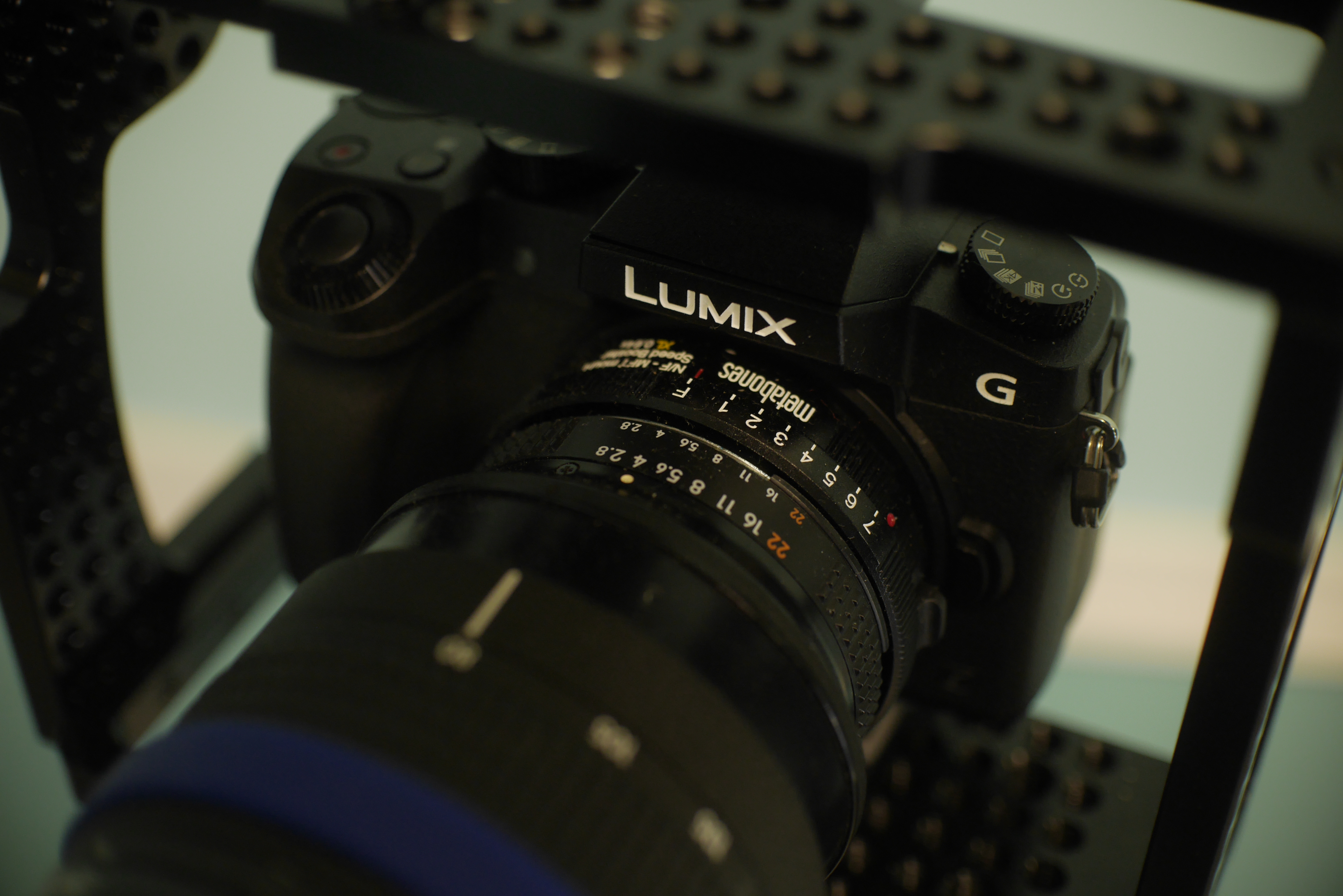

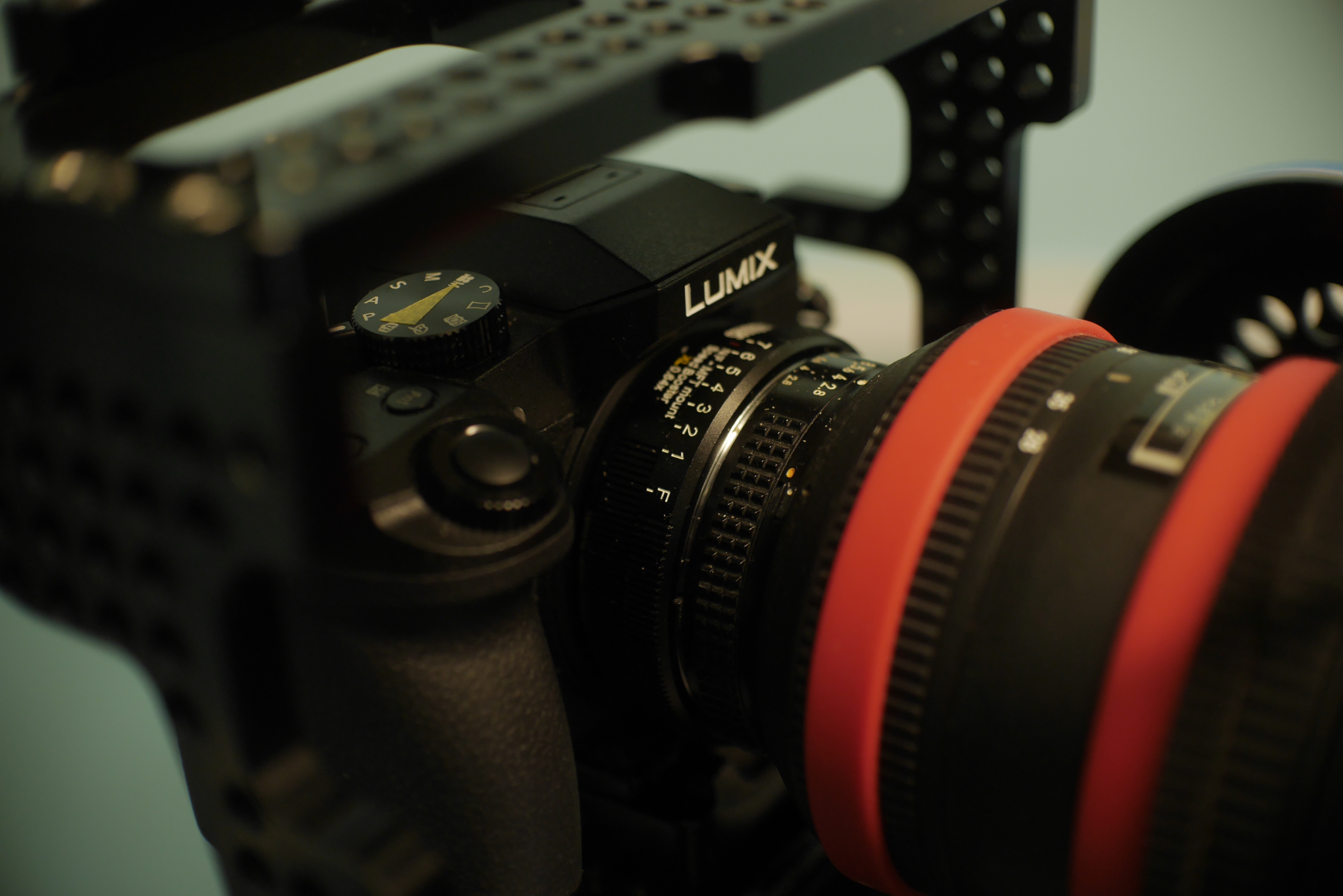

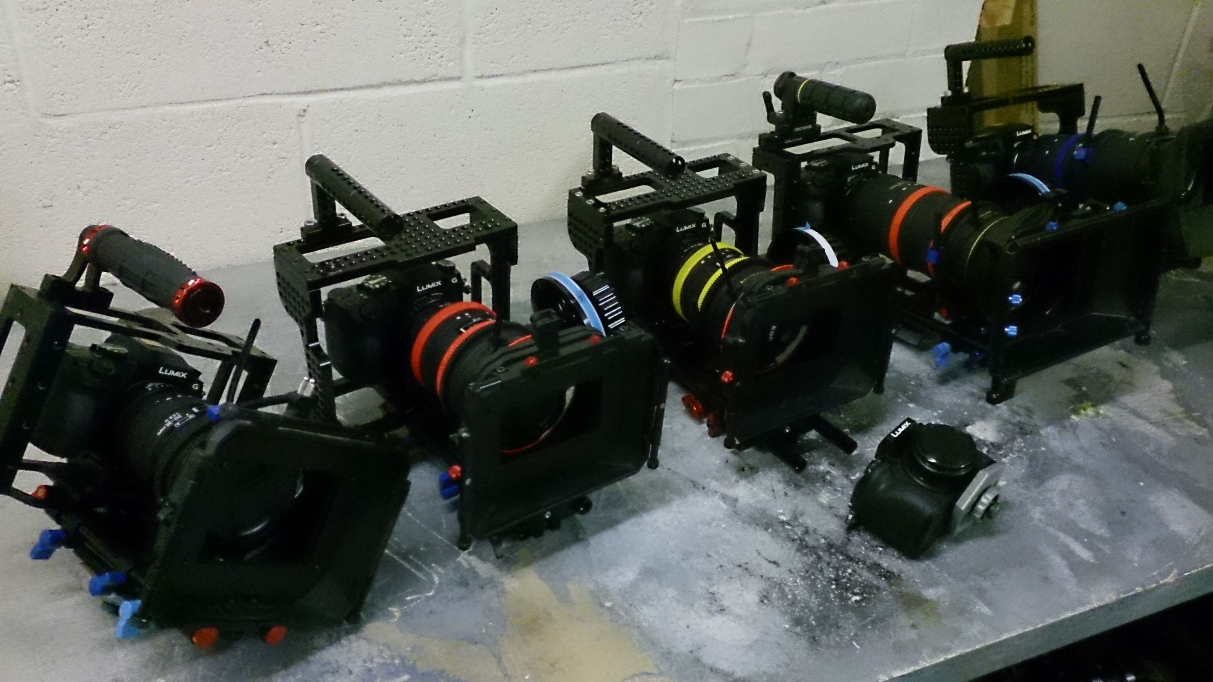

andy lee Posted June 22, 2016 Share Posted June 22, 2016 if you are going to get a Speedbooster get a Metabones they are the best construction wise and optically plus no lens shift on any on mine and Im using 8 X Metabones XLs to shoot a feature film right now ( 4 in Nikon Mount and 4 in Canon EF mount )- they are outstanding and I love them , I wouldnt shoot without them , they are essential on micro 4/3 cameras plus follow focus works really well as there is no play in the lens mount plus I cable tie all my lenses on rigs to the lens support so there is no movement at all of the follow focus - Im using Gini Rigs follow focus as its very big and smooth Im 38 days into a 45 day shoot and they are all performing superb NO issues at all 5 Metabones XLs on my rigs (Gini Rigs) with Nikon Bourne Lenses for the feature film Pandora I'm DP on . JazzBox 1 Link to comment Share on other sites More sharing options...

andy lee Posted June 24, 2016 Share Posted June 24, 2016 yes I mentioned that in a post a few months back - you can turn the head upside down on the Gini Rigs follow focus and that corrects the Nikon reverse focus issue its very easy to do and I have shot an entire feature film like thta on all my 6 rigs The Film City matte box works well with the Nikons I use them on the Nikon 28-70mm it has 4x4 filter trays I always used Tiffen NDs On 23/06/2016 at 1:10 AM, JazzBox said: Woooow!!! Thank you very much Andy!!! Do you use an active or passive Metabones? How do you cable tie the lens? On the rods or on the matte box? I see some great follow focus' ring: where can I buy them in Europe? Huge thanks! I have 4 Nikon Metabones XL and 4 active Canon EF Metabones XLs that I used on the movie you can buy the Gini Rigs Follow focus here this is the exact ones I am using : https://www.ginirigs.net/product/ifocus-follow-focus/ JazzBox 1 Link to comment Share on other sites More sharing options...
