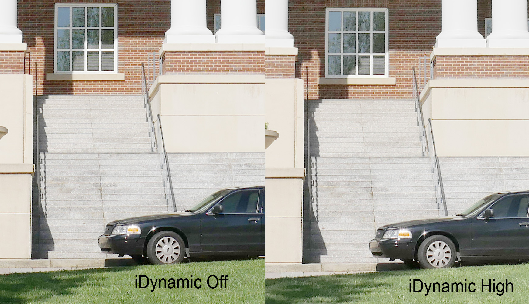

John Matthews Posted November 24, 2016 Share Posted November 24, 2016 11 minutes ago, Vesku said: Idynamic high is too extreme. I use normally low and standard for extreme scenes, not high. I think my GH4 records little more dynamic range and color information than GX85. Does the GX85 has 0-255 luminance range? It's 8bit 4:2:0. The previous remarks were concerning iDynamic high... I haven't tested low or standard. Again, I have my doubts about any difference in DR other than superficial slight modification of processing curves resulting in more noise and artifacts in dark areas. What does @Andrew Reid say, if anything, in his GH4 guide? DPreview did mention a slight gain in DR at the lower end and a generally lower midpoint in their LX100 review. This is probably what you're noticing. I have my doubts that Panasonic has changed anything concerning iDynamic since the GH4, LX100, G7, and probably the G80/85. Link to comment Share on other sites More sharing options...
Vesku Posted November 24, 2016 Share Posted November 24, 2016 Idynamic underexposes 1/3 stop. Sensor gets less light. It is noisier than without it. It gets more stuff in highlights and lifts shadows. In iso 200 image is flatter and still clean. Here is what iDynamic high makes in iso200 when using JPG photos with GH4. I made a very heavy midtone curve to lighten images. 4k video behaves quite the same as JPG photos with center crop. Link to comment Share on other sites More sharing options...
John Matthews Posted November 24, 2016 Share Posted November 24, 2016 31 minutes ago, Vesku said: Idynamic underexposes 1/3 stop. Sensor gets less light. It is noisier than without it. It gets more stuff in highlights and lifts shadows. In iso 200 image is flatter and still clean. Here is what iDynamic high makes in iso200 when using JPG photos with GH4. I made a very heavy midtone curve to lighten images. 4k video behaves quite the same as JPG photos with center crop. Exactly where do you see more DR (which seems like the purpose of a flat profile)? Highlight spectacles on the car? More detail under the car? More detail in the grass? If you're shooting the GH4, why don't you get a proper flat profile like V-log? Link to comment Share on other sites More sharing options...

Vesku Posted November 24, 2016 Share Posted November 24, 2016 2 hours ago, John Matthews said: Exactly where do you see more DR (which seems like the purpose of a flat profile)? Highlight spectacles on the car? More detail under the car? More detail in the grass? If you're shooting the GH4, why don't you get a proper flat profile like V-log? This example is not for dynamic range. The scene has no extreme contrast. I wanted to show that iDynamic high is not making much more noise or other bad things at iso200. (Still if you measure light and dark tones the iDynamic version is flatter) As I have said I use iDynamic for getting flatter or lighter blacks from camera unedited. V-log has issues and it needs editing. Link to comment Share on other sites More sharing options...
Vesku Posted November 24, 2016 Share Posted November 24, 2016 I started to wonder the idynamic and I made some tests again. Idynamic adds noise to darks and should be used with care. It is best when wanting the lighter result unedited. John Matthews 1 Link to comment Share on other sites More sharing options...
