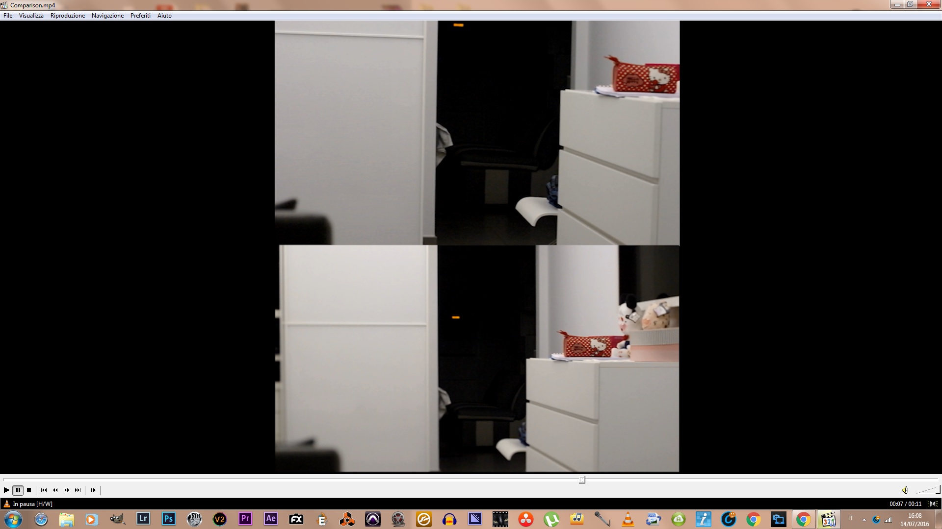

lucabutera Posted July 14, 2016 Share Posted July 14, 2016 Another quick test (this is one of the first test) the lens still is not perfectly aligned, and this creates a little blur in the lower part. Nevertheless, it also corrects distortion, behaving in the opposite way to the way a wide angle. Also, you can see the brightness gain of 1 stop in dark areas. sandro, Calum MacPhail, tokhee and 5 others 8 Link to comment Share on other sites More sharing options...

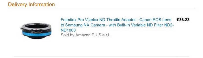

Calum MacPhail Posted July 15, 2016 Share Posted July 15, 2016 Keep an eye on Amazon guys, the price of this has been going up and down like a yoyo and now its back up to £96. But I got an absolute bargain last night... Link to comment Share on other sites More sharing options...
