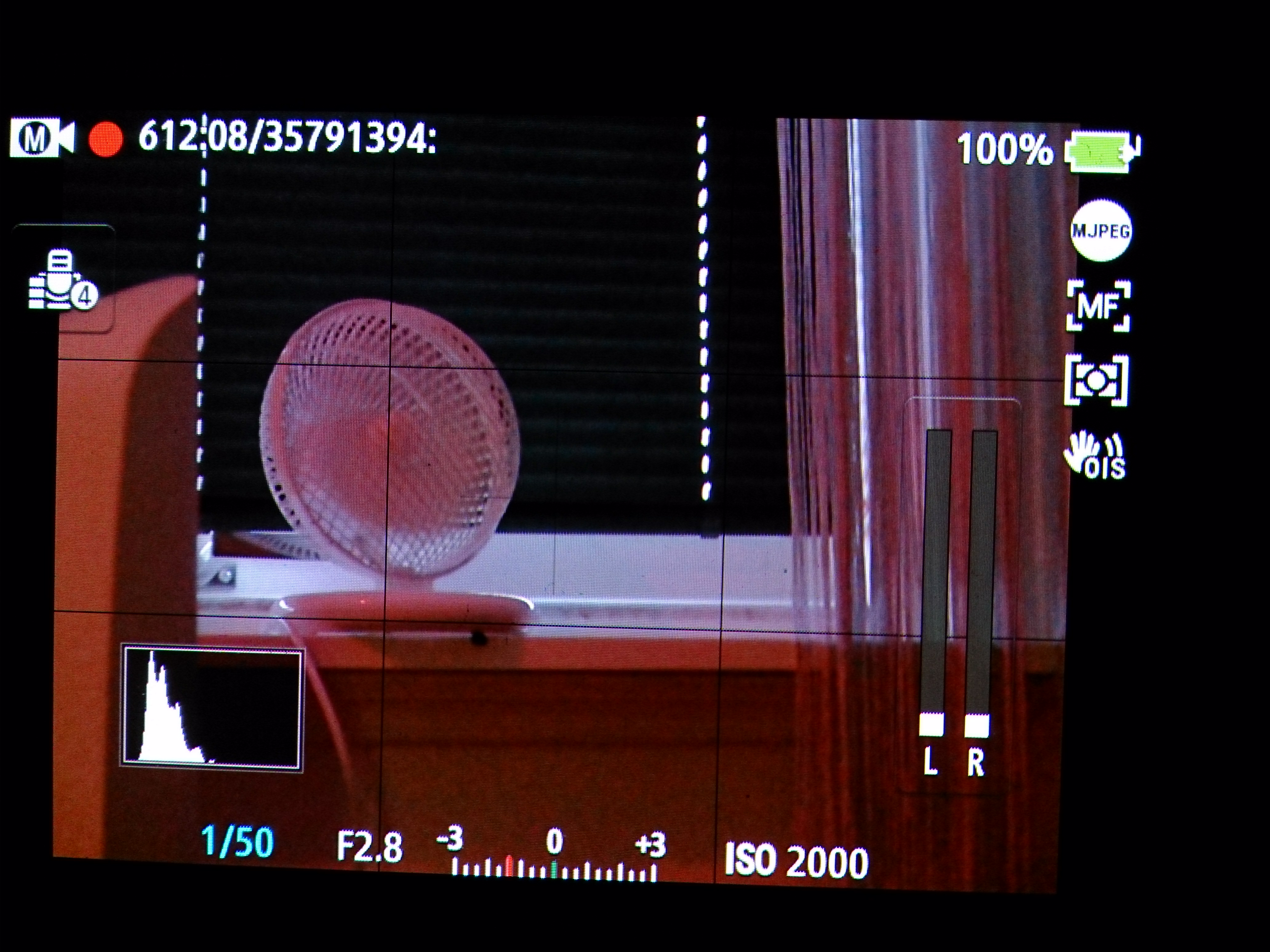

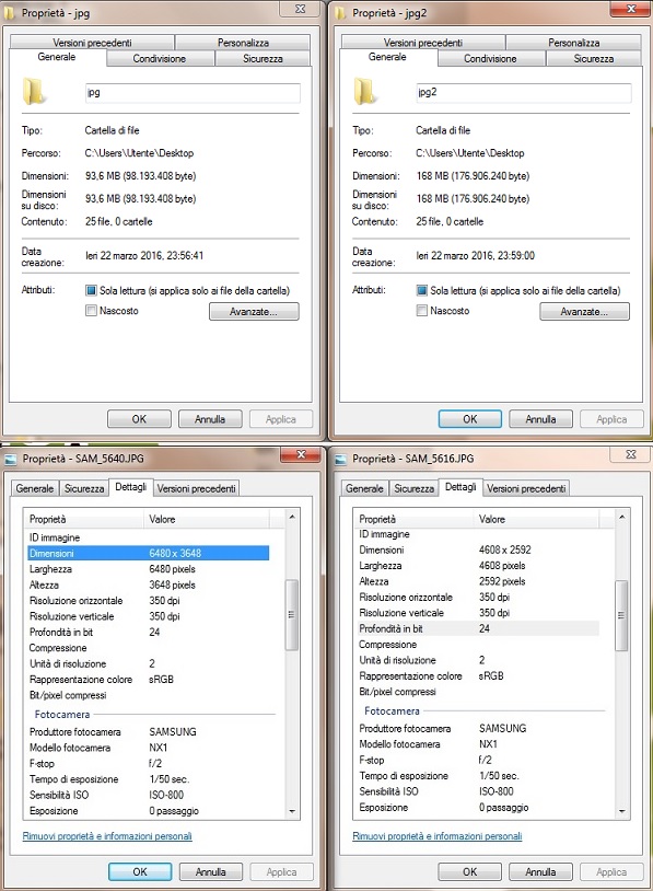

lucabutera Posted March 22, 2016 Share Posted March 22, 2016 25fps in jpeg, 4608x2592, aspect ratio 16:9, picture quality "super fine", has a bit rate of about 100MB/s. 25fps in jpeg, 6480x3640, aspect ratio 16:9, picture quality "super fine", has a bit rate of about 170MB/s. The Vasile hack has demonstrated that the Samsung nx1 is able to shoot video over 150MB / s so we are not very far from a new Magic Lantern for Samsung Nx1. vaga, SMGJohn and Hanriverprod 3 Link to comment Share on other sites More sharing options...
vaga Posted March 23, 2016 Share Posted March 23, 2016 Interesting that the number of bits per 25 still 4k frames is less than the amount vasile has been able to unlock for 1 second of HEVC. Does the bitrate of the video include the audio track as well? How is the gradeablility of those JPEGs? Link to comment Share on other sites More sharing options...
SMGJohn Posted March 23, 2016 Share Posted March 23, 2016 11 minutes ago, vaga said: Interesting that the number of bits per 25 still 4k frames is less than the amount vasile has been able to unlock for 1 second of HEVC. Does the bitrate of the video include the audio track as well? How is the gradeablility of those JPEGs? JPEG's will have superior grading capability than HEVC, to match a Super Fine JPEG to HEVC the bitrate has to be so insane that grading that HEVC video is going to be a nightmare if you do not own a 50k dollar workstation, not to mention the HEVC codec in Premiere CC2015 is causing me more trouble and performance issue than I want to deal with, I rather spare a few GB of space and continue converting them to ProResLT. I rarely noticed banding issue with JPEG's in the NX1 either, some rare cases but that would just be the terrible JPEG compression algorithm that Samsung uses. If you want I can shoot a 15fps 6k in 16 by 9, 1 - 2 second video and you can have fun in whichever video editing software you use, from personal experience the JPEG's out of the camera have pretty damn good data in it, allowing me to pull some pretty amazing details out of dark areas and compress highlights, its no raw but its WAAAAY better than HEVC could probably ever do if you ask me. vaga 1 Link to comment Share on other sites More sharing options...

ReinisK Posted March 23, 2016 Share Posted March 23, 2016 6 hours ago, lucabutera said: 25fps in jpeg, 4608x2592, aspect ratio 16:9, picture quality "super fine", has a bit rate of about 100MB/s. 25fps in jpeg, 6480x3640, aspect ratio 16:9, picture quality "super fine", has a bit rate of about 170MB/s. The Vasile hack has demonstrated that the Samsung nx1 is able to shoot video over 150MB / s so we are not very far from a new Magic Lantern for Samsung Nx1. How did you reach 25fps? Isn't 15fps the max this camera can do? Link to comment Share on other sites More sharing options...
Pavel Mašek Posted March 23, 2016 Share Posted March 23, 2016 9 hours ago, lucabutera said: 25fps in jpeg, 4608x2592, aspect ratio 16:9, picture quality "super fine", has a bit rate of about 100MB/s. 25fps in jpeg, 6480x3640, aspect ratio 16:9, picture quality "super fine", has a bit rate of about 170MB/s. The Vasile hack has demonstrated that the Samsung nx1 is able to shoot video over 150MB / s so we are not very far from a new Magic Lantern for Samsung Nx1. MB (megabytes) and not same as Mb (megabits = usual unit for bitrate). 170MB/s (megabytes per second) are 1360Mb/s (megabits per second)... so it is completely different level of bitrate. Vasile hack provides +100Mb/s ( I do not want to brake his request about "not mention" bitrate :-)) so it is higher than default bitrate but still much lower than 170 MBps/1360 Mbps. vaga 1 Link to comment Share on other sites More sharing options...
Chant Posted March 23, 2016 Share Posted March 23, 2016 41 minutes ago, Pavel Mašek said: MB (megabytes) and not same as Mb (megabits = usual unit for bitrate). 170MB/s (megabytes per second) are 1360Mb/s (megabits per second)... so it is completely different level of bitrate. Vasile hack provides +100Mb/s ( I do not want to brake his request about "not mention" bitrate :-)) so it is higher than default bitrate but still much lower than 170 MBps/1360 Mbps. The camera is limited by the bus speed of UHS-2 which is 312MB/s 2496Mb/s Fastest card is currently the sandisk extreme pro at 250MB/s 2000Mb/s So there is much more to go until we reach that. Should be enough for what I am looking into. And remember, higher bit rate, lower compression, less math the processor needs to do, so less work and less heat. Theoretically the limit is high, and if you look at the dp review of the canon 80d and the nx1 their new low noise tech is still miles away. Hanriverprod and SMGJohn 2 Link to comment Share on other sites More sharing options...
