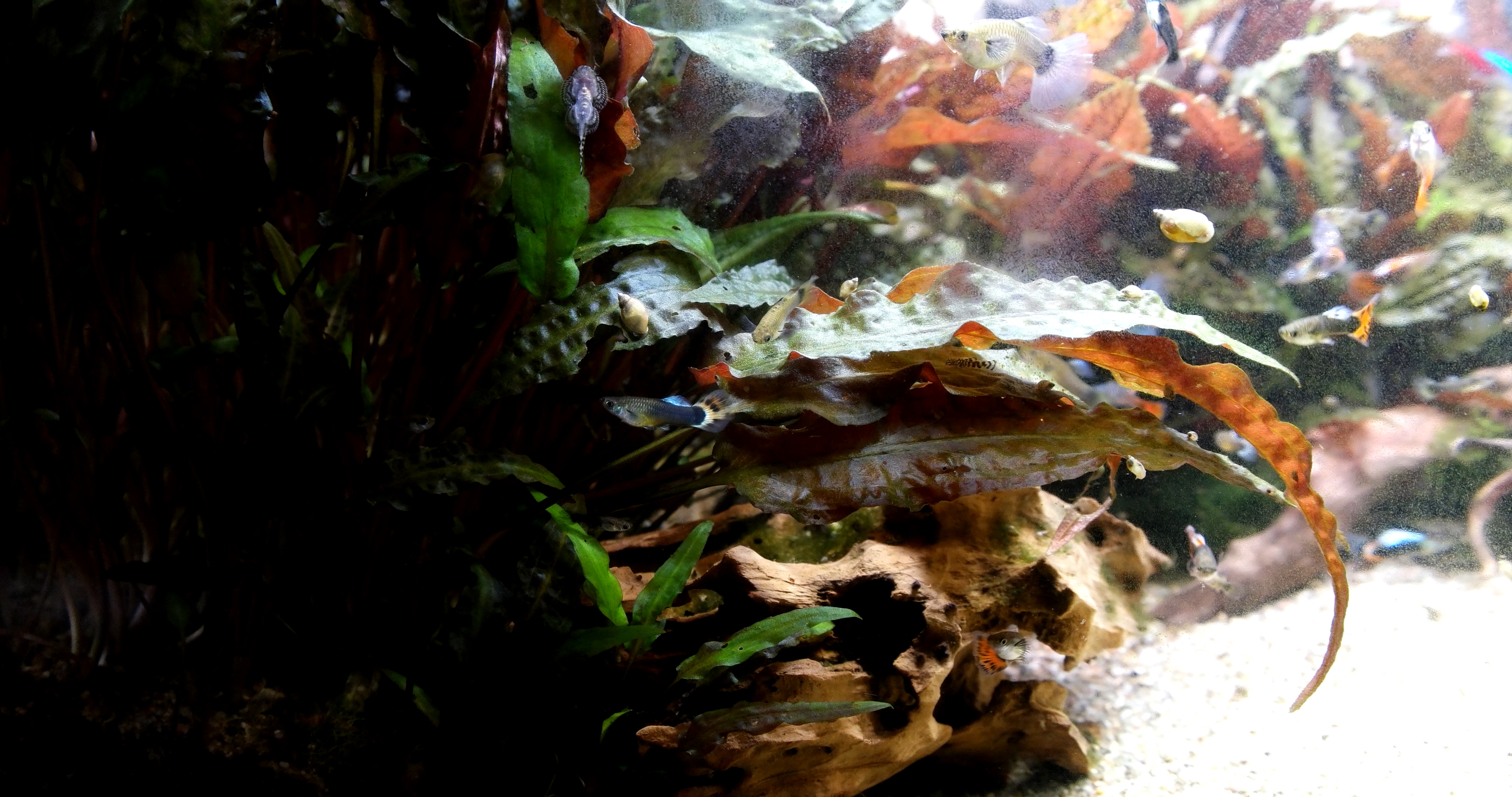

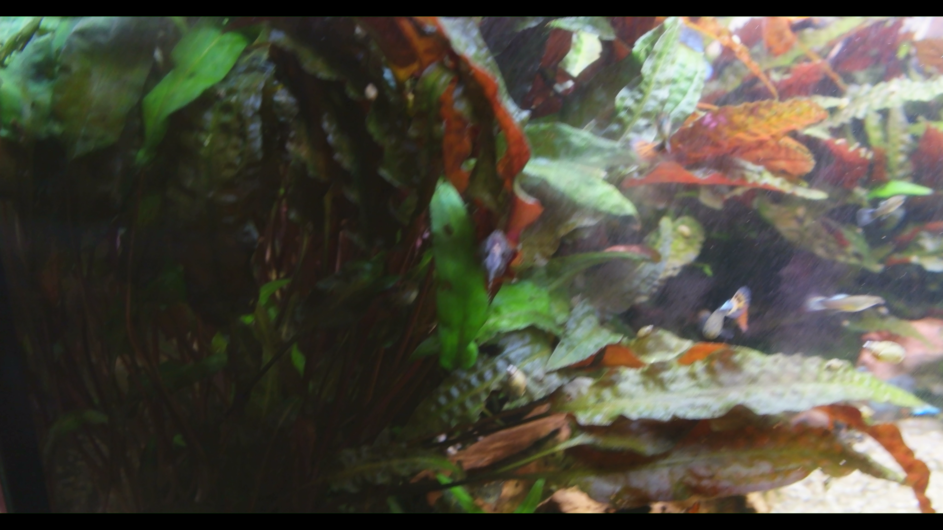

Pavel Mašek Posted March 18, 2016 Share Posted March 18, 2016 YESSS! Incredible! I am also surprise that playback is realtime in full resolution in Premiere (it was choppy but I had to move the file to SSD, then it was fine). (i7 3,2Ghz, SSD, Nvidia GTX960 with h265 support). I think it is not against Vasile's rules - here are just 2 images - default and graded. The shadows noise is very usable - my opinion: it is not fine noise, but look at that - default was completely black in shadows! Marco Tecno, SMGJohn, Hanriverprod and 2 others 5 Link to comment Share on other sites More sharing options...

Pavel Mašek Posted March 18, 2016 Share Posted March 18, 2016 Indeed it is still image from video so it does not show the "noise movement"...Maybe I pushed shadows too much but test it on your side and you will see. I think it is very useable. Link to comment Share on other sites More sharing options...
Geoff CB Posted March 18, 2016 Share Posted March 18, 2016 34 minutes ago, Pavel Mašek said: YESSS! Incredible! I am also surprise that playback is realtime in full resolution in Premiere (it was choppy but I had to move the file to SSD, then it was fine). (i7 3,2Ghz, SSD, Nvidia GTX960 with h265 support). I think it is not against Vasile's rules - here are just 2 images - default and graded. The shadows noise is very usable - my opinion: it is not fine noise, but look at that - default was completely black in shadows. Did a similar test. Ridiculously over and under exposed. I'm astounded. Given the lighting source I'm guessing we are looking at 800 iso or higher. Pavel Mašek, Hanriverprod, SMGJohn and 1 other 4 Link to comment Share on other sites More sharing options...

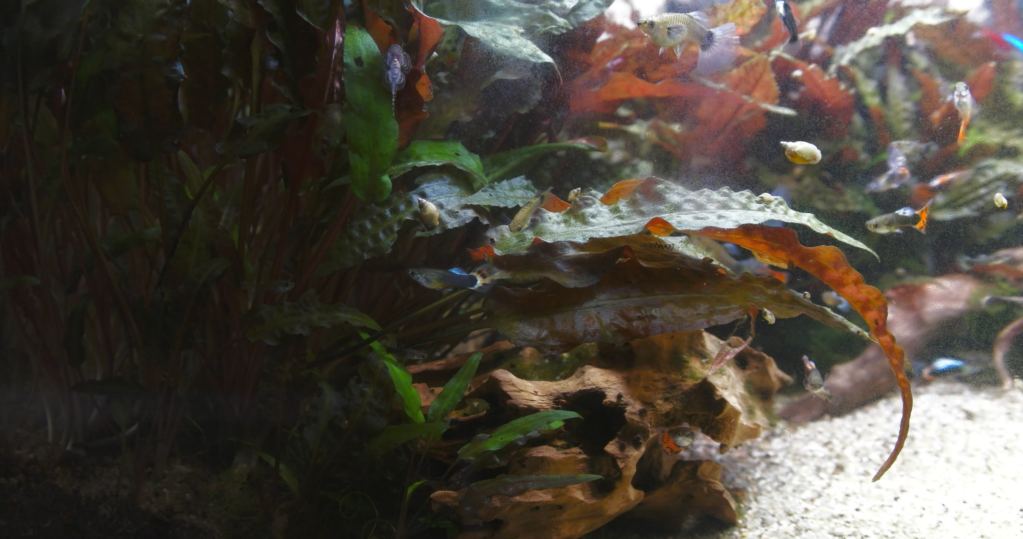

vaga Posted March 18, 2016 Share Posted March 18, 2016 I tried some basic adjustments in VLC and then screenshotted (I tried Resolve, but it crashed on my computer when it saw 4k footage). Link to comment Share on other sites More sharing options...
