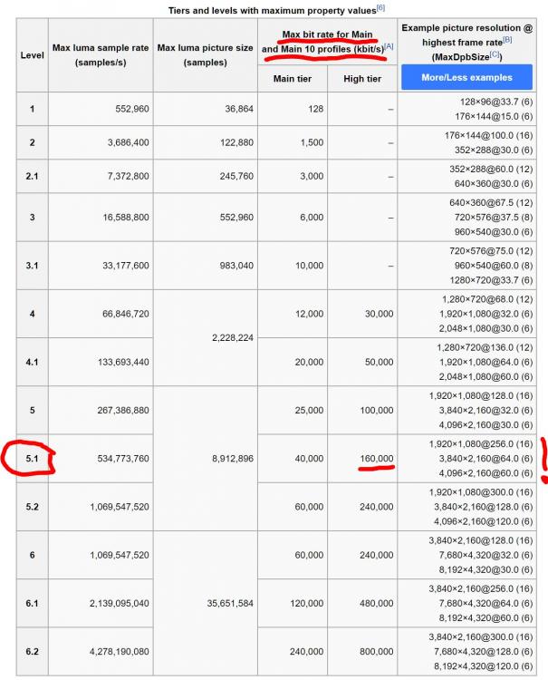

derderimmermuedeist Posted March 5, 2016 Share Posted March 5, 2016 If i see it right (in the Chart) then the maximum Bitrate for the H.265 HEVC is at Level 5.1 (found this Level in the File-Infos of my NX1-Videos) 160.000 kbit/s, approximately 156 Mbit/s. And interessting too, the maximum Frame rates: c4k @ 60p UHD @ 64p an FHD @ 256p SMGJohn, Pavel Mašek, saintsimon2016 and 1 other 4 Link to comment Share on other sites More sharing options...
