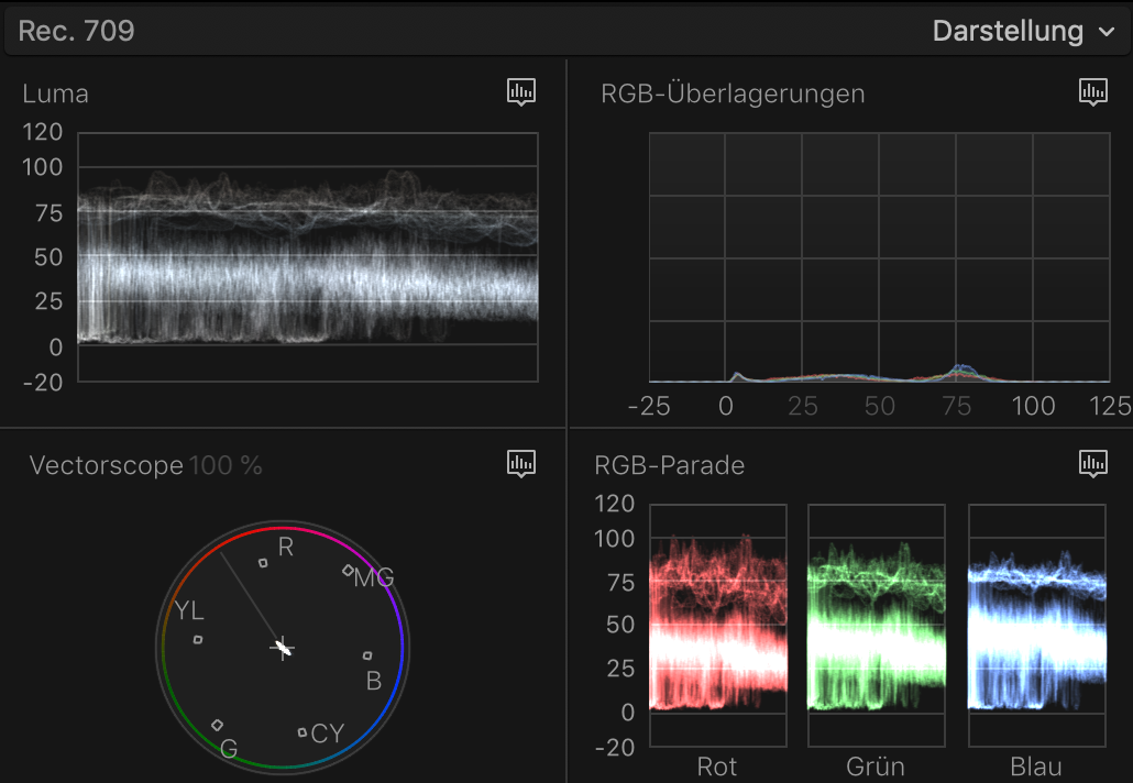

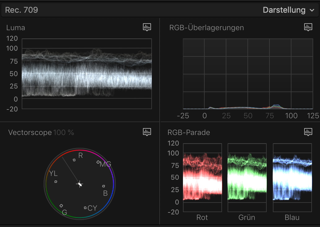

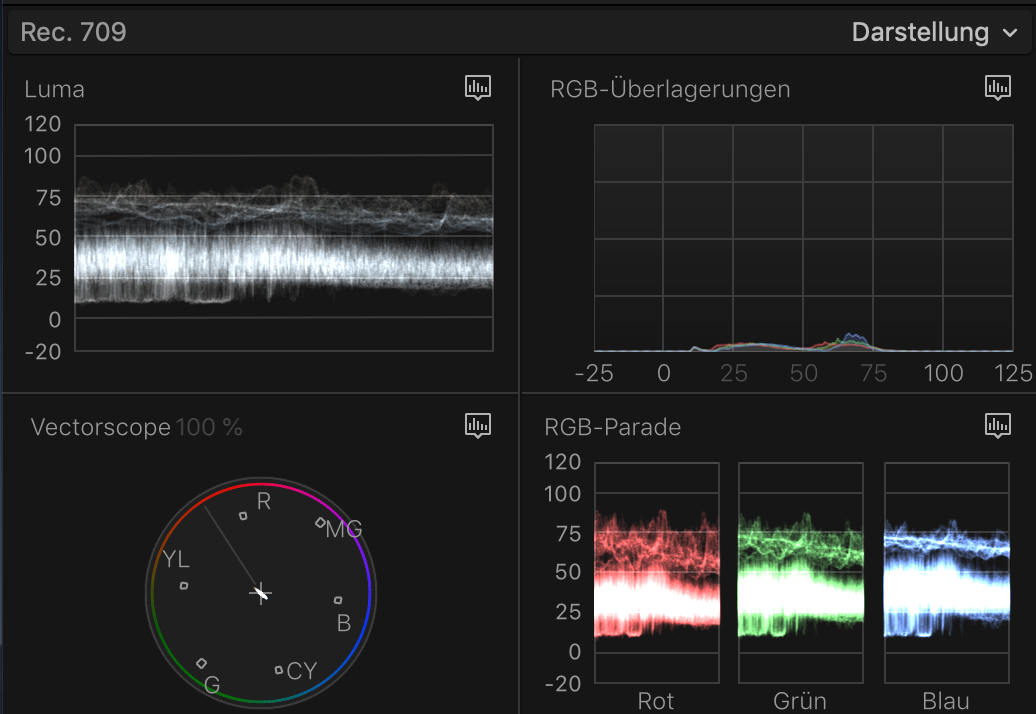

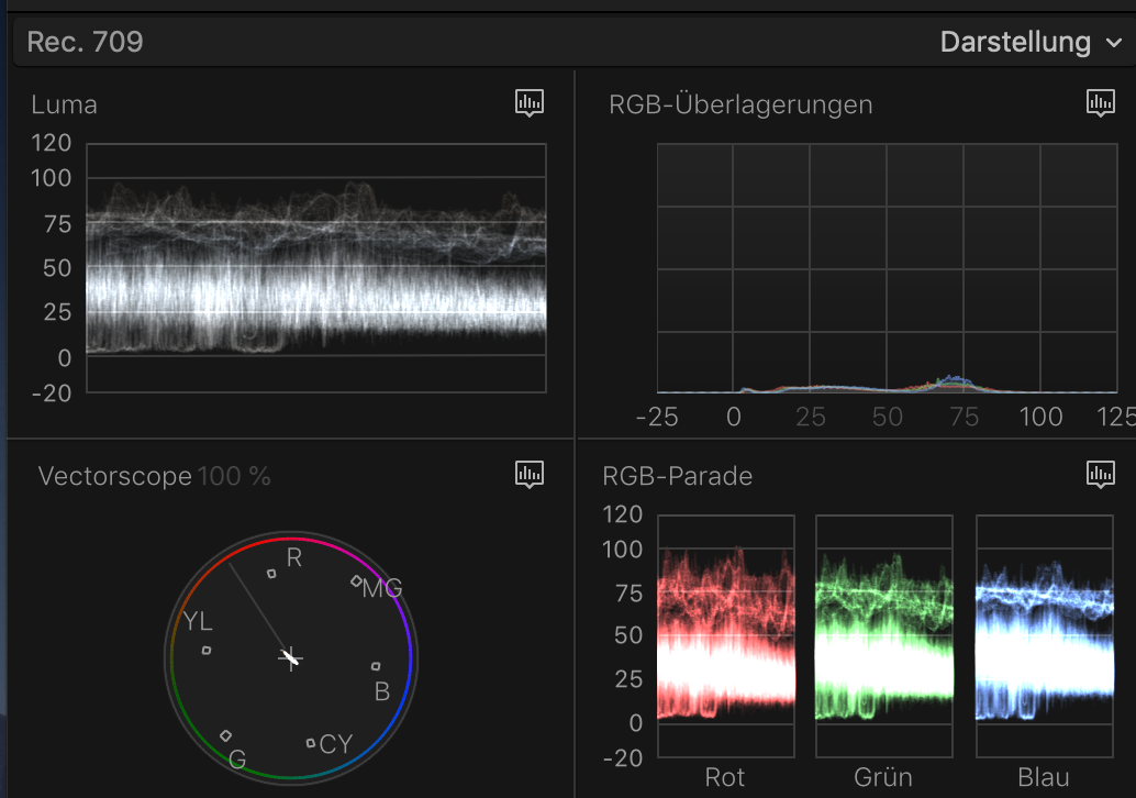

lebigmac Posted October 6, 2019 Share Posted October 6, 2019 Hello, in my quest to find out how fcpx handles hvec 16-235 files vs. 0-255 ones, it seems that the luma spectrum is wider with the 0-255 setting. When you push the fcpx's auto color correction button, however, both files level up to the same range and to my eye, there aren't any differences in the resulting pictures. What does this tell us? 0-255 16-235 0-255 with auto color correction 16-235 with auto color correction Link to comment Share on other sites More sharing options...
