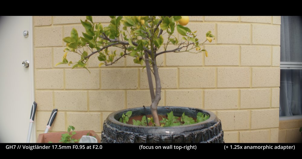

kye Posted August 4 Author Share Posted August 4 1 hour ago, BTM_Pix said: It certainly is, thanks for doing that. Much appreciated. I brought these images into Resolve and had a play, as well as some others I shot but haven't posted. It seems that the squeeze factor might be slightly more than 1.25x in some shots. I de-squeezed by just scaling around 0.75-0.8 vertically, and scaled the shots in post to match framing and got 1.388 on one and 1.276 on another. So even applying a large pinch of salt as it wasn't locked off, the squeeze factor seems to be variable. I wonder if this is distance related as perhaps the adapter moves the lens plane forward so that optically the position the camera sees from is moved forward a touch, as this would explain why the squeeze factor seemed to be more than advertised. It seems it's also a skill to get it rotated exactly vertically (although the adapter itself is easy to use in this regard). Link to comment Share on other sites More sharing options...

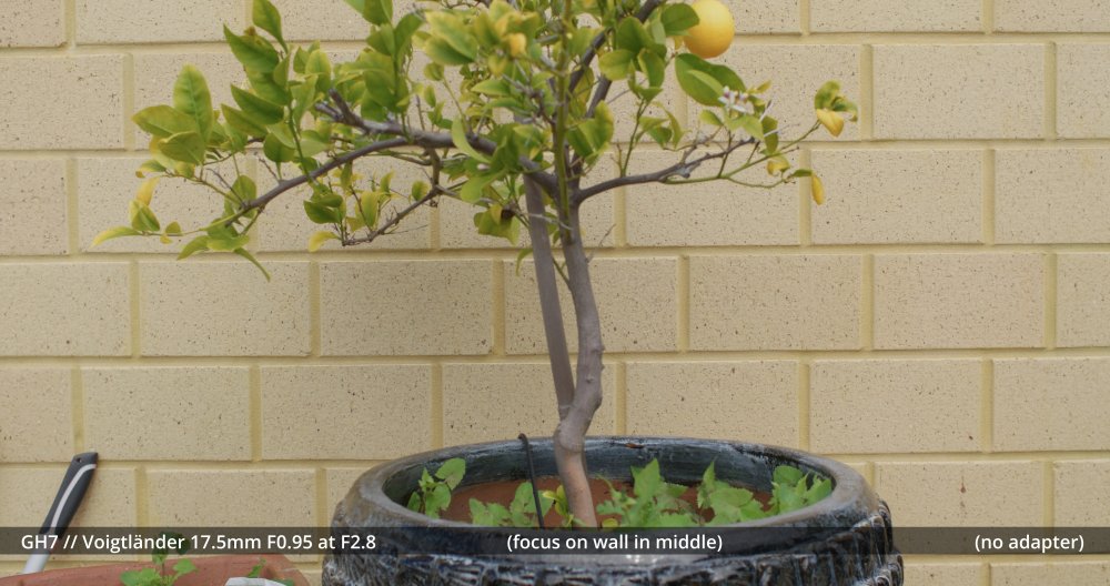

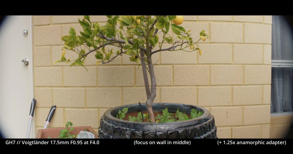

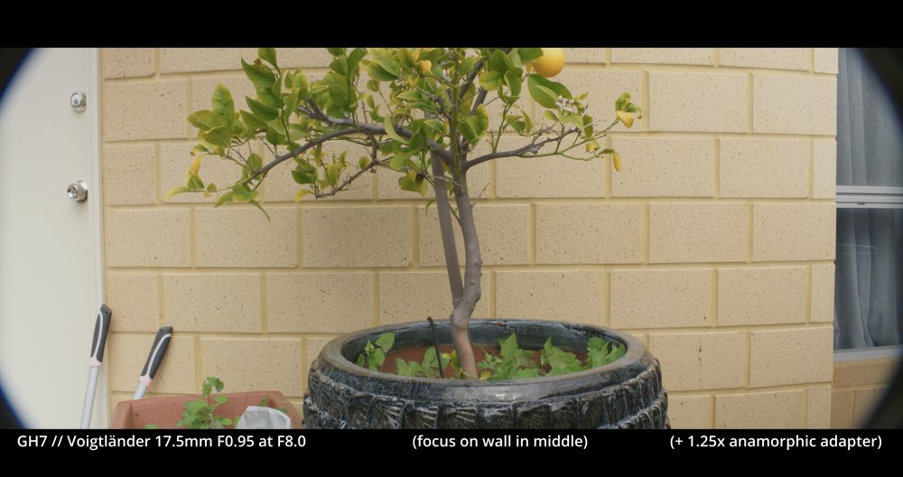

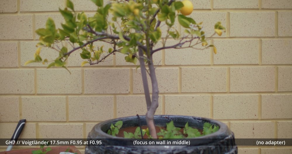

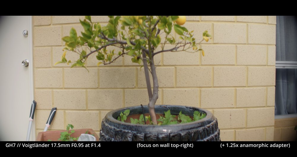

kye Posted August 5 Author Share Posted August 5 Testing the Sirui 1.25x adapter at various F-stops, including all the way down to F0.95. I wanted to see how much the Sirui was compatible with faster apertures than F2.8, which is what the manual suggests you use. Setup was with the GH7 shooting 5.7K and the Voigtländer 17.5mm F0.95 lens, which isn't so sharp wide open. The below stills from a 5.7K timeline. I matched exposure on the middle of the image, and used a fixed WB (the Voigt has colour shifts). It seems like it does soften the image slightly, but it's pretty minor and I also can't be sure that I focused it 100% perfectly either (the Voigt goes a little past infinity and the GH7 only does 6x punch-in), so it's at least as sharp as these images. I'll have to test flaring in a separate test, and also other focal lengths, but if you don't have bright lights in frame then it seems like you can go faster than F2.8, at least at around 17mm, which really opens up more possibilities I think. I also randomly grabbed this shot last week with the 14-140mm and Sirui - no idea if I focused it properly but the vibe is pretty nice! mercer 1 Link to comment Share on other sites More sharing options...

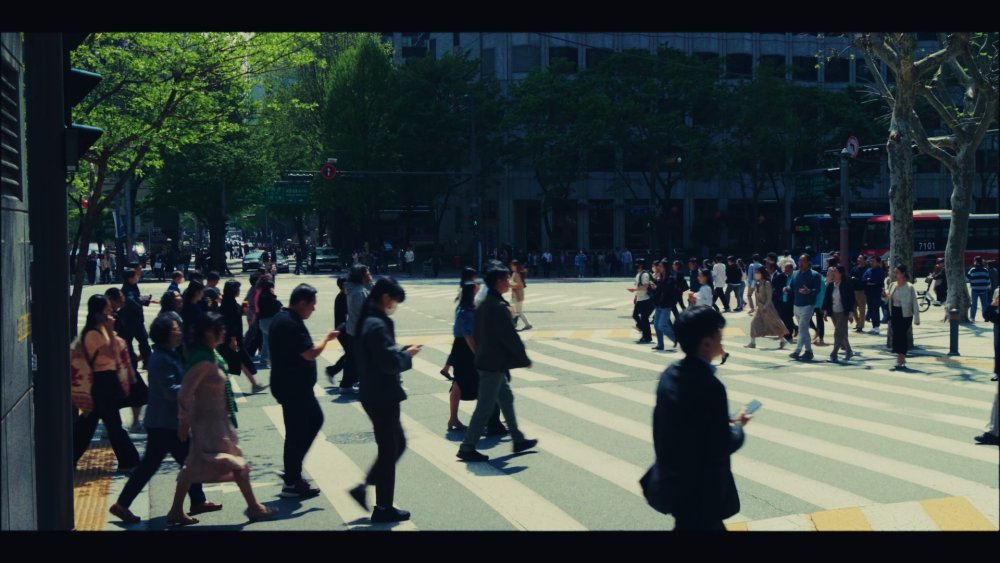

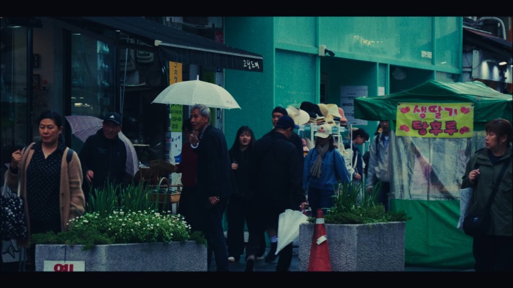

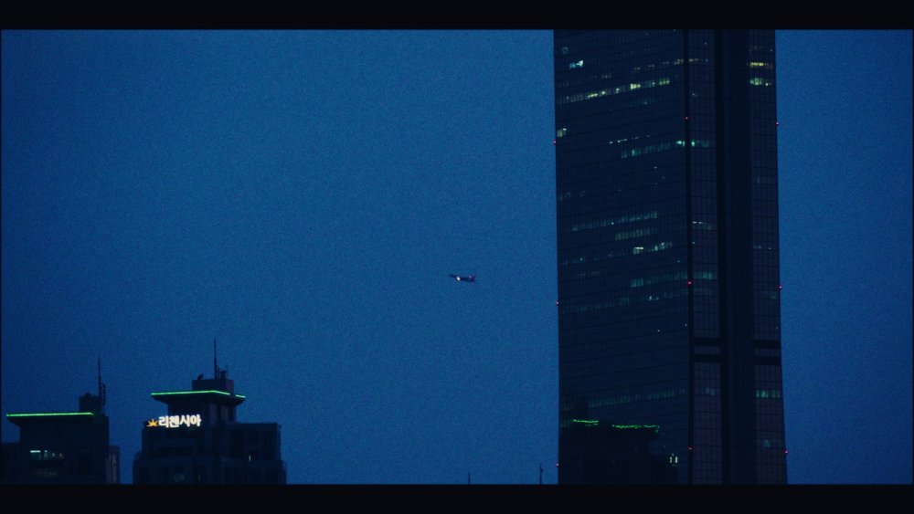

kye Posted August 7 Author Share Posted August 7 Yesterday I played around with FLC and grading some clips from Korea and the GH7 and 14-140mm. I plan to do a range of tests around settings for softening / sharpening / adding grain / other texture treatments in post, but YT compression is pretty diabolical so I'll need to do quite a number of upload tests to see what settings in Resolve get you what result on YT. I also went much bolder with the colours too, thinking of Gawx. This was a first attempt just to work out the ballpark of where to start. Probably the immediate takeaway is how the grain is quite different per shot, despite it being applied evenly to all shots. Here is a comparison between the timeline in Resolve, the 42Mbps h264 4K export, and the 12.6Mbps h265 4K YT download. Shot 1 - Resolve: Shot 1 - Export: Shot 1 - YT stream: Shot 2 - Resolve: Shot 2 - Export: Shot 2 - YT stream: Shot 3 - Resolve: Shot 3 - Export: Shot 3 - YT stream: Impressions: I'm told that film grain is most noticeable in the mids and shadows, so the distribution is consistent with film, which partly explains why the first image has less noticeable grain as most of the image is quite bright or quite dark. The sky shot seems to have lots of grain as it's a flat surface in the right luma range, but it seems that more grain is retained on the YT stream because there is less movement in the frame for the compression to cover. Whereas on the street scene the grain is considerably reduced despite having similar darker flat surfaces. I didn't apply any softening to this video, so the sharpness is direct from the 14-140mm -> GH7 5.7K to C4K downsample -> C4K 500Mbps Prores 422 -> 1080p timeline image path. The 14-140mm isn't tack sharp but it's not too bad. I've noticed in the past that grain can make images look sharper than they really are, but in this example the grain combined with the compression probably softens detail as a net result. I will definitely be exploring this relationship more. Film is known to have a sharpness of >1 at its maxima, so having some sharpening applied seems appropriate. Overall it seems to do a pretty good job capturing the grain, here's the next frame from the YT download so you can compare what is grain and what is detail and texture in the scene. mercer and BTM_Pix 2 Link to comment Share on other sites More sharing options...

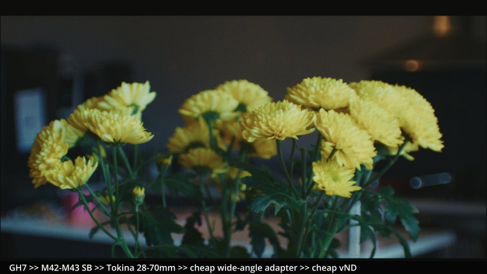

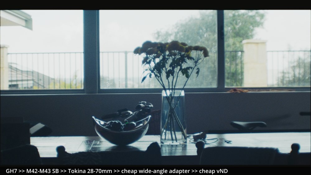

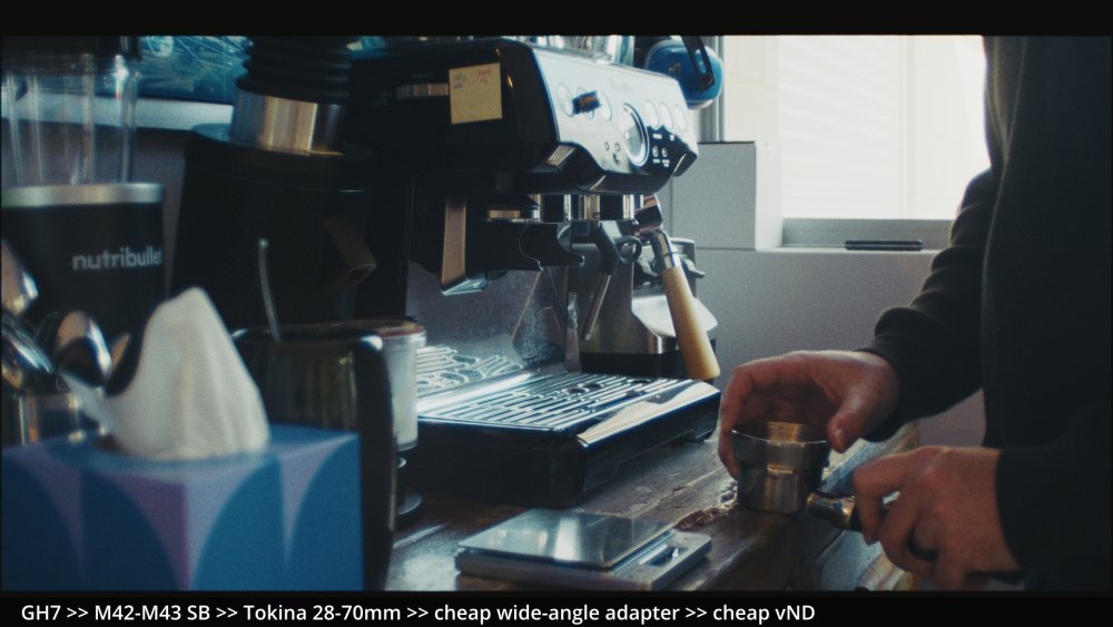

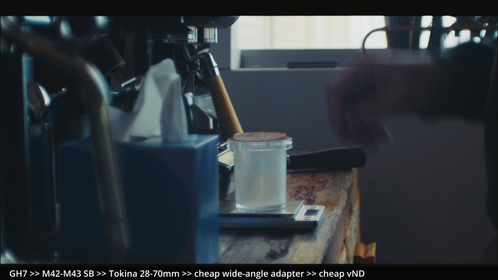

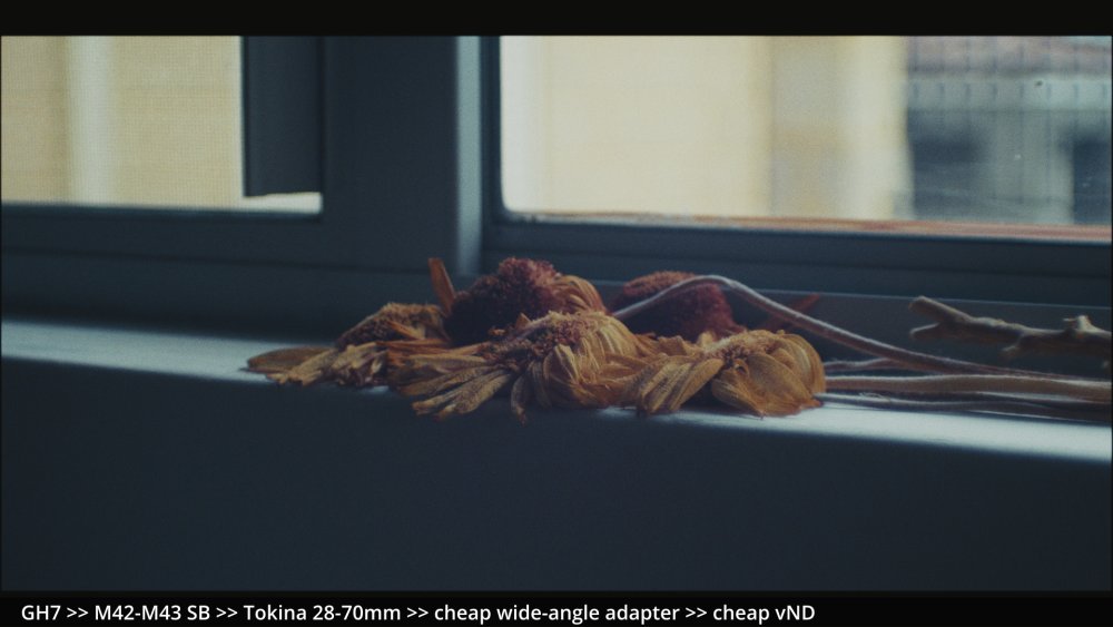

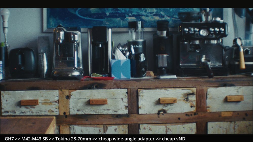

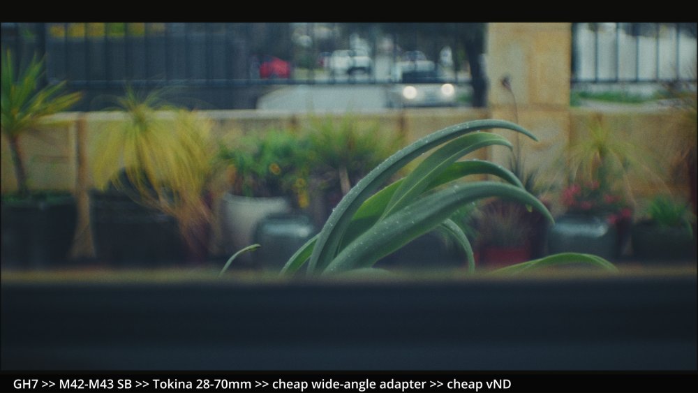

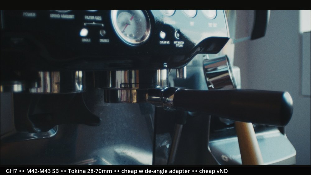

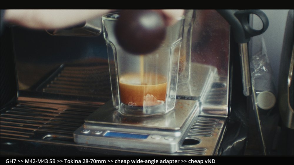

kye Posted August 22 Author Share Posted August 22 Shot a quick test with the Tokina RMC 28-70mm F3.5-4.5 zoom wide open with the wide-angle adapter. Combined with Resolve Film Look Creator it's super super analog, and maybe a bit too analog for what I would find uses for. Still, interesting reference. GH7 shooting C4K Prores 422 >> M42-M43 SB >> Tokina 28-70mm >> cheap wide-angle adapter >> cheap vND Resolve with 1080p timeline: CST to DWG >> exposure / WB >> slight sharpening >> FLC >> export Personally I am not really a fan of the hard-edged bubble-bokeh and the flaring with strong light-sources in frame is too much for most of what I shoot (mostly exterior locations and uncontrolled lighting) but it's great to know that looks with this level of texture are possible. I'm keen to compare it to the setup but without the wide-angle adapter. That would be less degraded but maybe in the right kind of way. Link to comment Share on other sites More sharing options...
EduPortas Posted August 22 Share Posted August 22 Nice! The contrasty light makes this images much more interesting than the previous flat ones. kye 1 Link to comment Share on other sites More sharing options...
QuickHitRecord Posted August 23 Share Posted August 23 To me, these are my favorite images yet -- by a long shot. I may need to reconsider my position on vintage zooms! kye 1 Link to comment Share on other sites More sharing options...
kye Posted August 23 Author Share Posted August 23 13 hours ago, EduPortas said: Nice! The contrasty light makes this images much more interesting than the previous flat ones. Thanks. If you like contrasty light, my next batch of images should please you! 8 hours ago, QuickHitRecord said: To me, these are my favorite images yet -- by a long shot. I may need to reconsider my position on vintage zooms! What is it about them you like? Is it how imperfect / degraded they are? They certainly have an incredible amount of feel, that's for sure. This zoom is the Tokina RMC 28-70mm F3.5-4.5 and I understand these were held in reasonably high regard back in the day, so it's potentially not a disaster, although I'm not sure that it's the sharpest / cleanest vintage zoom in the world. Looking back at the initial set of images I posted in my first post, this seems to have gotten the closest with the softness of the OOF areas and the CA / colour fringing etc. Link to comment Share on other sites More sharing options...

QuickHitRecord Posted August 23 Share Posted August 23 4 hours ago, kye said: What is it about them you like? Is it how imperfect / degraded they are? They certainly have an incredible amount of feel, that's for sure. All of the above. I think that the lessening of detail forces my brain to "fill in the blanks", making it more of an interactive set for me. And I have an emotional response to an espresso machine, which I usually wouldn't. 4 hours ago, kye said: This zoom is the Tokina RMC 28-70mm F3.5-4.5 and I understand these were held in reasonably high regard back in the day, so it's potentially not a disaster, although I'm not sure that it's the sharpest / cleanest vintage zoom in the world. Curious, does the front element rotate when focusing on this? On 8/21/2025 at 8:30 PM, kye said: Personally I am not really a fan of the hard-edged bubble-bokeh and the flaring with strong light-sources in frame is too much for most of what I shoot (mostly exterior locations and uncontrolled lighting) but it's great to know that looks with this level of texture are possible. I've held the same position for years but lately I've been learning to like it. Hard-edged bokeh is one of the big differentiators between modern and vintage glass. Link to comment Share on other sites More sharing options...
kye Posted August 24 Author Share Posted August 24 10 hours ago, QuickHitRecord said: All of the above. I think that the lessening of detail forces my brain to "fill in the blanks", making it more of an interactive set for me. And I have an emotional response to an espresso machine, which I usually wouldn't. Curious, does the front element rotate when focusing on this? I've held the same position for years but lately I've been learning to like it. Hard-edged bokeh is one of the big differentiators between modern and vintage glass. Yes, it has an emotional component doesn't it - that's a good way of putting it. There are lots of parallels between cinema and dreaming or memories, so in some ways the more realistic the image is the less aligned it is with all the other things about it that are dreamlike or like a memory (e.g. we can teleport, jump time, speed up and slow things down, we can see something happening without being there, we can fly, etc). Considering that memories are formed more readily at points of heightened emotion, I think there's a link between a slightly surreal image and something feeling emotional. Unfortunately the front element rotates with focus on this lens. I had it in my head that means I can't use it with the anamorphic adapter but just realised that's not true as the taking lens should stay at infinity... I'll have to try that next! I'm not sure about hard-edged bokeh.. maybe I'll come around but not sure. Our attention is directed by a number of things, one of which is sharpness, and so focusing the lens is the act of deliberately directing the viewers attention by adjusting the focal plane to be on the subject of the image. When the out-of-focus areas have hard edges, this takes the viewers attention and pulls it towards things that have not been chosen as important in that image, so it sort of undermines the creative direction of the image in a way that you can't really counter. Link to comment Share on other sites More sharing options...
