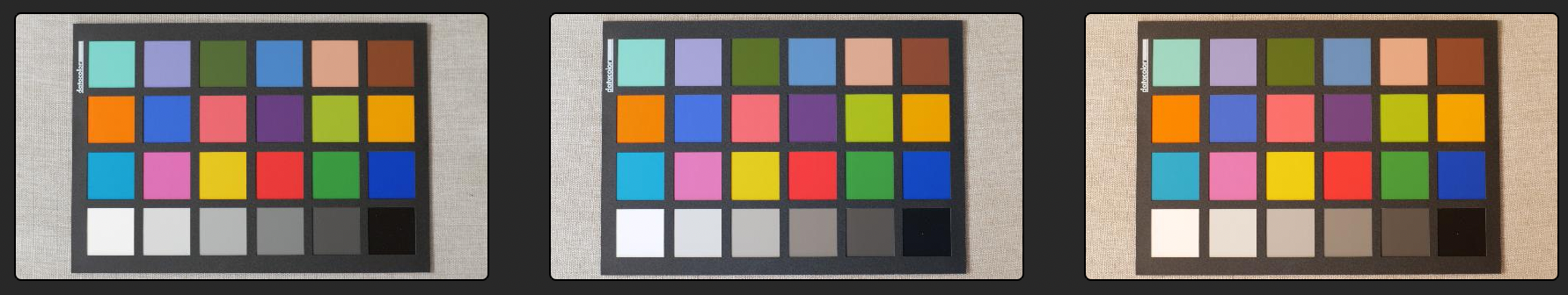

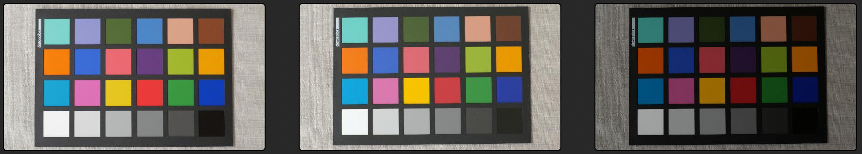

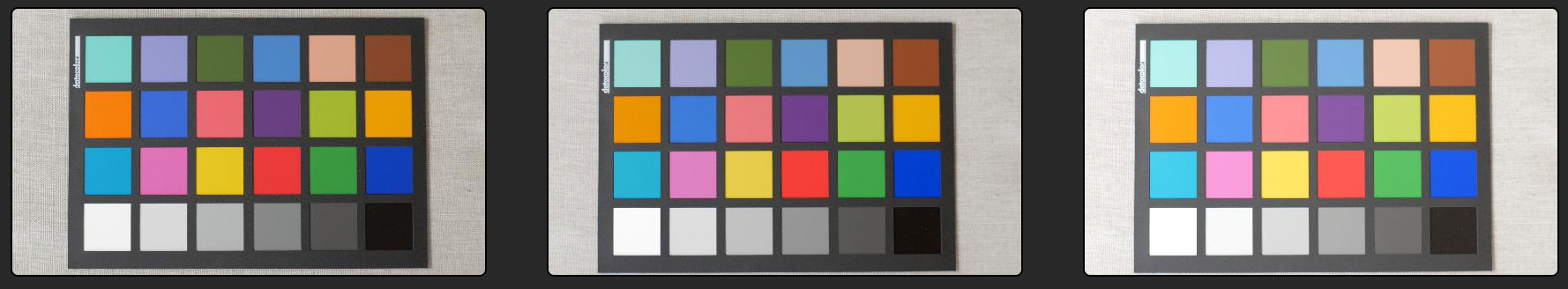

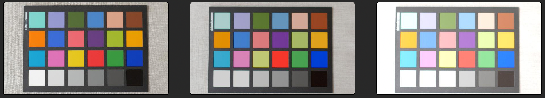

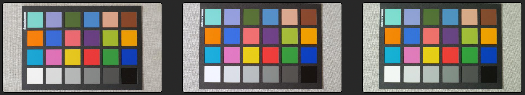

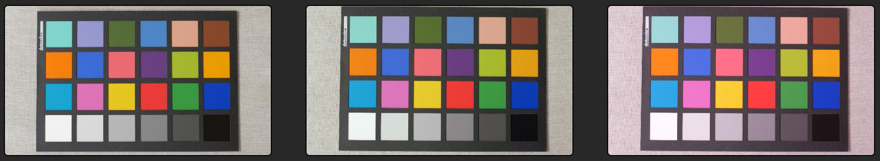

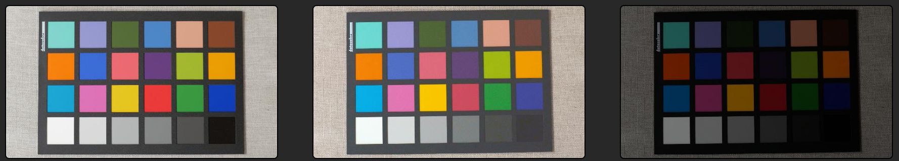

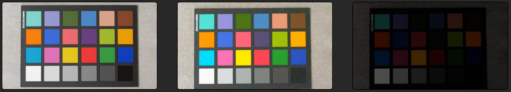

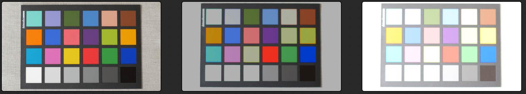

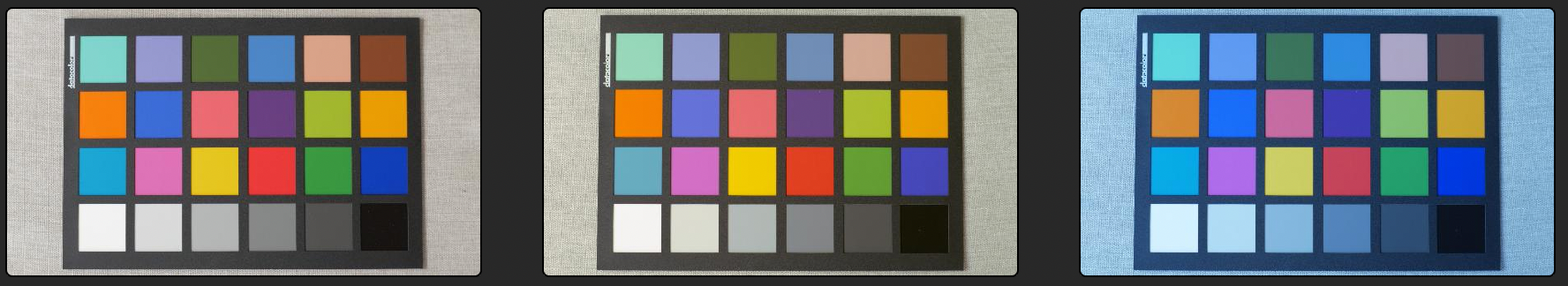

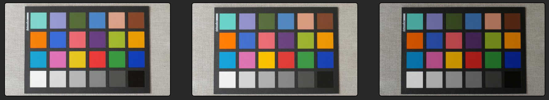

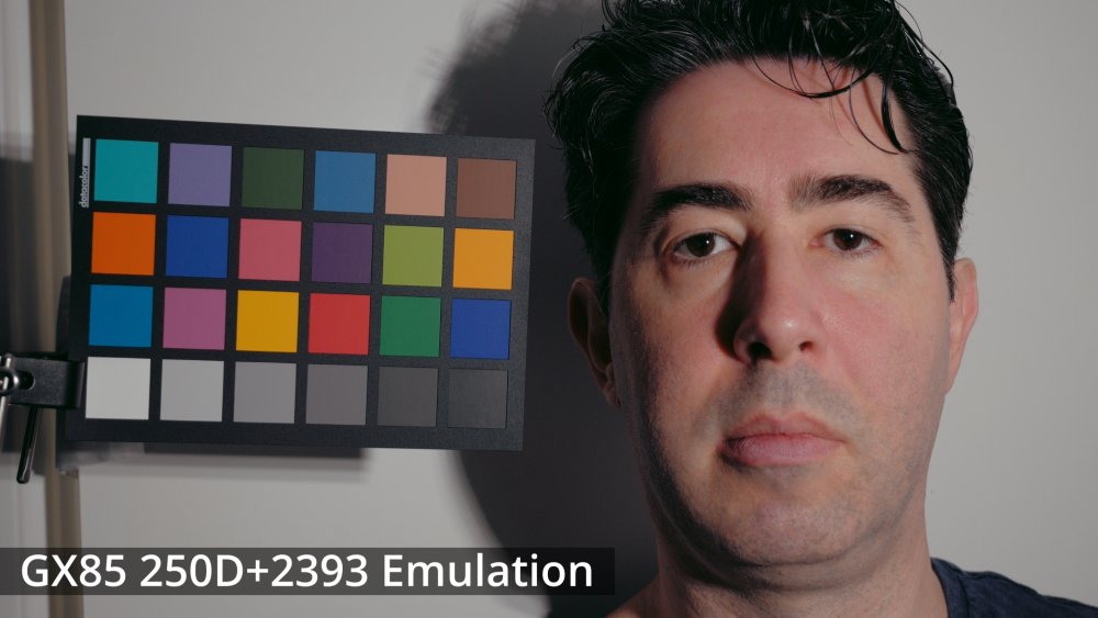

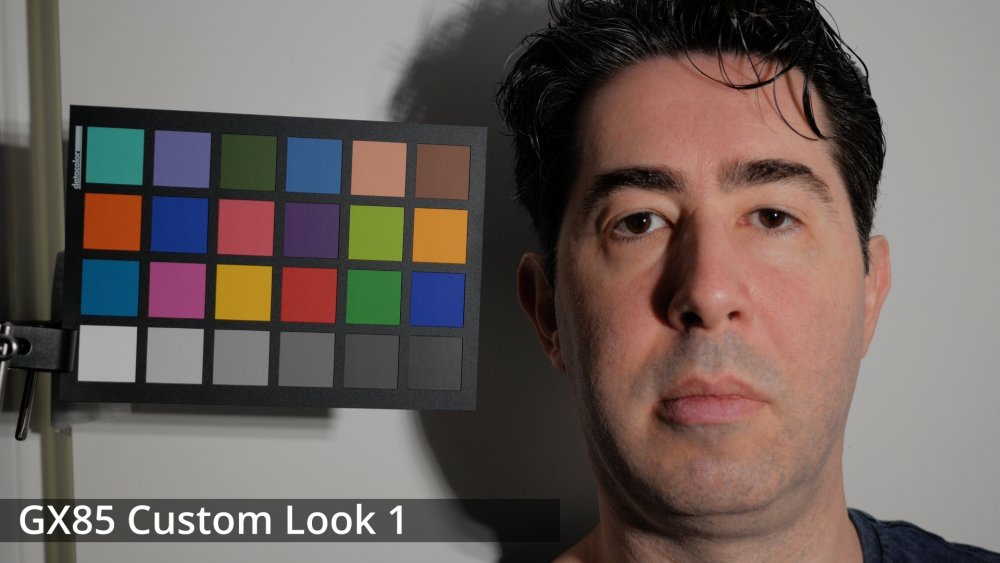

kye Posted January 2, 2024 Share Posted January 2, 2024 8-bit rec709 profiles are much more flexible in post than you might think. I'm not saying they're as good as an Alexa or whatever, but they're a million miles better than people give them credit for. Here's a latitude and WB torture test of the GX85, in the standard profile (8-bit rec709) customised to have reduced contrast but normal saturation. For each of the below, the left image is the properly exposed reference image, the middle one is the graded image, and the one on the right is the image SOOC. Exposure latitude test - +3 stops: Exposure latitude test - +2 stops: Exposure latitude test - +1 stops: Exposure latitude test - -1 stops: Exposure latitude test - -2 stops: Exposure latitude test - -3 stops: Exposure latitude test - -4 stops: Exposure latitude test - warm: Exposure latitude test - cool: Exposure latitude test - magenta: Exposure latitude test - green (as far as it would go!): Notes on the testing method: GX85 shot in manual mode on cloudy day Exposure varied by changing lens aperture WB varied by changing colour temp and tint Tools used in Resolve were mostly Lift/Gamma/Gain, saturation, and some had a bit of Shadows/Mids/Highlights Notes on the results: If it's clipped then it's clipped, there's no getting around that If you've shot a whole sequence in the wrong WB then shoot a test chart replicating the error, spend some time on the correction, then apply to all the shots... a bit of work but worth it to rescue a days shooting If you've shot on auto-exposure / auto-WB and want to correct the small errors then this is easily possible - it won't have gotten it nearly as wrong as what I have shown above Most cameras shooting in rec709 will do funky stuff to colours depending on their luma value as part of the look of the profile, so when you over/under expose and then pull things back the hues and saturation levels will have shifted around in odd ways compared to a normal exposure, but if it's a real shoot then you most likely won't have many dominant hues in the image and you only have to correct the ones that are in the frame and distracting, so the above is far more work than normal shooting would be The days of needing RAW or even LOG to change exposure or WB in post are gone, and although the rec709 profiles often have lower DR than log profiles, they're much better than you think. If anyone wants me to post full-sized versions with titles so you can flick back and forth then just let me know. Happy shooting! Beritar, Rinad Amir, John Matthews and 3 others 2 4 Link to comment Share on other sites More sharing options...

John Matthews Posted January 2, 2024 Share Posted January 2, 2024 Great work, @kye! I'd be interested at looking at the full resolution images if possible. After doing the WB tests, do you think there's more latitude in slightly blue, magenta, or green version. I remember that Gerald Undone did a test some time ago and found more latitude in a warmer WB than a bluer WB. FHDcrew 1 Link to comment Share on other sites More sharing options...
kye Posted January 2, 2024 Author Share Posted January 2, 2024 12 minutes ago, FHDcrew said: Love this! I am coming to the same conclusion as I shoot in 8-bit rec709 more and more. And I find that having a color managed workflow helps a lot; the image is quite flexible when conformed to Davinci Wide Gamut; responds a lot like LOG does. And if my exposure and white balance aren't too off, the grading experience is great. Actually, for these I didn't use Colour Management (I know this will shock people!) and it was a bit of a surprise to me too, but the LLG controls just worked better. The fact they're designed for rec709 might have something to do with that, perhaps, maybe... ? 😆😆😆 I normally make my adjustments in real projects using Colour Management, and they're fine because they're not a torture test like this with huge adjustments, but maybe I'll keep this in mind and if I get difficult shots then maybe I'll change to rec709 for one node and do the adjustments in that. 8 minutes ago, John Matthews said: Great work, @kye! I'd be interested at looking at the full resolution images if possible. After doing the WB tests, do you think there's more latitude in slightly blue, magenta, or green version. I remember that Gerald Undone did a test some time ago and found more latitude in a warmer WB than a bluer WB. Cool, I'll work out the best way to post them. TBH I don't know what "more latitude" really means. For example it might be the amount you can shift something before clipping occurs, or before some level of visible undesirable aesthetic effect occurs, but this would be situation dependent and also user dependent. If you can think of a way to test this then I'd be happy to have a look. From memory, I think I set the blue image to a colour temp in the 6000s and the warm one to 3200, and neutral was in the middle somewhere. The magenta and green images were setting the in-camera adjustment to the maximum it would go in those directions. So, from that, these are very large WB errors to recover from, and (hopefully!!) much more than you'd ever encounter in real life. FHDcrew and John Matthews 2 Link to comment Share on other sites More sharing options...

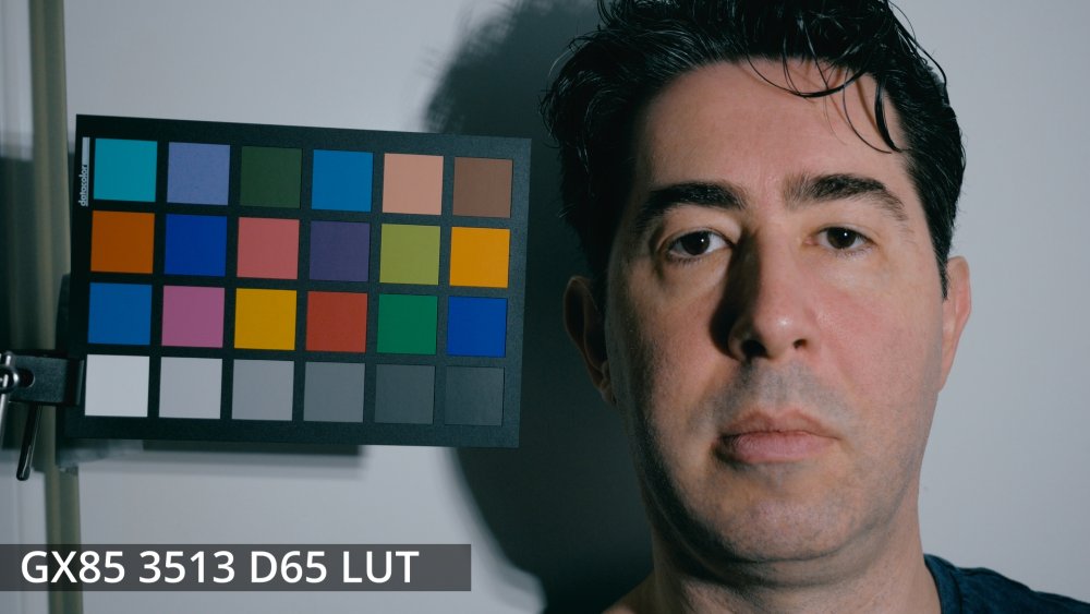

kye Posted January 2, 2024 Author Share Posted January 2, 2024 Also, if anyone can think of any other tests I should do then I'm all ears. Perhaps the one that might be useful is including skintones, so maybe I'll have to make a cameo in the test images. Realistically, the ability to recover skintones is probably the most important thing, and perhaps the most fragile. FHDcrew 1 Link to comment Share on other sites More sharing options...
FHDcrew Posted January 2, 2024 Share Posted January 2, 2024 Would love to see skin tones! I need to learn how to work with them given 8-bit limitations. That indeed always tends to be the trickiest for me to work on. John Matthews 1 Link to comment Share on other sites More sharing options...
kye Posted January 2, 2024 Author Share Posted January 2, 2024 15 minutes ago, FHDcrew said: Would love to see skin tones! I need to learn how to work with them given 8-bit limitations. That indeed always tends to be the trickiest for me to work on. Skin-tones are always the trickiest because we are much more sensitive to this area of the colour cube than any other. If I make a cameo then you'll get to enjoy the full range of tones - from pasty to gaunt and all the way to magenta and red. Lucky you! In terms of working with skin-tones "given 8-bit limitations" I don't think there are limitations, at least if we're working with 8-bit rec709 images. In broad terms, the danger of "breaking" the image comes from areas where the bits are too far apart and the associated artefacts become visible. The bits are broadly as far apart in 8-bit 709 as they are in 10-bit LOG as they are in 12-bit RAW. The difference that most people experience between those is likely to be the compression, considering that 8-bit 709 will mostly be 10-100Mbps, 10-bit log will mostly be 50-400Mbps, and 12-bit RAW will be uncompressed. Perhaps the worst combination is 8-bit log, which TBH, is so bad it should be against the Geneva convention on human rights. This is the worst combination because the bits in the final image are spread apart the most. This is why I shoot rec709 with normal amounts of saturation - it gives more information for colours than if you reduce the saturation in-camera and then boost it in post. It's also why the iPhone HDR implementation is so good - it is 10-bit but the levels of saturation in the files is close to 709 levels, so you have a really large amount of colour fidelity still retained in the files. John Matthews 1 Link to comment Share on other sites More sharing options...
kye Posted January 2, 2024 Author Share Posted January 2, 2024 Link to files. The reference image is repeated so you can just go back and forth to compare. Enjoy! https://www.dropbox.com/scl/fo/vj7wthlzjc9ocqtphvclt/h?rlkey=ivcvcj3hmdrow1q0zsof0wc1p&dl=0 John Matthews 1 Link to comment Share on other sites More sharing options...
John Matthews Posted January 2, 2024 Share Posted January 2, 2024 36 minutes ago, kye said: Link to files. The reference image is repeated so you can just go back and forth to compare. Enjoy! https://www.dropbox.com/scl/fo/vj7wthlzjc9ocqtphvclt/h?rlkey=ivcvcj3hmdrow1q0zsof0wc1p&dl=0 I downloaded all of them. My conclusion (as I thought): stay away from overexposure. Underexposure is scary, but noise can be dealt with. Overexposure results in lost colors and a strange halo softening that you don't have with underexposure. kye 1 Link to comment Share on other sites More sharing options...
