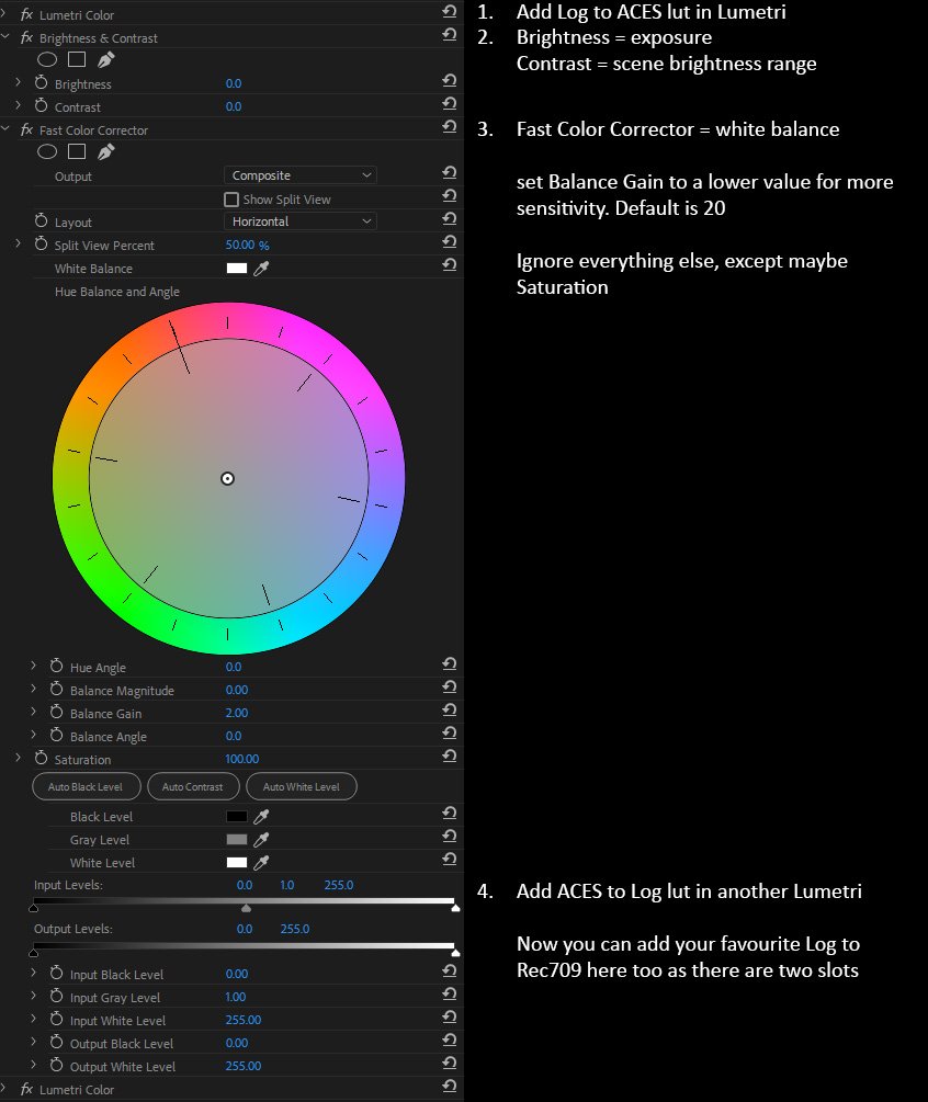

hyalinejim Posted June 16, 2022 Share Posted June 16, 2022 I've long been a fan of 10bit log because of how far it can be pushed without falling apart. However, I still use Premiere for all of my jobs. This is because I'm used to it, have old projects that I often need to incorporate in new ones and sometimes I need to be able to talk nicely to After Effects and Photoshop. I don't mind editing in it. But colour correction sucks for log footage. The Lumetri controls are designed to work on God knows what gamma. It's OK-ish for making luminance adjustments to log gammas (still not by any means perfect) but trying to white balance accurately is basically impossible. The highlights will be over corrected and the shadows undercorrected. For a while, for critical colour work I had been pasting Premiere timelines into After Effects in order to use an ACES worfklow there using the OpenColorIO plugin. The advantage of working in ACES space is that you can adjust exposure, contrast and colour globally across the luminance range. If you're used to using the White Balance, Exposure and Contrast sliders in Lightroom for photo editing then basically you can do the same thing very easily in ACES colour space. Finally, and thanks in part to a post on the Sigma FP thread I've found a way to do something similar in Premiere. Here's how to do it. You'll need a free copy of Resolve for this. Create a Resolve project with these settings and add a clip: Add Color Space Transform effect to a node and set the input to the gamut and gamma of your log footage. Then right click the CLIP thumbnail and generate a 3D lut (65 point). This lut will transform your log footage into an ACES-like condition: Now add a second node and add a Color Space Transform effect. This time the color spaces and gammas are reversed. This gets your footage back to log. Our corrections will go between these two transformations. Disable the first node (or delete it) and generate a second lut: Now in Premiere add the following effects: The first lut, Log to ACES, goes in the first instance of Lumetri (you'll have to find it in the Effects Panel and drag it to the clip. Don't go into the Color workspace as we'll need two instance of Lumetri) The second lut is ACES to Log and that goes in the second instance of Lumetri (if you put this in the Basic lut slot you can put a log to Rec709 in the Creative lut slot) Between the two add brightness and contrast. +15 brightness units is one stop. Also add the obsolete Fast Color Corrector. This simple colour wheel will do all your white balancing for you. There's even a white balance dropper if you need it. The wheel is very sensitive, though, so I lower the Balance Gain to 2 to make it less sensitive. If you have a nice lut that you like for your log footage then this is all you need to colour correct very, very quickly in Premiere. White balance, exposure, contrast. Done! Next! I'll post some examples of saving poorly exposed and white balanced shots when I have time. Premiere stupidly doesn't allow you to save the four effects as a single preset, but you can save the first lumetri as a preset, the two middle effects as a preset, and the last lumetri as a preset. I would love to not use Lumetri at all for this, but can't find a simple "Apply Color LUT" effect like there is in After Effects. Does anyone know of one? webrunner5 and PannySVHS 2 Link to comment Share on other sites More sharing options...

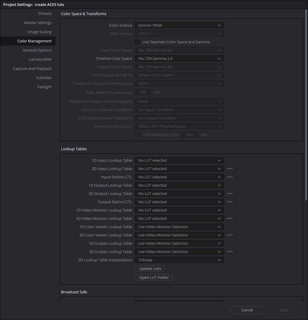

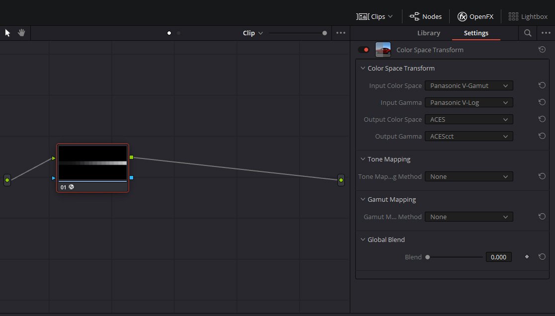

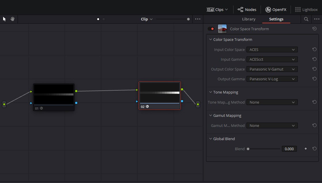

hyalinejim Posted June 16, 2022 Author Share Posted June 16, 2022 Actually, I think I made a mistake regarding the colour space. In the Resolve colour space transform effects, all colour space drop down boxes should be at Rec709, otherwise the colours go wonky. Link to comment Share on other sites More sharing options...
kye Posted June 17, 2022 Share Posted June 17, 2022 @hyalinejim Have you confirmed this works? I thought LUTs ignored OFX plugins? I've tried creating LUTs before with it and the OFX plugins were ignored and the LUTs weren't usable because of this. Link to comment Share on other sites More sharing options...

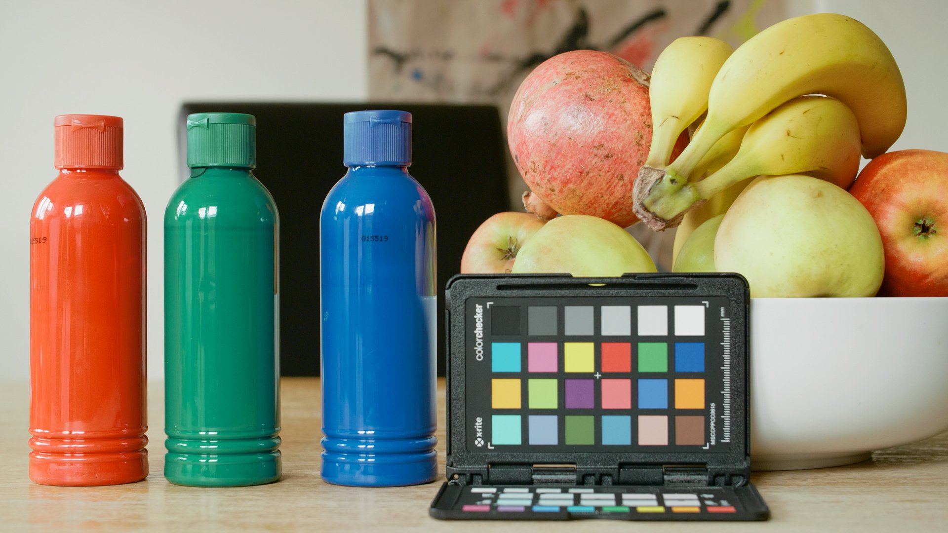

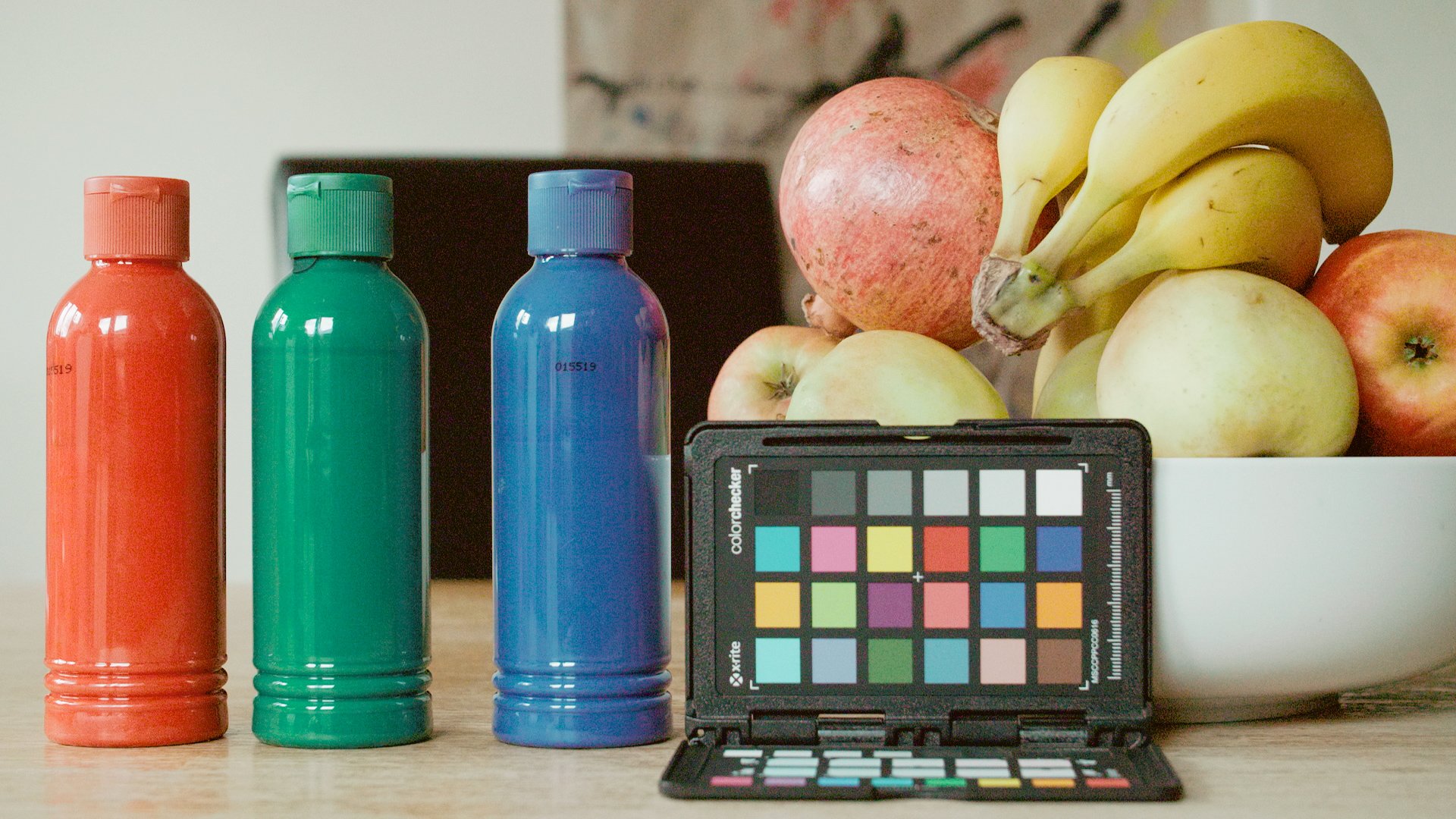

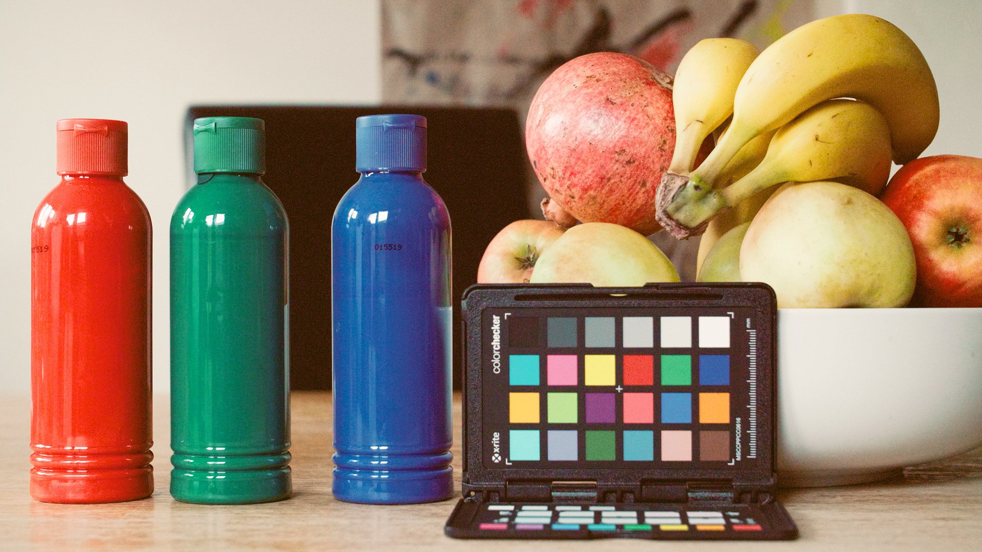

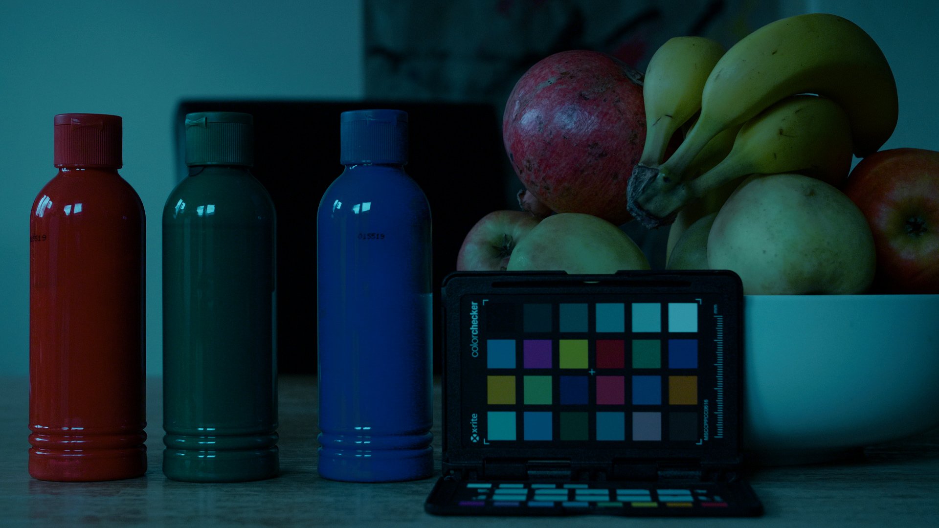

hyalinejim Posted June 17, 2022 Author Share Posted June 17, 2022 10 hours ago, kye said: @hyalinejim Have you confirmed this works? I thought LUTs ignored OFX plugins? I've tried creating LUTs before with it and the OFX plugins were ignored and the LUTs weren't usable because of this. Yes, it works! At least for the workflow I'm describing. All of the below are GH5 V-Log with a lut applied (open in separate tabs to compare): Target image, roughly correct exposure and WB. Wrong image, 3 stops underexposed and wrong white balance. Wrong image corrected with exposure and white balance adjustments within Lumetri, under the lut, so that patch D4 matches the target image. Note that contrast has changed and there are colour is off in the shadows and highlights. Wrong image corrected as described above. Contrast is correct and colour is almost perfect (I think some colour information is clipped in the underexposure and cannot be recovered from the noise floor). kye 1 Link to comment Share on other sites More sharing options...
FHDcrew Posted June 17, 2022 Share Posted June 17, 2022 Man this is huge. I loved this style of functionality in Davinci, in Davinci you can use the HDR “global” slider and set color space/gamma to your log curve, giving very accurate exposure adjustments in post. Works well for my Z6 as N-log has no native ACES support. This is HUGE for premiere pro users and makes lumetri much more viable. Resolve is still a better grading software though :) webrunner5 1 Link to comment Share on other sites More sharing options...
kye Posted June 17, 2022 Share Posted June 17, 2022 26 minutes ago, hyalinejim said: Yes, it works! At least for the workflow I'm describing. All of the below are GH5 V-Log with a lut applied (open in separate tabs to compare): Target image, roughly correct exposure and WB. Wrong image, 3 stops underexposed and wrong white balance. Wrong image corrected with exposure and white balance adjustments within Lumetri, under the lut, so that patch D4 matches the target image. Note that contrast has changed and there are colour is off in the shadows and highlights. Wrong image corrected as described above. Contrast is correct and colour is almost perfect (I think some colour information is clipped in the underexposure and cannot be recovered from the noise floor). Awesome! Maybe it's a newer version of Resolve - I tried exposing a power grade to a LUT and it failed because it ignored the CST OFX plugin, and surprisingly, it didn't work right without that CST in the middle of it!! 7 minutes ago, FHDcrew said: Man this is huge. I loved this style of functionality in Davinci, in Davinci you can use the HDR “global” slider and set color space/gamma to your log curve, giving very accurate exposure adjustments in post. Works well for my Z6 as N-log has no native ACES support. This is HUGE for premiere pro users and makes lumetri much more viable. Resolve is still a better grading software though 🙂 Resolve is better, no doubt. However, you can do a huge amount even with basic tools, so there's no excuses 🙂 hyalinejim 1 Link to comment Share on other sites More sharing options...

FHDcrew Posted July 24, 2022 Share Posted July 24, 2022 Looks like I’ve reached the point where premiere will be a necessity for some work I do 😞 So now I gotta break away from resolve a bit and start learning premiere. I’ll still color in resolve, though this exposure technique first mentioned in this thread will be very useful for quick grades in premiere. Honestly with this, along with turning CST into a LUT, I could probably replicate my grading process in premiere. I don’t do any complex grades, I simply like the organization and behavior of the tools available in resolve. webrunner5 1 Link to comment Share on other sites More sharing options...
kye Posted July 25, 2022 Share Posted July 25, 2022 7 hours ago, FHDcrew said: Looks like I’ve reached the point where premiere will be a necessity for some work I do 😞 So now I gotta break away from resolve a bit and start learning premiere. I’ll still color in resolve, though this exposure technique first mentioned in this thread will be very useful for quick grades in premiere. Honestly with this, along with turning CST into a LUT, I could probably replicate my grading process in premiere. I don’t do any complex grades, I simply like the organization and behavior of the tools available in resolve. Just kidding... 🙂 My understanding is that Premier is probably still a better editor than Resolve (although Resolve is closing the gap) and that the main issue with Premier is that it crashes all the time. Save early, save often. In terms of colour though, we all love to think that the 5,984 controls that Resolve has are required for good colour, but it's not true - if you get the basics dialled in then you can get great looking images with the tools that basically any NLE has. webrunner5, FHDcrew and hyalinejim 3 Link to comment Share on other sites More sharing options...
