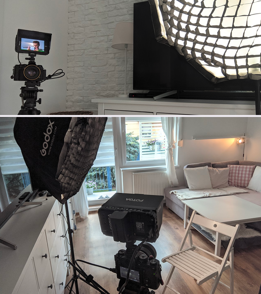

heart0less Posted May 9, 2020 Author Share Posted May 9, 2020 A simple talking head setup - check! Only 1 bulb (out of 4) used and - okay, I admit it - it was a bit too bright to my liking in this scenario. Don't ignore inverse square law, lads and guys! The key light was ~ 50 cm away from me. f/1.4 , 1/160 s, ISO 1000, WB - 4000K BTS: Mark Romero 2, zerocool22, Simon Young and 3 others 6 Link to comment Share on other sites More sharing options...
