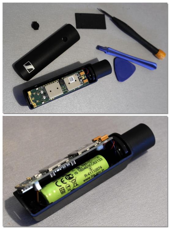

Super Members BTM_Pix Posted April 5, 2019 Super Members Share Posted April 5, 2019 When this system was announced, there was a discussion over the internal rechargeable battery not only in terms of run times but also over longevity and if it failed would that be game over for the units. At the time, I speculated that based on the power spec quoted by Sennheiser and the shape of the units then it was likely that it was going to be a standard off the shelf battery (a 3.7V/850mAh 14500) so not only should it be possible to replace a dead battery, it shouldn't be that much of a challenge to make it swappable if you needed really long run times in the field. So.....now that I actually have one, I thought I'd have a look. And, yes indeed, it is a standard 3.7V/850mAh 14500 battery. You can pick these up for less than £1 each and a charger will set you back about £5-7. The connector to the board is also just a standard connector so if you really need the longer run times and swap out capability its pretty straightforward to fashion this yourself and have all day run times for both receiver and transmitter for under £20. Now, where did I put that warranty form.... sanveer, solovetski, Grimor and 3 others 2 1 3 Link to comment Share on other sites More sharing options...

keem85 Posted May 30, 2021 Share Posted May 30, 2021 On 4/5/2019 at 7:41 PM, BTM_Pix said: When this system was announced, there was a discussion over the internal rechargeable battery not only in terms of run times but also over longevity and if it failed would that be game over for the units. At the time, I speculated that based on the power spec quoted by Sennheiser and the shape of the units then it was likely that it was going to be a standard off the shelf battery (a 3.7V/850mAh 14500) so not only should it be possible to replace a dead battery, it shouldn't be that much of a challenge to make it swappable if you needed really long run times in the field. So.....now that I actually have one, I thought I'd have a look. And, yes indeed, it is a standard 3.7V/850mAh 14500 battery. You can pick these up for less than £1 each and a charger will set you back about £5-7. The connector to the board is also just a standard connector so if you really need the longer run times and swap out capability its pretty straightforward to fashion this yourself and have all day run times for both receiver and transmitter for under £20. Now, where did I put that warranty form.... Is there any chance you can show us how we swap the battery with a new 3.7V/850mAh 14500 battery ? Where do we solder and how? I really need to know this before buying the set for both my mic and guitar. It's such expensive kits and I want to know I have long longevity on this.. My Relay G10 is such trash, and I Had to bin it after less than two years of use.. Link to comment Share on other sites More sharing options...

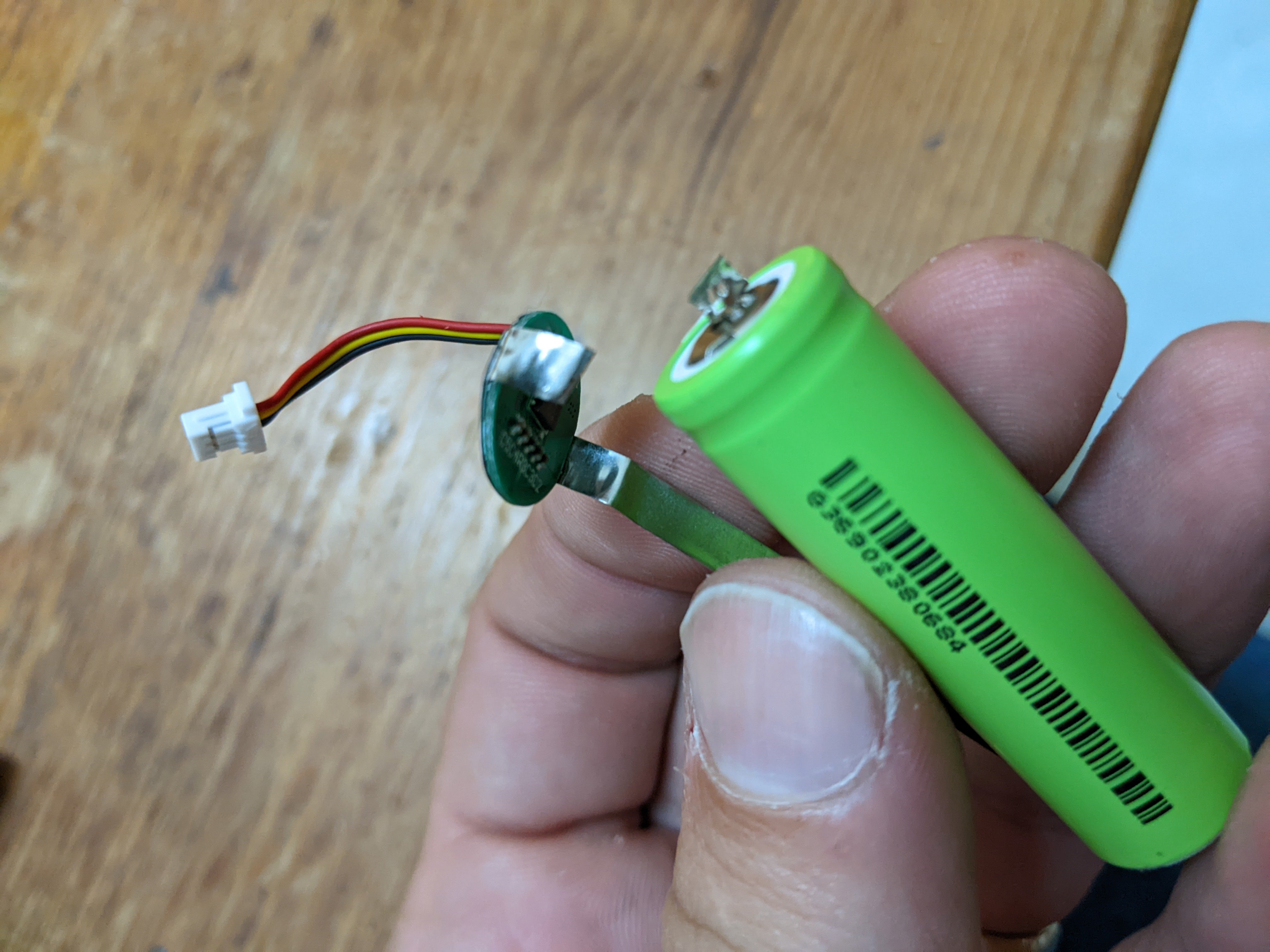

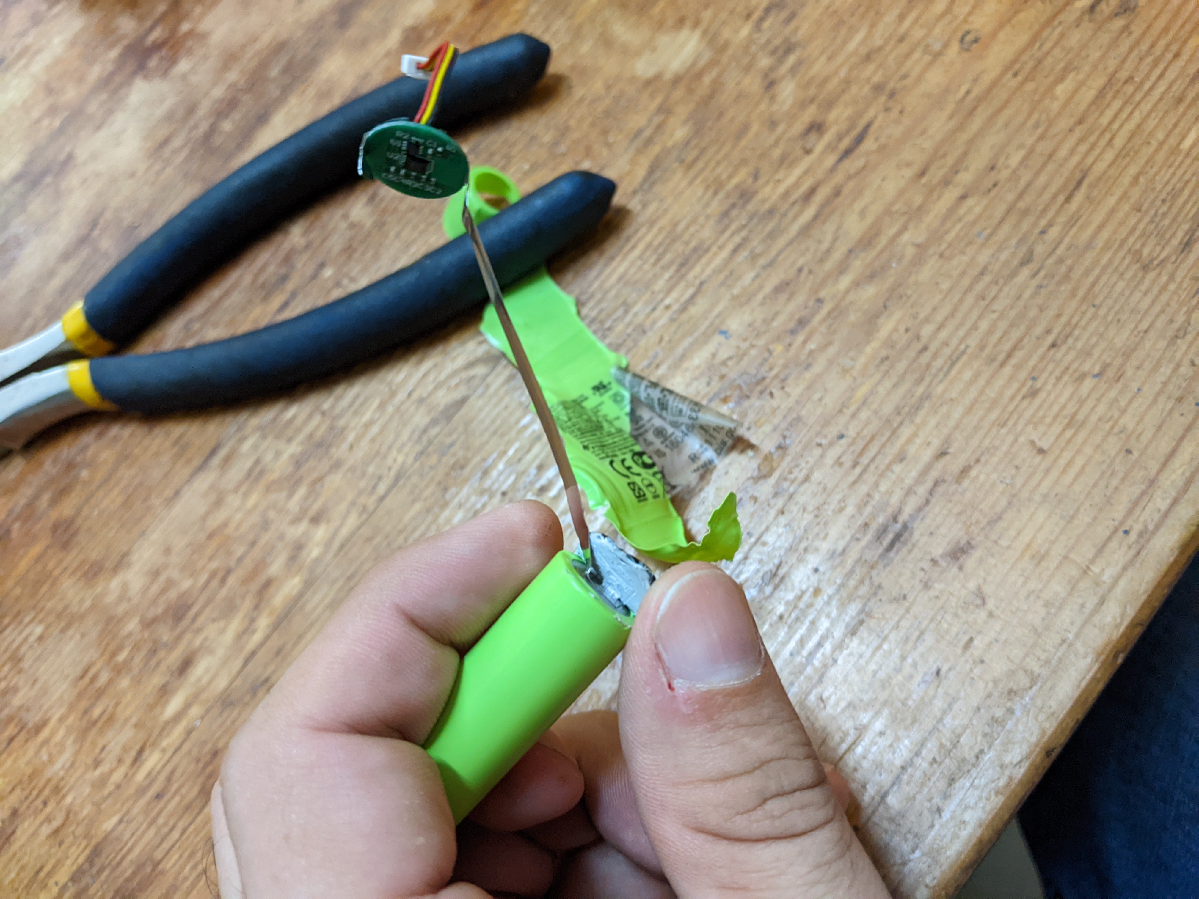

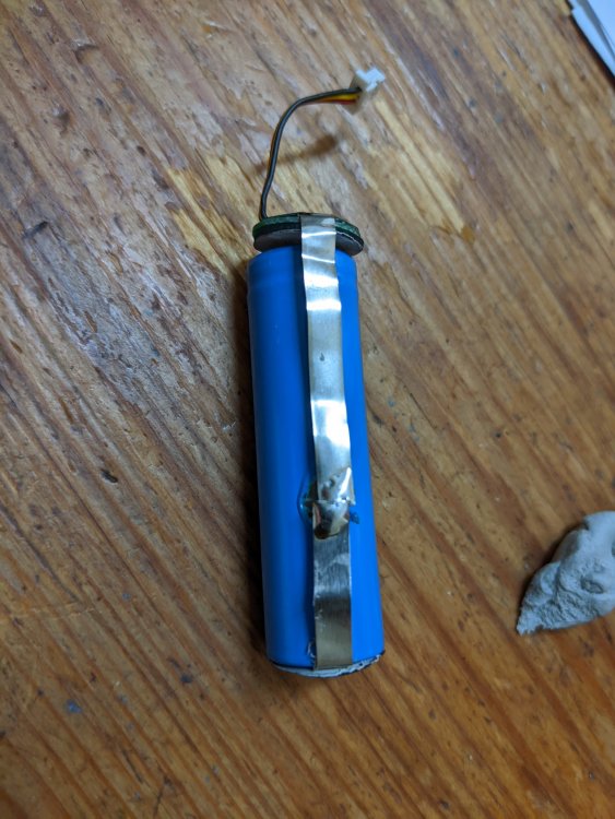

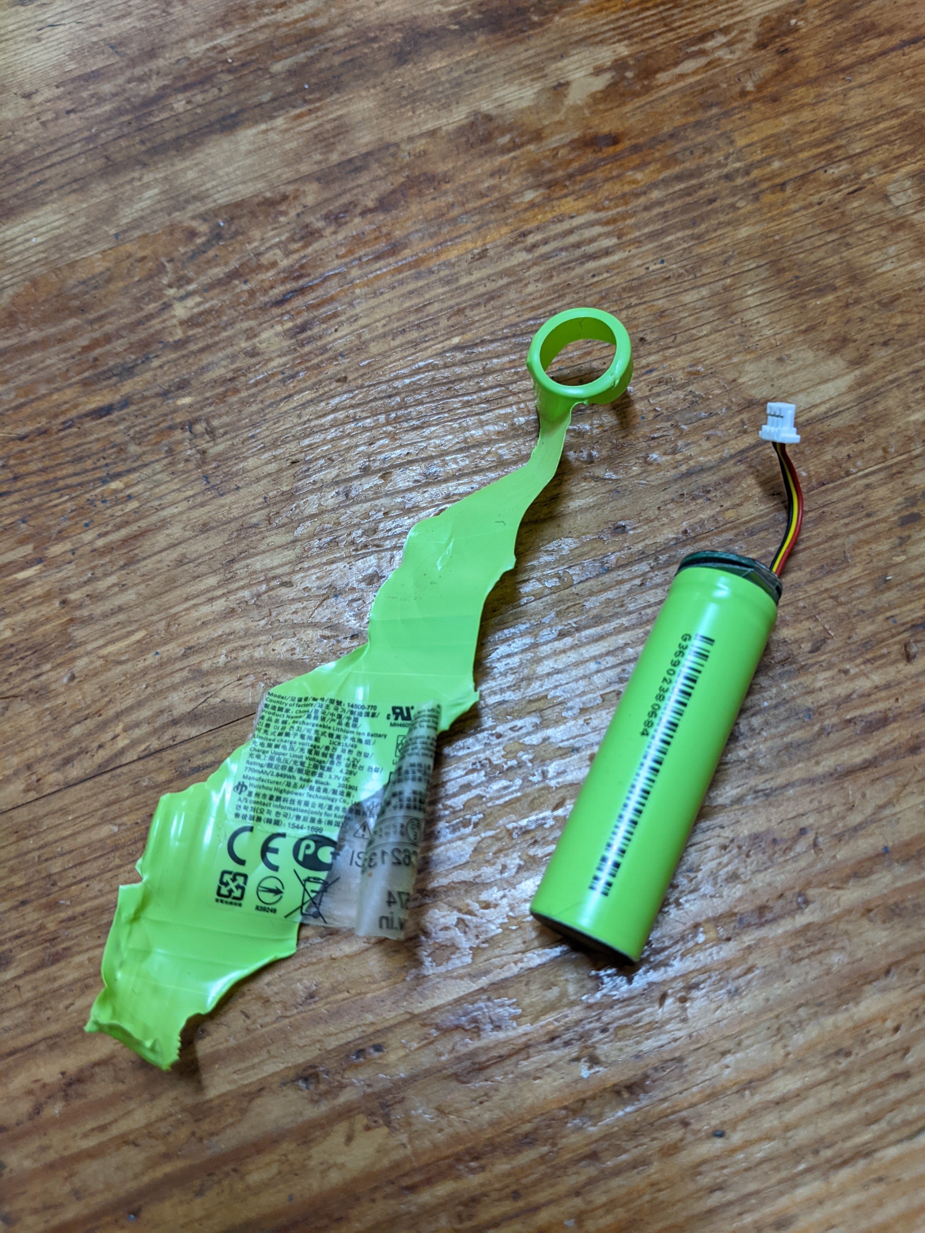

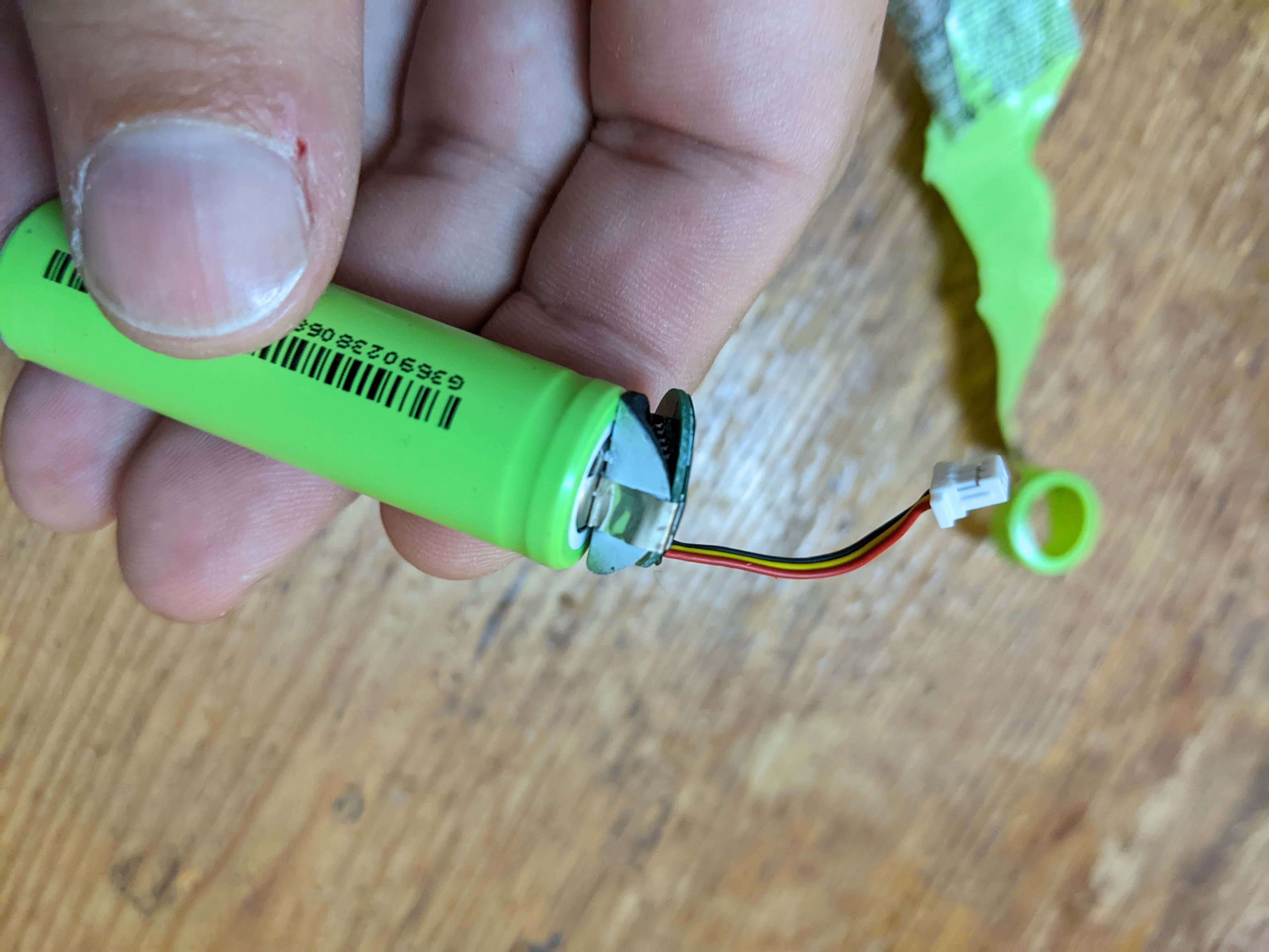

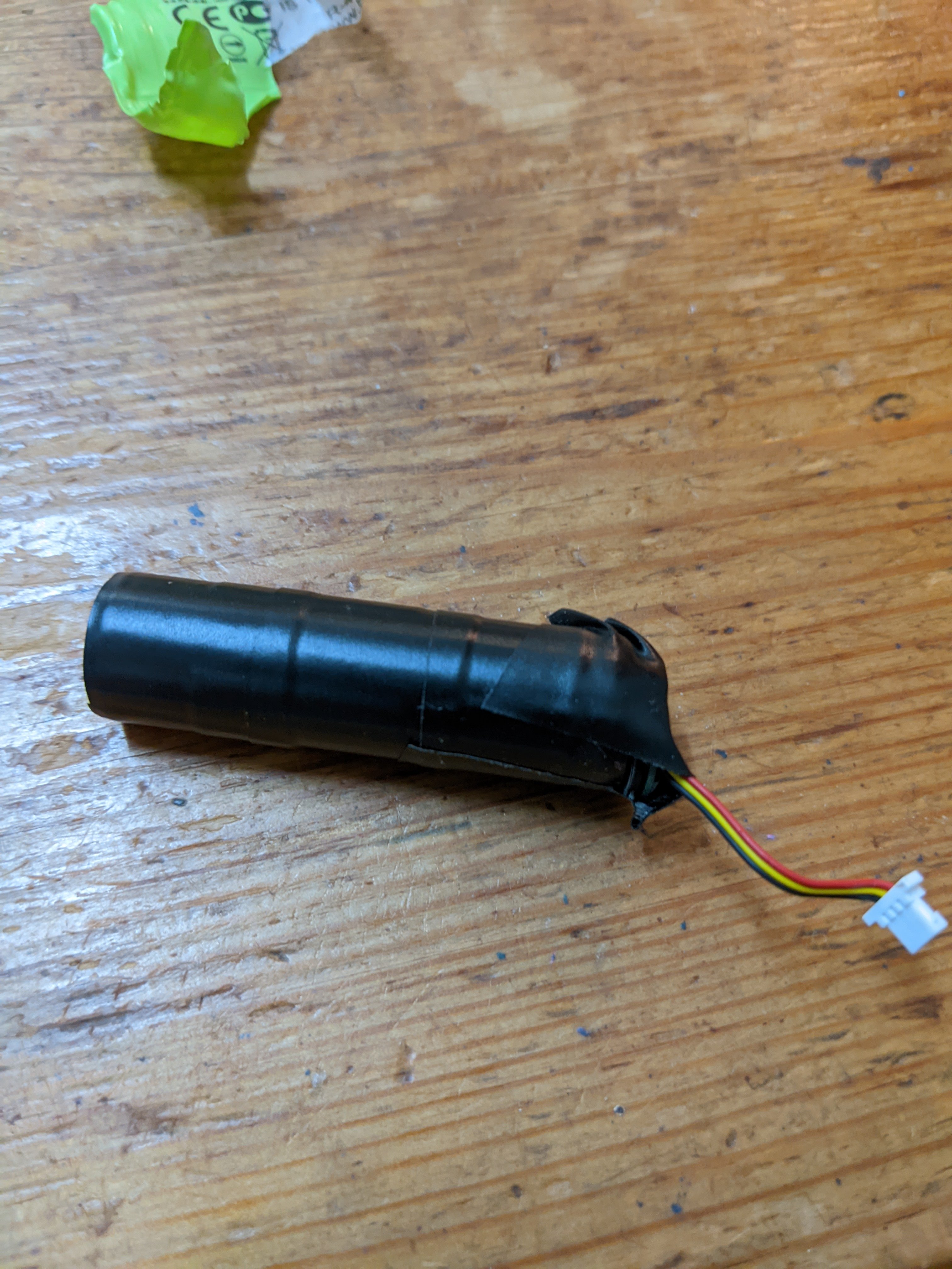

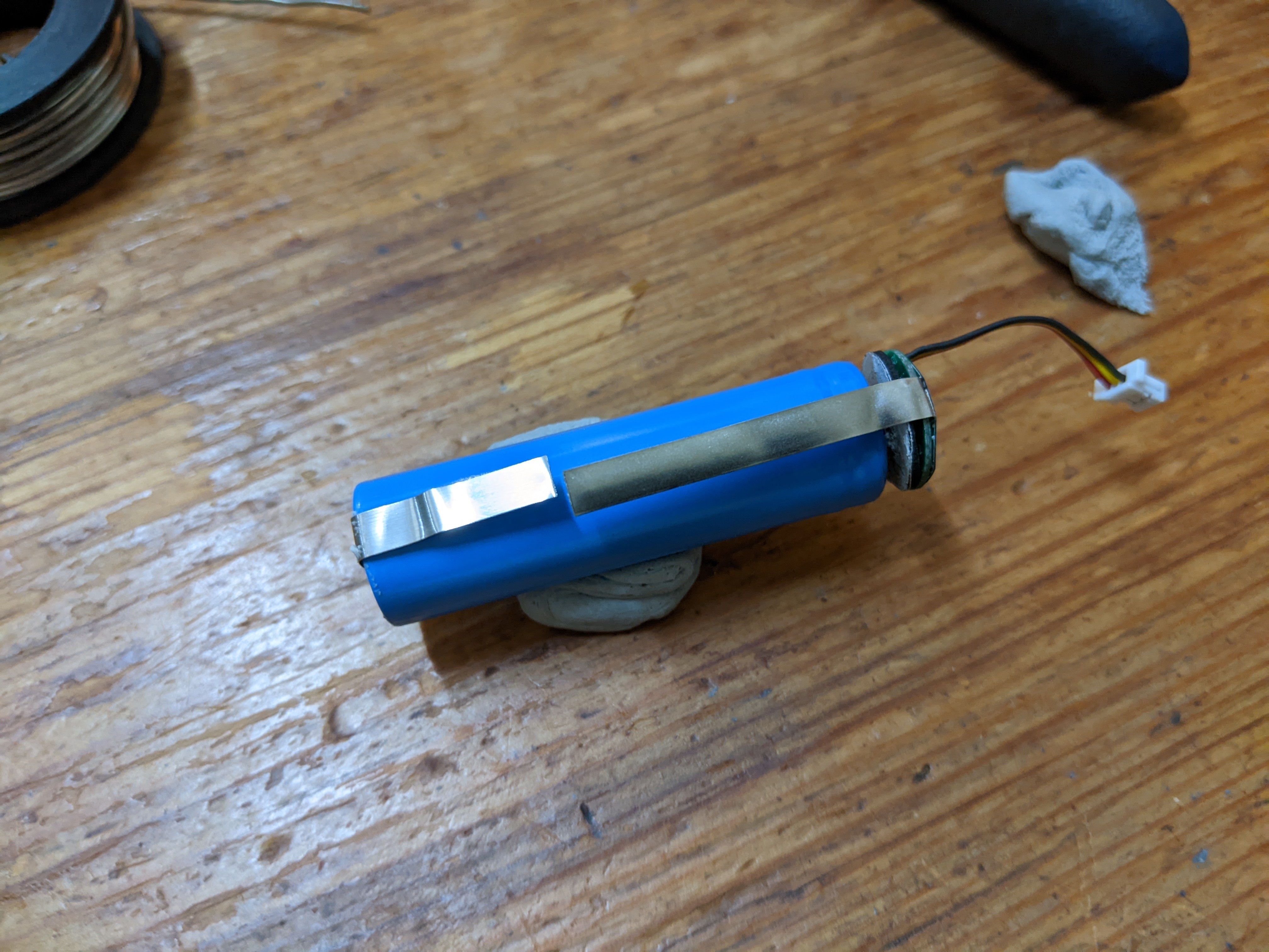

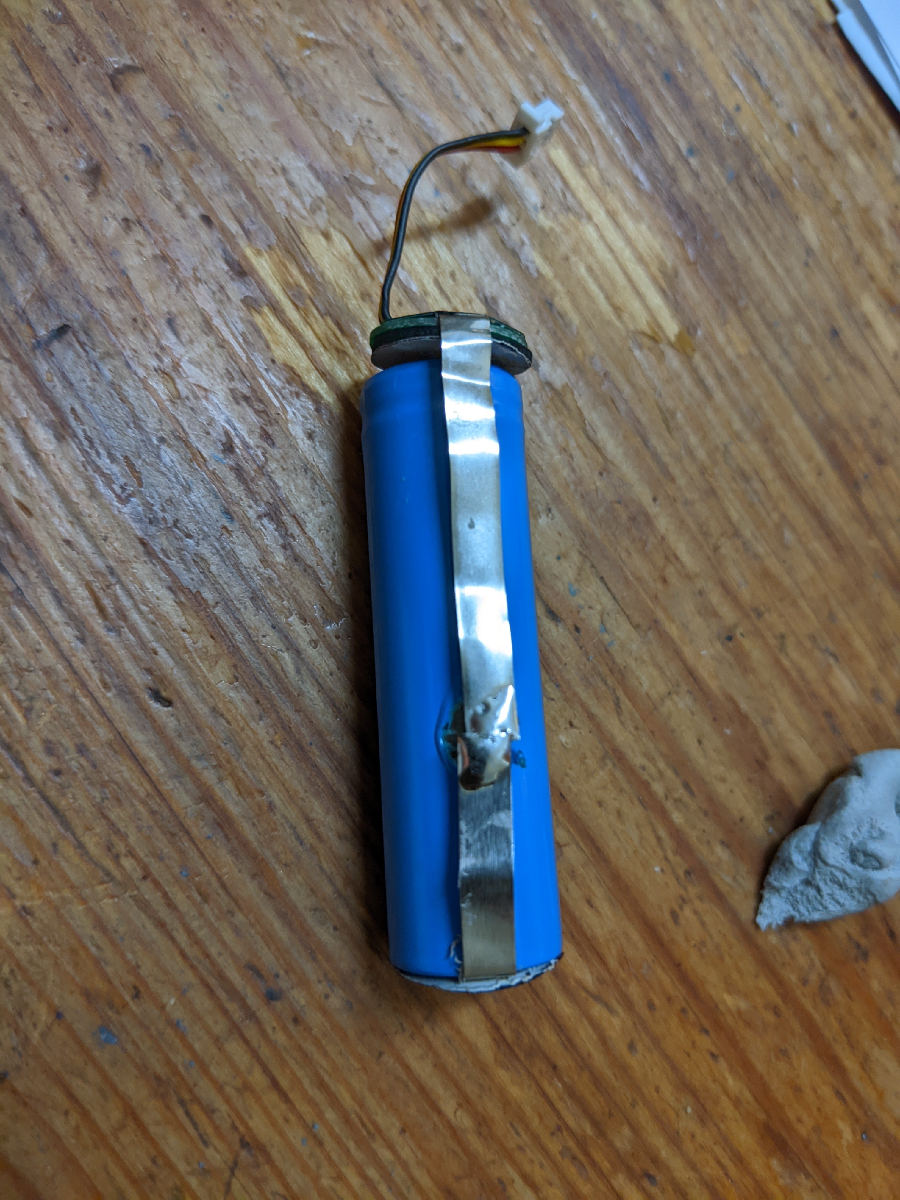

RevTodd Posted May 5, 2022 Share Posted May 5, 2022 Hi Folks, I see a recurring question here on the opening of the module. In short, it isn't hard. You basically have to pry it apart along the seam. Some will use a guitar pick, but I happened to have a 1" square of metal (you might have it too... it came with a magnetic phone mount, the metal that sticks to the phone) that was thin and able to get in there to pry and pop it open. I see some people have asked about a larger capacity battery, and while that is certainly possible, I wasn't able to find one. I just replaced it with another 800mah 14500 3.7v battery I found at the local electronics store. MAKE SURE IT HAS SOLDERABLE ENDS ON IT!! Once you pop the top, you've got to pull the circuit board out and disconnect the two connectors. The battery is held in place with some double sided tape on the underside that you can't see, but you'll need a small screwdriver or something to pry it out. Next step is to take the plastic wrapper off to expose the connections. (see my first picture) Then on the top side of the battery, peel the black cover back (it's under the little circuit board) to expose the top battery connector. Cut that silver strip. (see picture 3) You do the same thing on the bottom of the battery. Basically at this point you've got to pay attention to how long the solderable lead is that is on your replacement battery. Mine was about an inch long, so I didn't end up cutting the connector at the very bottom. You can see how I trimmed it in picture 5. Once those two connectors are cut, you move the unit you just cut off onto your new battery. In picture 6 I've soldered that connector that goes down the side of the battery. Do the same thing on the top. Once you've soldered it up, wrap the battery back up with some electrical tape and you're good to go! Juank, BrunoCH and Kisaha 1 2 Link to comment Share on other sites More sharing options...
DFT Posted September 26, 2022 Share Posted September 26, 2022 So, I'm a little confused. On my XSW Digital TX XLR, the transmitter that plugs into the mic, the battery inside is exactly as pictured in this thread, BUT the legend on the case states 5 v and 500 mA? Could someone please clarify? Also, between the 'IS,' 'IEC' codes and R-41110574 # (part #?), could someone explain please. Thanks! Link to comment Share on other sites More sharing options...
Super Members BTM_Pix Posted September 27, 2022 Author Super Members Share Posted September 27, 2022 12 hours ago, DFT said: BUT the legend on the case states 5 v and 500 mA? That is the power specification for the USB-C charging input. 12 hours ago, DFT said: Also, between the 'IS,' 'IEC' codes and R-41110574 # (part #?), could someone explain please. The IS and IEC numbers indícate conformity of the battery for fire safety and battery charging standards. The R code is the registration with the Bureau of Indian Standards who run conformity assessment schemes. Link to comment Share on other sites More sharing options...

BobC Posted May 14, 2024 Share Posted May 14, 2024 FAIR WARNINGS: 1) yes, the unit is easy to pry open, but you WILL destroy the ‘catches’, that you need to close the unit afterwards. 2) do NOT attempt to remove the audio connector from the PCB; the connector is of the utmost flimsiest kind, and you WILL rip off the thin wires (ask. me how I know) Now, I’ve ordered 1200mAh batteries and will install them instead of the 800mAh ones - will post back how that went. In the meantime, it took me half an hour to pry out the audio connector, and reconnect the wires to them - under a digital microscope and working on a 24” monitor. Most people will not have this equipment, so think before you start. As for closing the unit afterwards, a few very small drops of superglue will probably do the trick. But I will see if I can open the second unit without tearing off anything; if I succeed I will post back also. Link to comment Share on other sites More sharing options...
