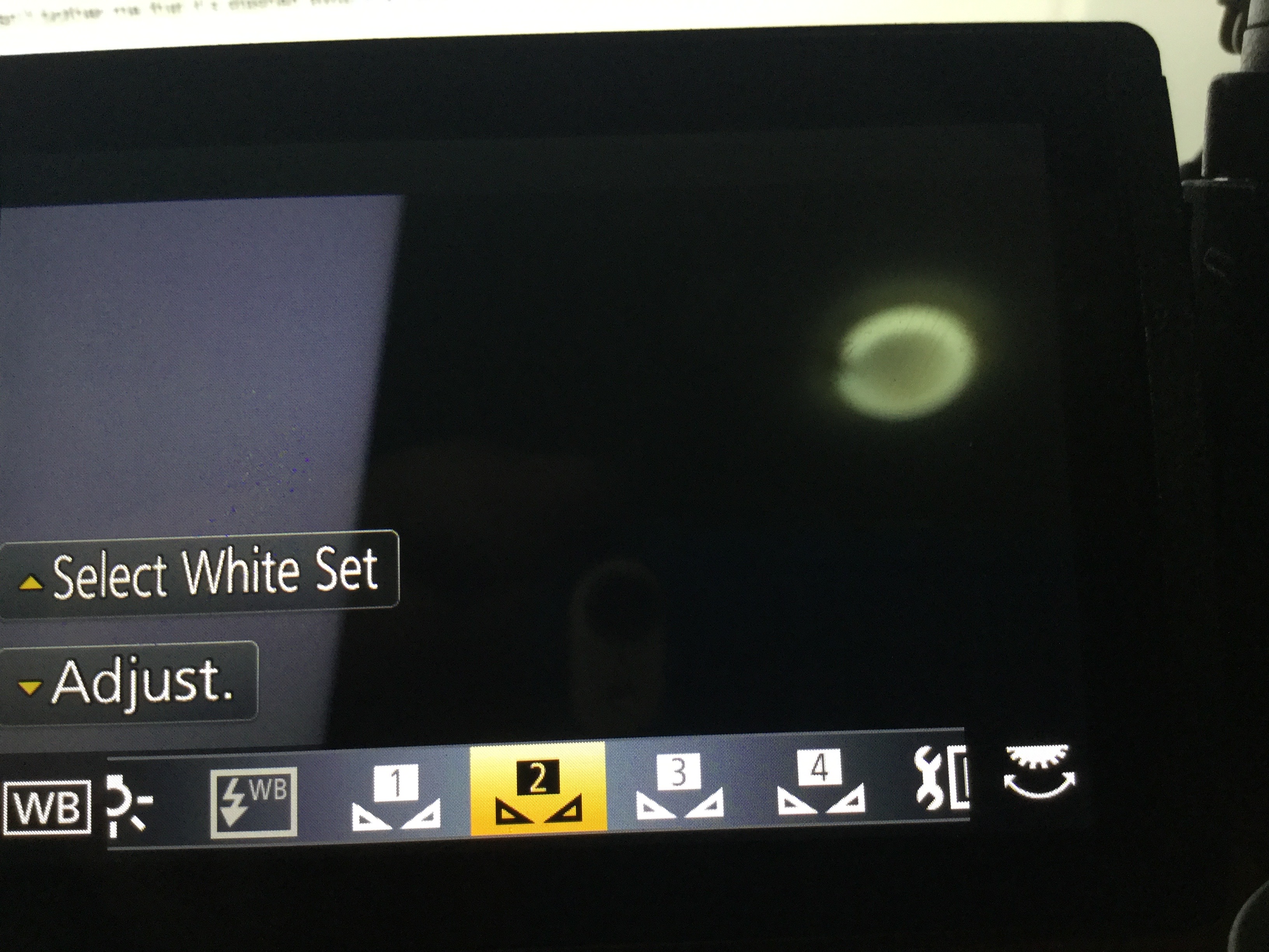

Do you mean this? On Panasonic cameras, you can assign WB to any function button.

I meant a custom WB rather than just a button to access the WB selection menu.
