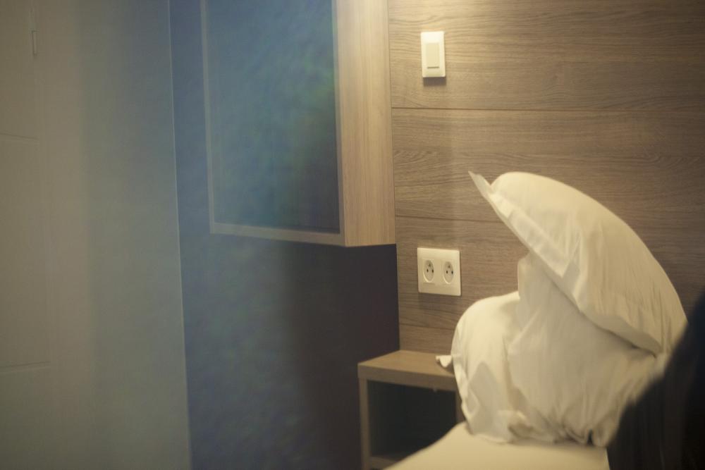

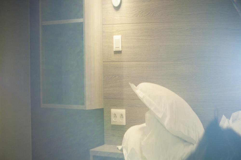

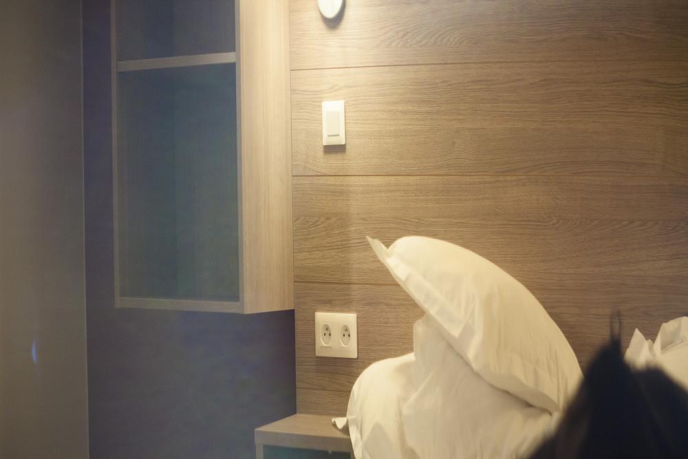

Justin Bacle Posted November 3, 2016 Share Posted November 3, 2016 Very unscientific test (as I don't have step-up and step-down rings nor do I have a Tripod as I am in a Hotel for work right now) Used a flashlight to create side lighting. But here it is. I think I proved your point No Ultra contrast filter : Filter In Front of the anamorphic : Filter between the adapter and lens (sorry for being a different shot, as I did have to put everything on a table) : jase and sanveer 2 Link to comment Share on other sites More sharing options...
jase Posted November 3, 2016 Author Share Posted November 3, 2016 Thanks! This seems to prove in turn @bunk's theory: i would say that placing the filter between adapter and lens yields an image that has much lens flare/haze, yet the filter effect is reduced. I think i could live with that, awesome @Justin Bacle sanveer and Justin Bacle 2 Link to comment Share on other sites More sharing options...
