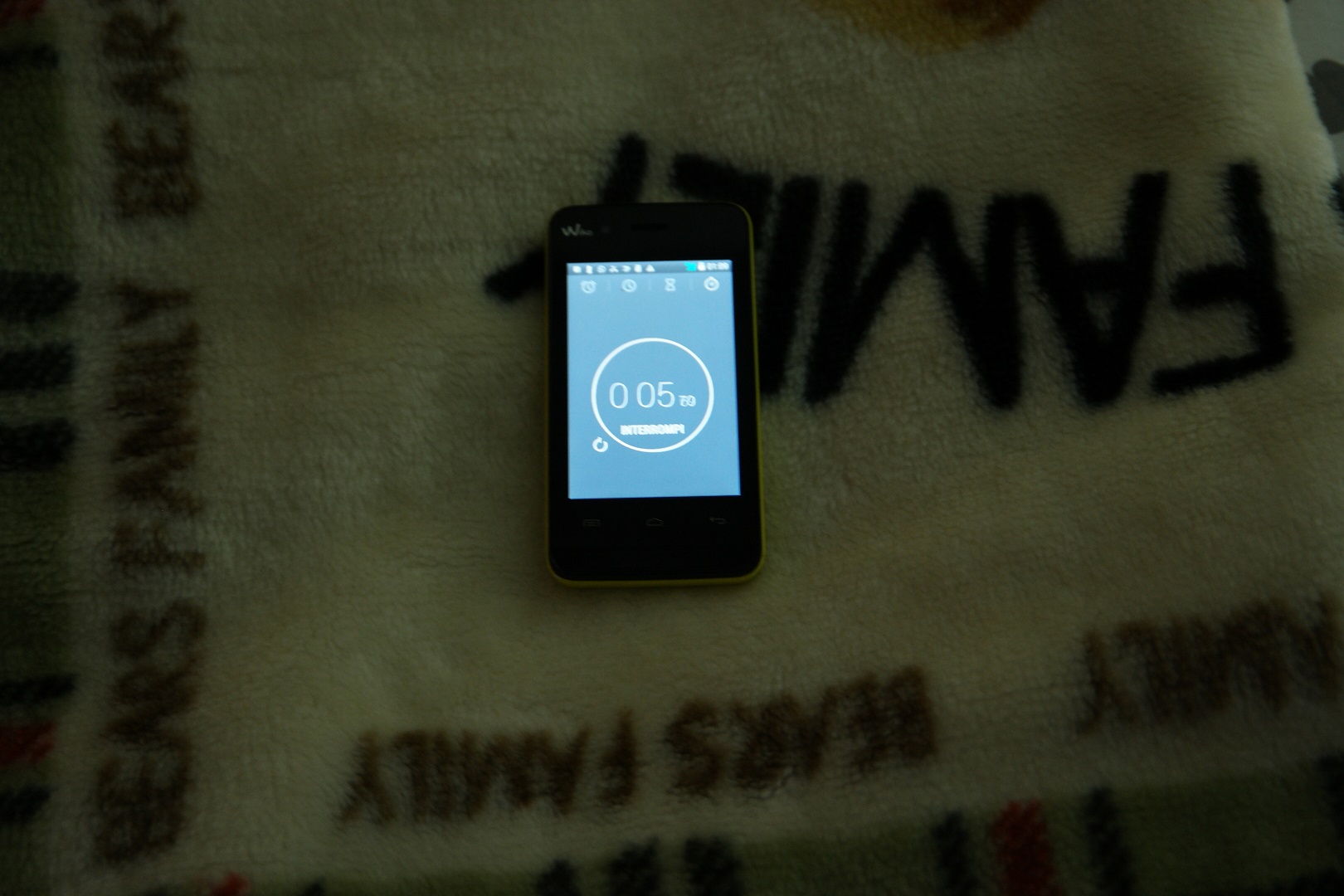

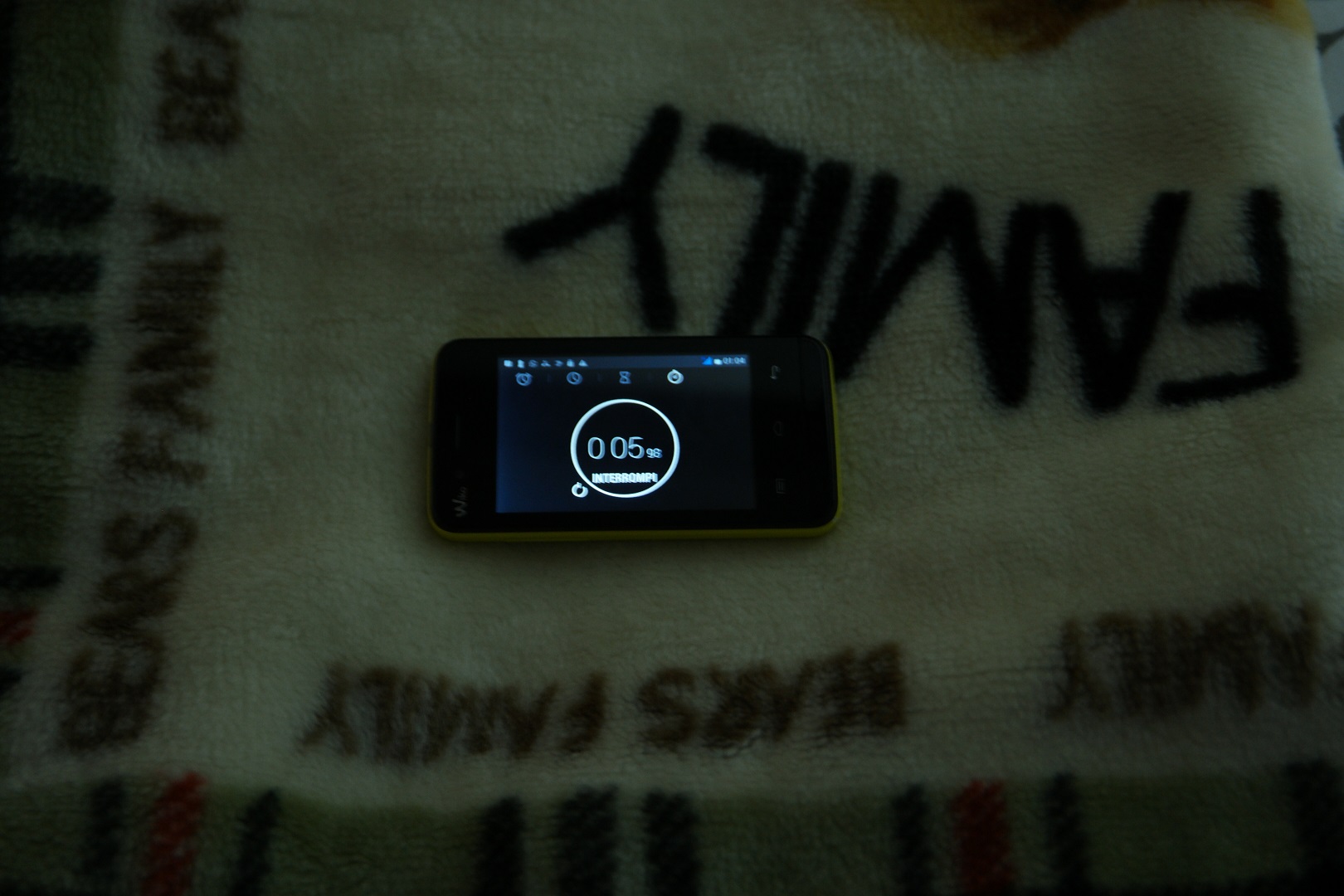

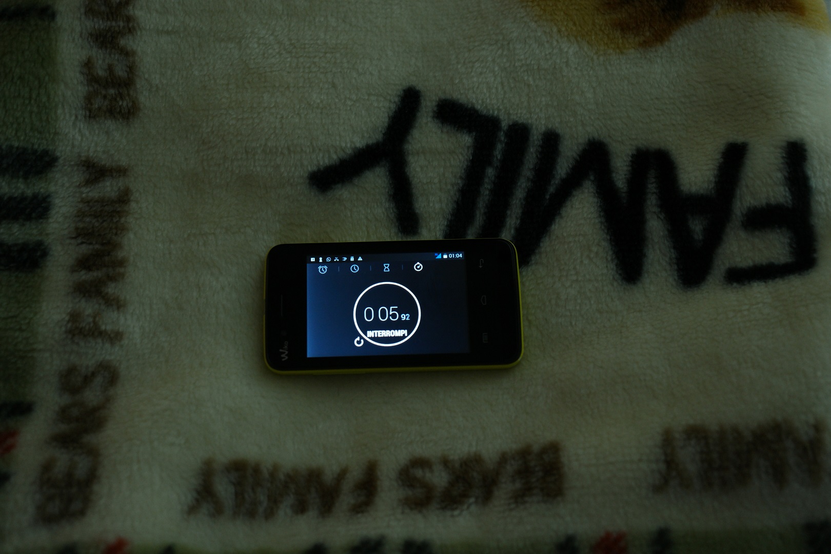

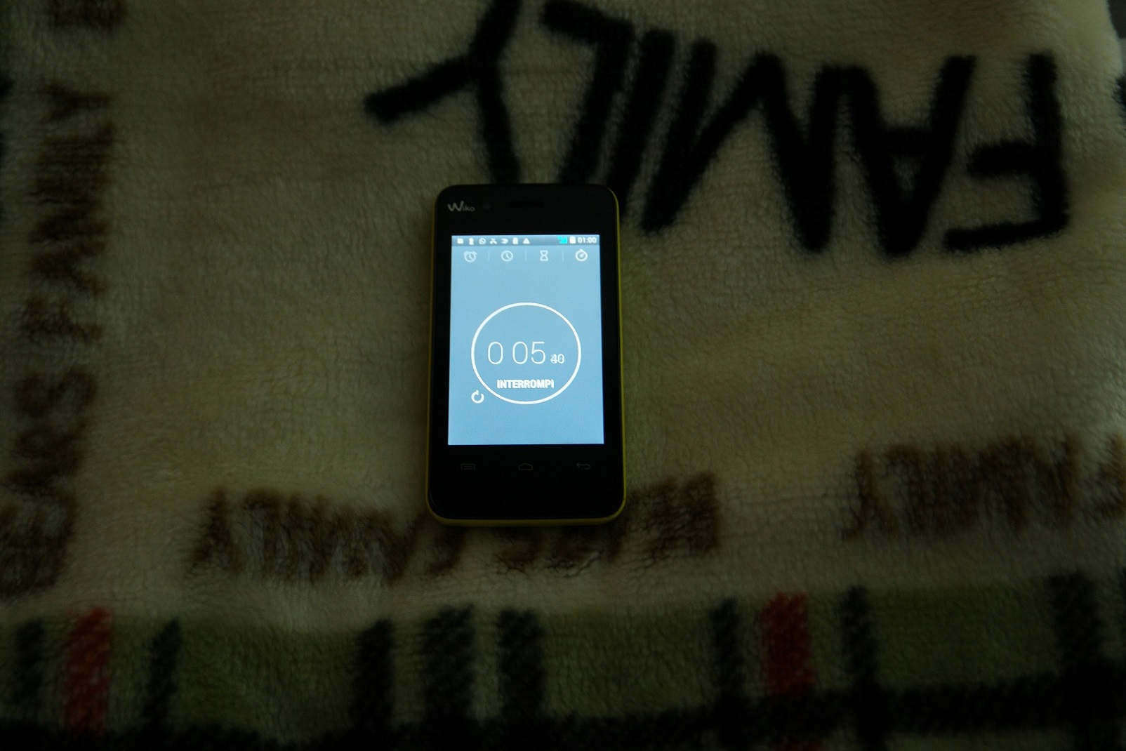

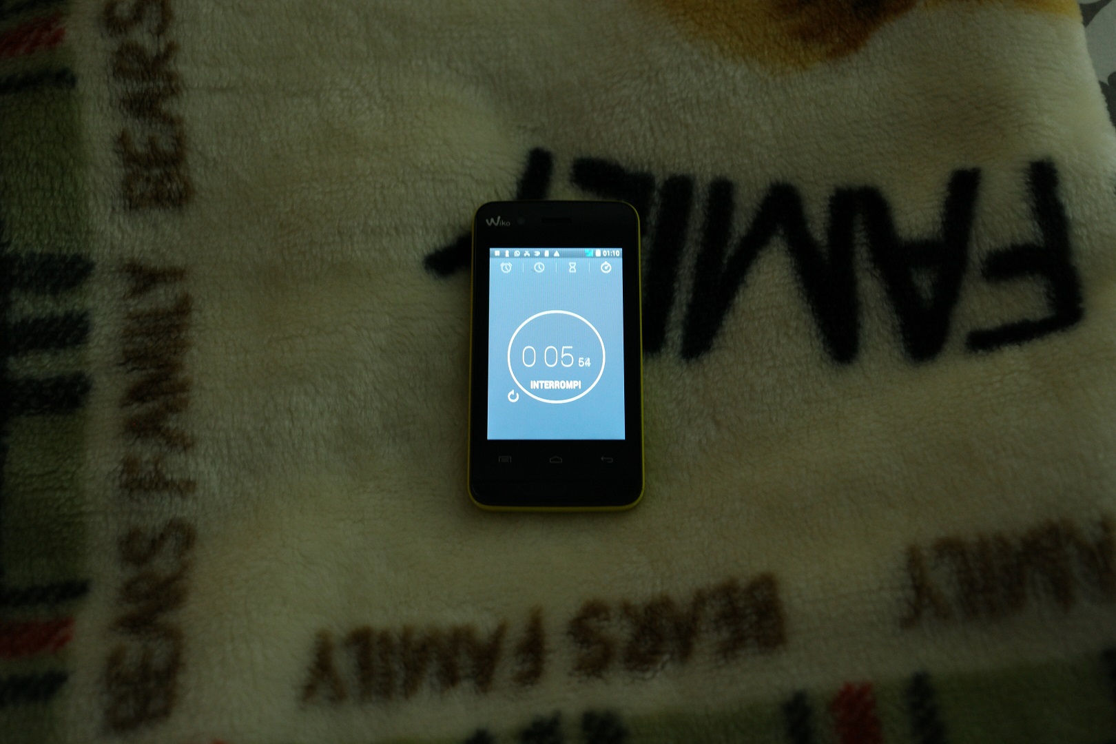

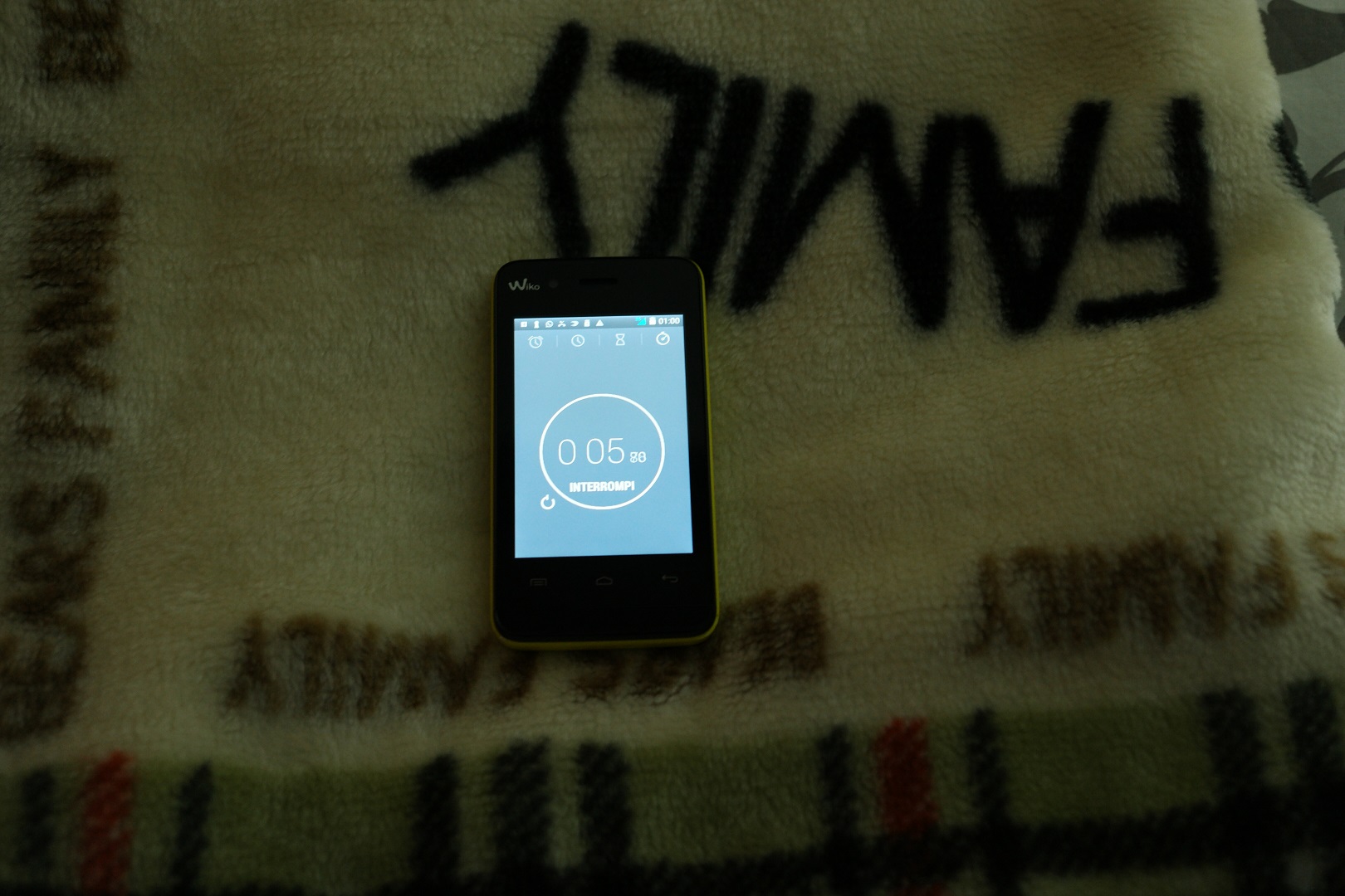

lucabutera Posted February 21, 2017 Author Share Posted February 21, 2017 Tonight I want to test the speed focus of 16-50 F.2-2.5 S and the 30mm F.2 pancake. The test was performed as follows: - Camera Samsung NX1 in M mode - 1/60 - F.2.5 - ISO 800 - 30mm focal - Subject illuminated with low artificial lights, subject distance 1mt; - Before shooting I prepared the objective by changing the focus of the lens; - At the stroke of 5/2 of the time trial I I pressed the shutter button. This test is not scientific, because my reflexes can alter the result, it is only a test in the real world, but what I discovered was shocking! The first shot to win the 16-50 S that has passed the 30mm well 0.40 tenths of a second, but for security I wanted to repeat the test by turning the phone horizontally and I could not believe my eyes. Not only did the 16-50 was slower than 30mm but also has the wrong focus for two consecutive times !! At this point I wanted to repeat the test with smartphone horizontal but again the 30mm was more accurate and fast and the 16-50 S missed the target. I do not know what to think, maybe 16 50 S is faster when used on shorter as 16mm focal, possibly with daily lights the result could be overturned but to date the 30mm F.2 won both the target speed in focusing on the targeted subject and also the skill in not miss the shot. First time. 16-50mm S (fast focus 0,40 sec. but no perfect shoot - watch Wiko logo) 30mm 0,80 sec. but nice focus Second Time, turn the smartphone 30mm 0,92 sec. to focus 16-50mm S 0,98 sec to focus (0,06 more and wrong focus) Last Time Turn the smartphone and try again with 16-50mm S 0,70 sec. to focus and misses the shot again! 30mm 0,54 sec. and perfect shoot. The 30mm F.2 Pancake, in this no scientific focus test, win 3 on 3. SMGJohn 1 Link to comment Share on other sites More sharing options...

Arikhan Posted February 21, 2017 Share Posted February 21, 2017 @lucabutera Thank you for the helpful test! We have to consider that AF speed != AF accuracy - so your test is not surprising for me ( I can't check this, because I don't own the 30mm Samsung lens) In video (CAF) it's much more important to lock on accurately and keep focus than fastly lock on and miss focus Thanks again! Additional thought: As I can see, the lighting situation you use could be a little bit challenging for the NX1, as the behaviour and IQ of the NX1 in quite decent light and decent contrast are sometimes a miserable failure. So if you do your test in nearly perfect situations like day light and normal contrast, you could get completely different results for the same test. My experience after about 25.000 still shots with the NX1... In very decent light and contrast, the NX1 misses oftenly focus (and mostly IQ) when fast AF lock on with moving subjects is needed (still photography) - nothing comparable with other APS-C cameras like the D7200 or the D500. This camera's focusing capabilities and IQ are really very dependent of the amount of light it receives and contrasts it's faced with...Much more than any other "quality camera" with APS-C sensor size... Link to comment Share on other sites More sharing options...
SMGJohn Posted February 21, 2017 Share Posted February 21, 2017 I think the speed difference comes down to the fact that the motor in the 30mm has only a fixed focal length to move while the 16-50mm is a zoom and zoom lenses are ALWAYS slower than quality prime lenses, and yes Luca is right the zoom is slower at 50mm than it is on 16mm because the motor must move the zoom more at the longer ranges than it will have to in the wider ones. It be interesting to see how it acts as an adapter though. lucabutera 1 Link to comment Share on other sites More sharing options...
